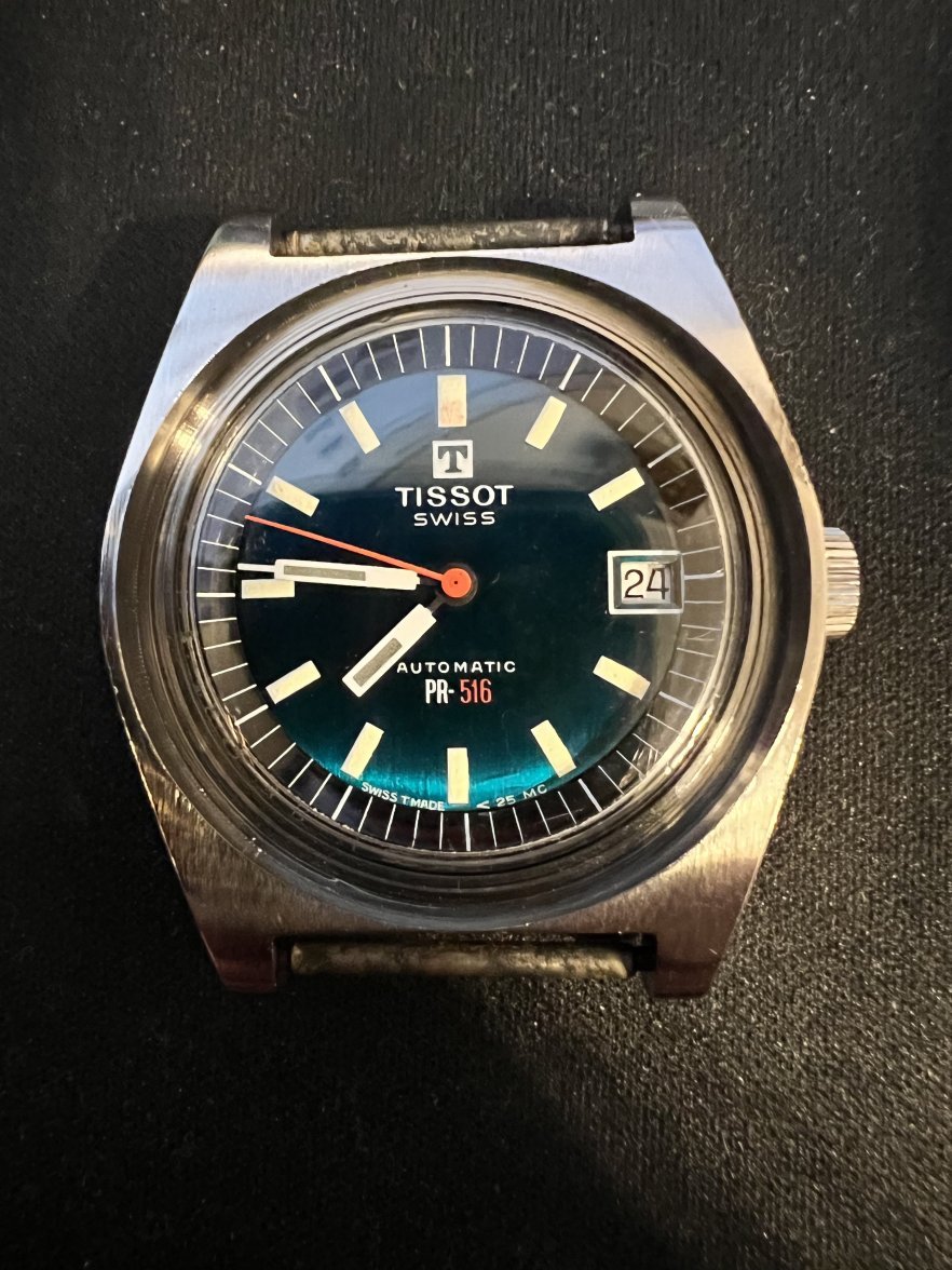

Hello, I have a Tissot PR516 with a Bakelite ring that is broke, can I order from you a new one? Here is a photo of the whack.
Kind regards

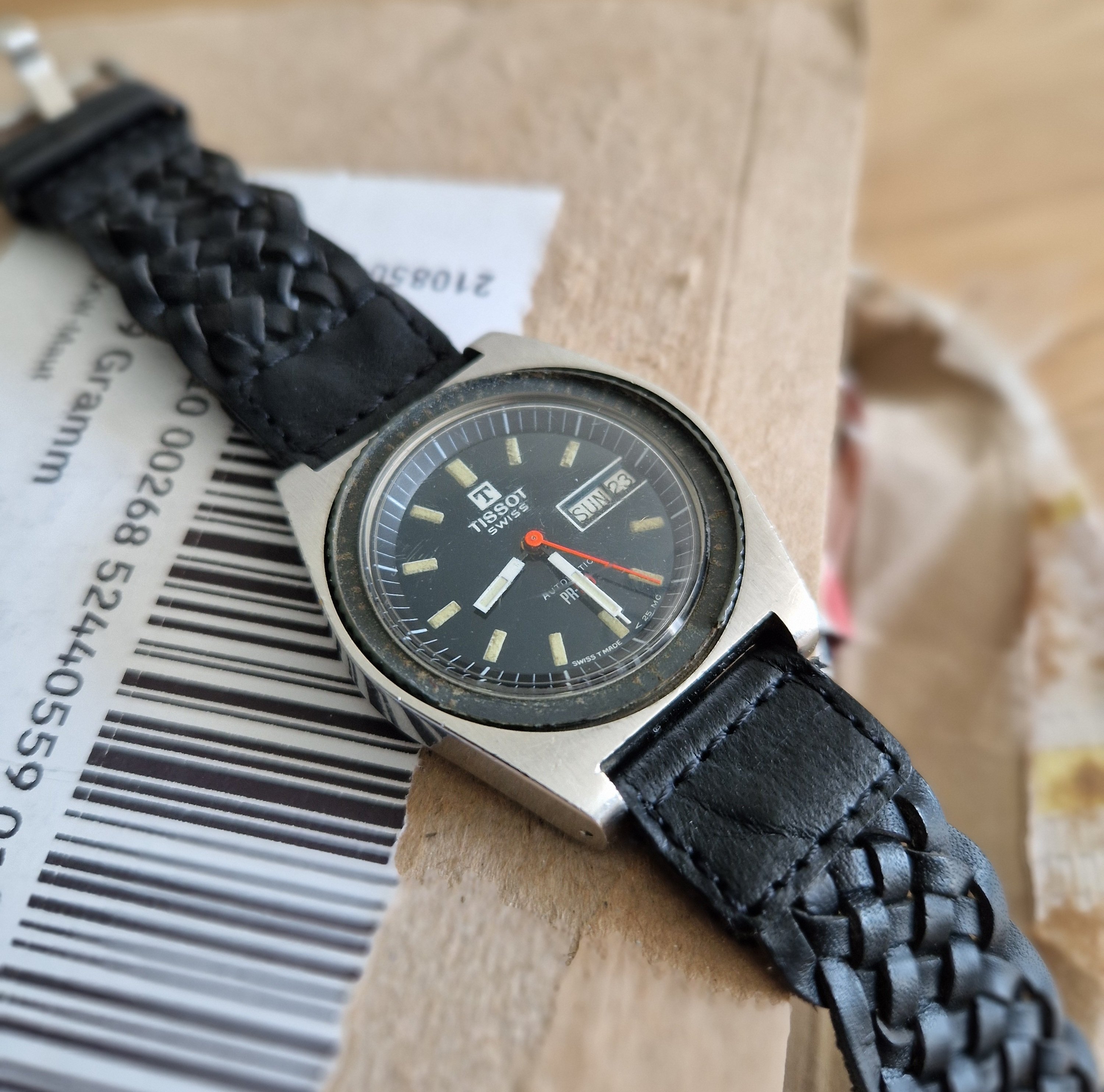

Hello mcgyver,
This is Rene from Austria. I stumbled across your amazing repro bezels while searching for replacement for my 46622-2x.
Is it possible to order one? Mine has the bakelite Version with the Insert. The bakelite outer ring is still there but very brittle. The insert is missing.
Would be great to hear from you, best regards and greetings from Austria.

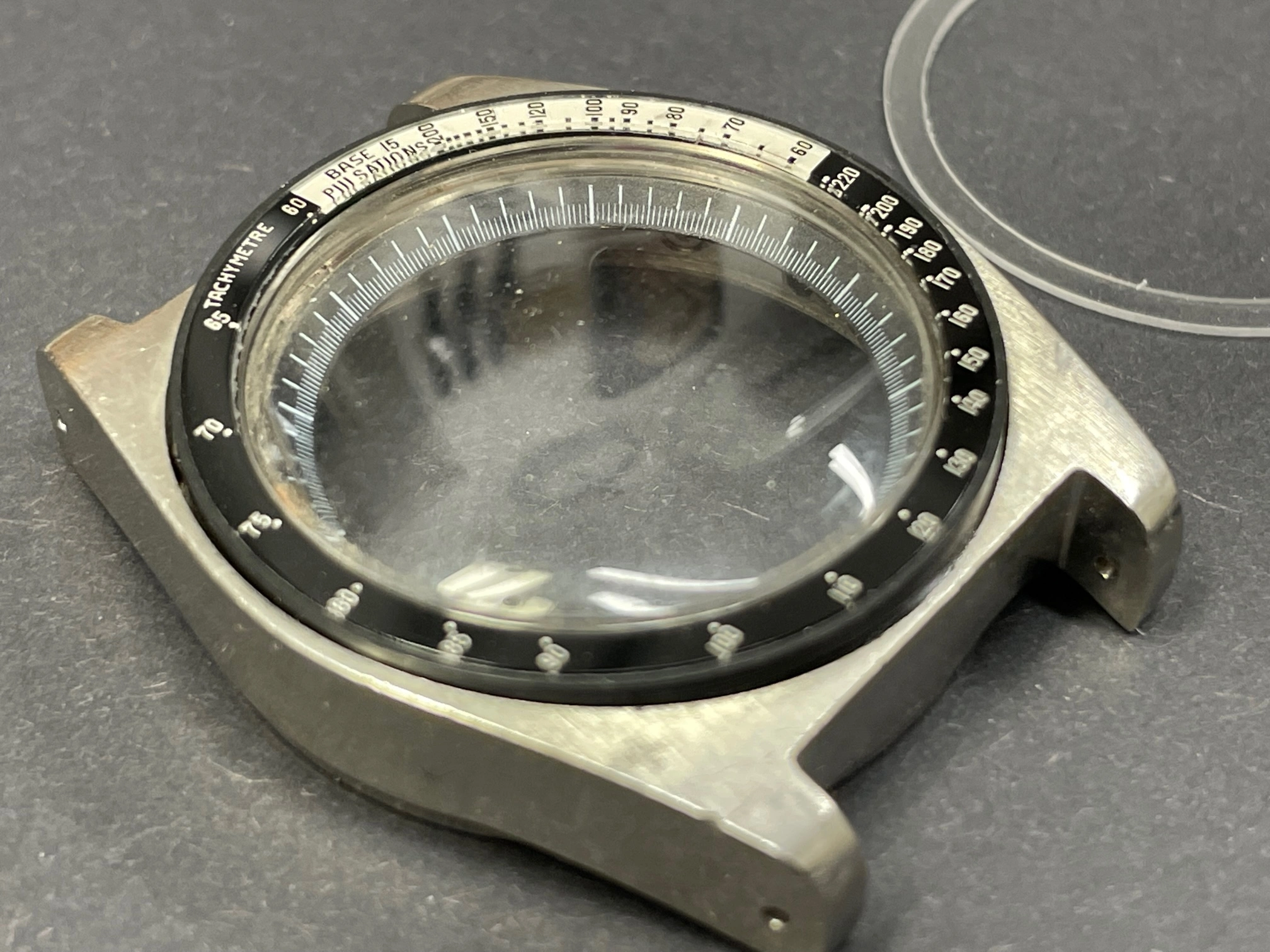

I have had request for making a bezel/insert for the PR516 chronographs with tachy/pulsations scale before - but I never had an original at hand to se how it was made. @TrboDieselPwrd kindly sent me a case with a worn bezel/insert to disect!
I have allways taught it was a rather thick acrylic insert, but it turns out to be 0.5mm and held in place by a piece of black plastic that is press fitted to the case.
I took measurements and produced a new "bezel" from fresh POM plastic.
The insert was made from 0.5mm acrylic sheet. Numbers/scale are made with a special method of painting and etching (muuuuuuuuuch experimentation to get it to work) and finally the backside is painted white.
The insert is then glued to the bezel and gets a final polish - done.

Incredible work @mcgyver! That bezel looks fantastic and you certainly didn't waste any time!
Very interesting! I also thought it was a thick acrylic part. On another heavily polished (including the bezel 鈽癸笍) example, it seems like the bezel is quite a bit thicker than what you found. The way it's polished down it seems like it's 1.5-2.0mm thick. Maybe the polishing blended all the layers together.
I can't emphasize how crucial this part must have been. These numerals are smaller and finer than those of a Moonwatch for example as the PR516 is only 36mm diameter. So glad this turned out so well and I am happy that I was able to "help" 馃榿
