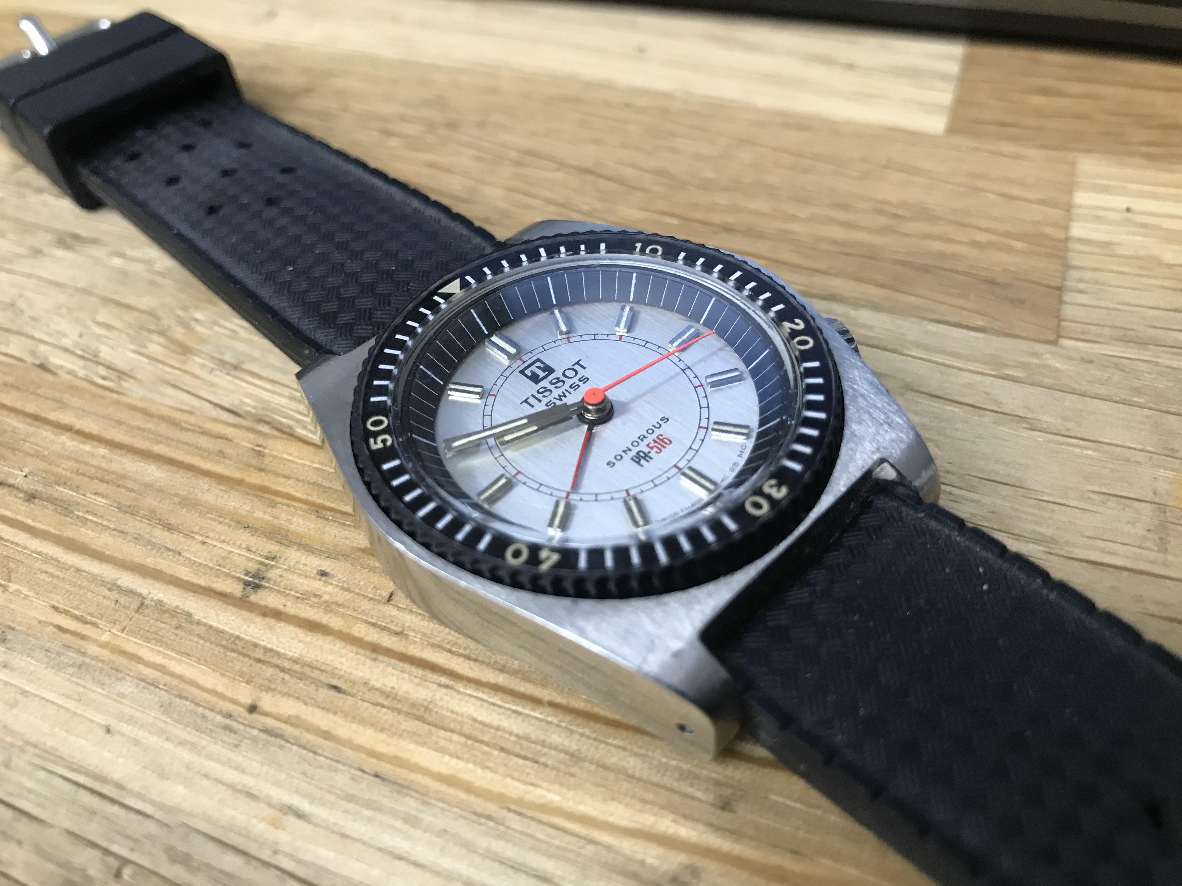

New version of the bezel

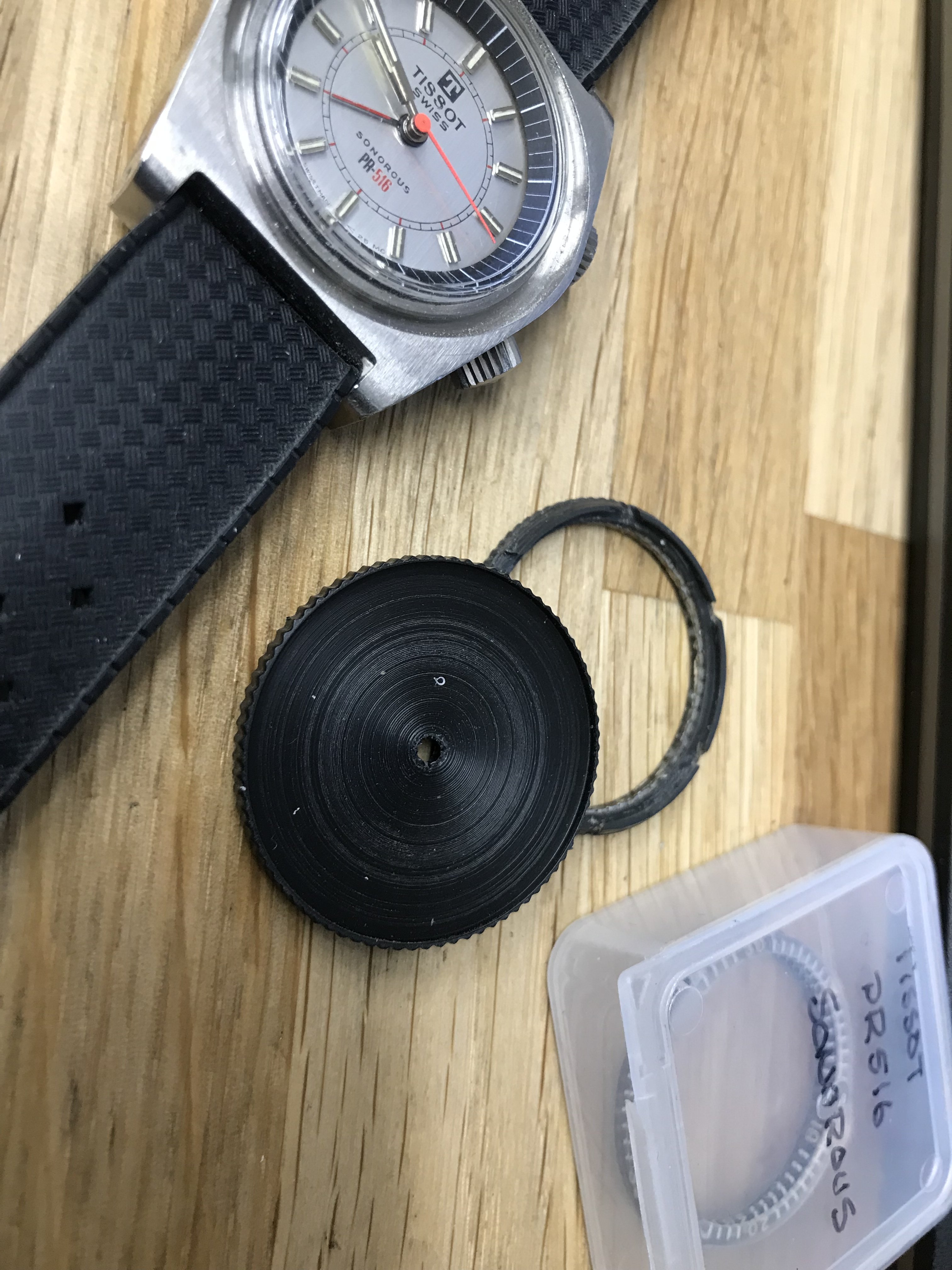

Milling the teeth manually was I real pain, so I had an idea to try and make these using my CO2-laser.
Getting hold of the POM/Acetal sheet material has been......hard. Do not know if it's the pandemic causing material shortage or the companys have to much to do and focus on the bigger fish - I have ordered two sheets and no feedback 6 months later!?
Anyway - went to my "go to guy" for scrap pieces of plastics and got two bits of black POM.

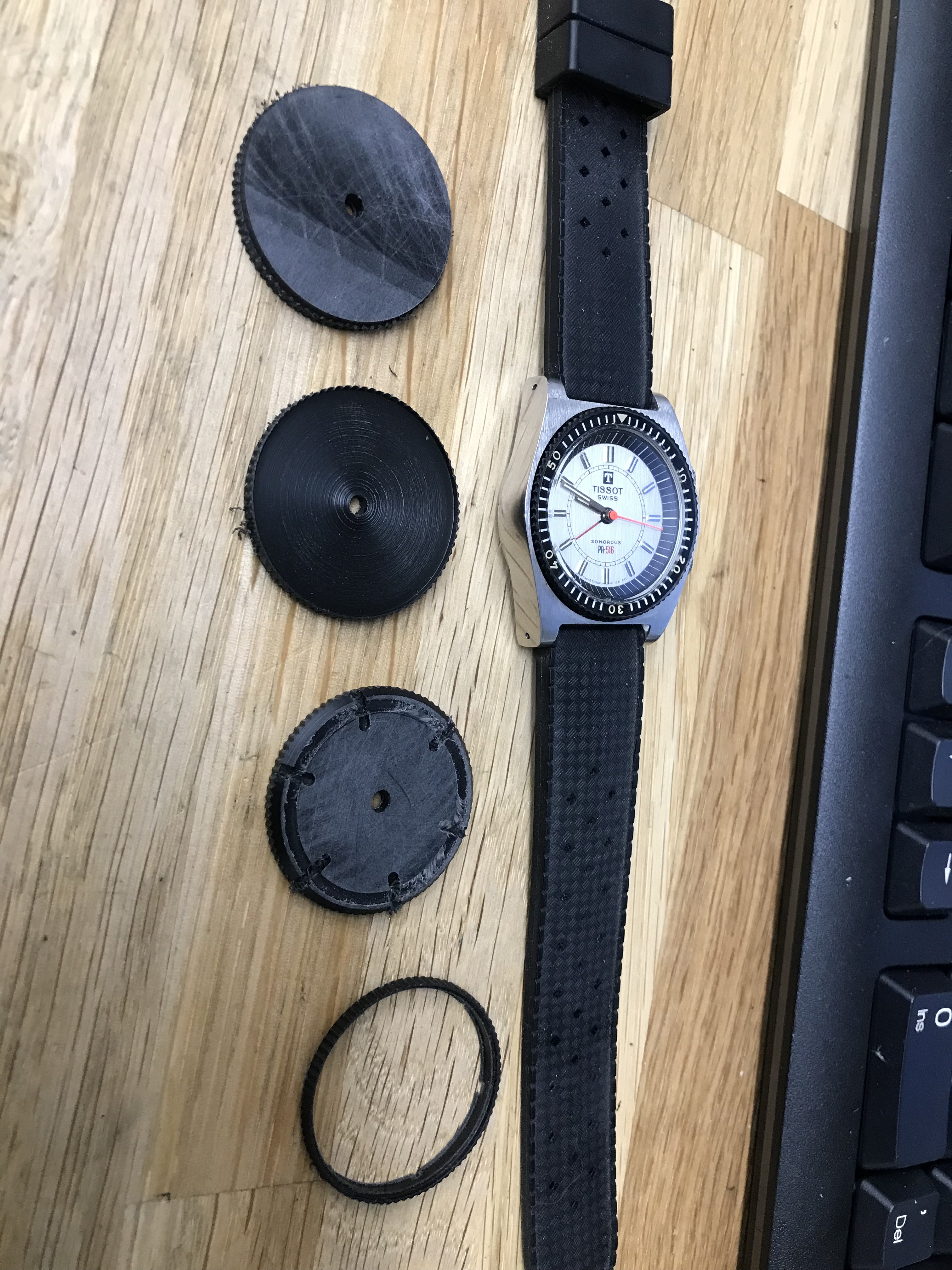

They where 8mm thick, so I milled them down to 3.5mm before moving them to the CO2-laser to cut out blanks.

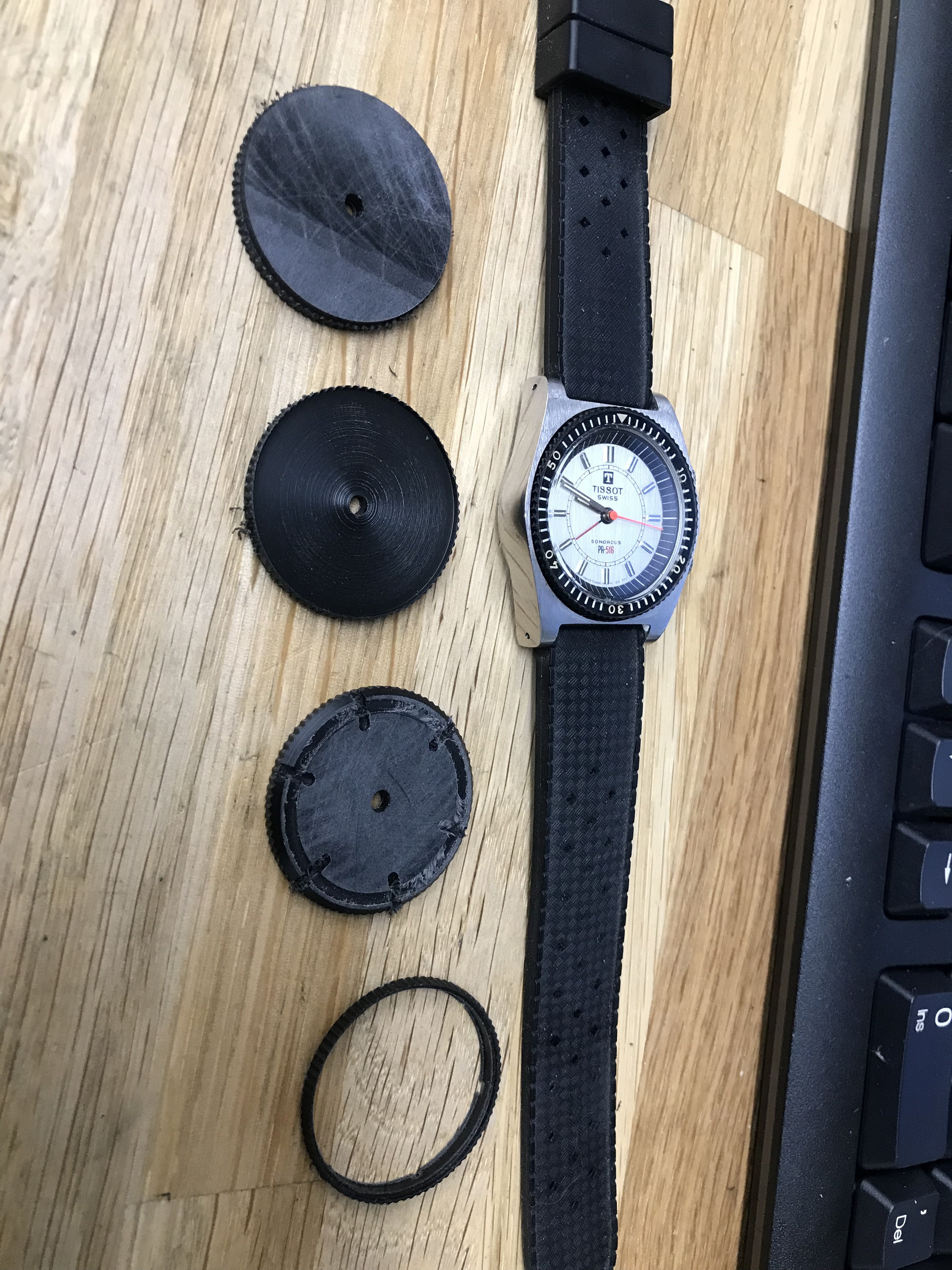

Here is a blank after making a cut using my lathe for the insert.
The back was then milled.
Then flipped and milled the front.
Here are the different stages shown.

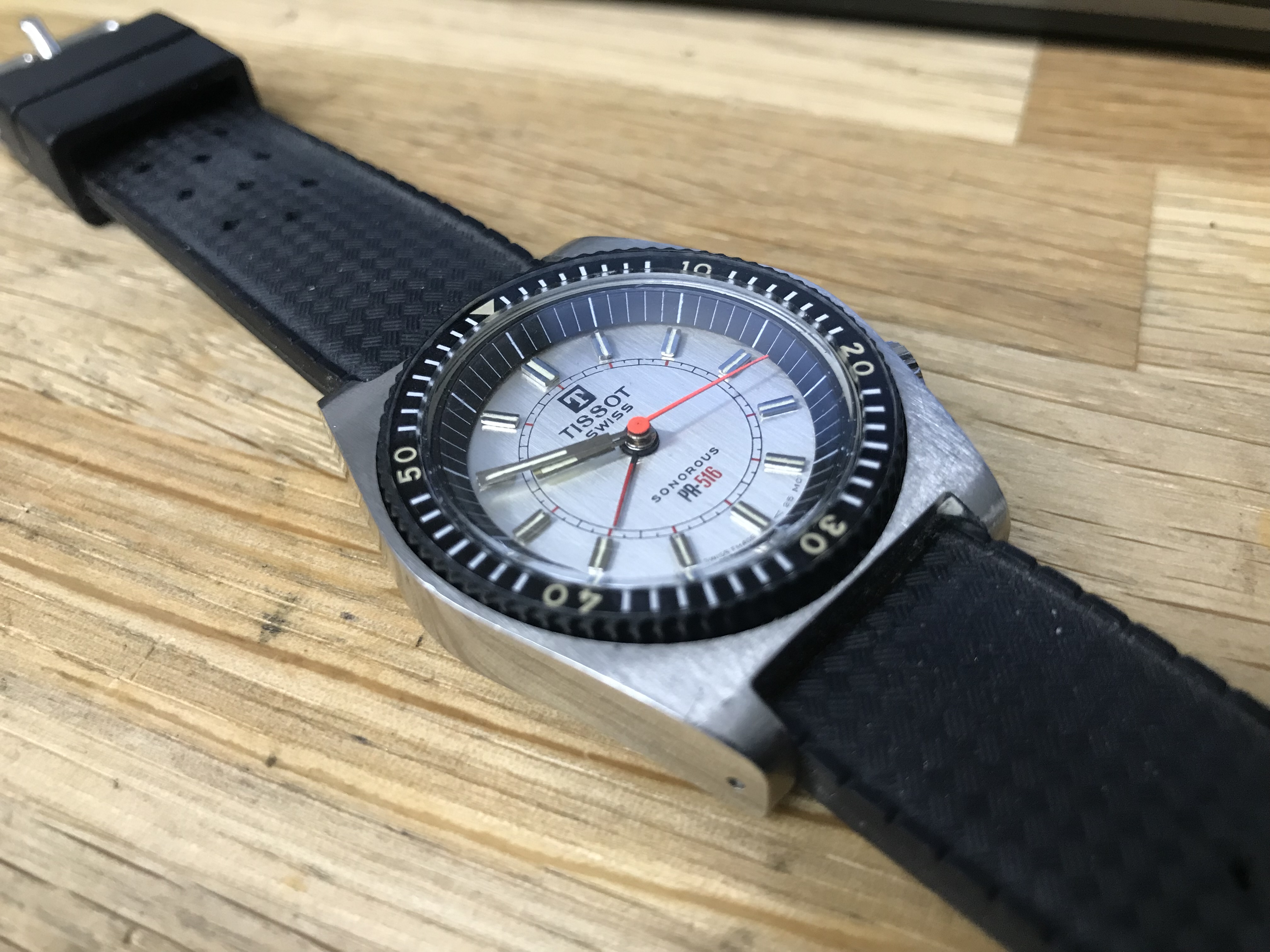

And the end result!!

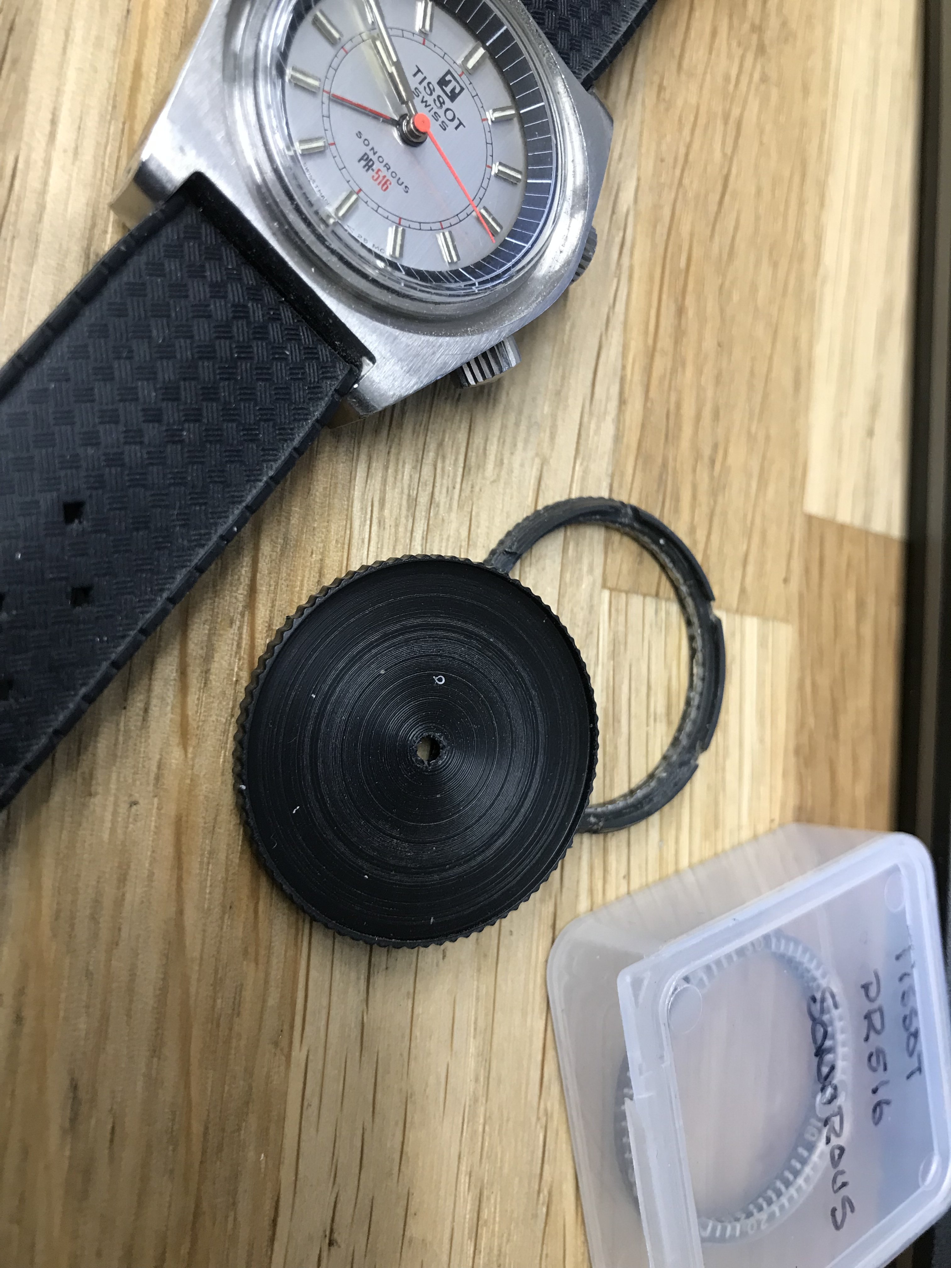

Made a new batch! 😀
Glue needs to cure and then a quick clean up and they are ready for service!

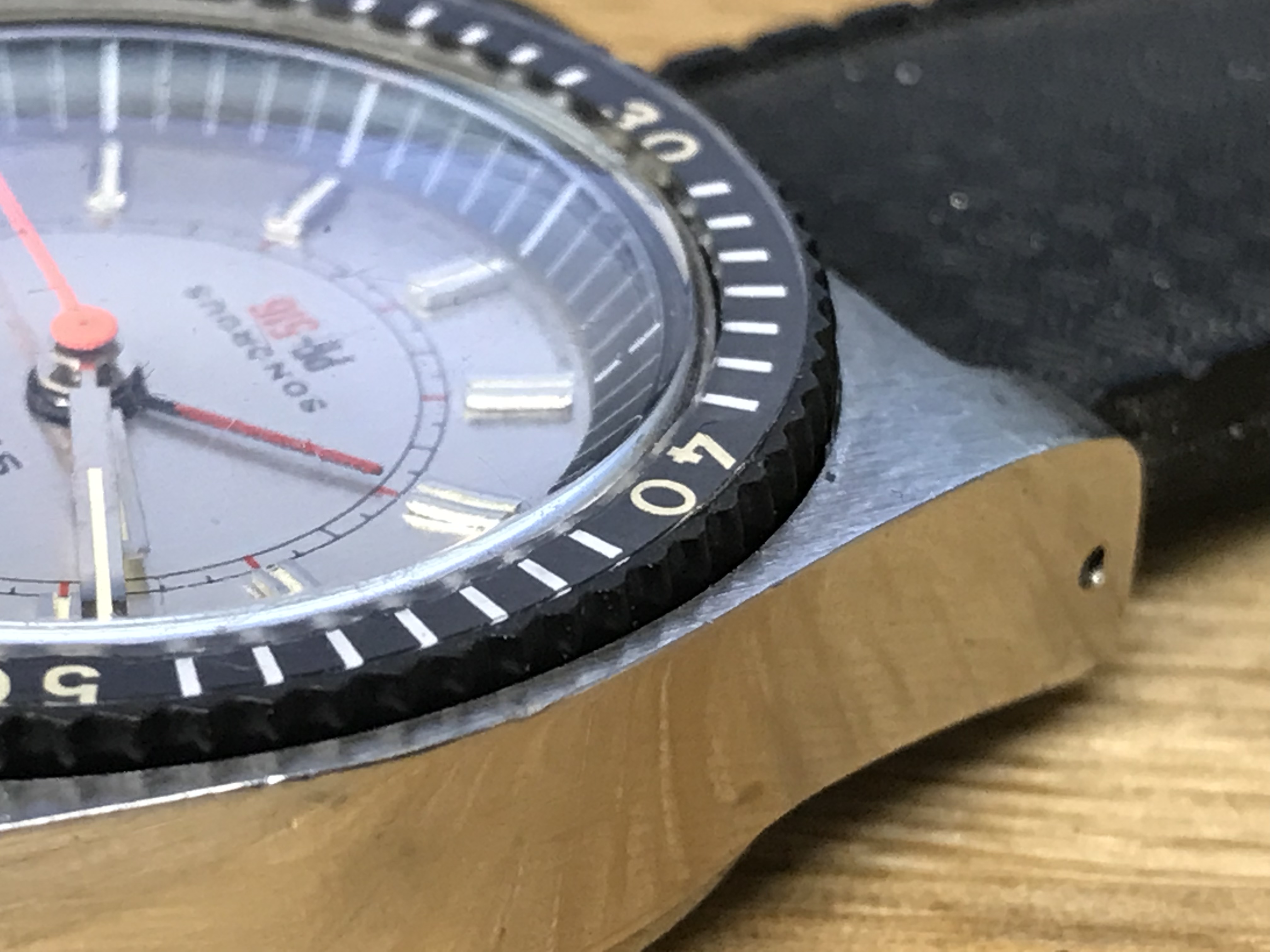

I’m trying different methods to make replacements for old lost acrylic inserts!
Fonts needs tweaking and indexes to - but method works.

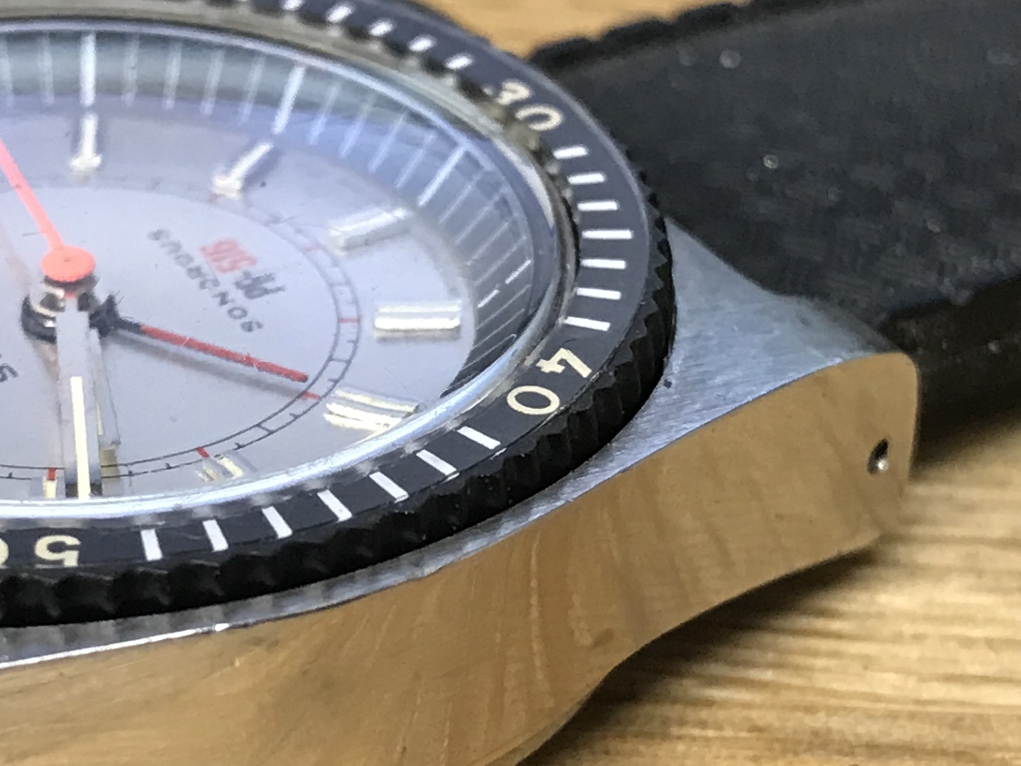

I got this watch a while ago
Initial plan was to use as is, but after a few days on the wrist I taught it lookeed a bit dull with the worn bezel.
What to do?
I made some tooling so I could mill the rounded "teeth" on the bezel edge.
After much boring work on the mill, the teeth were finaly in place.
Some more turning and after a nice anodizing acid bath followed by a dip in colour I had a almost finished new bezel.
A simple centering jig was cut in my fiber laser and the bezel was then ready to be engraved.
A new spring was made from a piece of stainless wire and all fitted on the watch - the result.

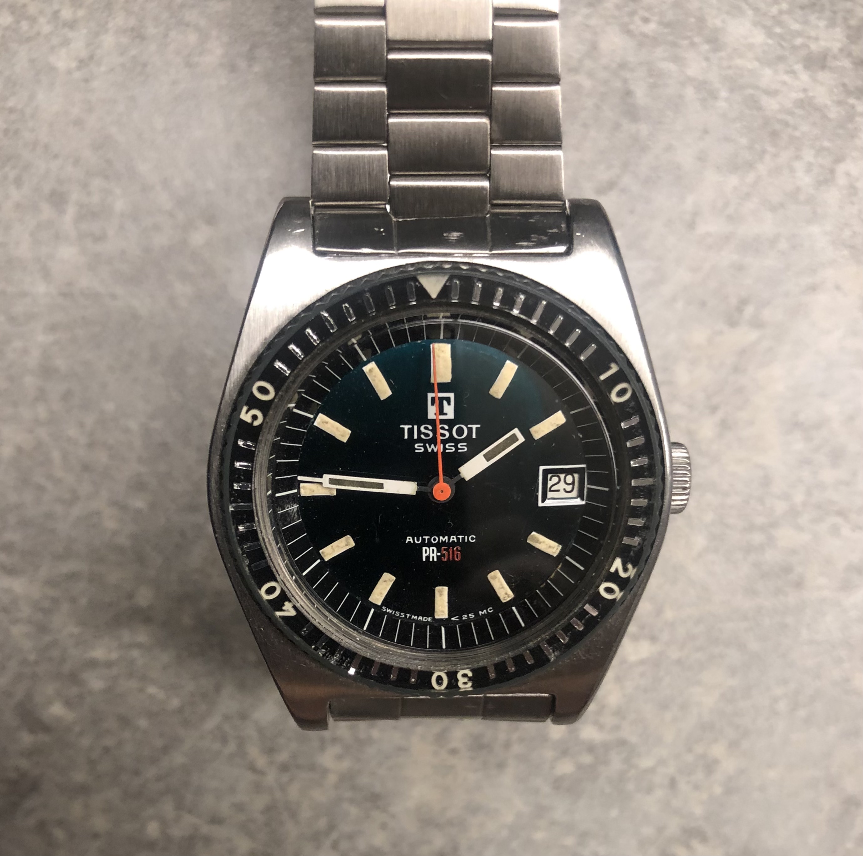

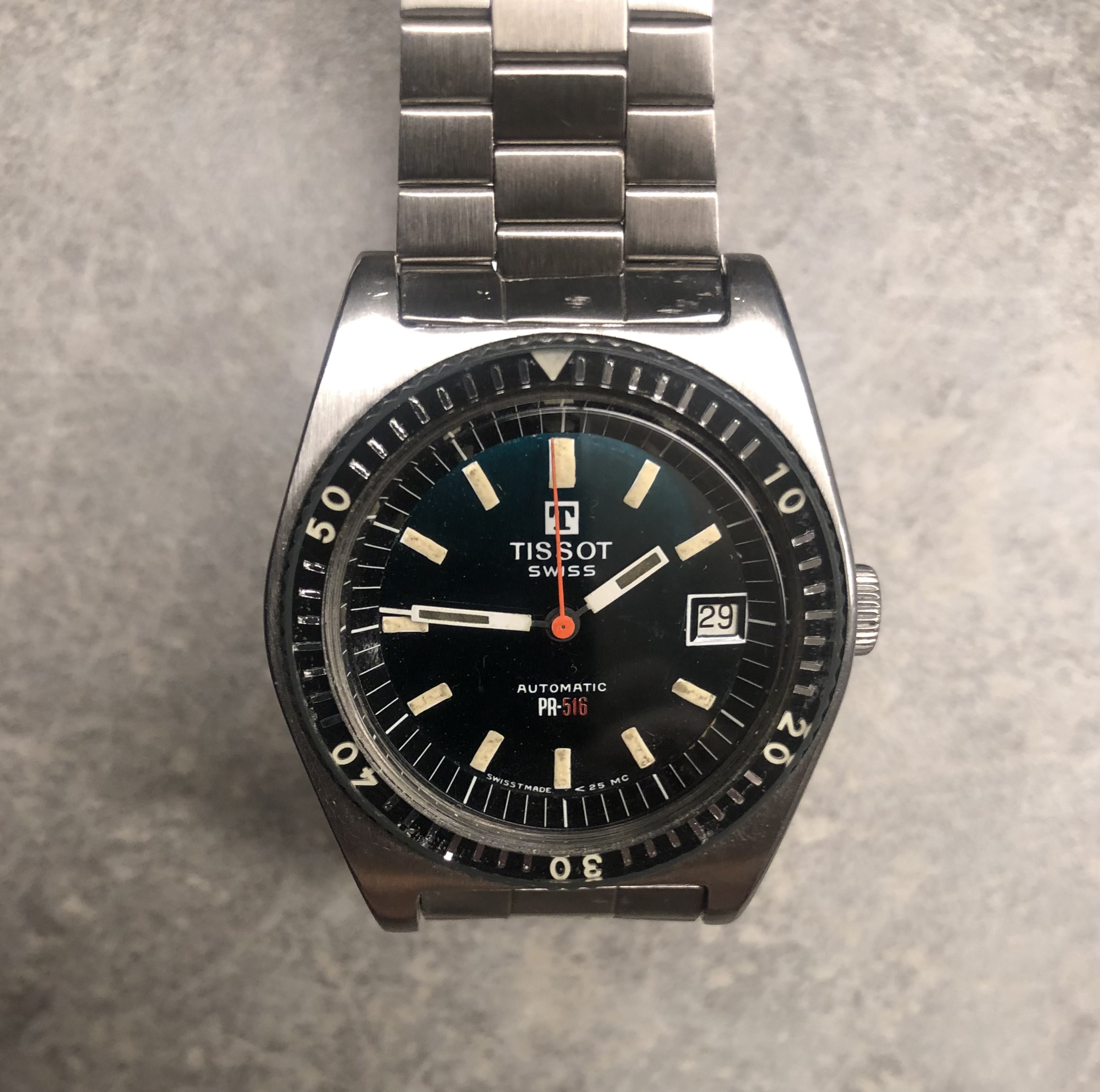

Hi mcgyver, sorry for the delay, my watch is finally here but i noted that the original bezel is in steel, do you think it's possible to remplace it by one of your creation in bakelite ? I give you a pics so you can see. Thanks
