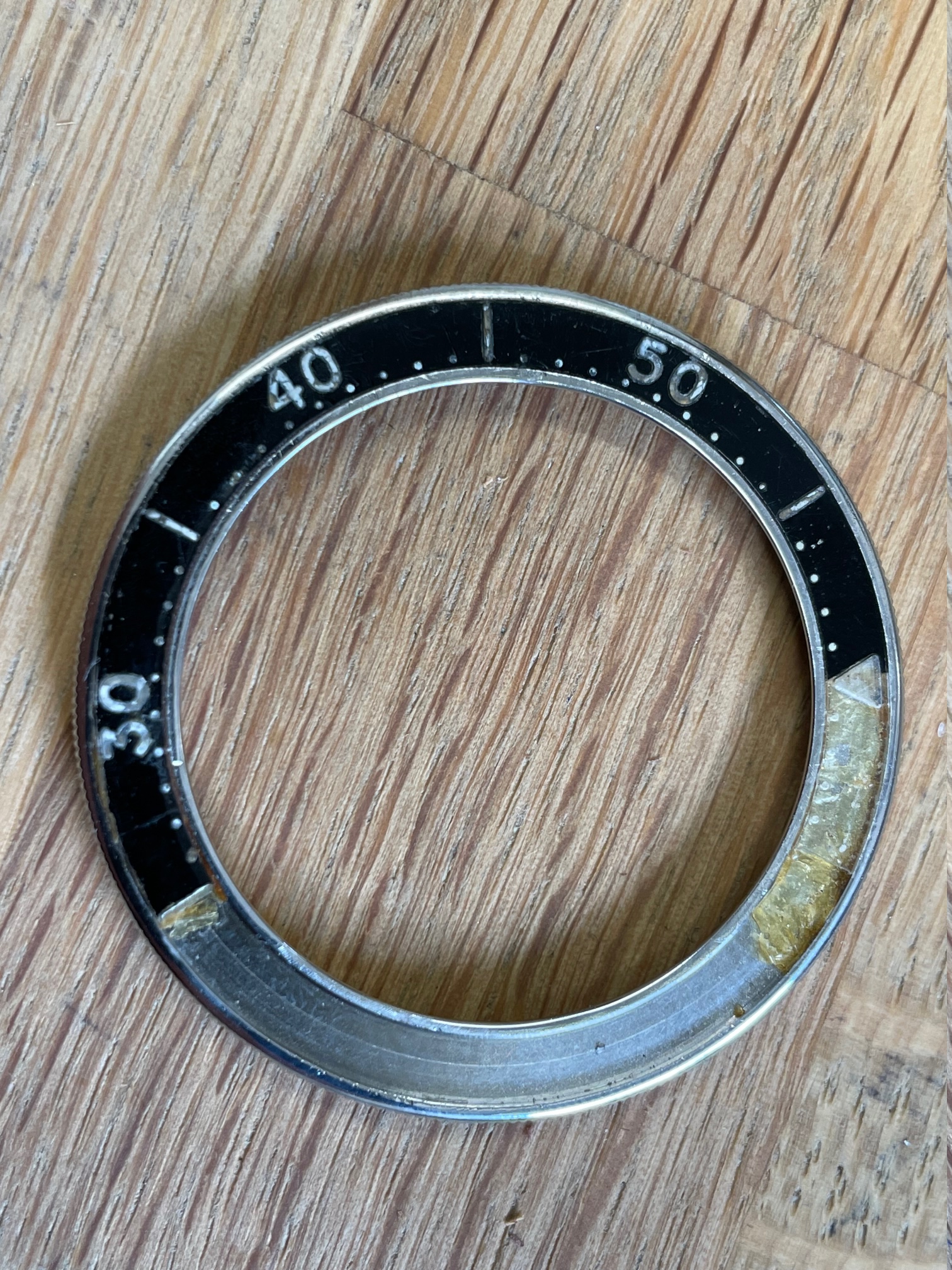

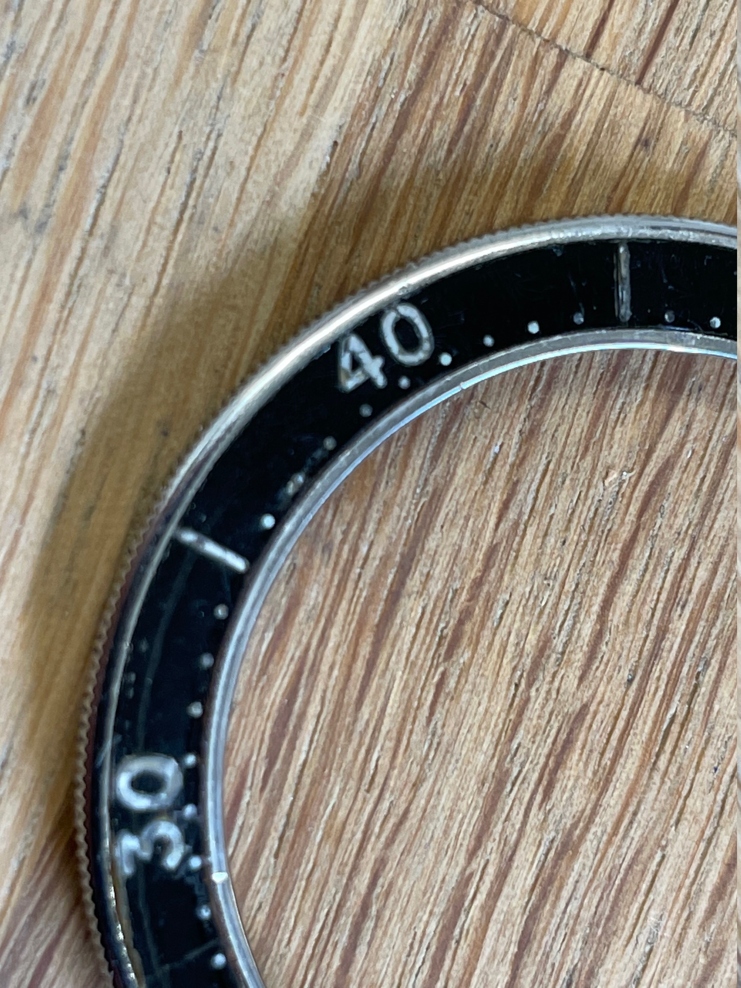

The bezel with insert looked like this:
The insert was totally missing from 0-20min => easier to just make a new one.

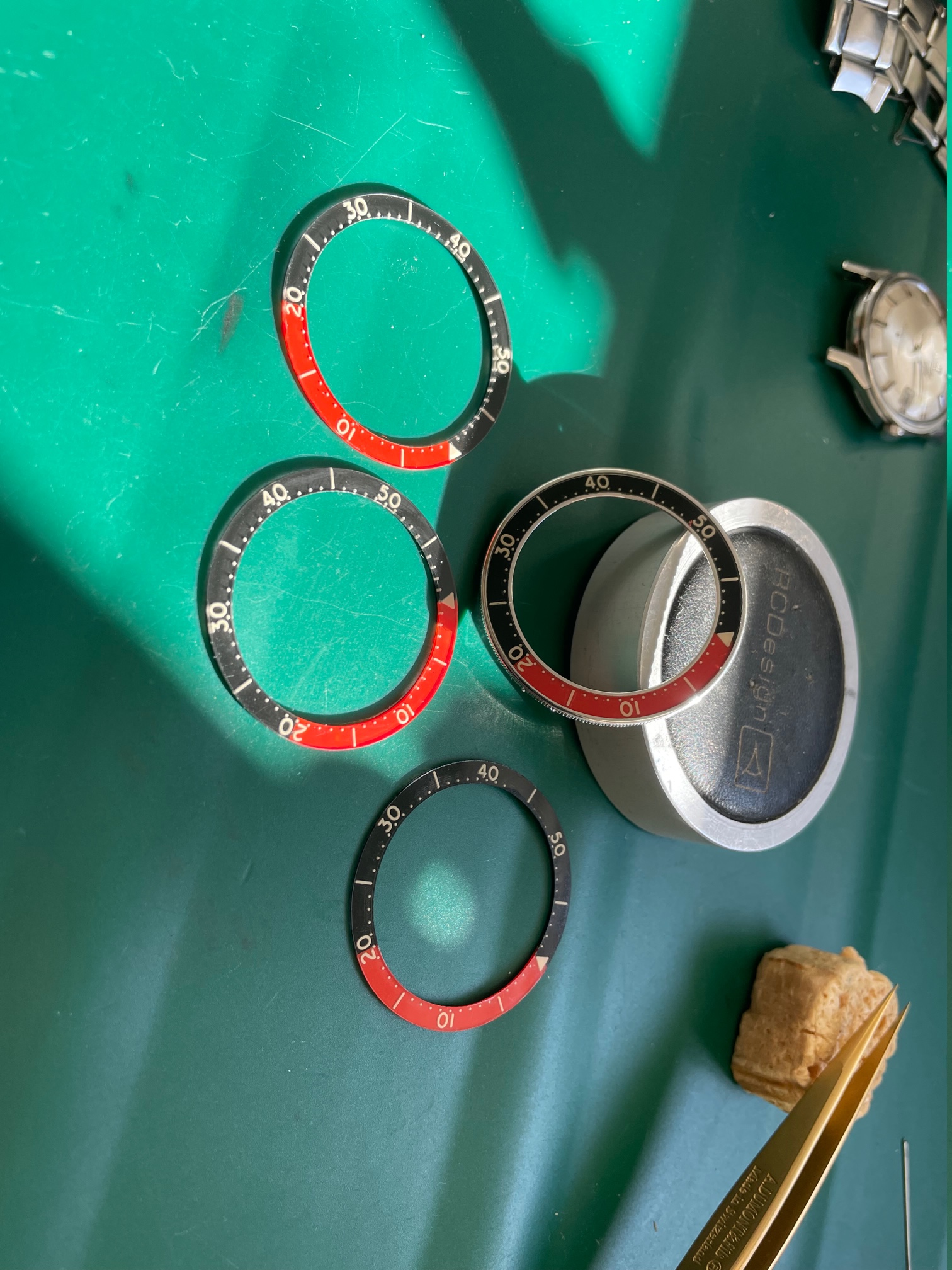

Here are some of the tes tversions:
It's a "simple" font, single stroke, so I taught it would be easy, took abt eight inserts to get tings right! 馃榾

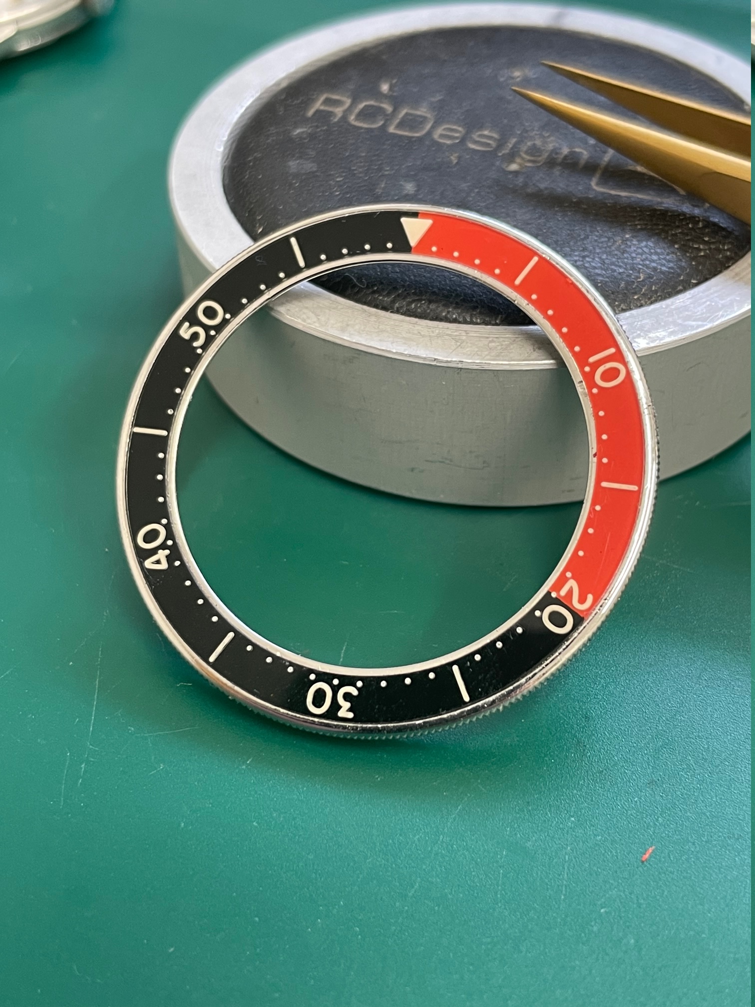

And here is the final version:
