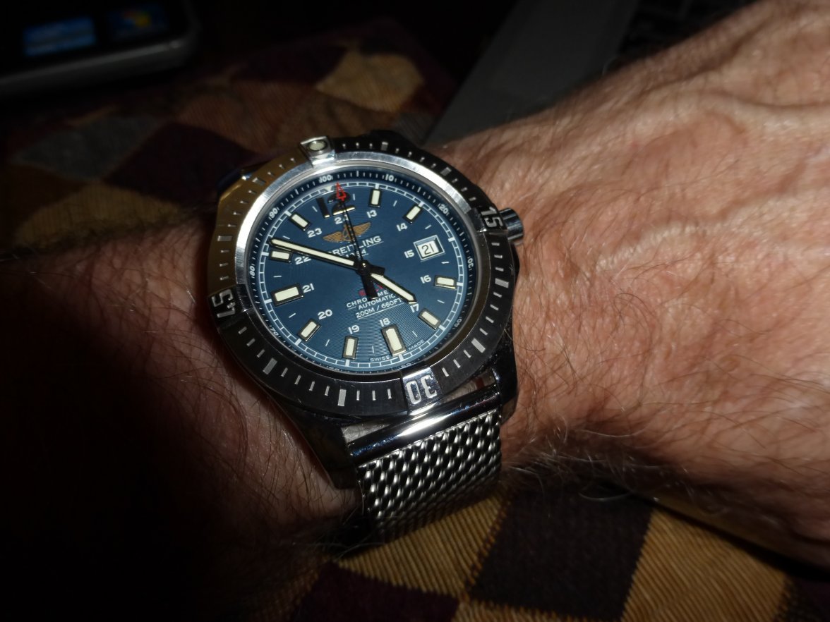

    I found the Jeweler and was stunned by the new Breitling Colt and settled on the marine blue dial (the color of the bay at Cozumel...REALLY!) Pretty, do-it-all, and they threw in a matching blue leather Breitling strap...all for more than double the discount of my AD back home! I was nervous at spending the cost of the cruise on a watch, but I could not let that deal slip through my fingers...7-7-15.

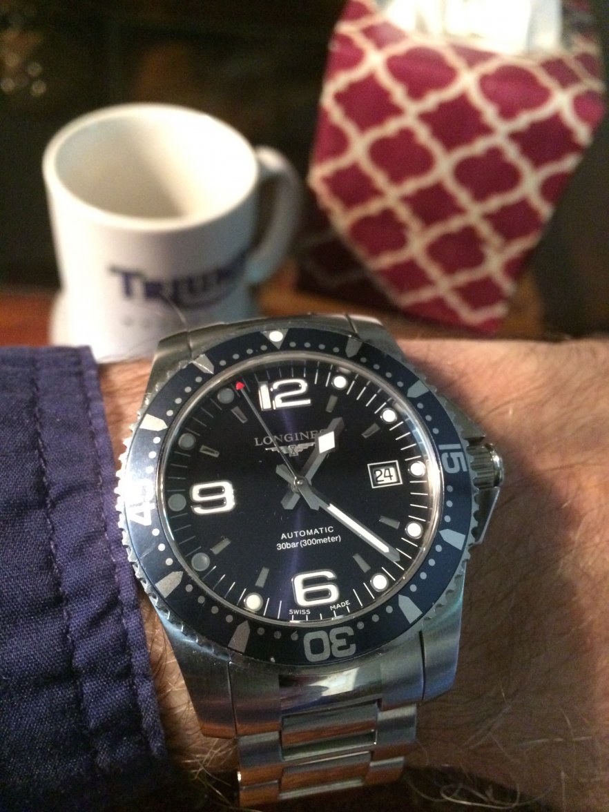

    So here I sat after vacation with a Longines HC with cal. L633 (based on 2824-2) and Breitling Colt with cal. B17 (based on 2824-2). What better thing to do than to test them against each other under a variety of conditions? (within reason). The Colt (COSC) and the Longines (not COSC) head-to-head data collection was on!
    Preliminary timing studies July 15-20 indicated:
    Longines HC varied from (per day, 24 hrs) 1 sec fast, to 2, to 3 secs fast, to 1 sec slow per 24 hrs. (and a few numbers in between) AVG. = 2.25 sec fast per day. COOL!
    Breitling Colt varied from +5 secs fast to +12 secs to +2 secs per day.
    The Breitling varied past COSC, and I thought it not so good that a watch more than twice the price and COSC certified should perform less consistently than my Longines, not COSC.
    I was told and had read that magnetism could cause a watch to vary significantly and was advised to see if the Colt was magnetized, if so, get it de-magnetised. (Especially if I went through any metal detectors on the cruise) Off I went to the one person in DFW that the Jeweler (AD) knew who was trustworthy and could do this. The deed was done and the Colt seemed to behave for a bit.

    I shipped the Longines HC to the hospital via the AD (Longines warranty fix place) in early April 2016 and when it returned it ran and continues to run (worn) +1.85 to +2.58 s/day. Mode is +2.08 s/day...to this day. Generally +4 s/day on winder...+2 s/day worn active.
    I shipped the Breitling Colt to the hospital via the AD (Breitling warranty fix place) April 25, 2016 and it returned 17 days later. (!!!fast in my book!!) Now runs worn +2.7 to +3.7 s/day. Winder = +4 to +4.5 s/day. I need more data on this one, but I have little doubt it will settle into a high +2 s/day fast.
