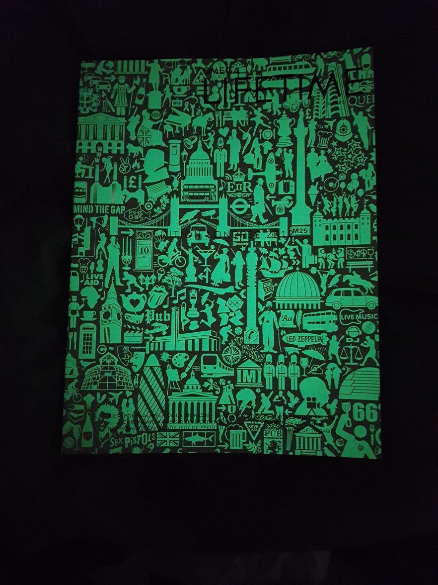

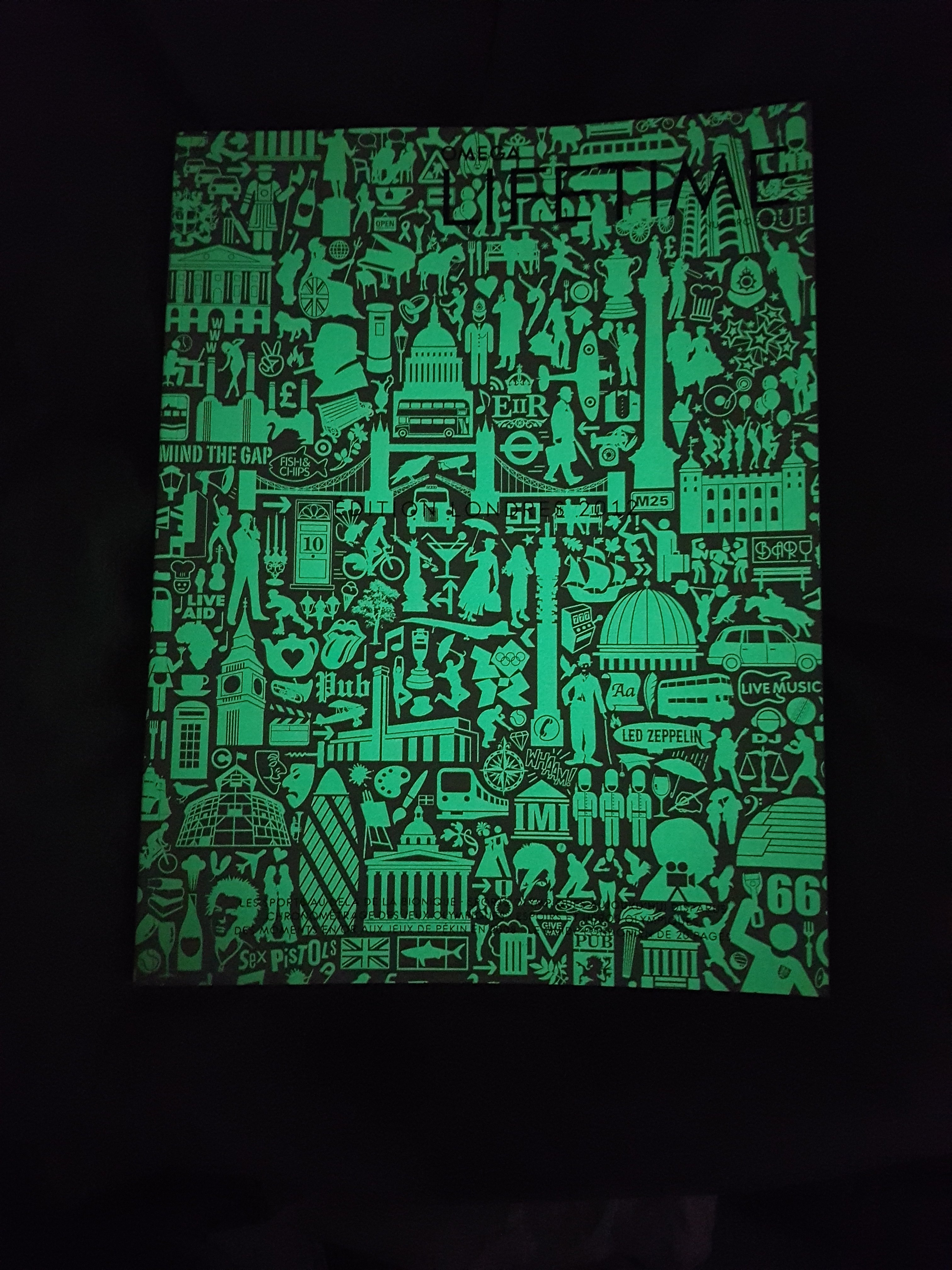

1,889
2,285
Speaking of lum, a cool edition of "lifetime" dedicated to the olympics in London 2012 馃槈
