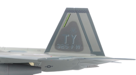

I am in the process of purchasing a couple of 1/72nd scale aircraft models, and they have painted replicas of the formation lights. These lights glow green and are electroluminescent, operated via a rheostat to vary their brightness. I have never worked with lume powders at all, and was curious if you guys who have think I could apply some to these areas to replicate the actual glow of the formation lights? If so, what's the best type to use and application method?
Here's an example of what the lights decals look like on a model (F-22), the small green strip at the top left of the vertical stabilizer:
