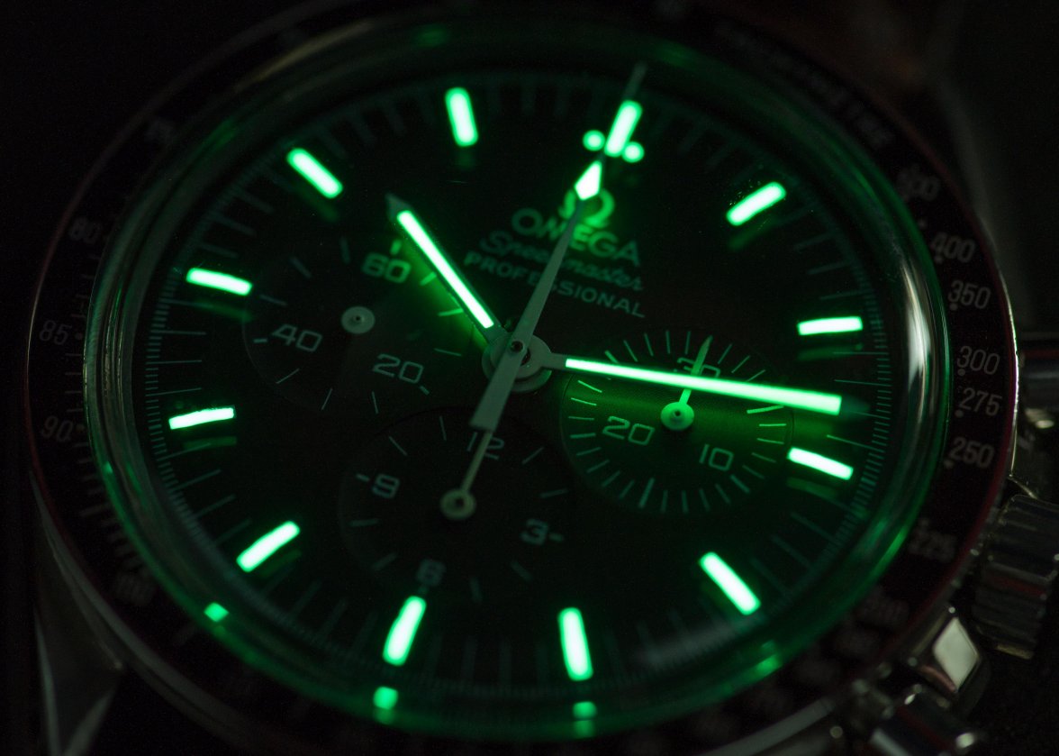

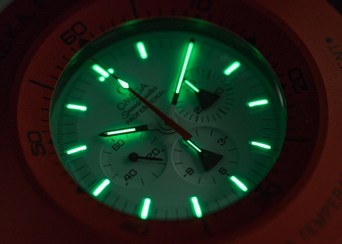

    blast it with a good amount of light, turn off all lights in the room, then max out your shutter speed to be as long as possible to compensate (remember to use a tripod)

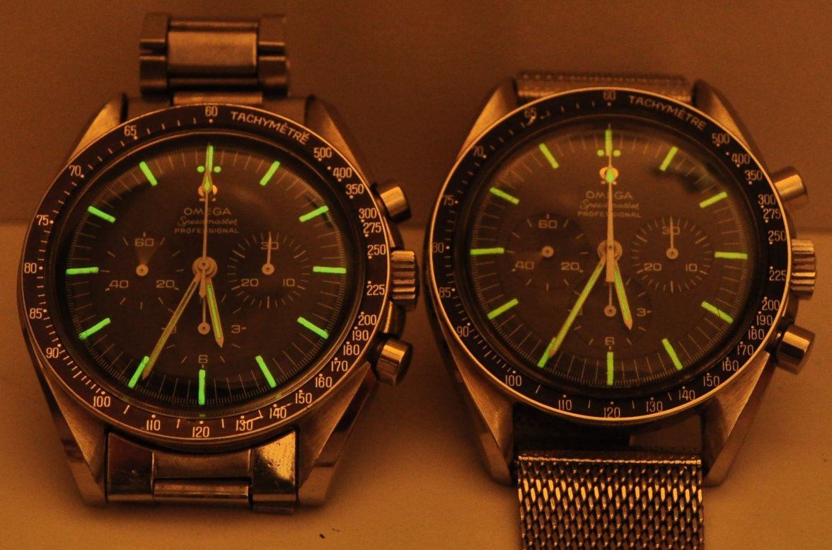

    here are some examples I have taken:
  9. BillLundberg Jun 26, 2017
    188
    266
    Awesome lume shots! I'm going a have try it myself now.
    josephgsy likes this.
  10. josephgsy Jun 26, 2017
    295
    408
    Thanks bill! only issue with shooting the way i shoot is that the minute hand leaves a light trail behind as it moves slowly, the only workaround to that is if leave the watches unwinded

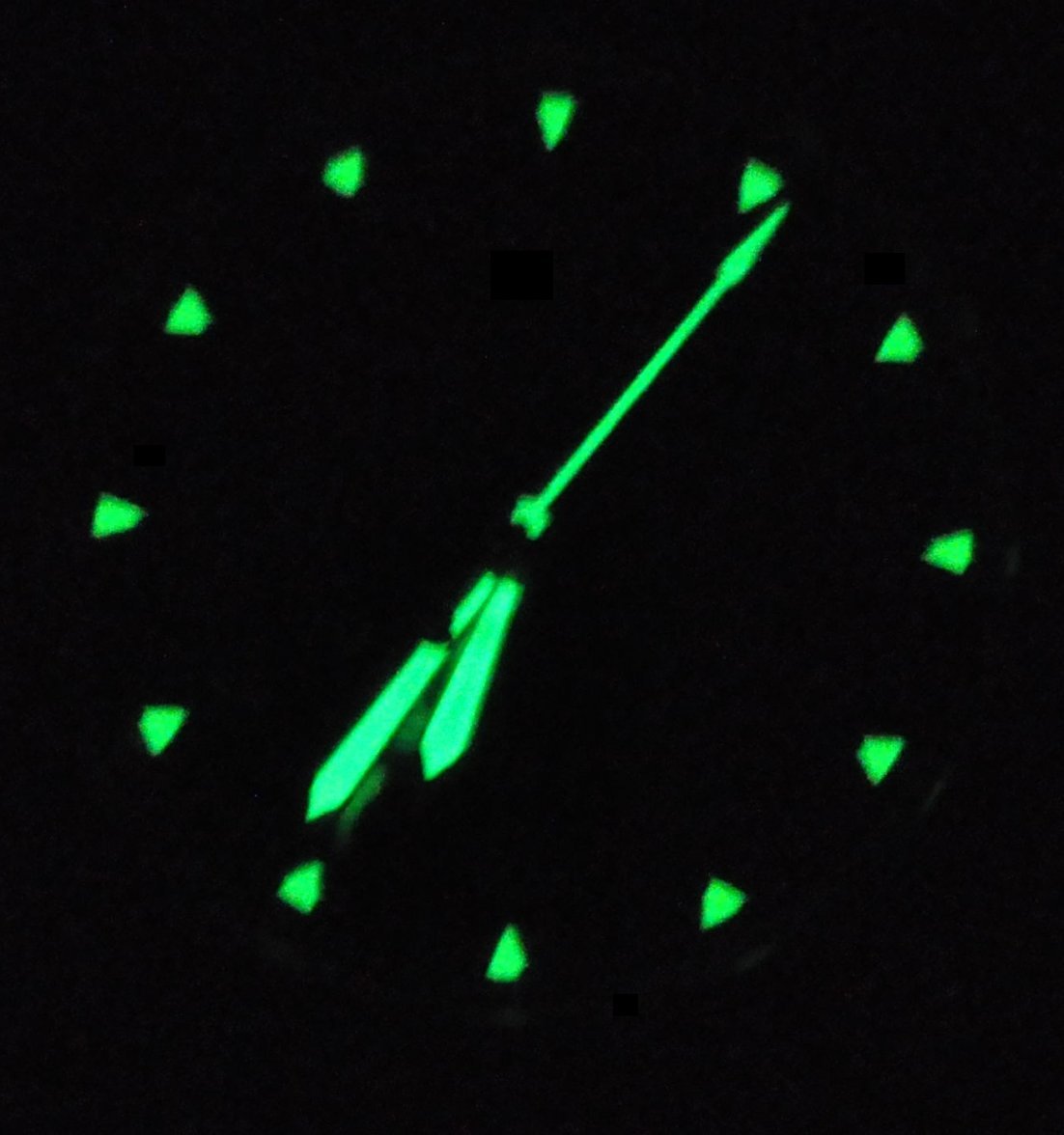

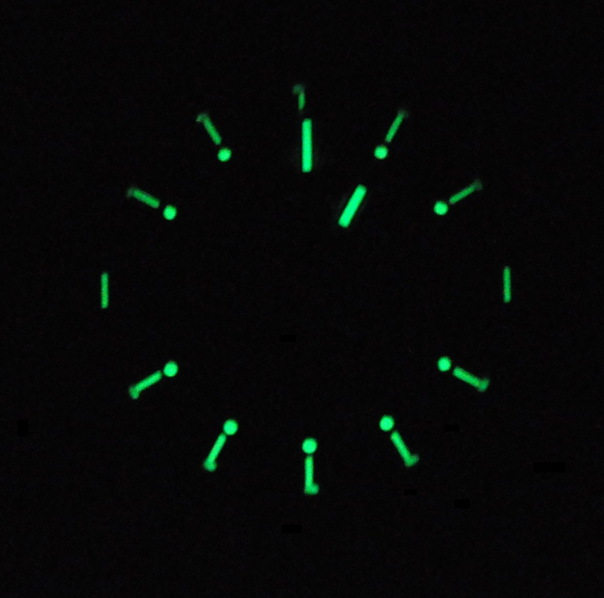

  15. Seaborg May 29, 2018
    1,533
    3,582

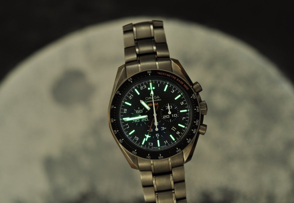

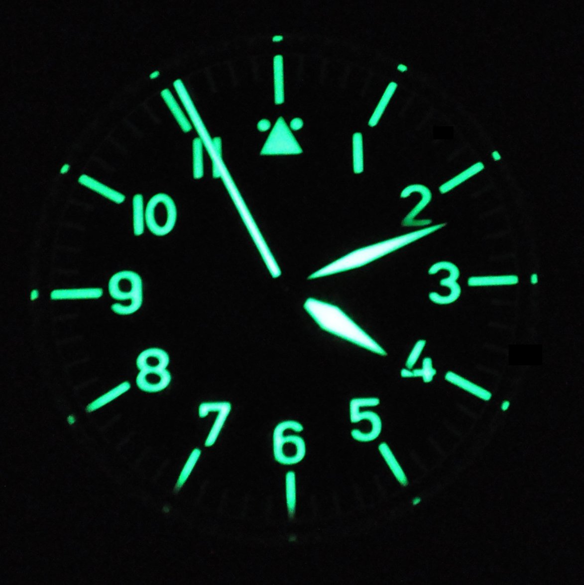

    As @josephgsy said, strong light exposure and successive lume shot (especially with aged tritium dials).
    Sorry, some pictures are blurry...

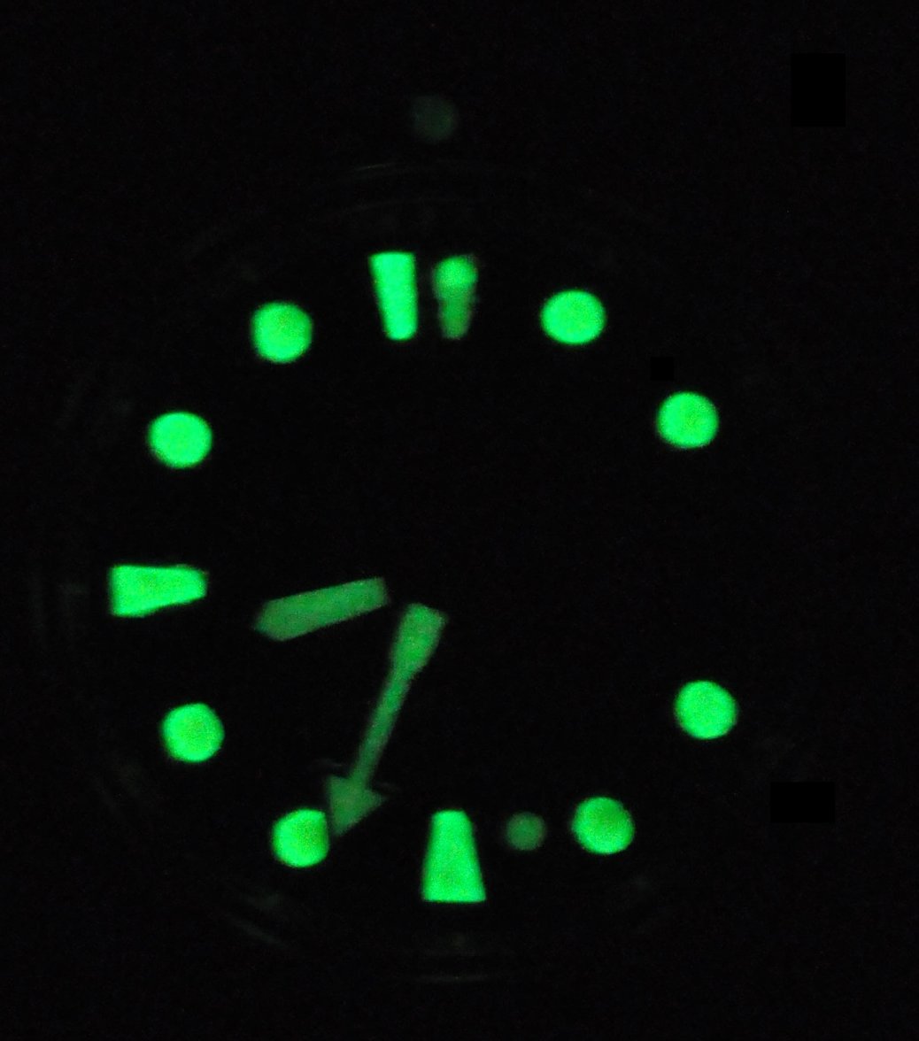

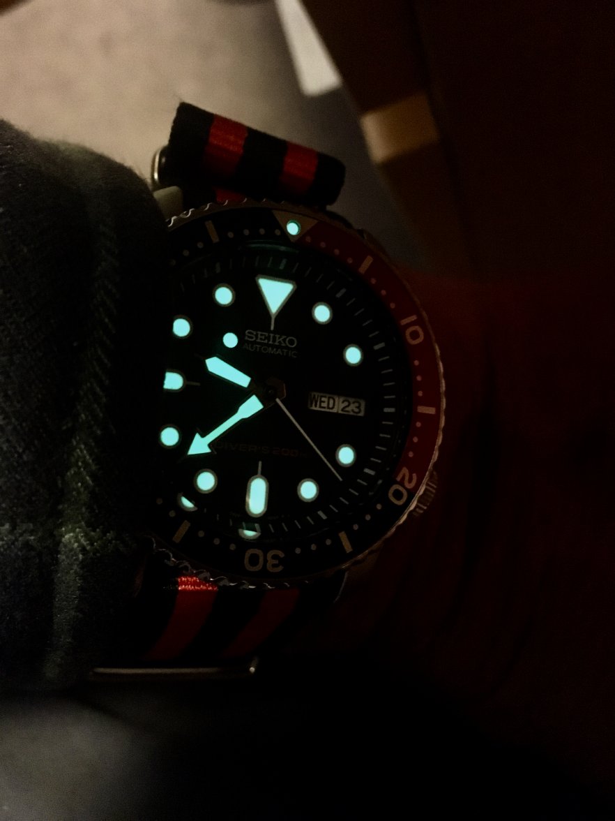

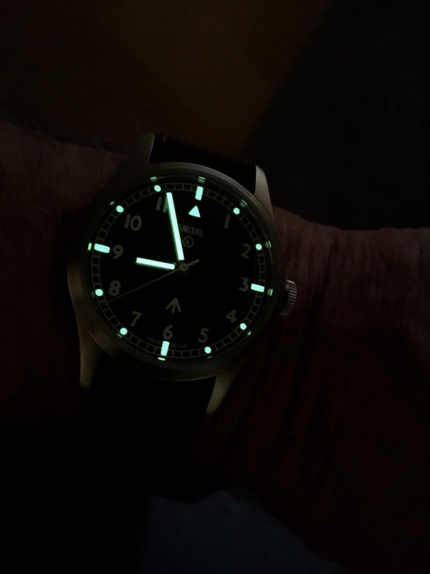

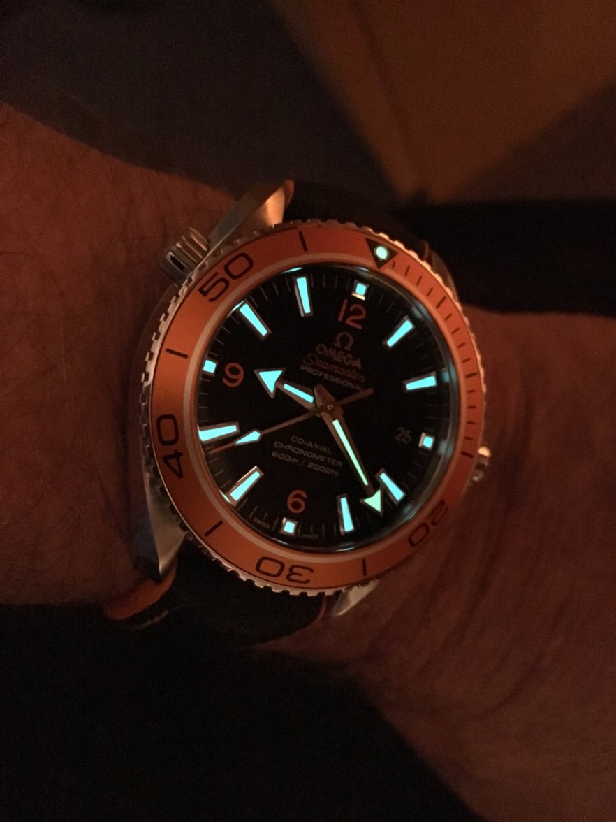

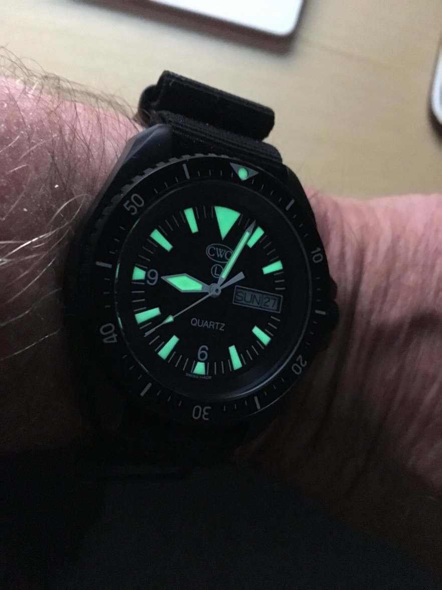

  16. Alpha Kilt Owner, Beagle Parent, Omega Collector May 29, 2018
    16,100
    142,267
    iPhone 6 not to shabby,
    josephgsy and Seaborg like this.

  18. Seaborg May 30, 2018
    1,533
    3,582
    Thanks.
    Nope, with a Nikon D5000 with a 18-55 mm lens (without a tripod explaining the blurry effect of the pictures).
    :thumbsup:

    I had a play around yesterday. I made it quite dark by almost completely closing the blinds, then played with shutter speeds and apertures until I got the depth of field and exposure that I wanted for the watch and background. Then a blast with an extremely bright light to get the lume glowing, then light off and photo taken. It was a 30 second exposure hence the disappearing running seconds hand.
    I think lume shots are much nicer when you can at least make out the details of the watch besides just the lume and complete darkness, and if the dial seems to be lit solely by the lume (like in @josephgsy ’s epic picture of his Alaska Project above) then all the better :thumbsup:

    probably would get much better shots with a tripod, longer exposure and some colour correction ;)
