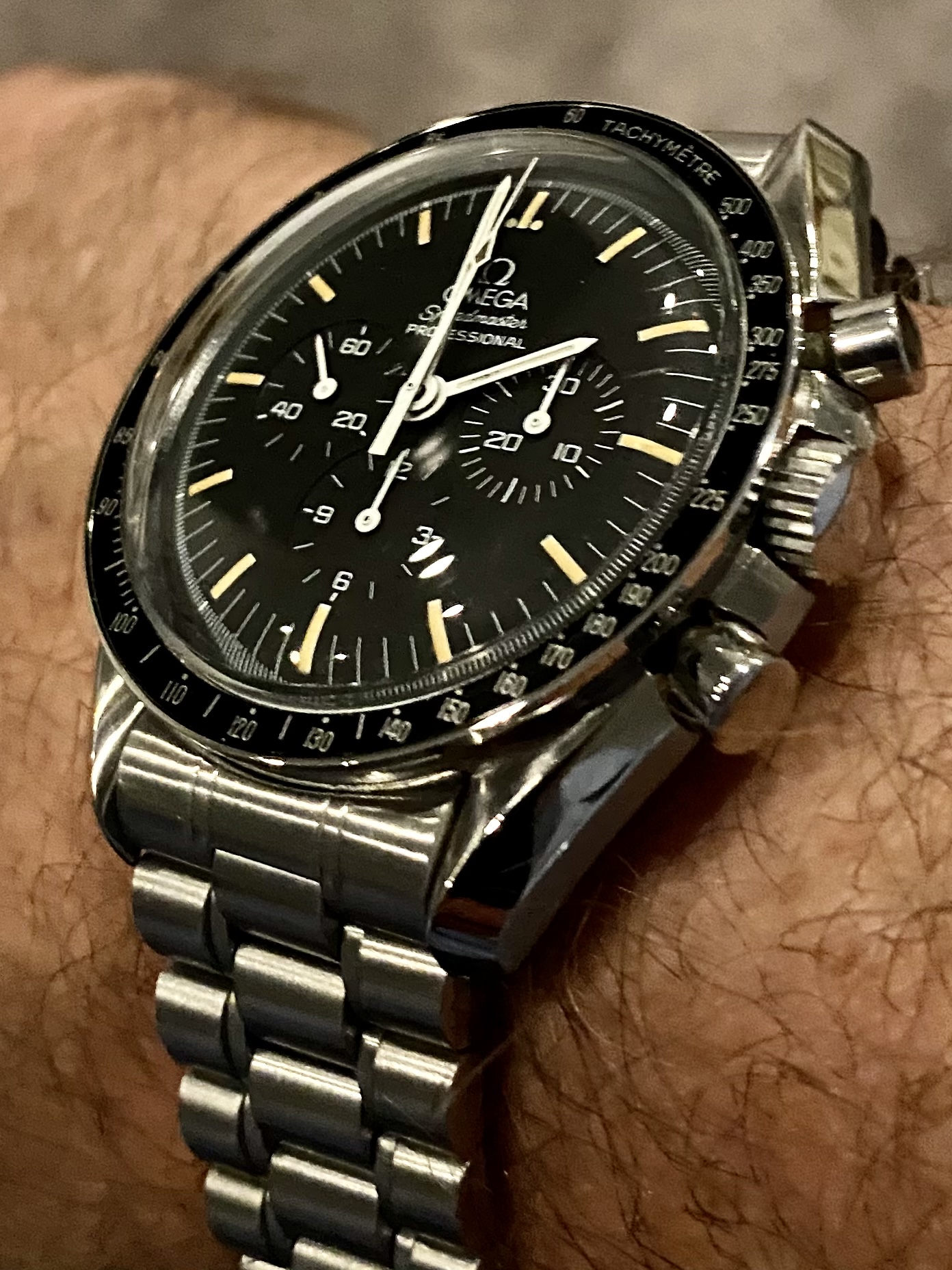

I have a question that I've been wondering for a while: how much if any lume do the Tritium lumed markers/hands actually give and how quickly they lose their lume? Are for example the 60-70s watches completely lumeless or is there still something? What about the 80-90s watches?
The discolored warm tone Tritium markers sure look nice, but there is something nice also about the lume actually working: my less than a year old Speedy begins to glow even in daytime shadows and I must say, I really like this about it. Plus, I have played with the thought that which is closer to the "astronaut experience": having the "original" Tritium lume that they had, even though their experience was probably with a fresh more or less white look (not yet discolored) and actual dark time glowing...
I'm not sure there is a real point to this post 😀 Perhaps I'm just trying to work out for myself, whether I should also jump on the patina train or appreciate the non original material, but original look and functionality of the new superluminovas...

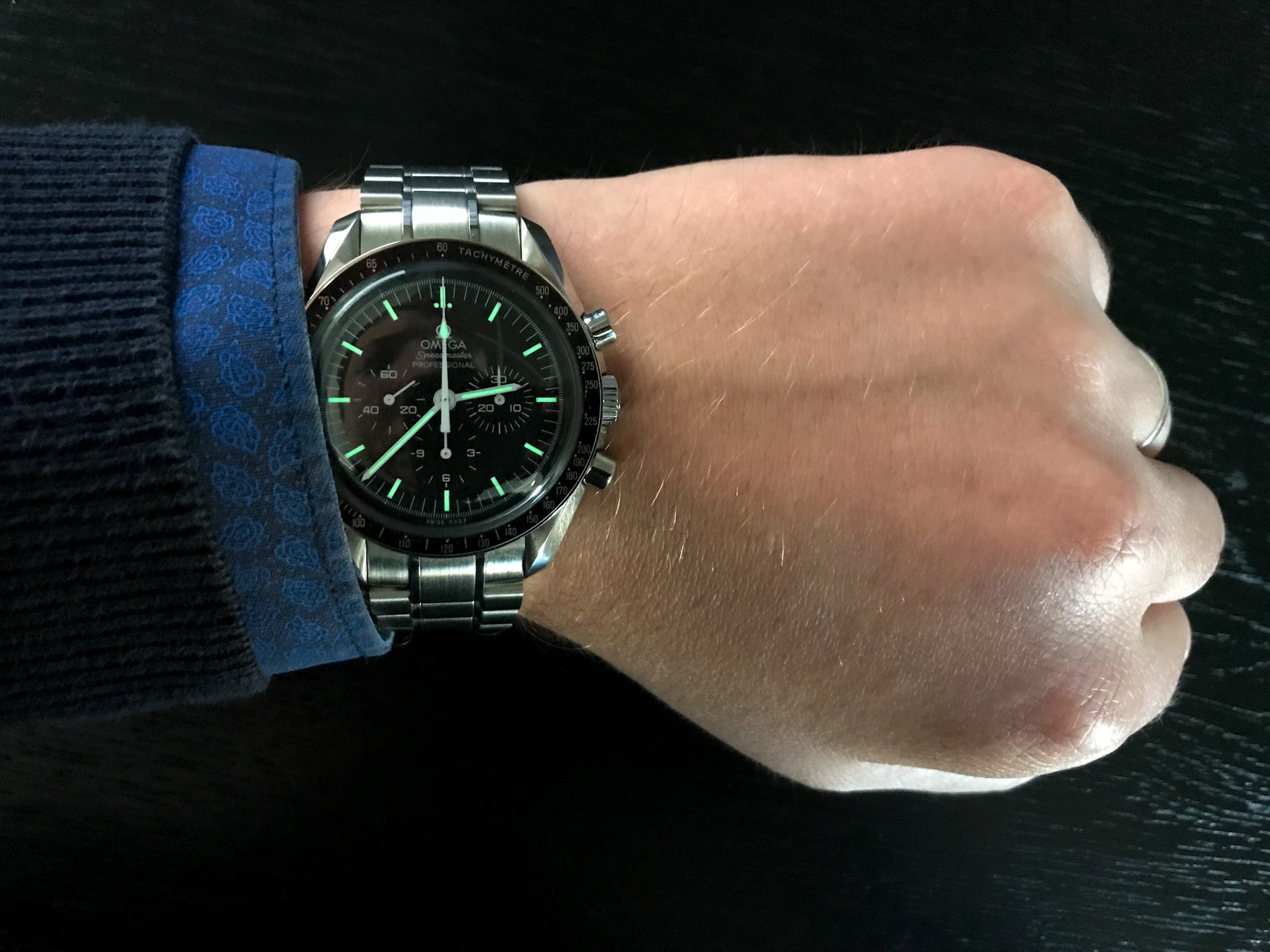

And trying to explain the daylight shadow lume, I meant something like this. Just came from sunny outside into my office:

Aside from all the technicalities on how long radium and tritium lasts, it will not produce what you called the "shadow lume" effect.
At least my tritium watch (from Ball) doesn't. Its a constant level of glow that isn't affected by anything other than the slow decay of the tritium itself. Its also not a glow that is visible in a lit room.
