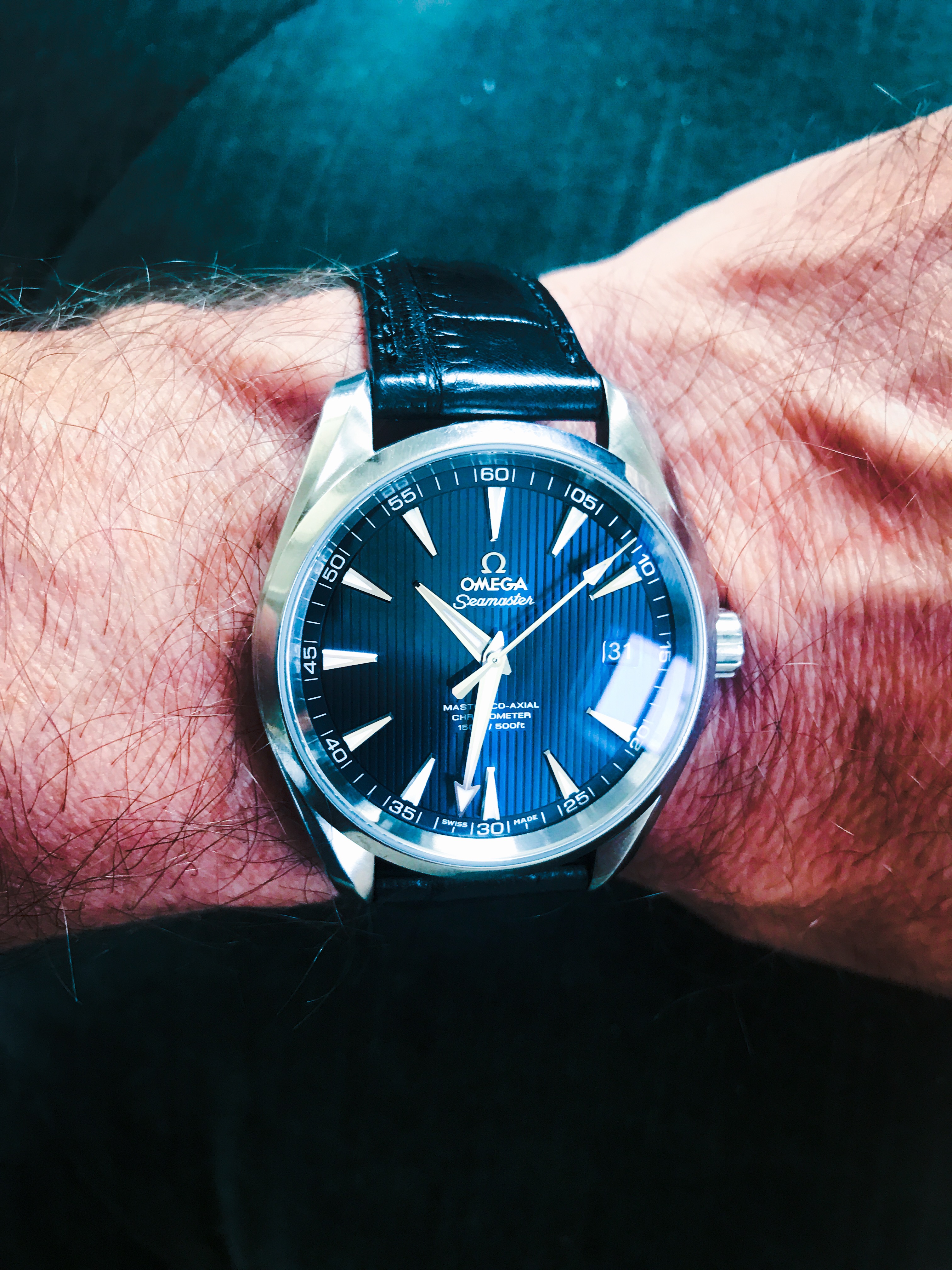

The skyfall is the non Master C 38.5 Version while in specter he uses the 41 mm master C. The differences are on the movement, Date window (framed versus non framed) and size.
48
7
That is a good looking piece! I just ordered the 38.5mm version. It is more proportioned thab the 41.5mm for me. How big is yout wrist?
