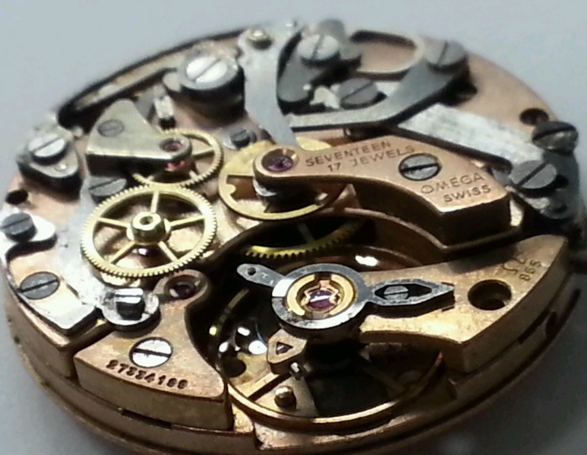

    Just bought this movement, it was on ebay but made a side deal for $210 not bad at all, thanks for your help guys. chronostop.JPG chronostop 1.JPG
  13. Archer Omega Qualified Watchmaker Feb 21, 2015
    26,464
    65,607
    Rough shape - hope the staff isn't rusted...

    How do you now that the hairspring is ok on that movement ? There is no screw in the balance cock ? So somebody has worked on it ?
  15. Joe K. Curious about this text thingy below his avatar Feb 21, 2015
    1,648
    2,100
    The movement has been cannibalized and is missing a number of parts including the balance cock screw, the pallet fork and the pallet bridge. Hopefully the parts you need are in good condition.
