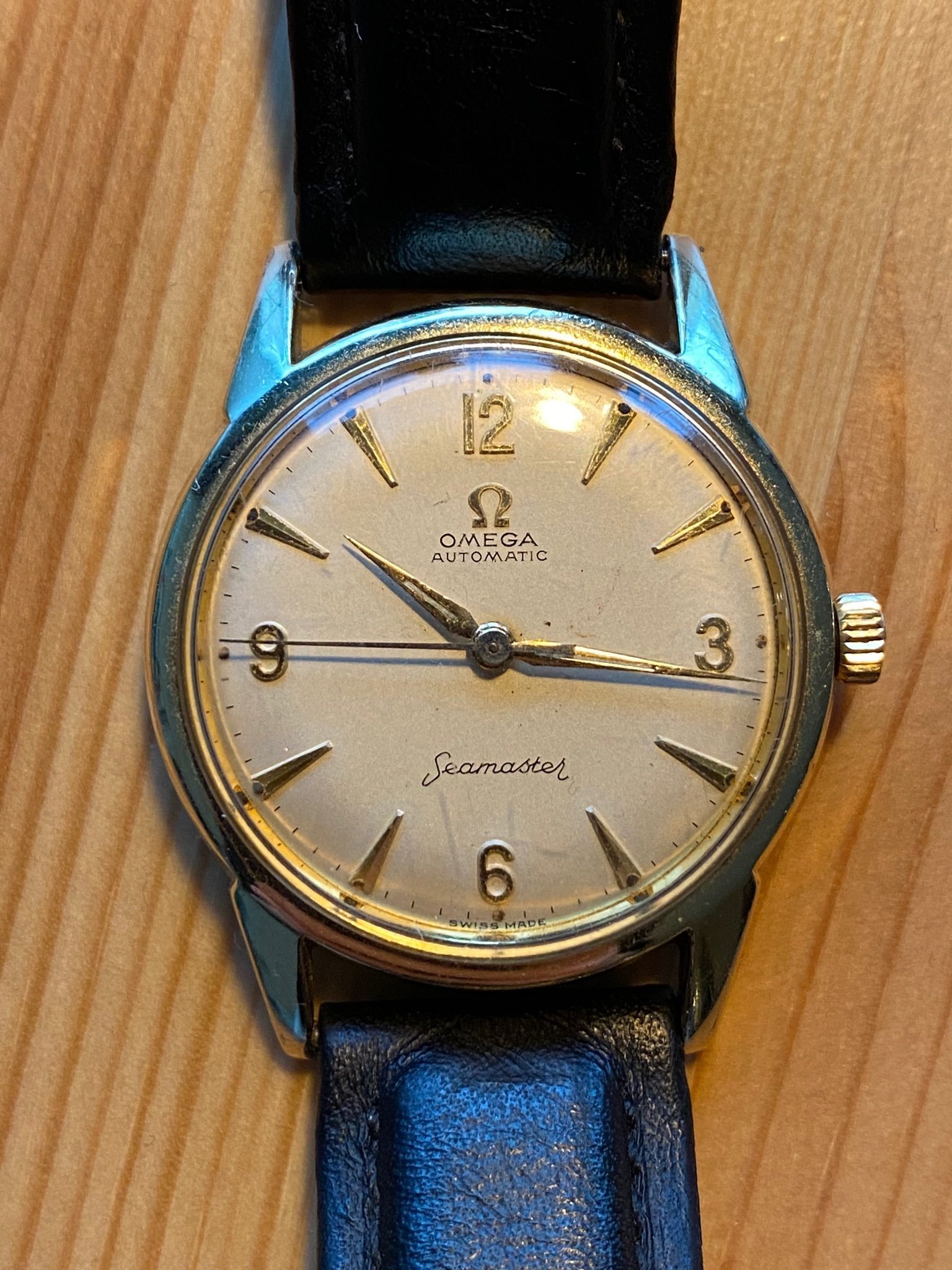

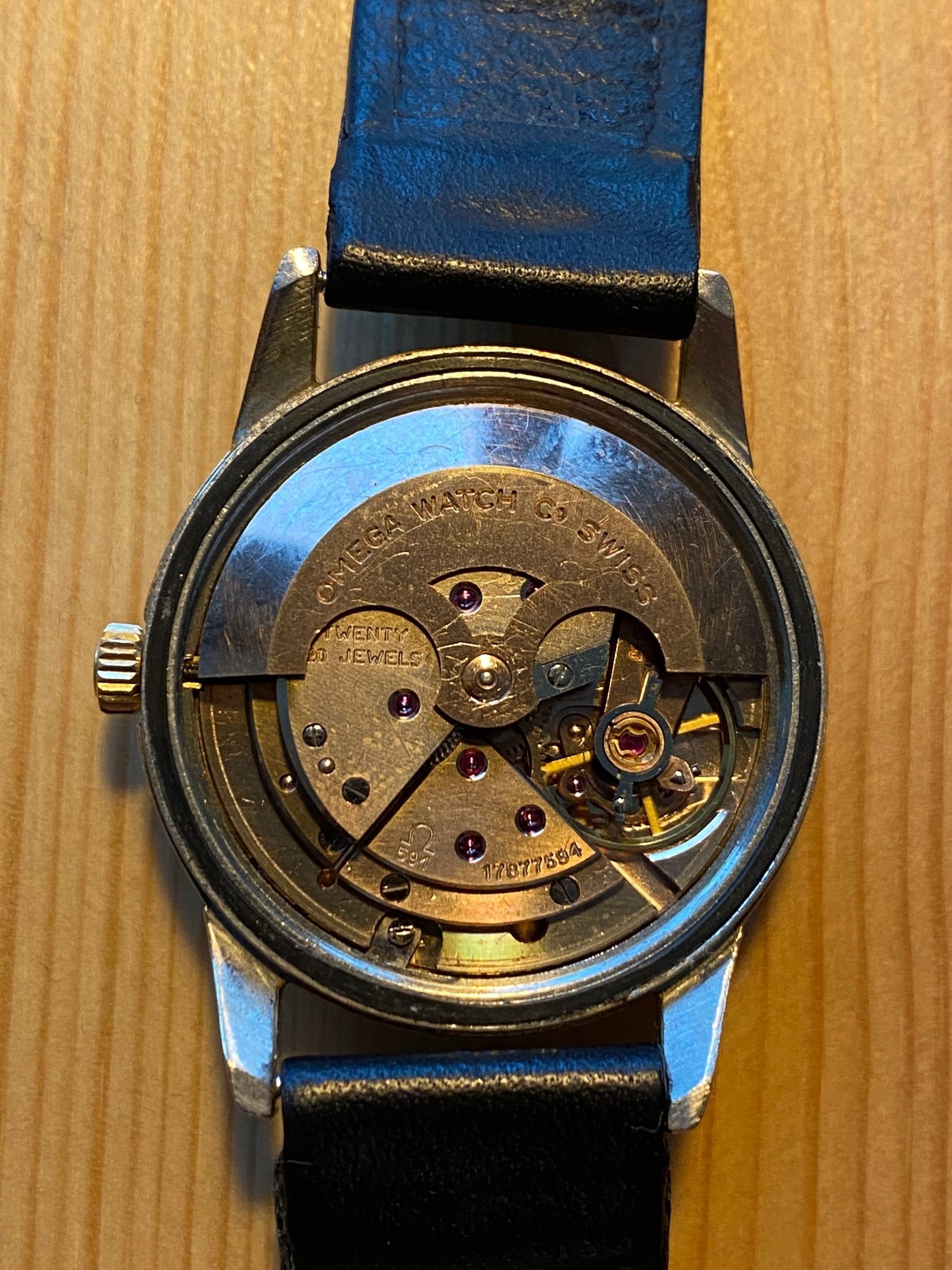

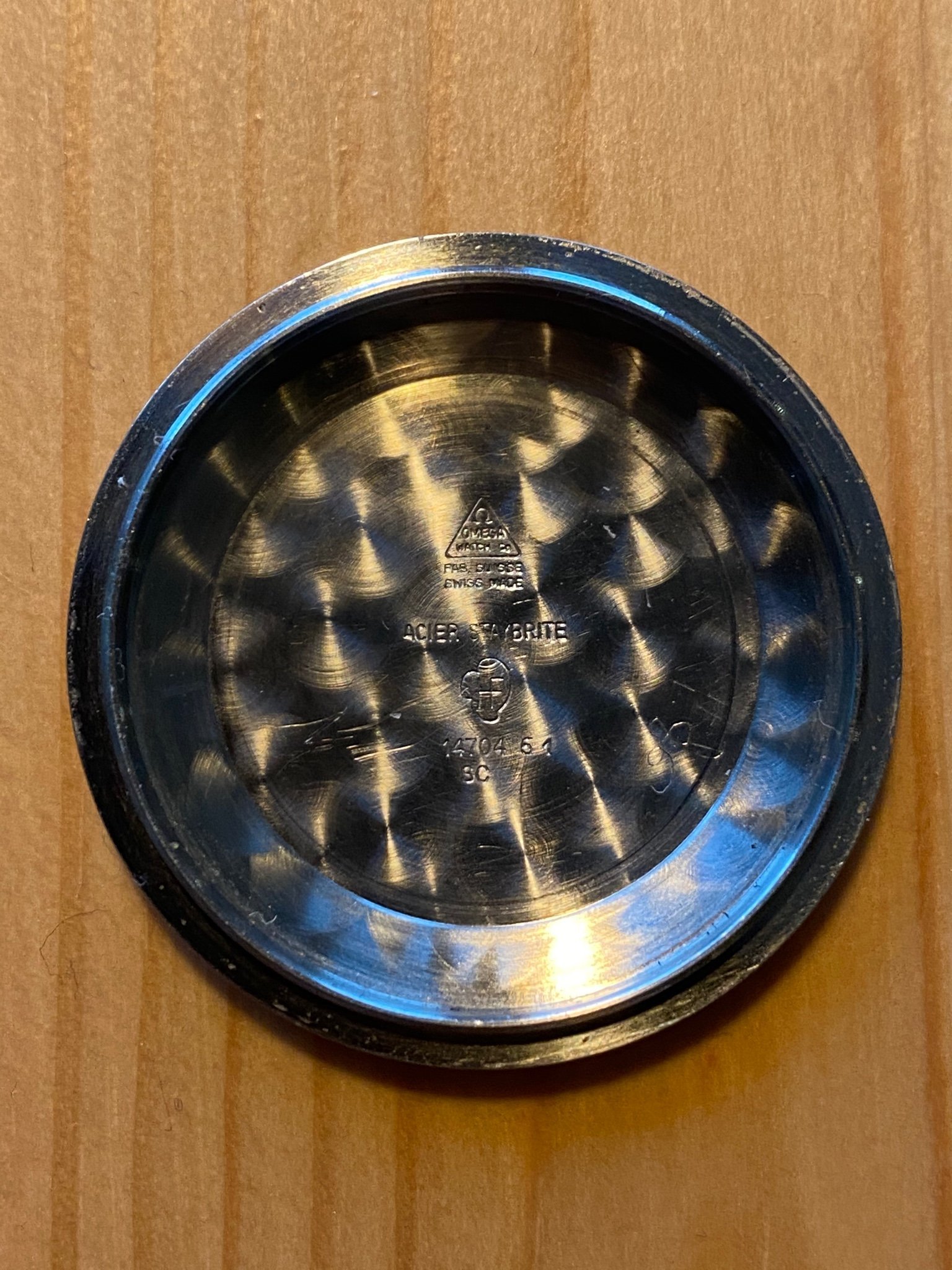

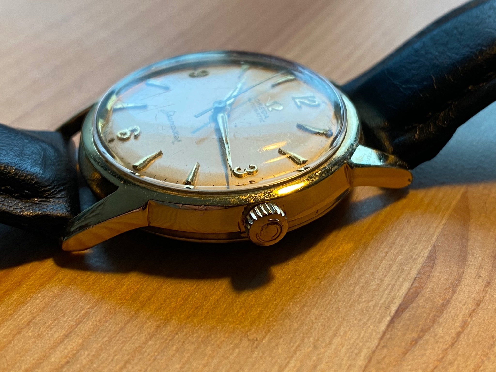

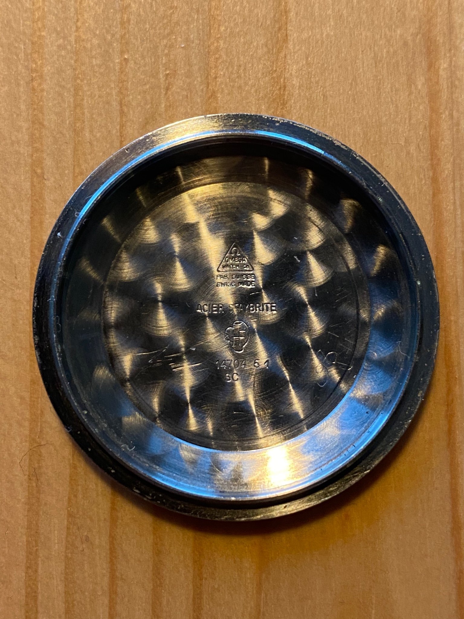

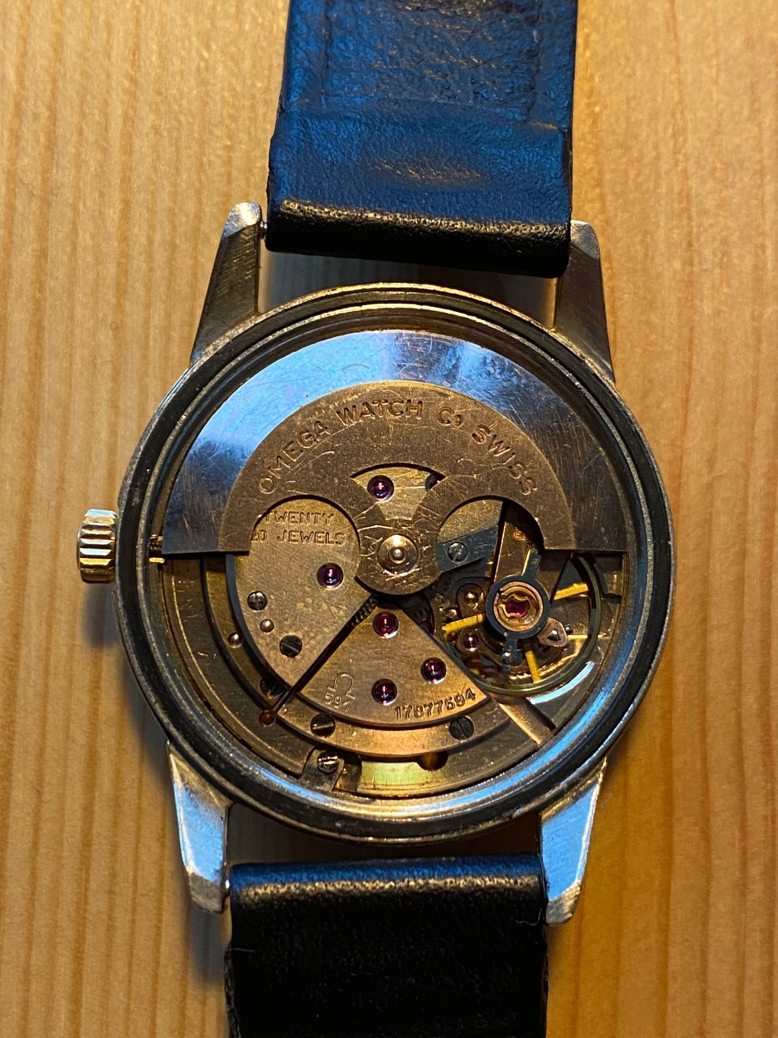

looking at a seamaster 14704 cal 591 with worn rotor
69
80
aparently the rotor is worn and it makes noice when winding, is it servicable for a decent amount of money?
otherwise the watch looks good maybe a bot polished? what should the price range for the watch be with such a fault?

Pinion for the rotor is available from Omega, so of your watchmaker has a parts account, they can order it. If they don't, then they would have to find it somewhere on the open market.
Keep in mind that the cost to service and repair these has little relation to what the watch is worth. In my experience watches where the rotor pinion is worn, tend to have been worn a lot without service, and can need many other parts replaced. The pinion alone is about 30 Euros, and if you start adding in a bunch of other parts that might be needed, that cost the same or more, it won't take long before you have nothing left to cover the labour. 200 Euro is low for an expected service cost on this watch in my view.

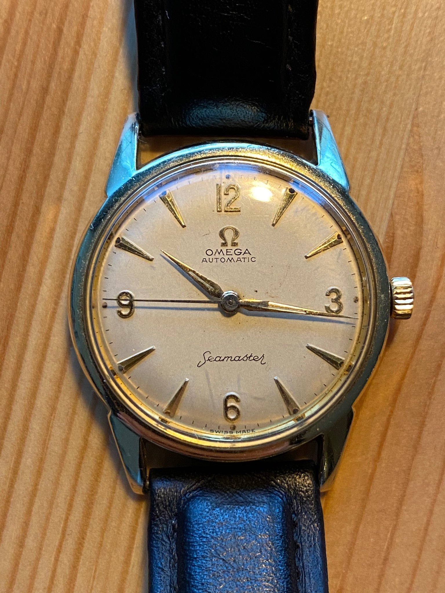

ok so what is a resonable price for this one at this point it works as is, and to me in a honest state. some markings service maybe -98?

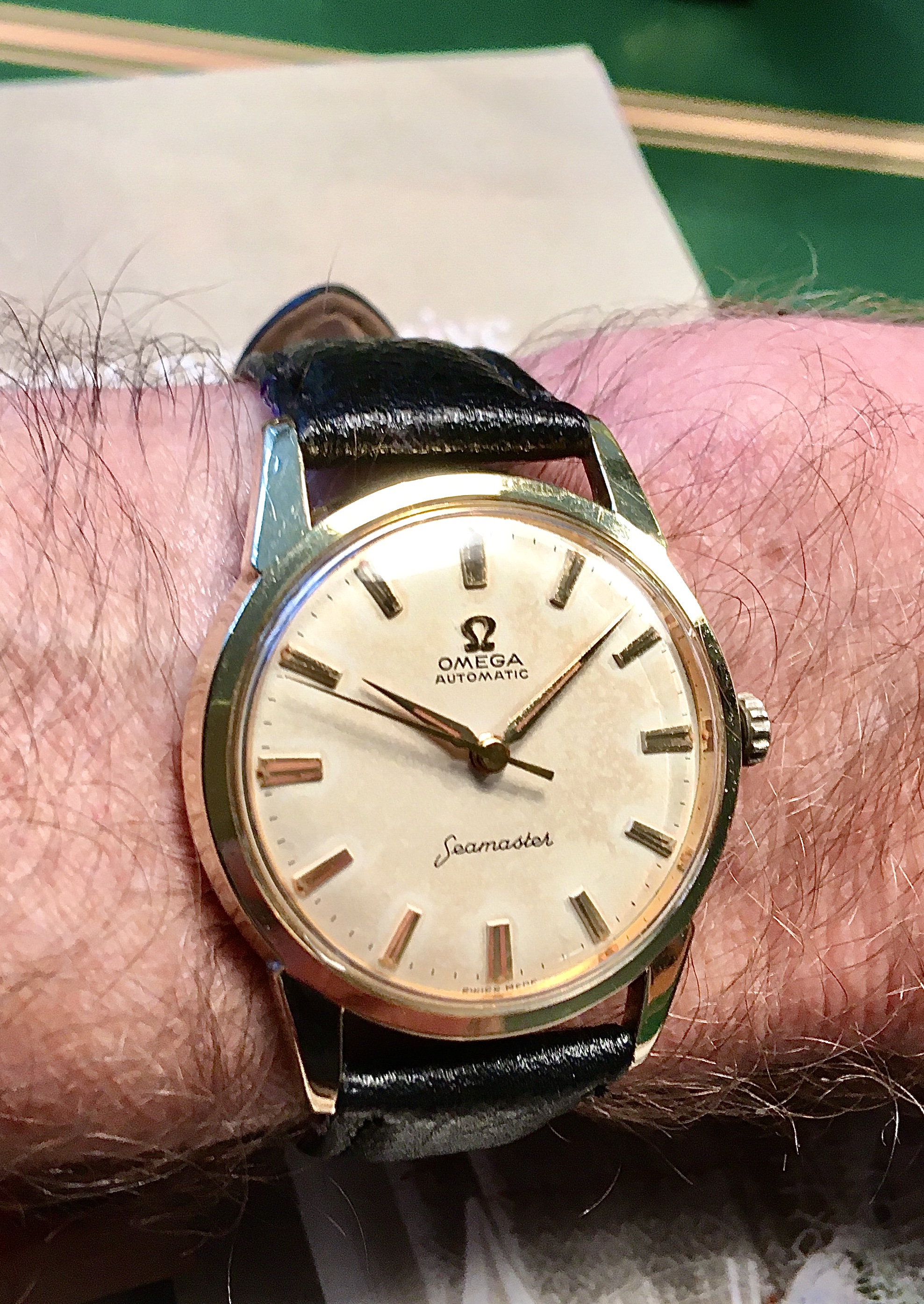

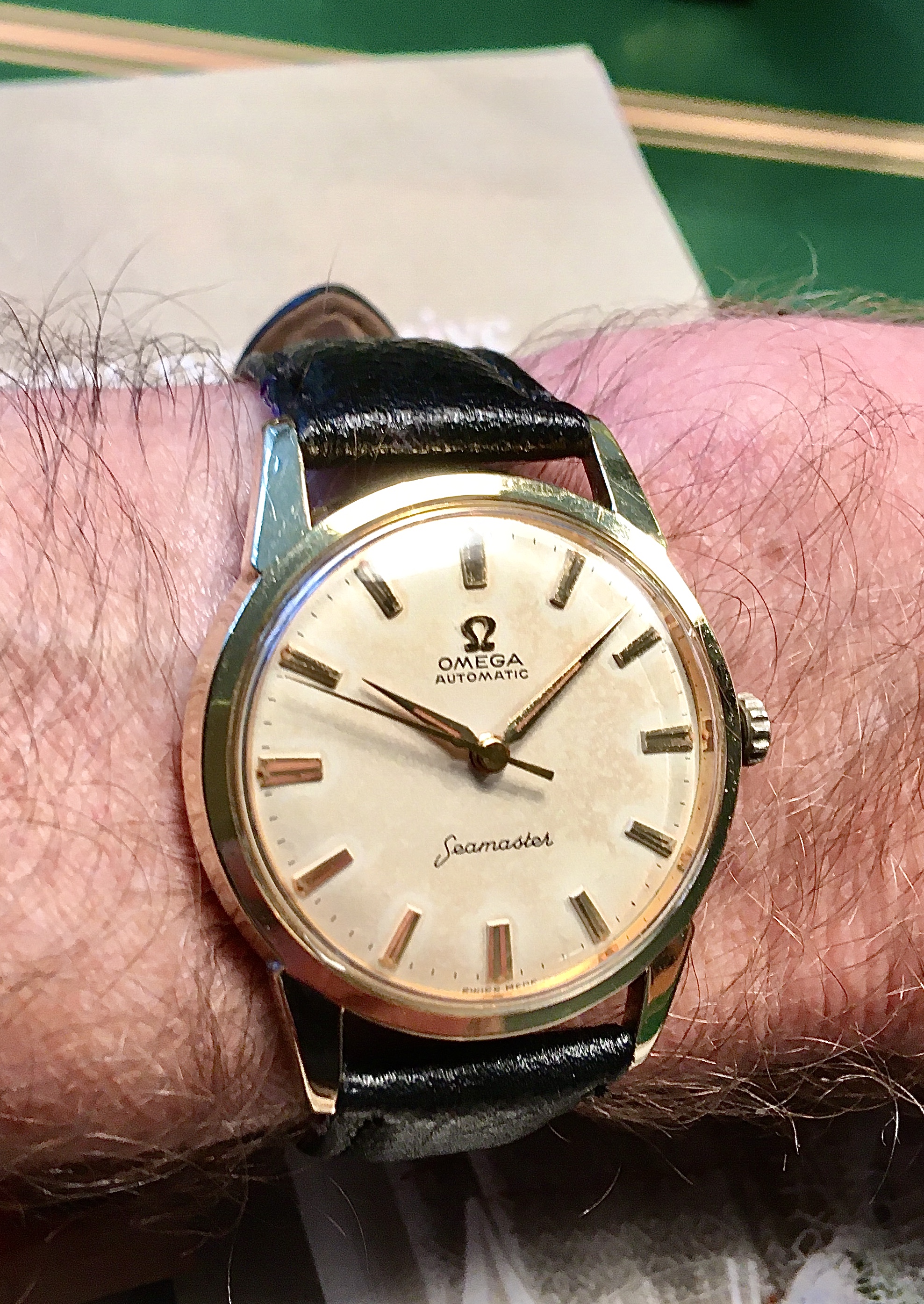

My 14704 with a 591 movement, bought on eBay for £400 two years ago

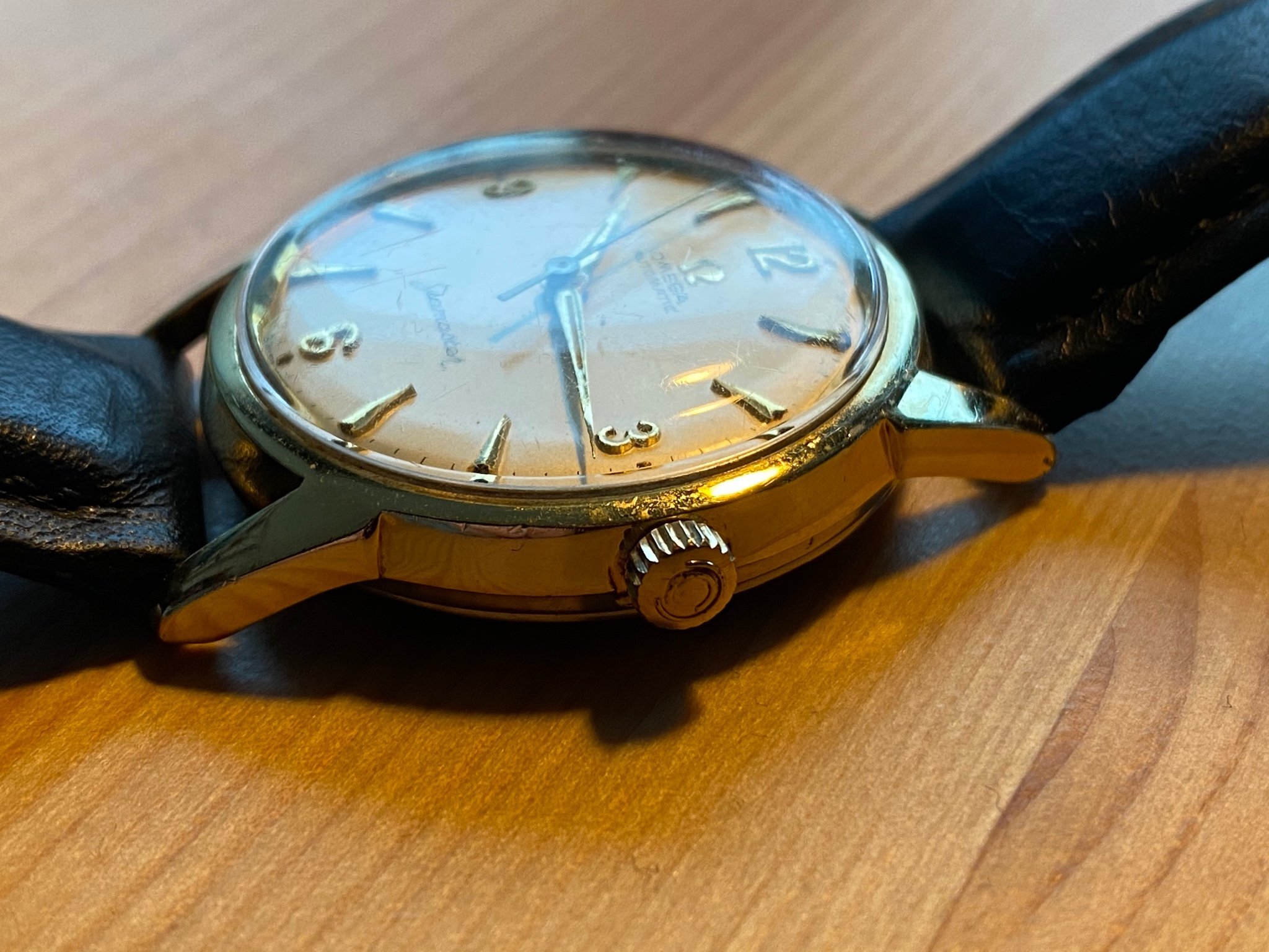

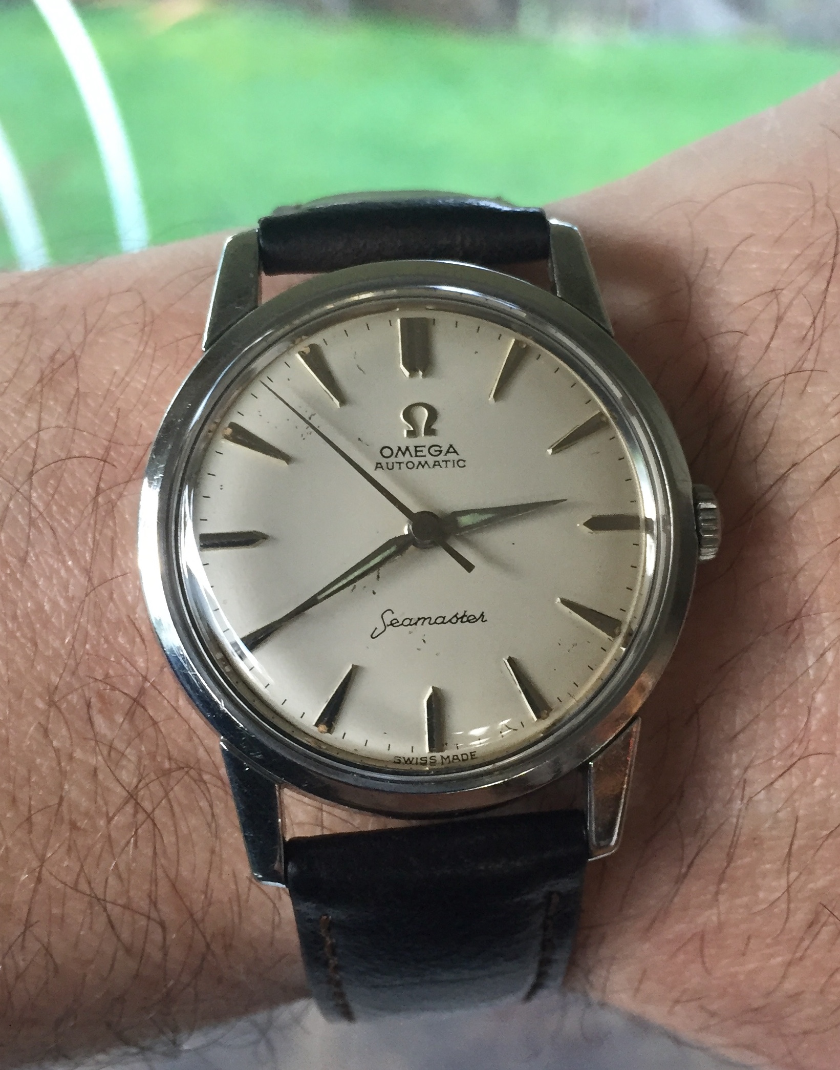

This Seamaster 14704 caliber 591 was my first vintage purchase in April 2016. I paid $325 for it...and after a $450 trip to my watchmaker, it's been running strong, keeping great time and despite the petite case diameter, it has plenty of wrist presence.
I definitely paid a bit of the noob tax on this watch, but it holds a special place in my modest collection, and it seems that the market has just about caught up to my investment in it...!

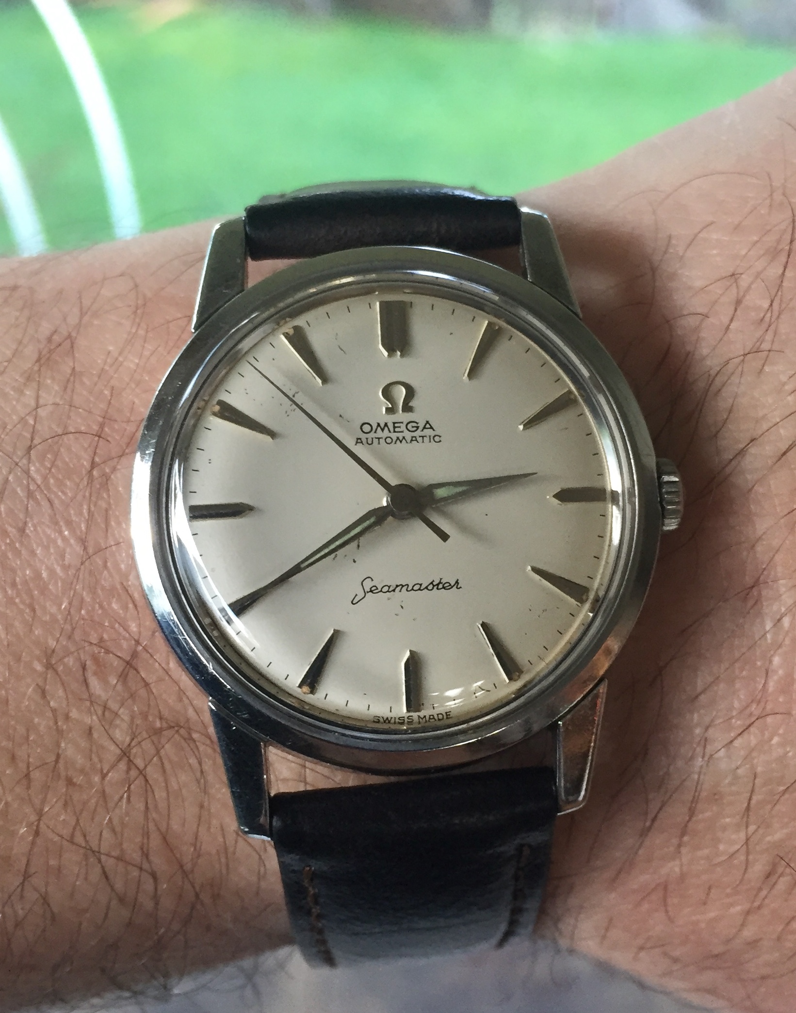

Is that a Certina crown on this watch?
On @Freddedw’s watch, not on mine 😉
