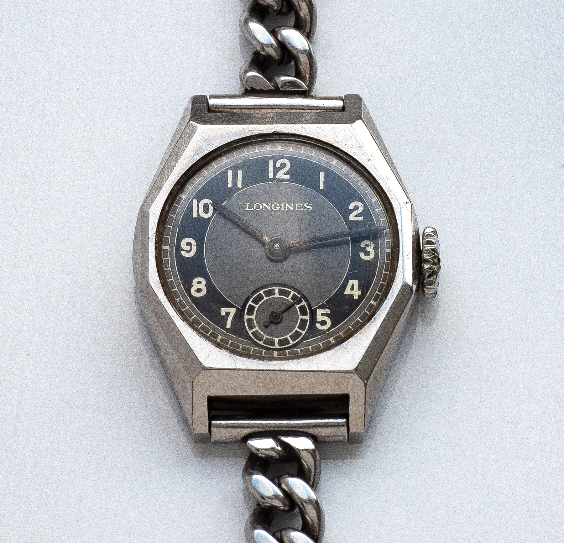

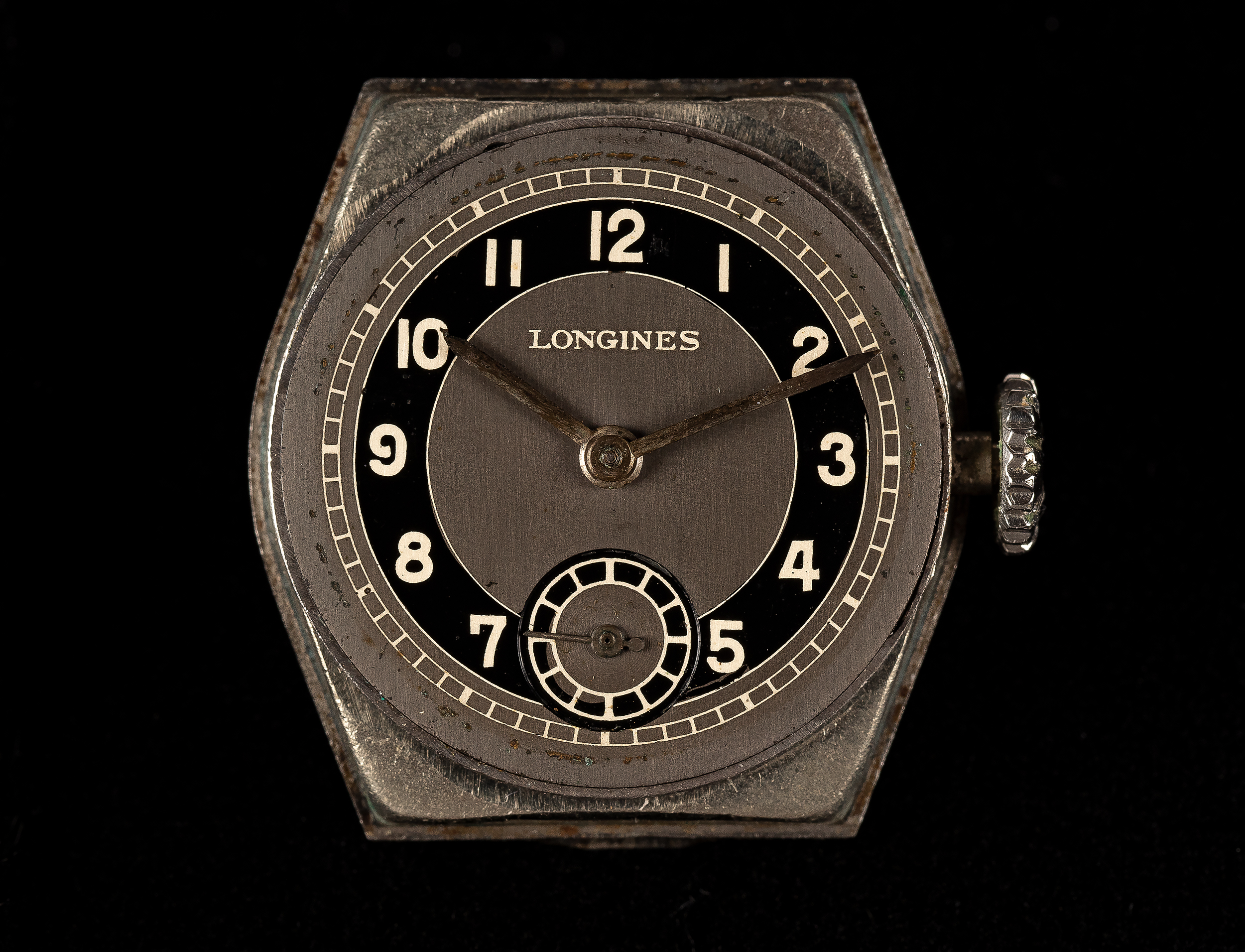

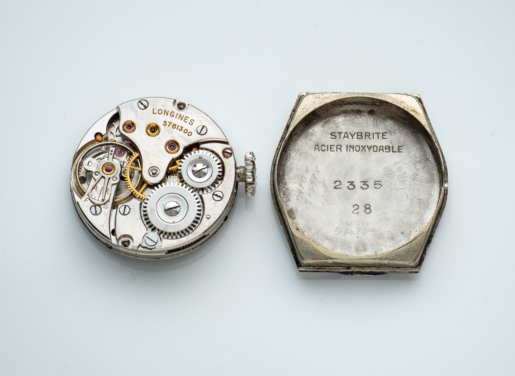

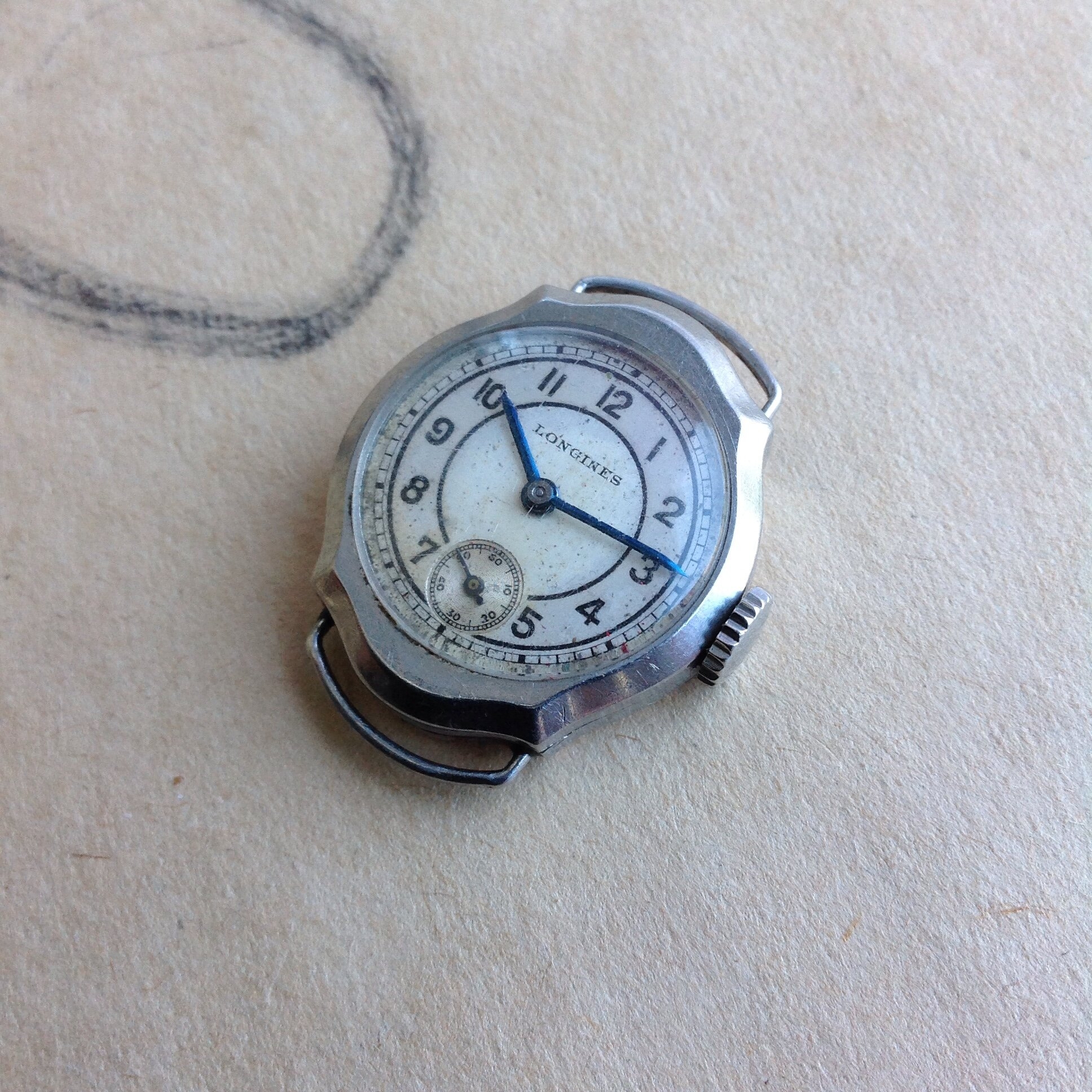

Dear fellow OF members. I intend to sell this Longines ladies watch. I hope it will be used as intended and my research tells me that it is manufactured in the late 30's (1938.) The case is 21-22 mm excluding the crown. The inner caseback is marked 2335 wich i believes should be the reference number, and the movement is cal 8.68N. The dial is in a stunning near flawless condtion with an unusual octagonal shaped case.
I am no expert on ladies watches, but dials in this fine conditon are quite rare in my opinion. I just want's to get the description as accurate as possible. Any opinions?

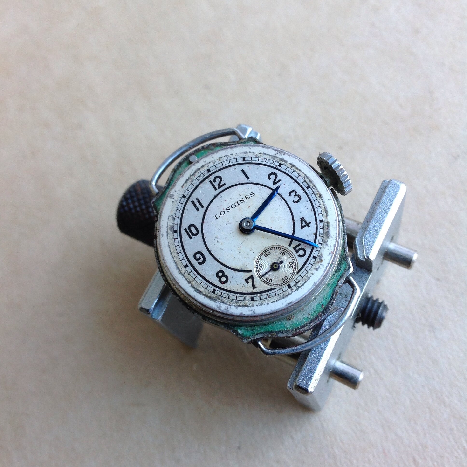

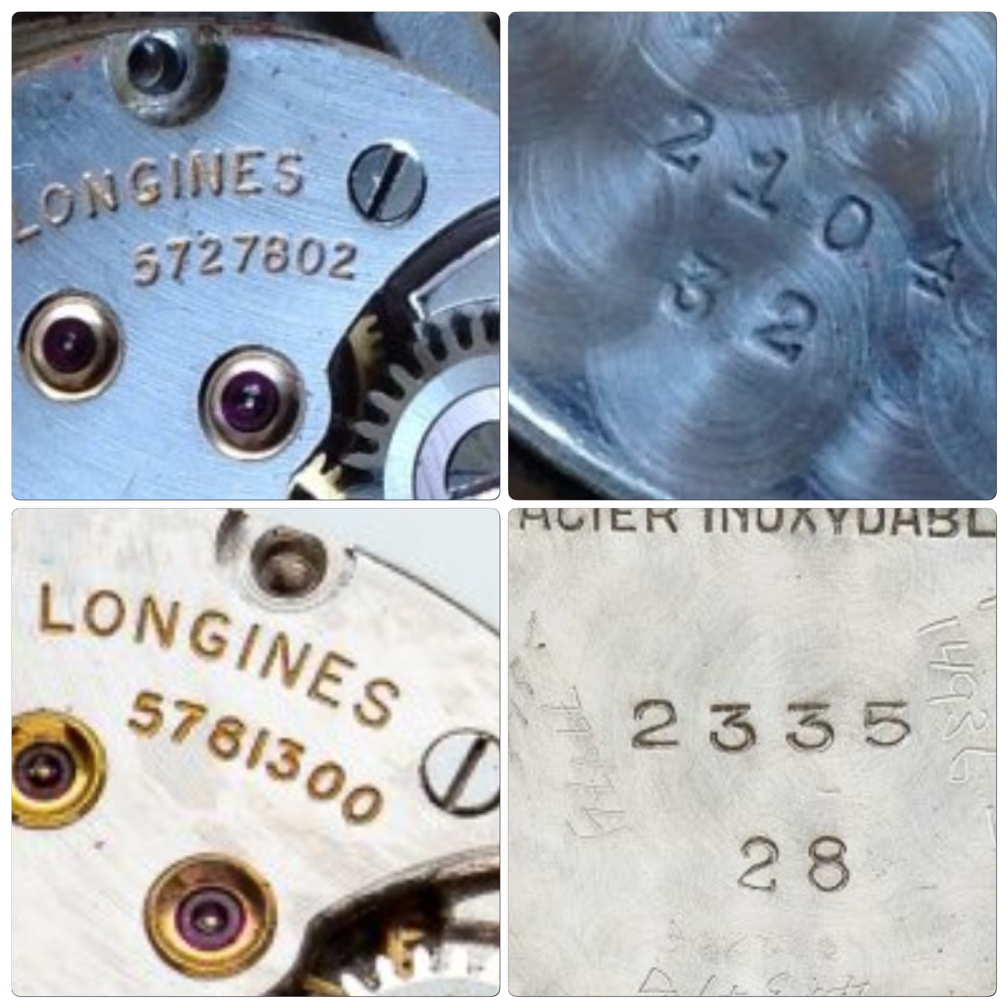

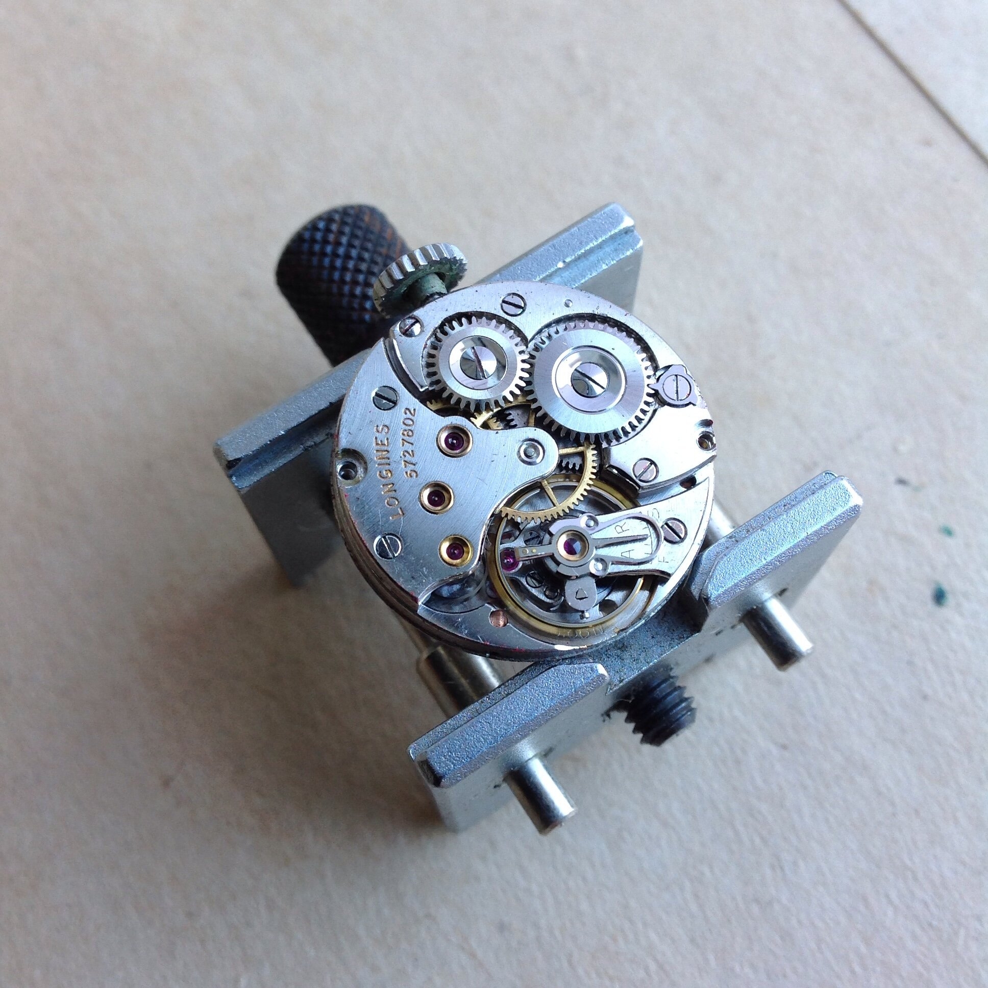

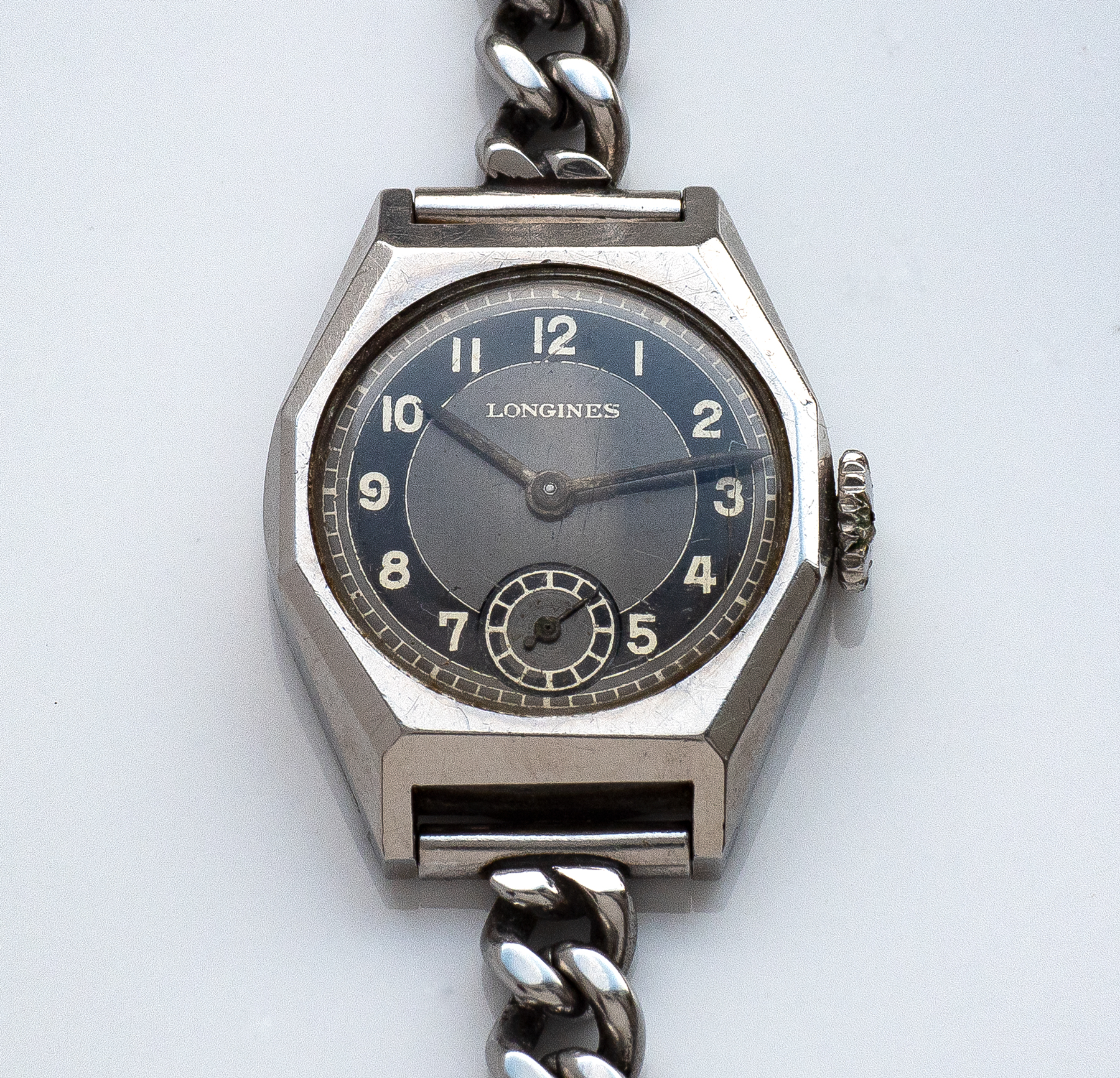

I have a simular one from the same era and it`s a keeper because
a sale would not generate much money imo.

Firstly, the 4-digit numbers on the inside of the case-backs of these watches are order numbers, not reference numbers. According to my observations, Longines was using both 4 and 5-digit order numbers during the 1930s and 1940s. The reference number of this watch likely begins with a "3" or a "4".
Secondly, despite some small imperfections (e.g. the grey of the sub-dial bleeding beyond the silver printing), the dial appears original. What intrigues me is the grey and black bullseye design. I think that the late 1930s would be quite an early instance of such a design, in a Longines. Given that the hands seem to fit and the movement is in quite good condition, it seems likely that all is correct.
It is a neat piece. Thanks for posting it.

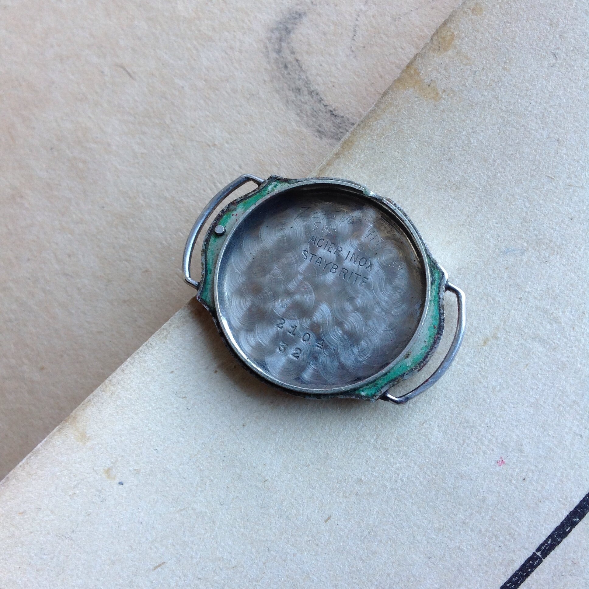

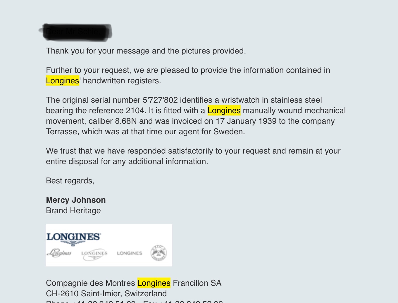

Strangely on mine Longines state the ref number to be 2104 as stamped
in the caseback. Will be interesting to hear what Longines Heritage has to say about OP`s watch😀

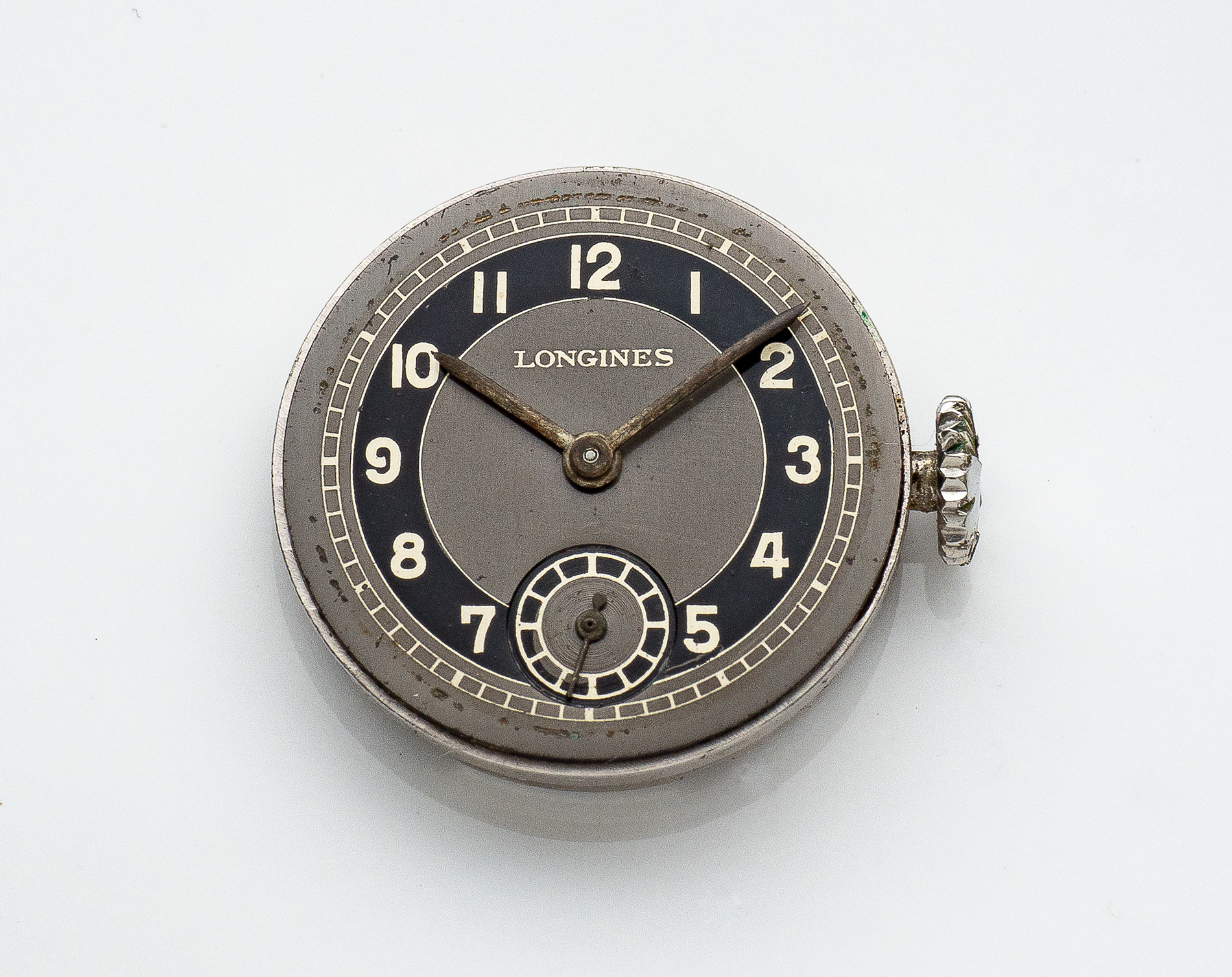

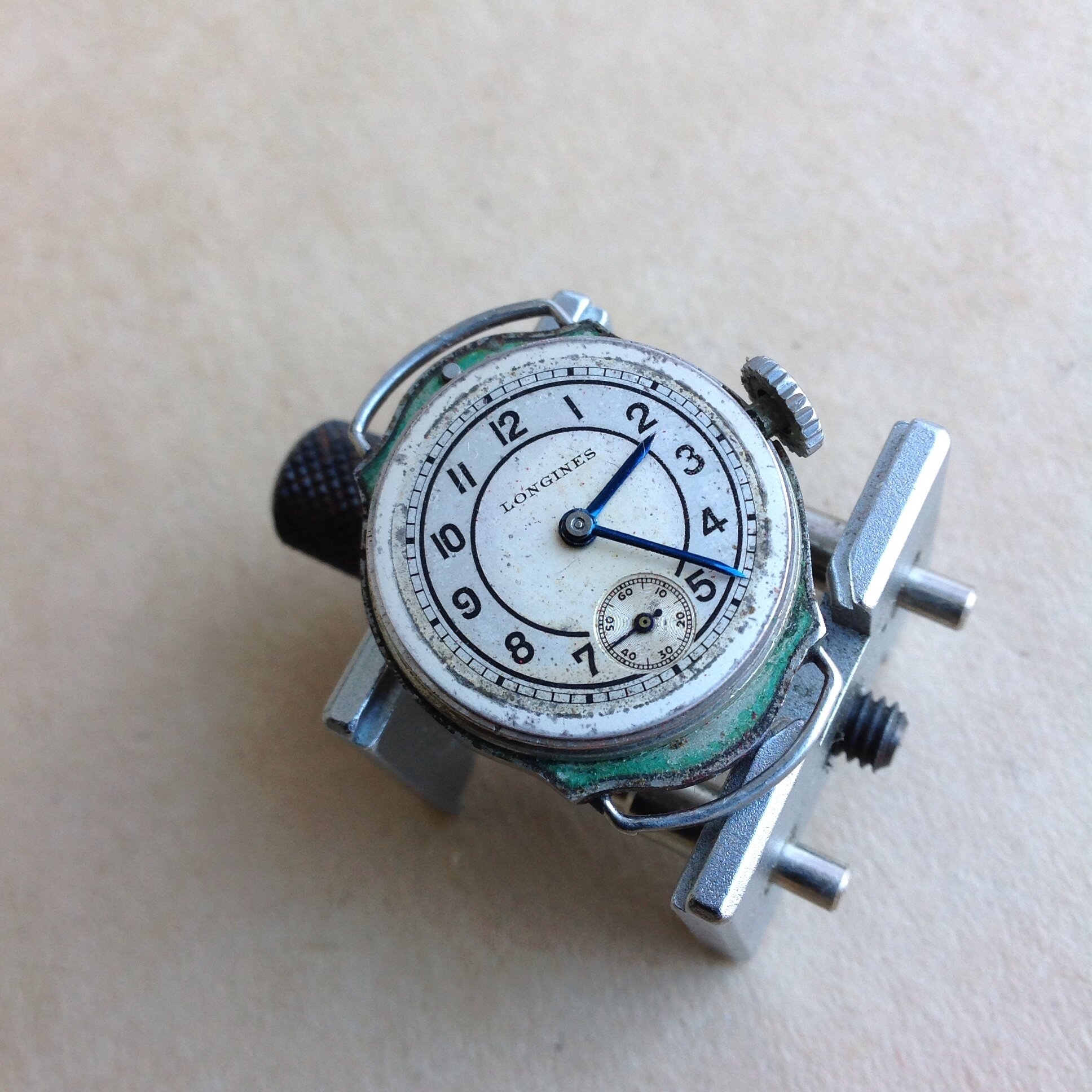

Thank you lads for your comments. Strange about the reference number though. @DirtyDozen12 are there exceptions? I refer to @Radiumpassion comments. My first pictures were taken in poor daylight. Here is a high resolution picture of the dial, using my macro lens.
2,829
4,948

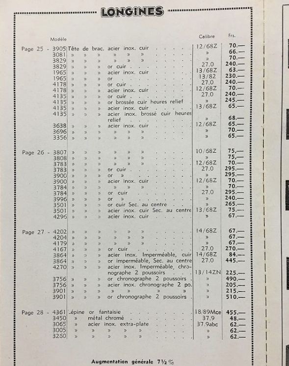

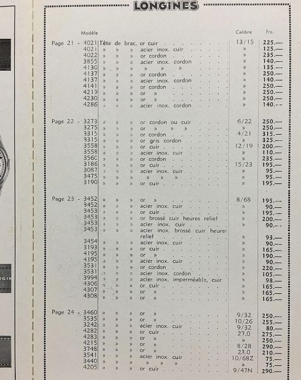

@Radiumpassion Thanks for posting that extract! I am surprised that 2104 is supposedly the reference number. If correct, this would suggest to me that the case is quite an early design since 2104 would be an early reference number. I know that Longines used 4-digit order numbers during this period and that these, rather than the reference numbers, normally appear on cases. However, there could certainly be exceptions. For illustration purposes, below is a catalog from 1938 from a great Instagram account: https://www.instagram.com/pharos_vintage_watches/ As is evident, all but one reference number (1965) begin with either a "3" or a "4". I would certainly be interested to know the reference number of the watch above.

Very interesting indeed @DirtyDozen12
Maybe Longines Heritage just «pulled a fast one» on me and called it
a 2104😉 I really hope that I have not worn out my welcome there..

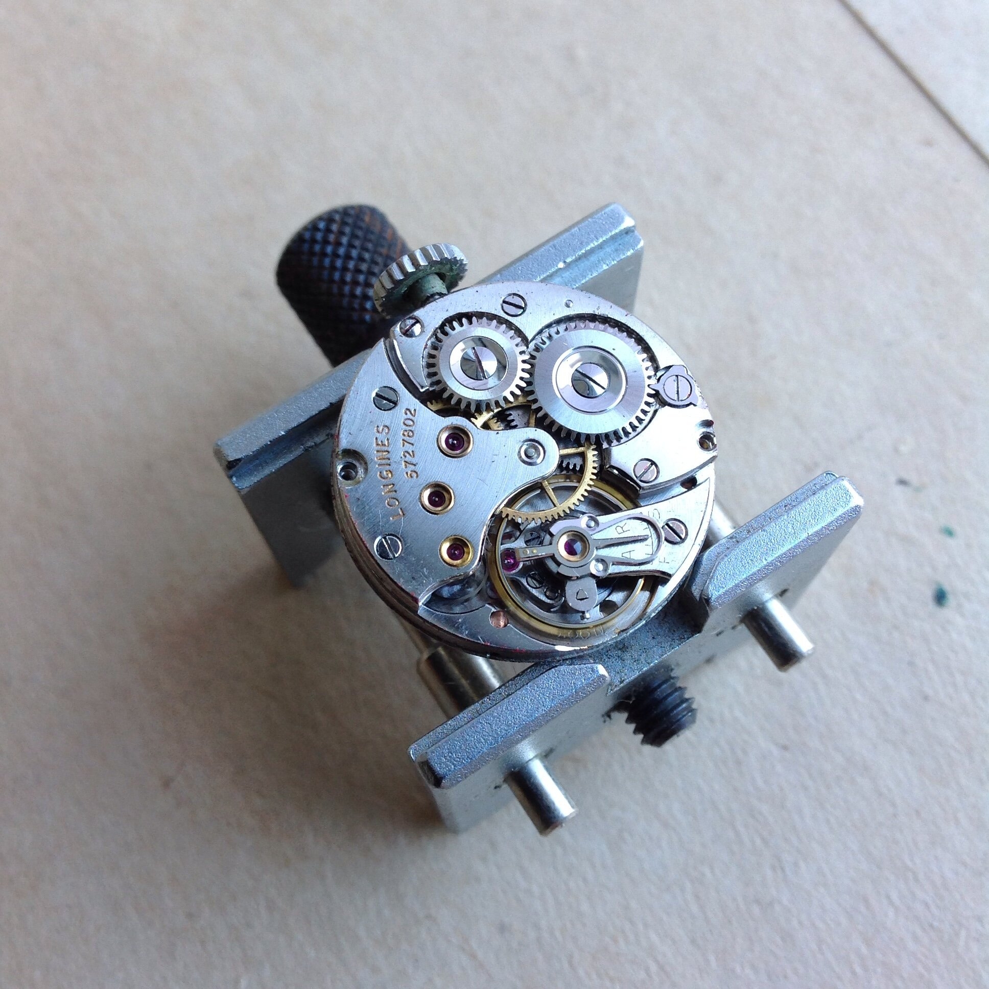

I think DD12 is right and the numbers are order numbers and not ref numbers
as they fit in nicely in sequense with the movement serial numbers on my and
op`s watch.
Here is a simular watch to mine in a mid 1930`s catalog, ref 3191

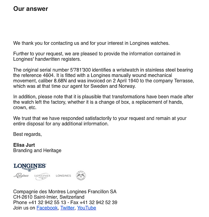

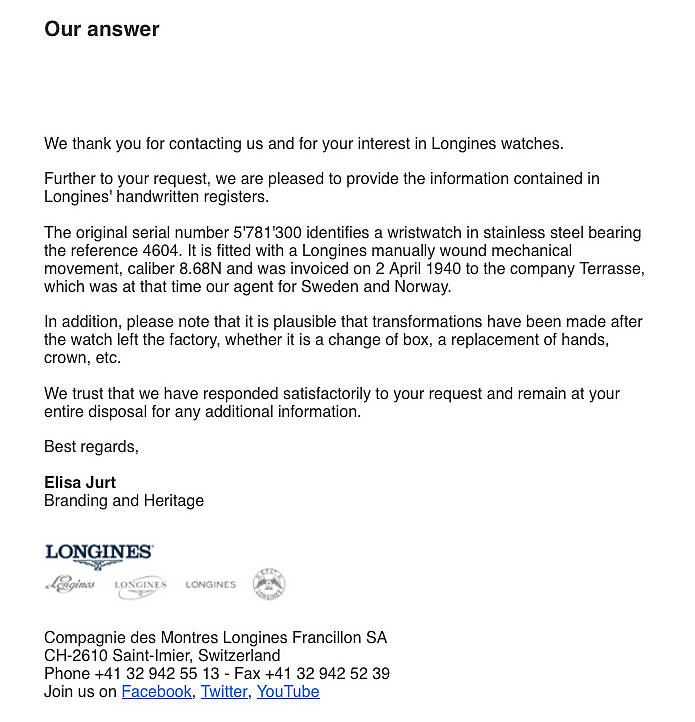

- No worries, you contributes with highly valuable information! I have sent an request to Longines Heritage customer service, will be back with all info asap. 😀
365
455
Longines vintage service is excellent! Here is information regarding the watch:

Thank you for posting this! @Maskelyne
Interesting to see Terrasse refered to as the agent for Norway in
April 1940 A week before Norway became occupied for five years.
During the occupation no watches or watchparts was imported or
distributed in Norway apart from mainsprings made in Sweden by
Sandvik.

@Maskelyne Thank you for posting the extract.
A reference number of 4064 is within the range of what I would have expected given the serial number and order number of 2335.
Edit: reference 4604*
