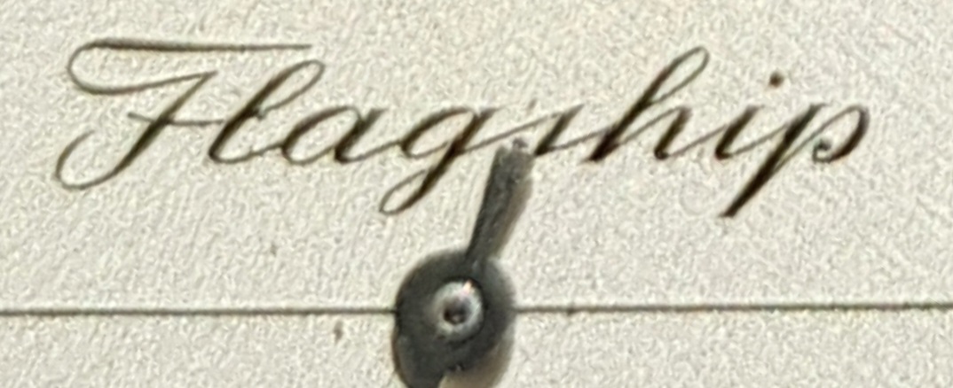

Under 30X magnification:
And under 60x magnification:

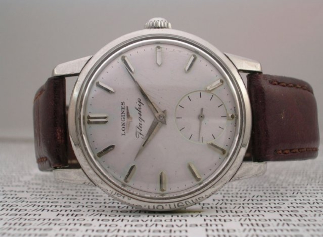

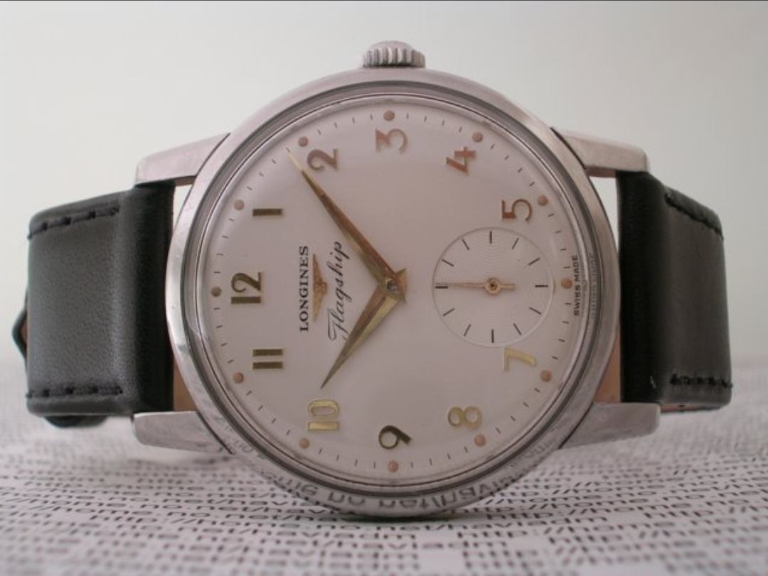

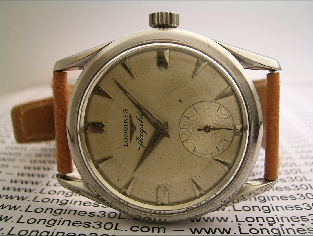

@yako54, I checked the Longines30L site and didn’t see any 6817’s with the high Flagship. Did I miss some or are these other references?
Off the top of my head I can't identify all three shared by yako54, but I know the one in the middle is a Ref. 6818 based on the distinctive lug design. A quick search on the 30L website shows that reference had either the name above the subdial or below the logo, so following that logic it's not out of the question that a 6817 could also have the same variations. My 6817 is significantly earlier than their earliest recorded 6817, from February 1958. For now, I'm yet to be convinced the dial is not original and thus the unusual hour marker is in my opinion a manufacturing quirk.

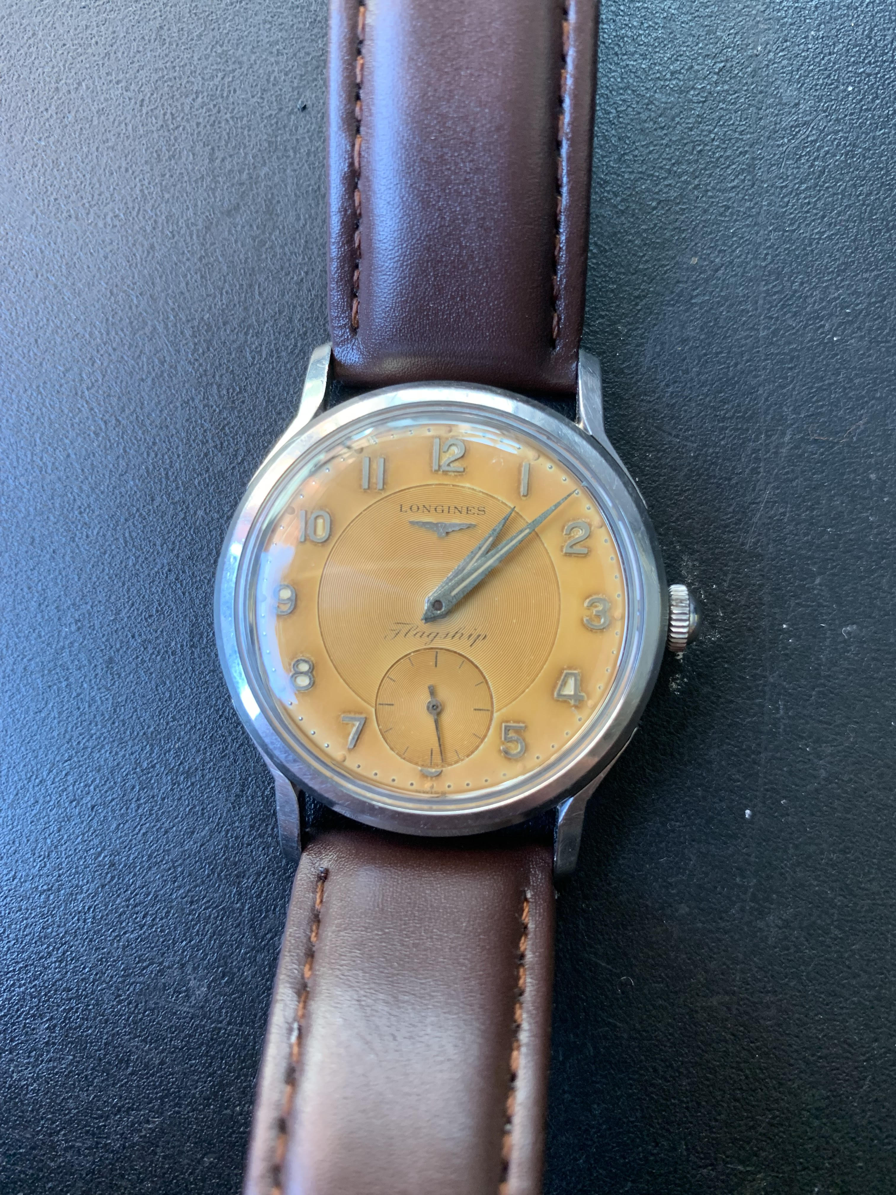

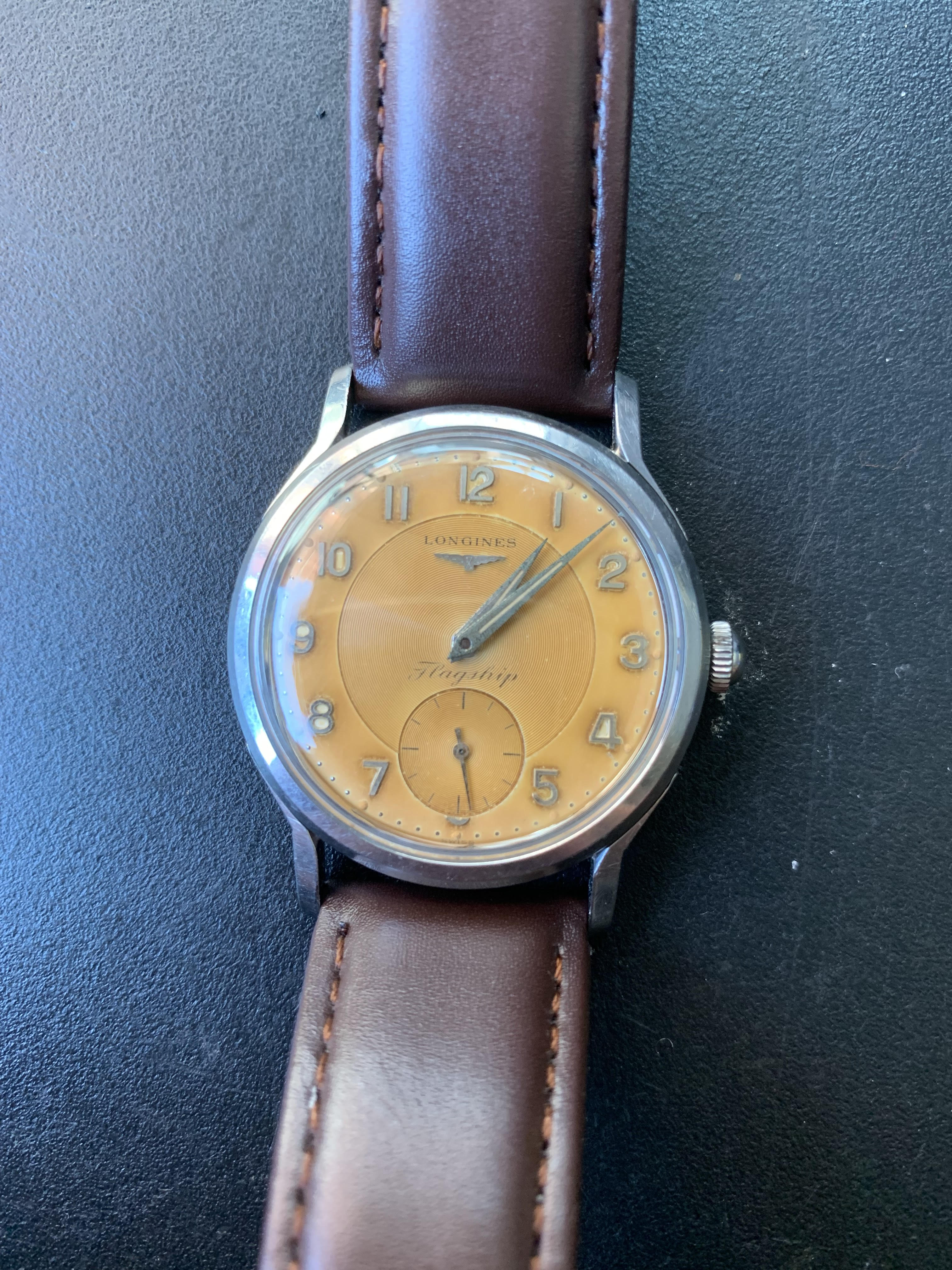

6
My Longines 6817 2 27, dated 1959 or 1958, bought by my great-grandfather in southern Norway.
