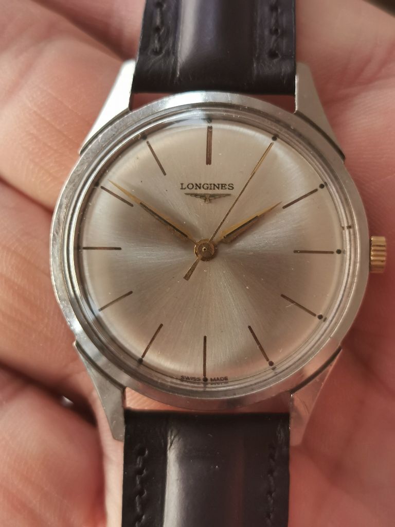

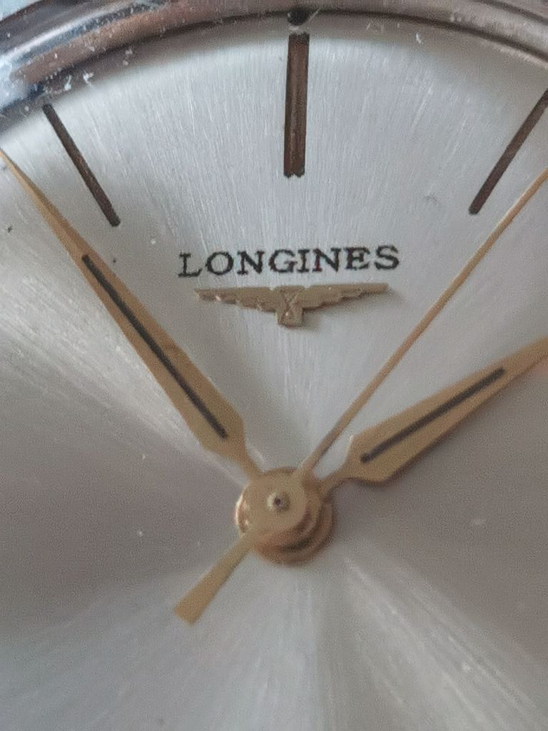

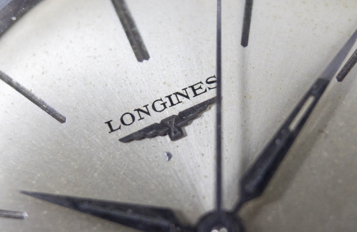

Dear Longines experts,
does this dial look original to you?
it looks nice, but i have a feeling it might be refinished, especially looking at the zoomed in photo.
thank you!

Thank you!
Its a neat looking watch at a fair price i think, but i guess I will pass here 👍

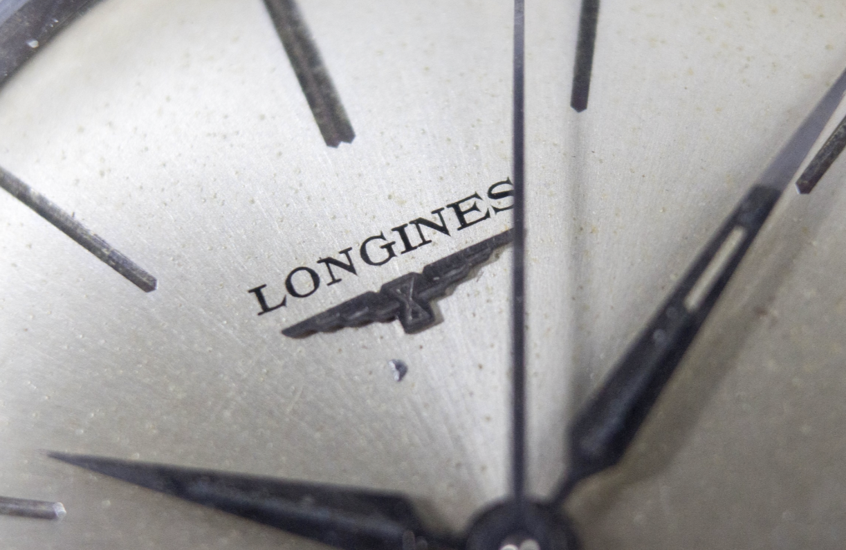

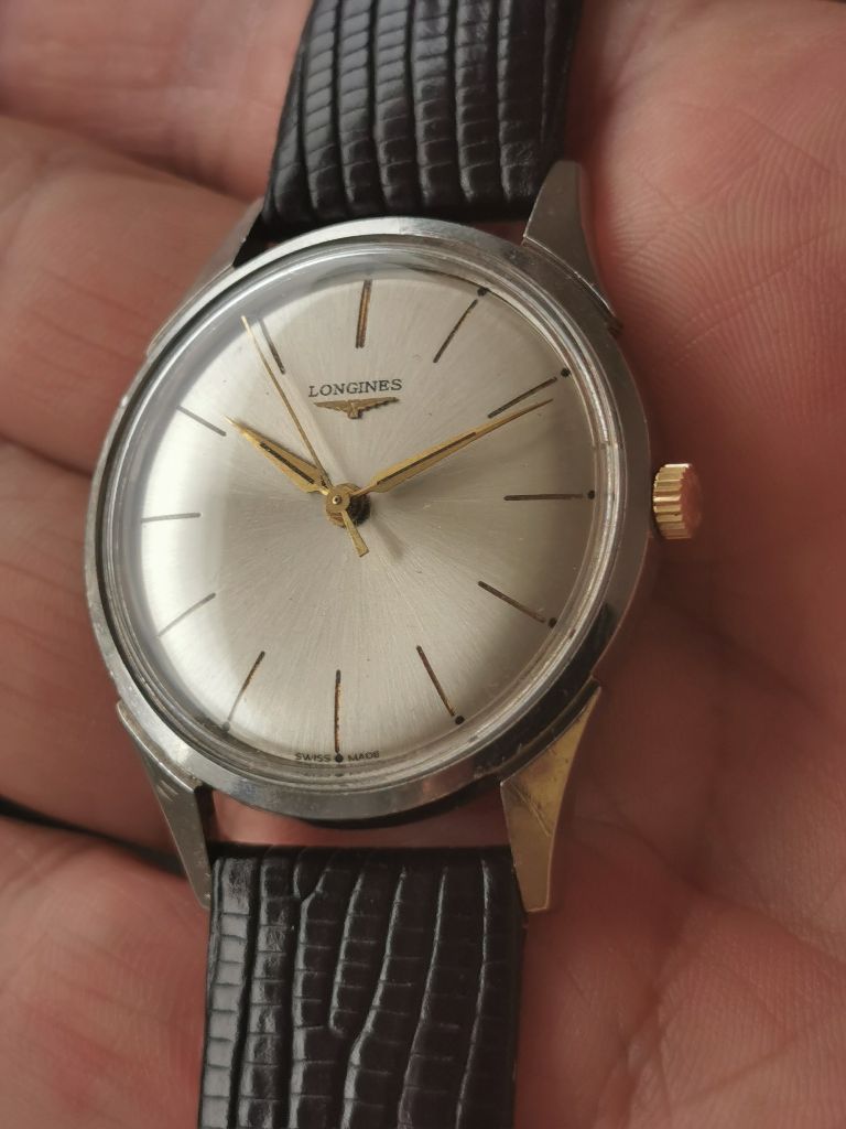

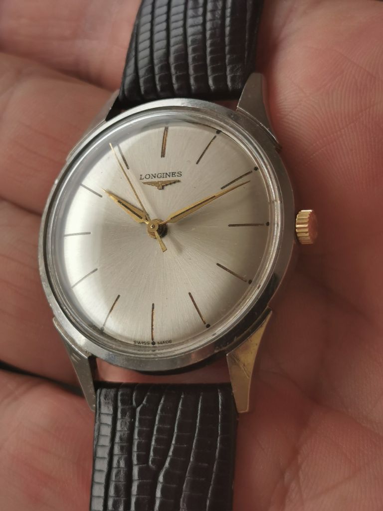

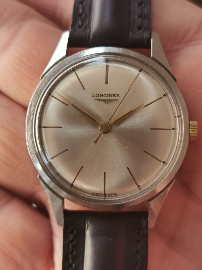

I have a watch with this exact reference. I can confirm that the logo on mine is sharp as shown by @DirtyDozen12. Another visible difference is that hands and crown are in steel on mine, but the shape of hands is exactly the same so I assume the ones on your photo are also original.
1,658
5,257
Yeah i think its alresdy clear that the example above is a redial.
