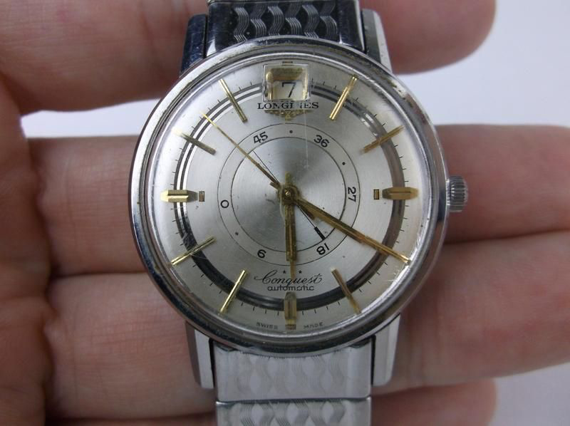

Every other example I saw has matching numbers. I'm not talking about the serial numbers, I'm talking about the 3 digit case number which in my opinion should be the same on the inner caseback as on the back of the lug.
I own a 9032 and a 9035, both SS. I have looked at maybe a hundred Power Reserves in listings also. They are supposed to match. Also, they can be 4 digits.

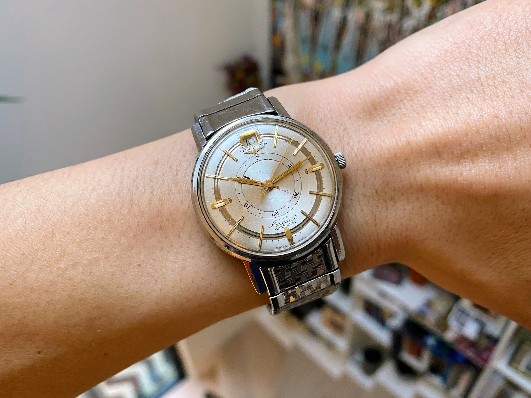

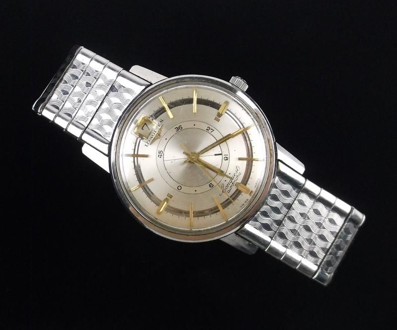

Incoming.... (Auction pics)..... Now where can I find a scallop crown???
Congrats! That bracelet is such a bonus!
the bracelet is the icing on the cake for me. Without it I might have actually passed
