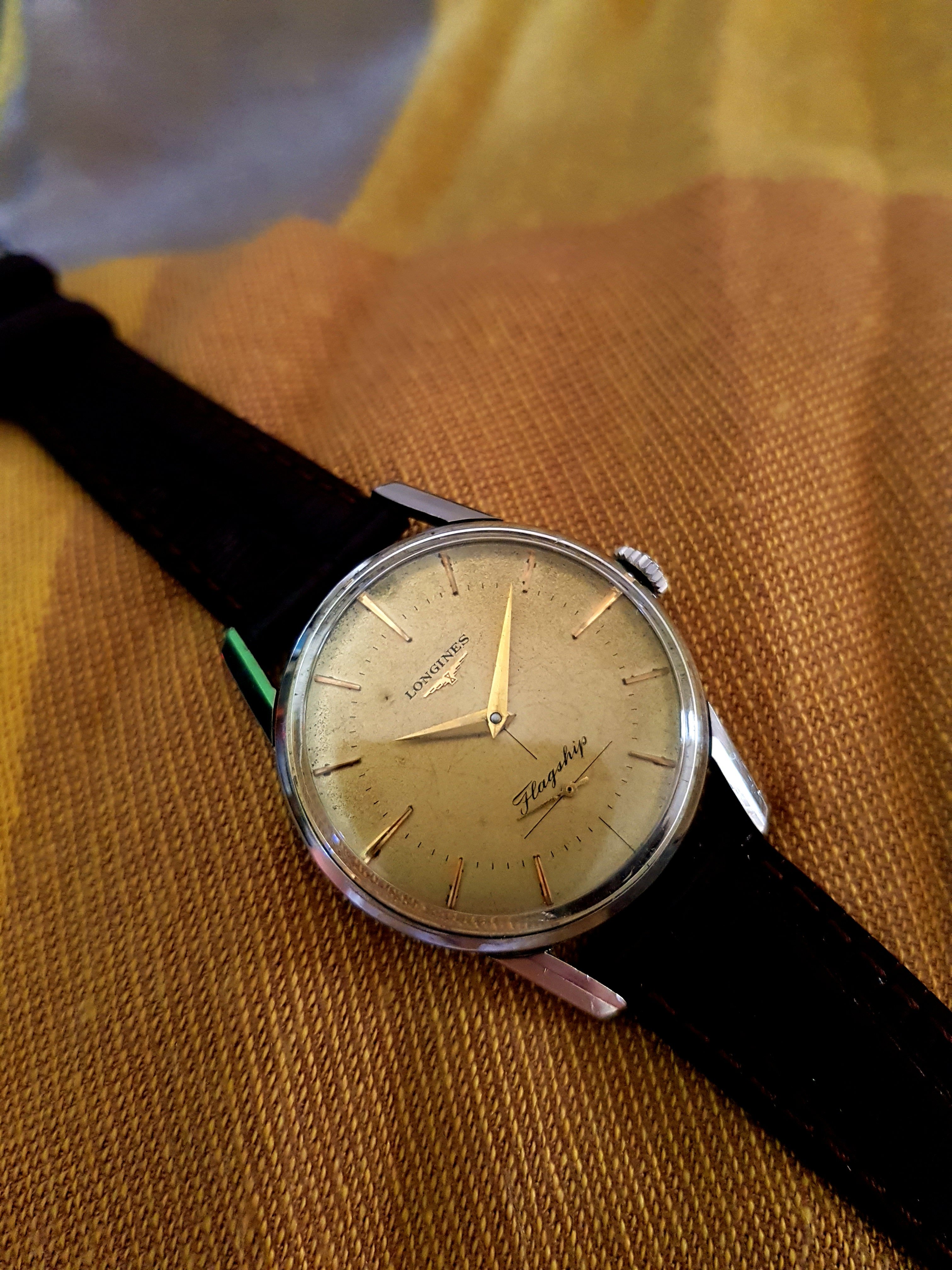

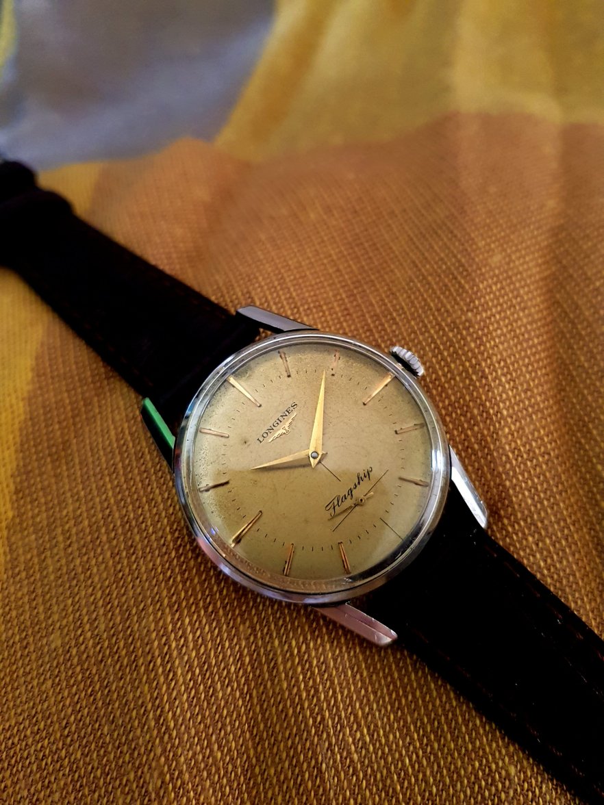

I certainly do like the 30L movement, like the style of lugs on that particular case, and find the aged dial on yours to be appealing. As others have said, just wind it until it stops. You won't hurt it.

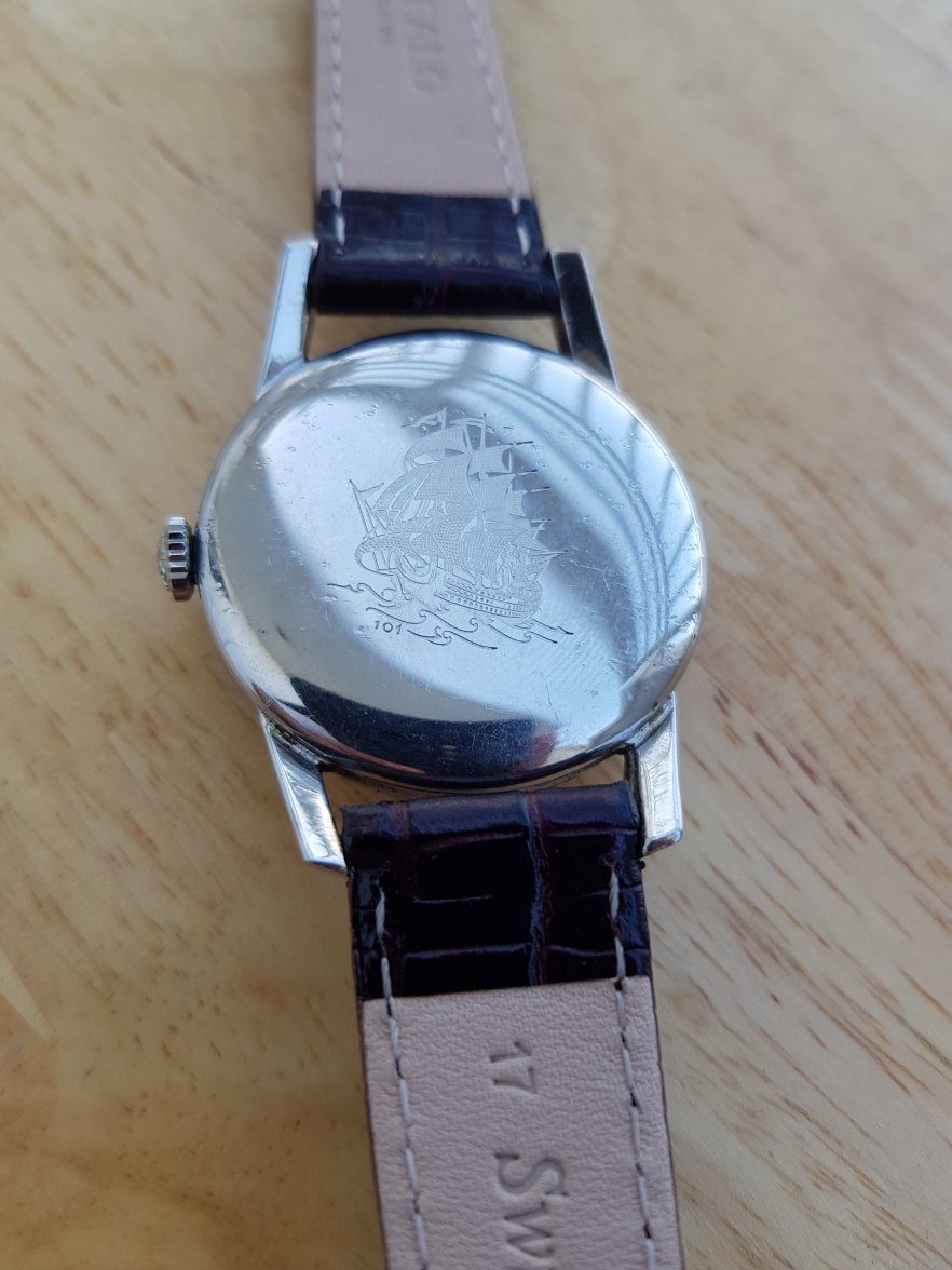

Gorgeous Flagship! When these were being produced by Longines, they were their top end manual-wound watches (as the name "Flagship" suggests). You're particularly lucky because the imprint of the ship is often worn down pretty badly, but yours is pretty crisp.

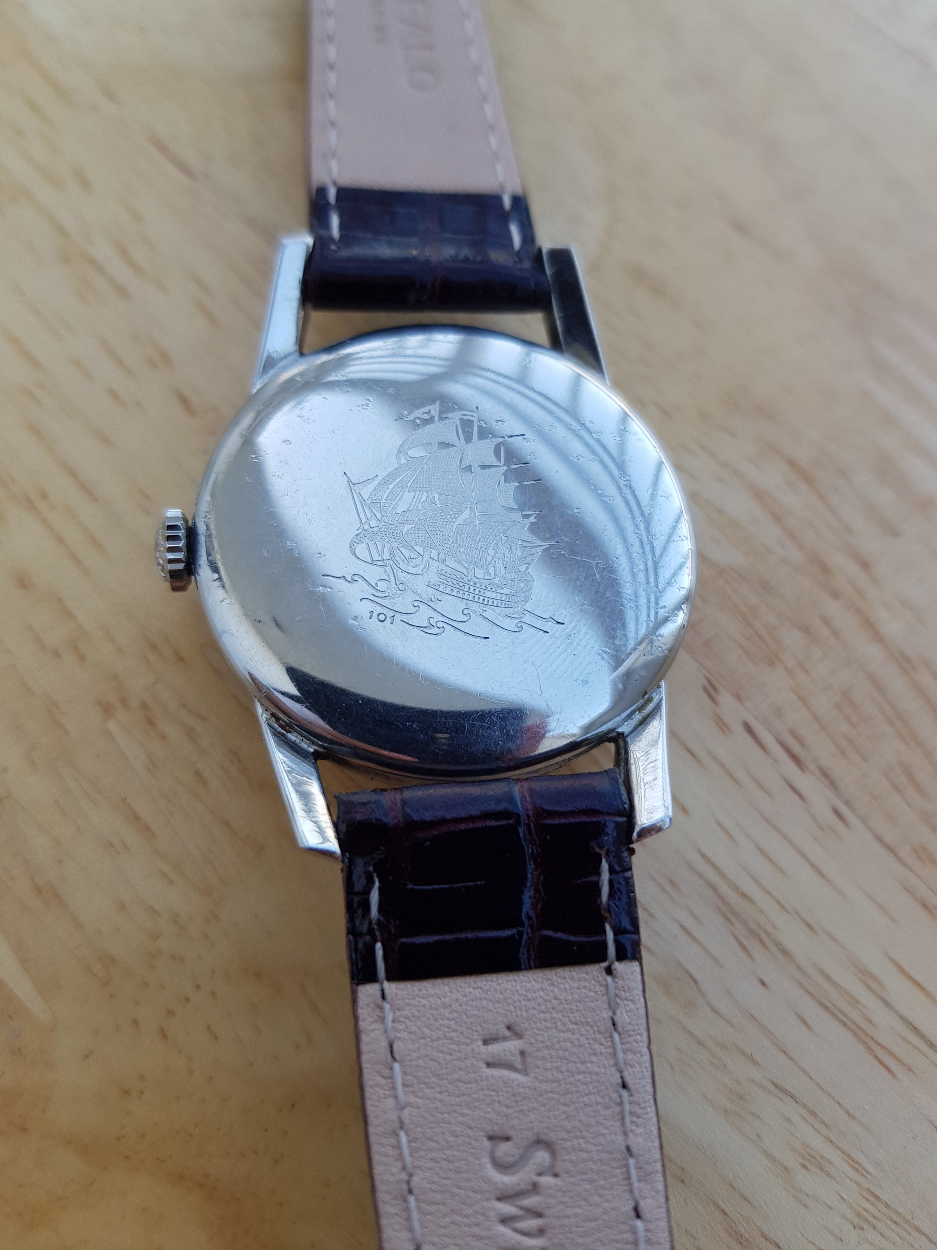

It’s the case reference number. There are four references for these (as far as I know only four..):
101 - snap back, sub-second
102 - screw back, sub-second
103 - snap back, center second
104 - screw back, center second
