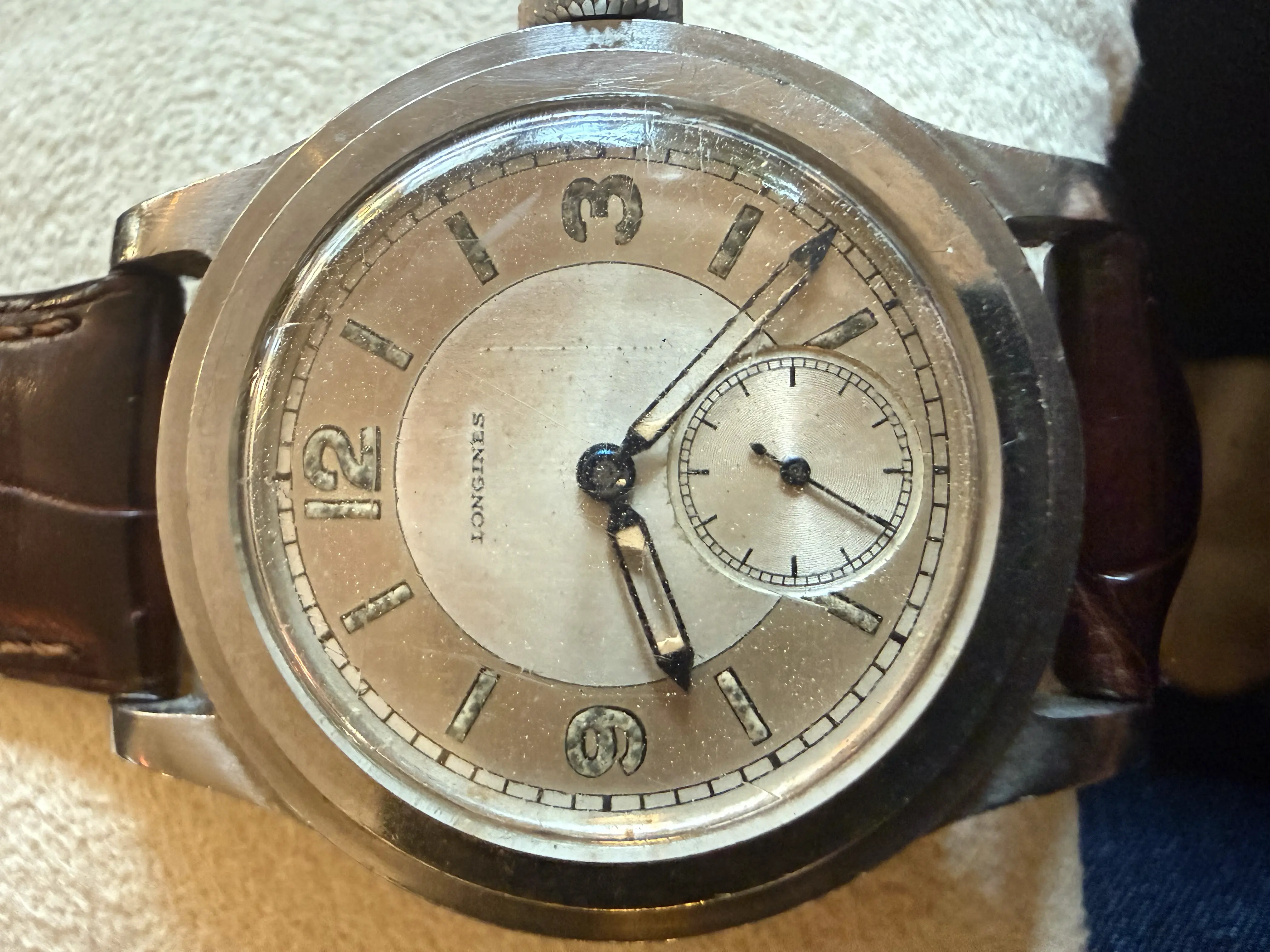

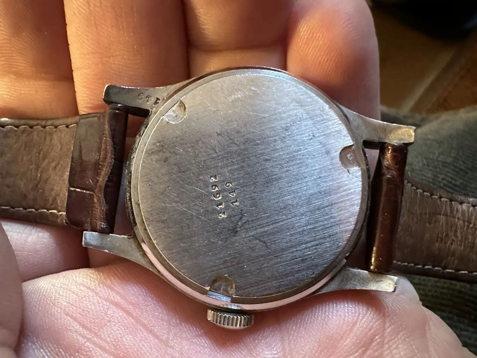

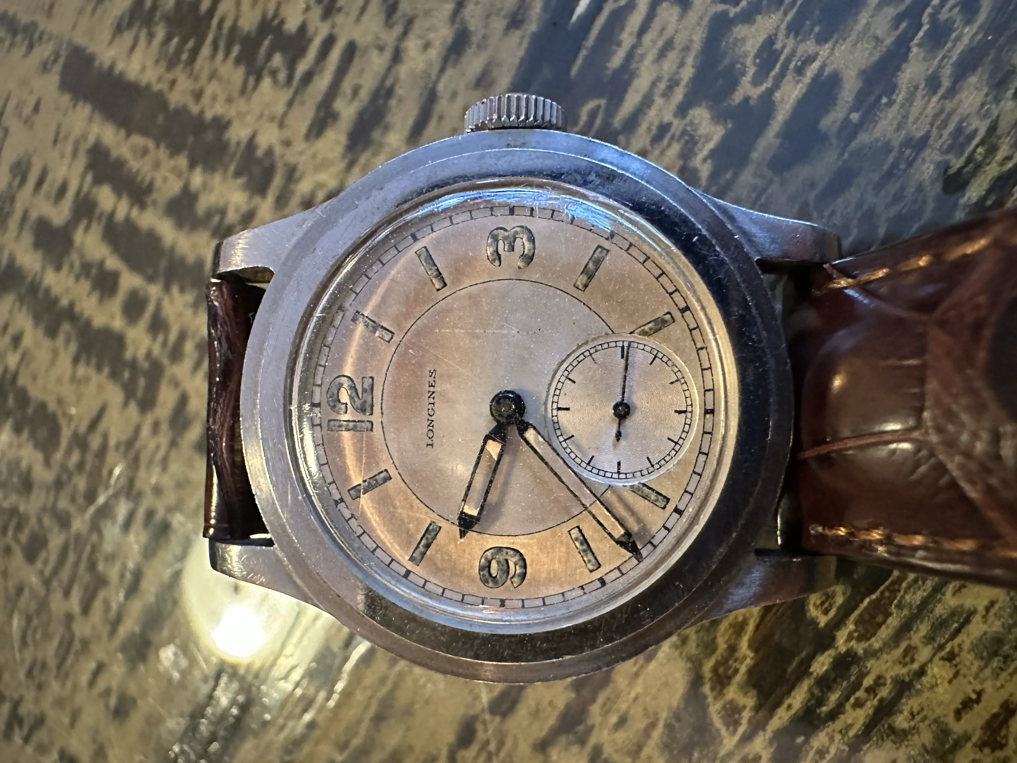

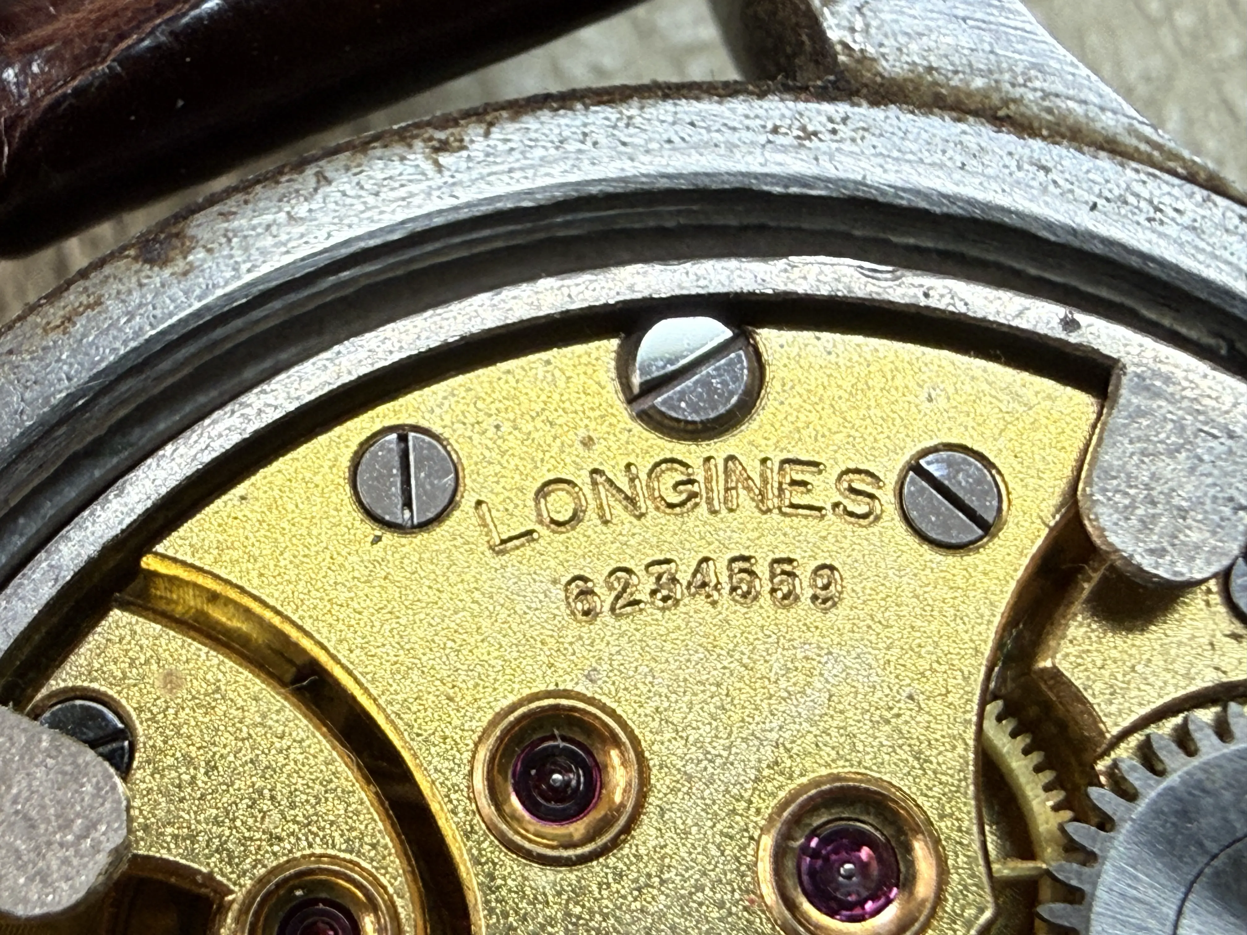

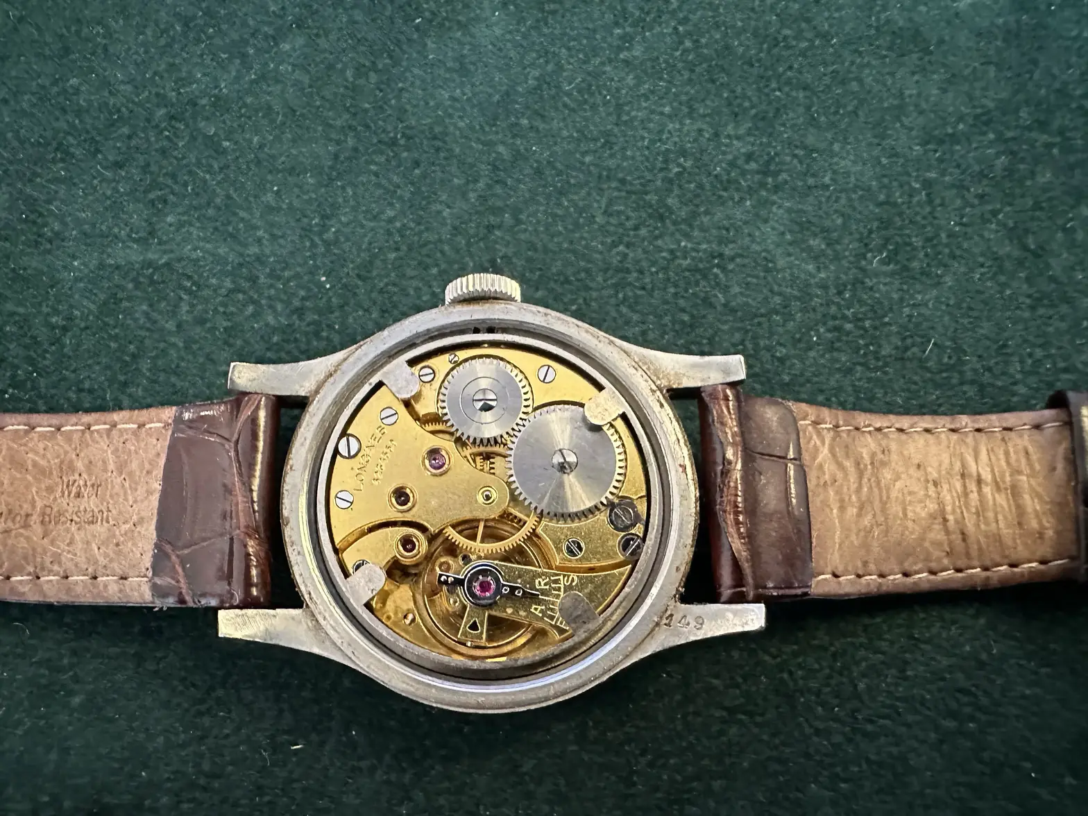

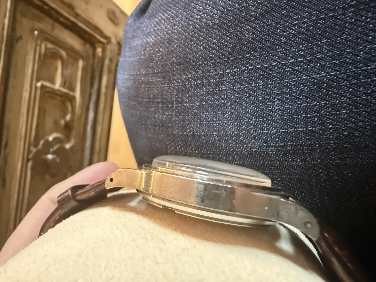

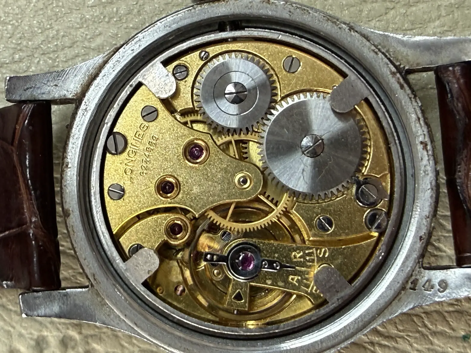

Hello everyone,
I would appreciate some help identifying and dating this Longines.
Known details:
  • 35 mm diameter excluding crown
  • Manual-wind movement
  • Small seconds

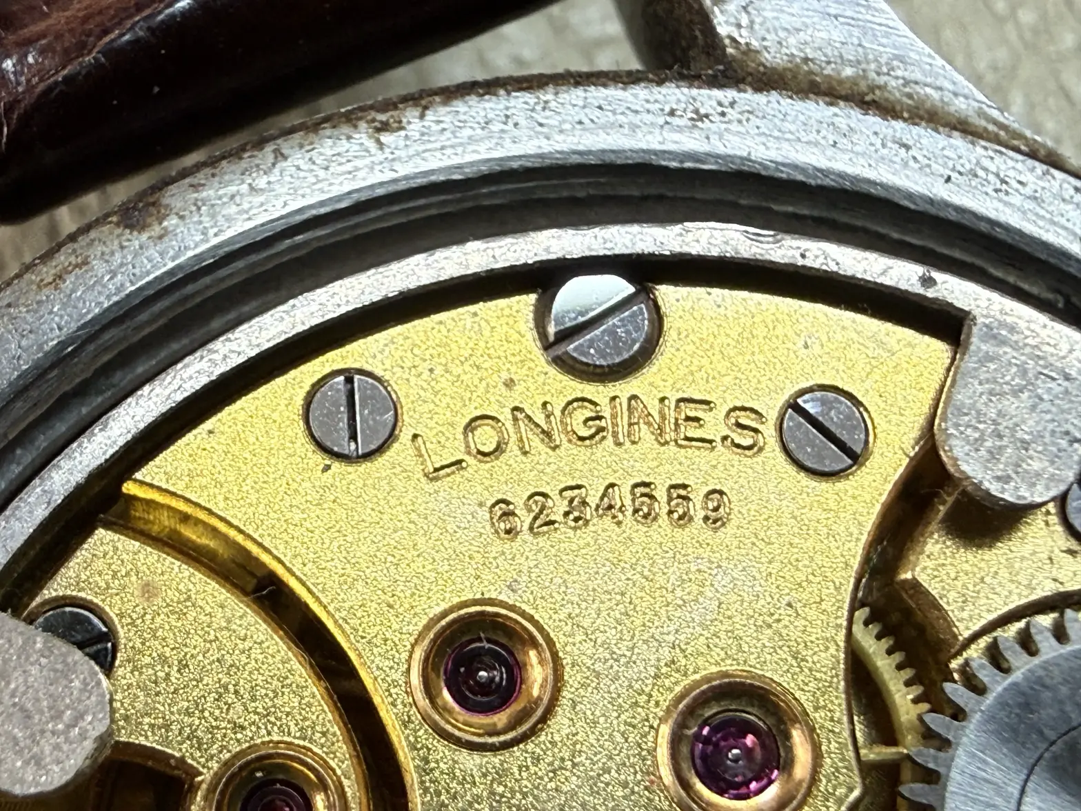

  • Movement serial number: 6,234,559

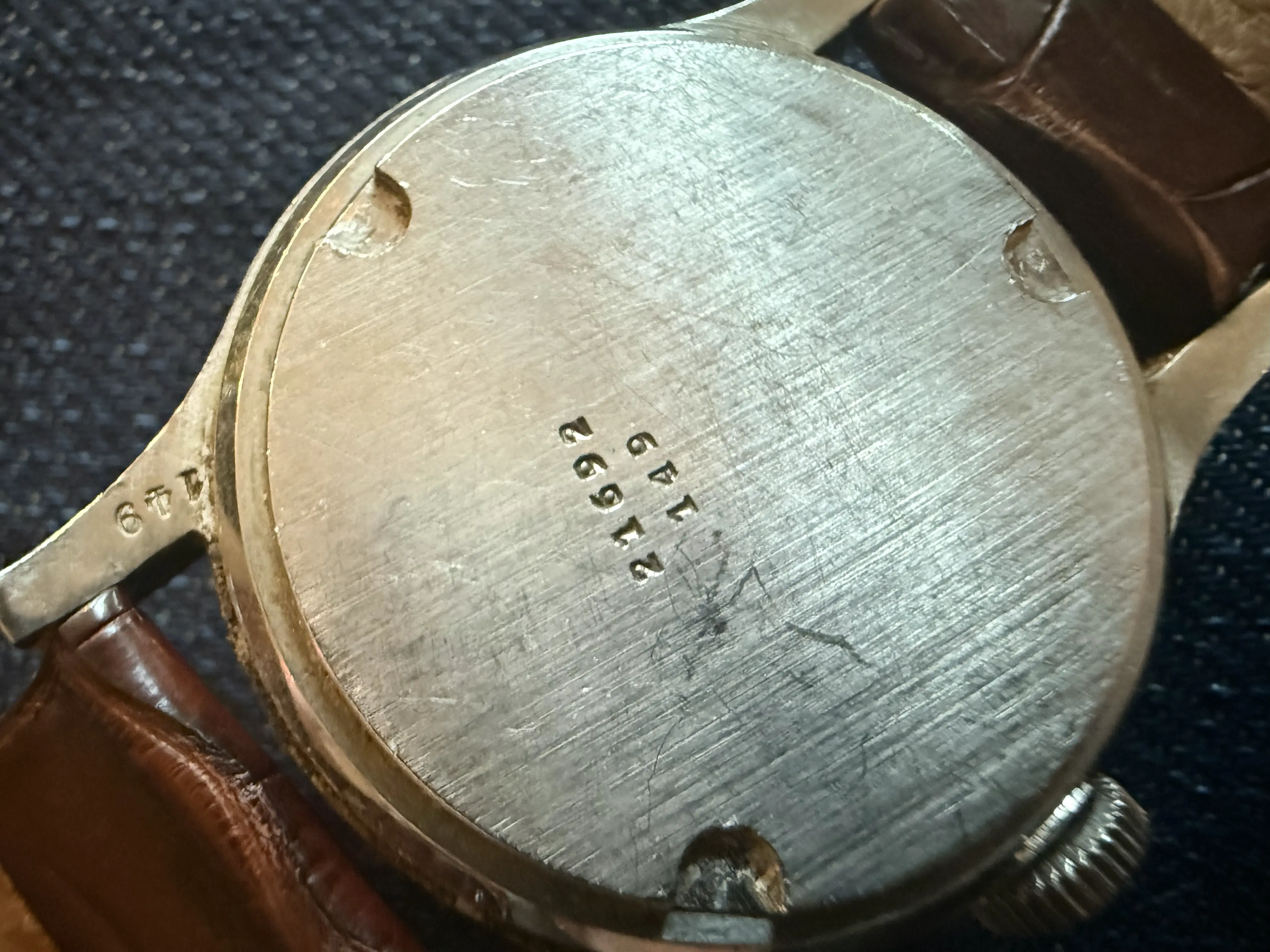

  • Case reference: 21692
  • Additional case number: 149
  • Three-notch screw-back case
I have owned this watch for many years and know its provenance well enough that I have no reason to suspect a recase or marriage, but I would like to learn more about the watch itself.
My main questions are:
  1. What is the movement caliber?
  2. Approximately when was the watch produced based on the serial number?
  3. Does the dial, handset, crown and case appear correct for the period?
  4. Is there any information available on case reference 21692?
  5. Is the three-notch screw-back case typical for Longines of this era?
  6. Would a 35 mm case have been considered oversized for the period, and how uncommon would that size have been?
I have attached photographs of the dial, movement, case, case back and movement serial number.
Many thanks for any information or observations.

Many of your questioms you will find by Google , but looks like a nice original tre tacche
with 12.68 Z movement.
Send Longines a mail with your pictures and the will tell you - free of charge - the day it was sold and where ;-)
But 6.23m will be end 1941, early 1942 I assume.
Most info on these type of cases can be found by searching for 'tre tacche'. I'd say that the watch is all correct

Thank you for the reassurance, do you think a extract from the archives at Longines is worth it for this watch?
6,631
10,386
The mail is free. If you want the same info on paper you pay for it
