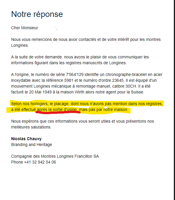

The answer is in the Longines extrait of archives:

" I suspect that the case of your watch was plated after it left the factory. "
You are right, an answer was provided in the extract. However, Longines' answer is not necessarily definitive, so I wanted to offer my opinion too.
