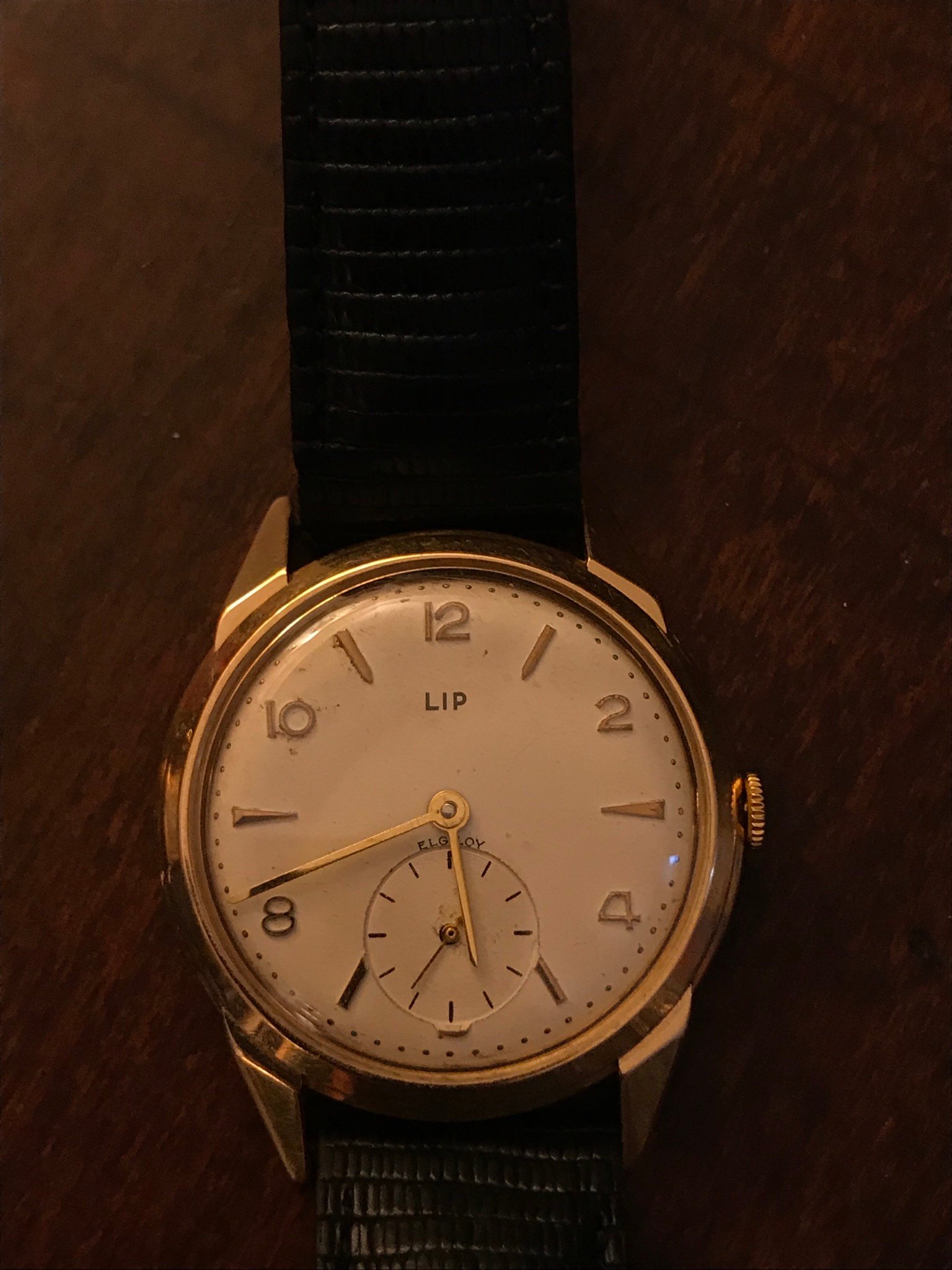

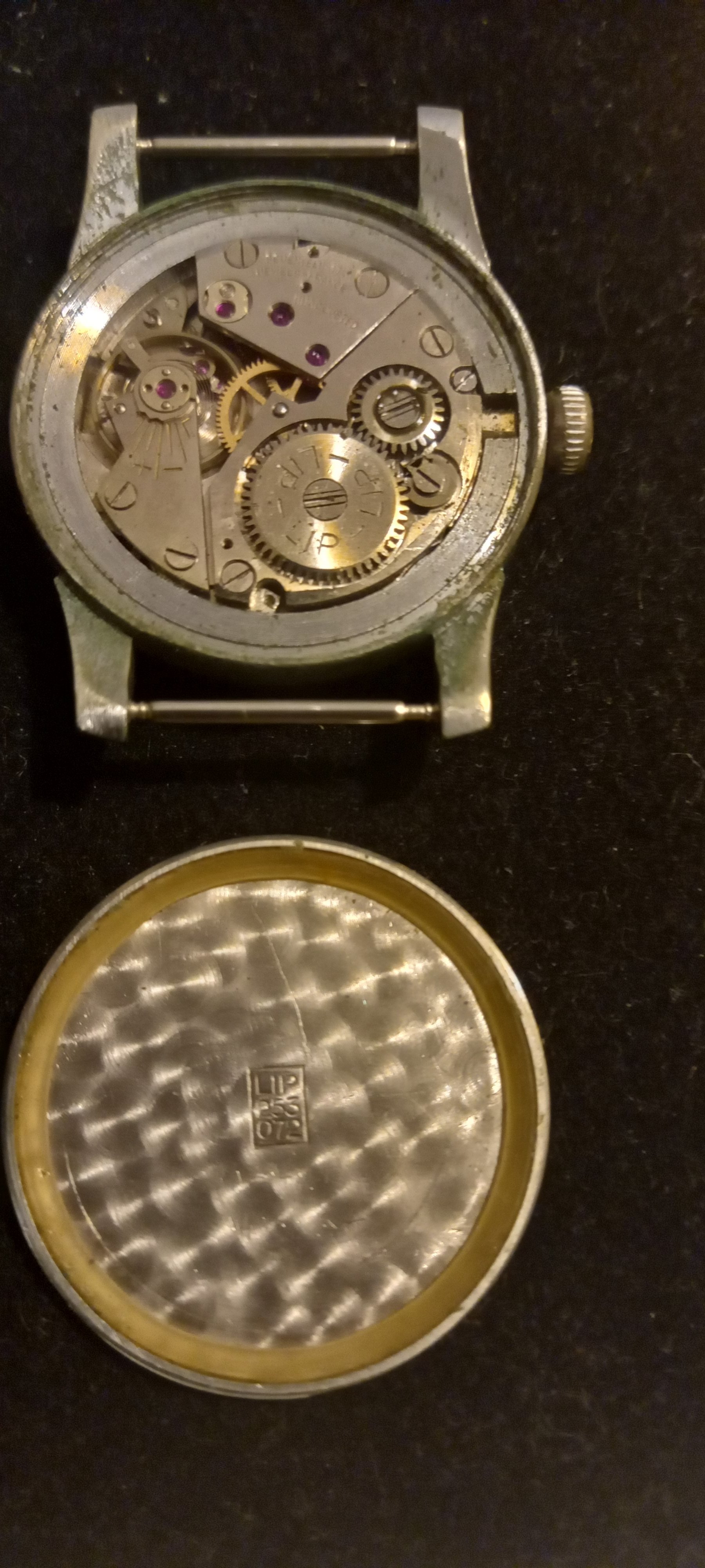

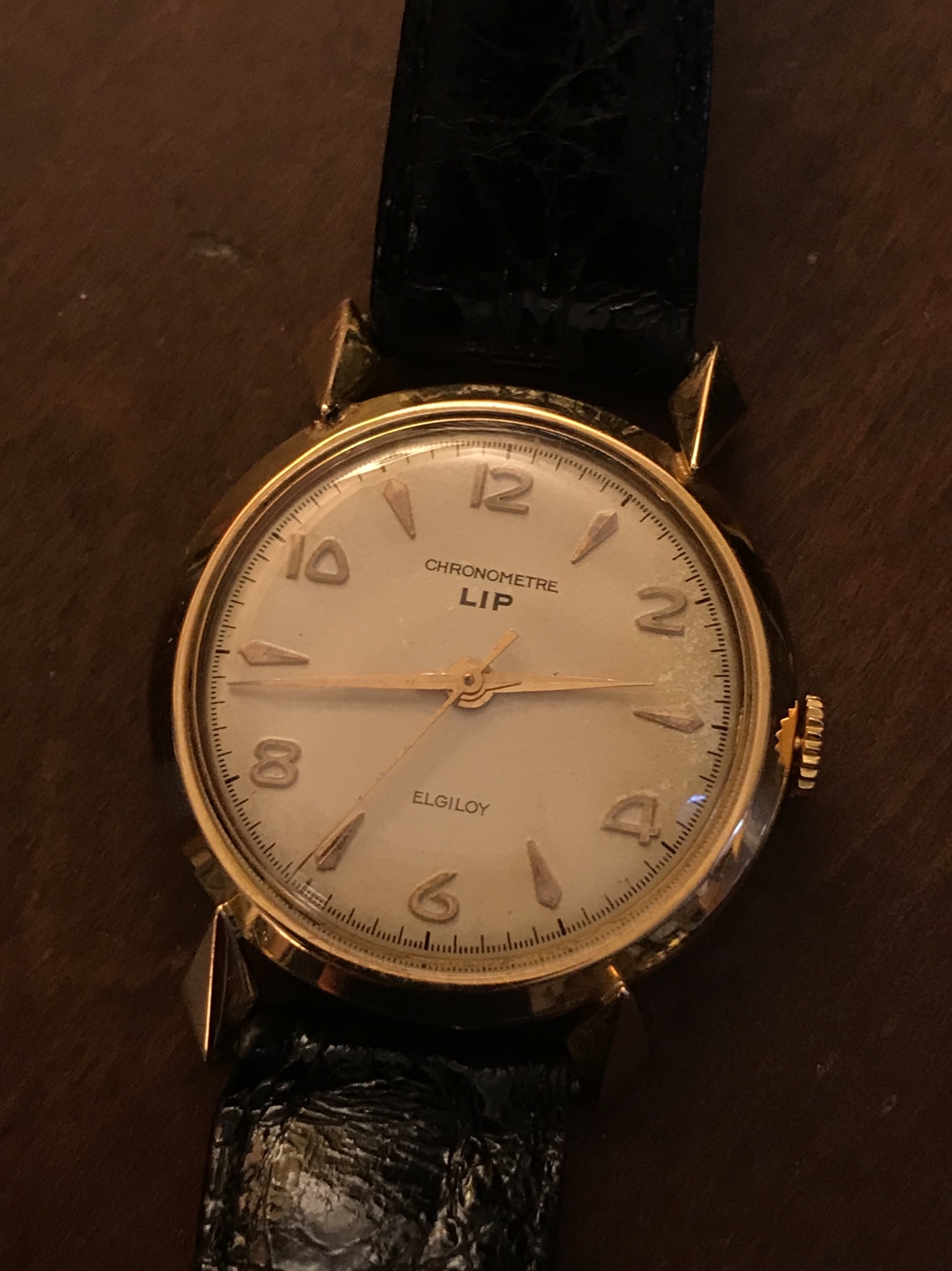

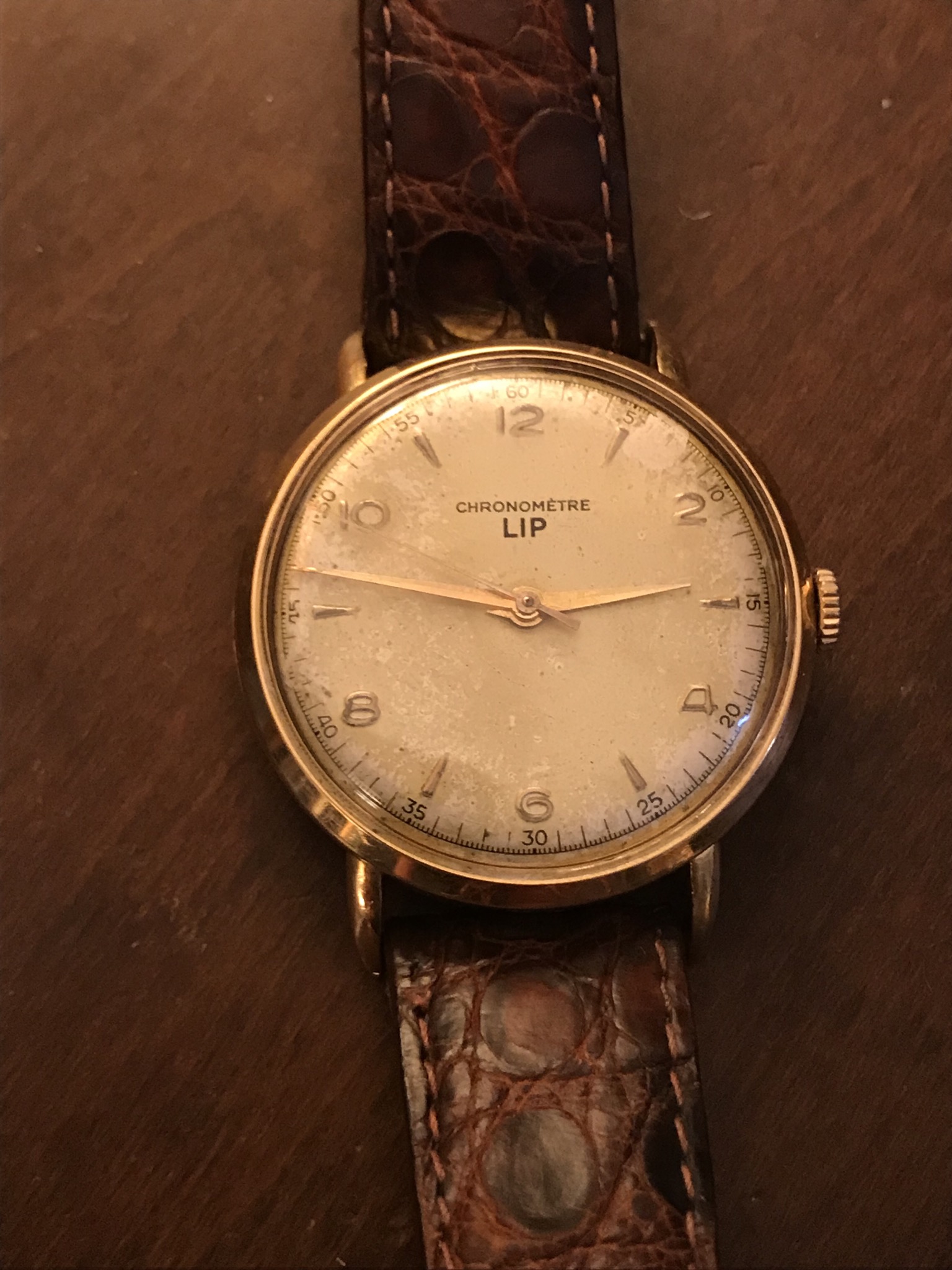

A few more Lips entered my collection lately. I added some older ones as well. All solid gold cases with a cal R 25:

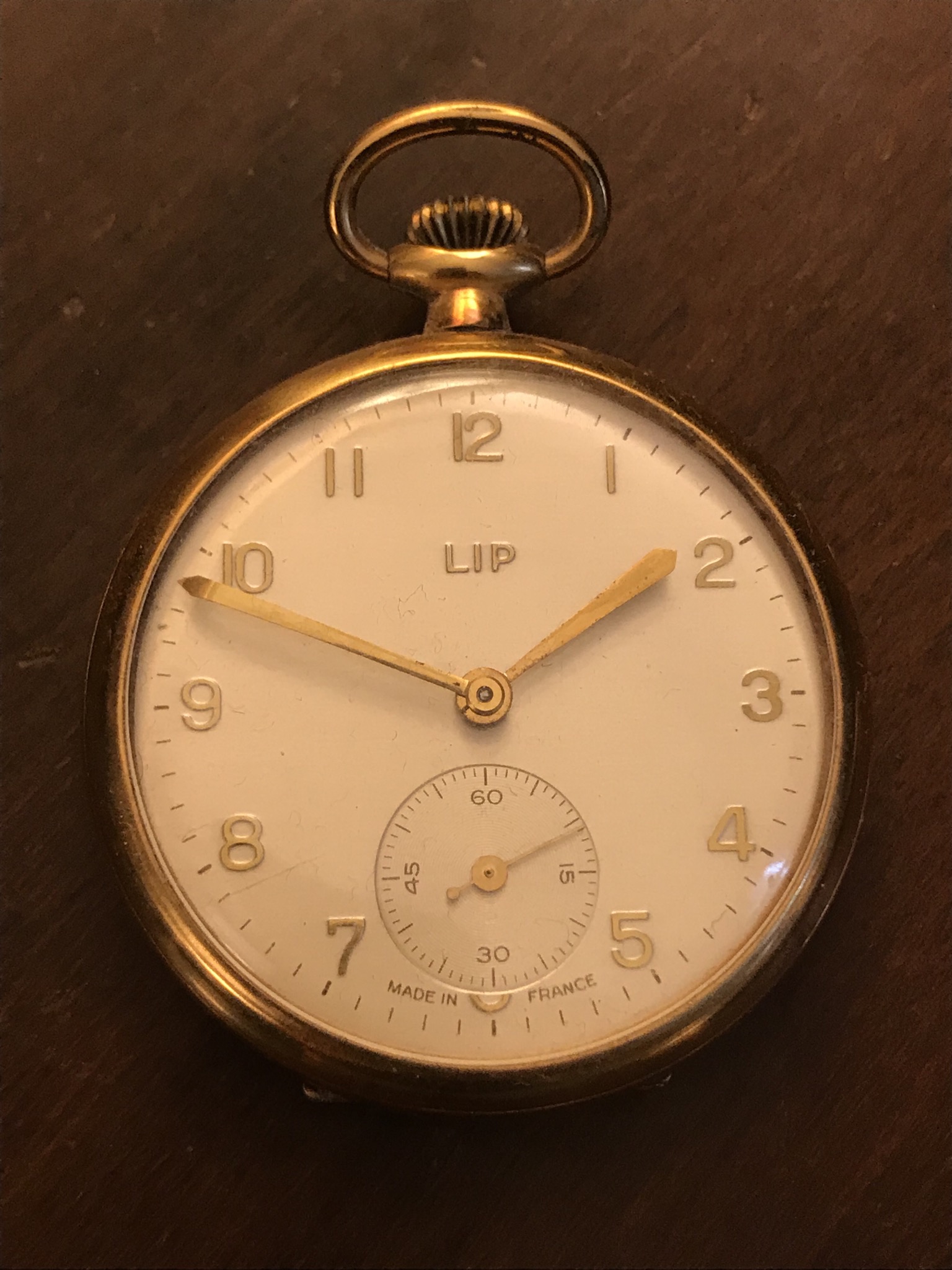

And my favorite Lip pocket watch:

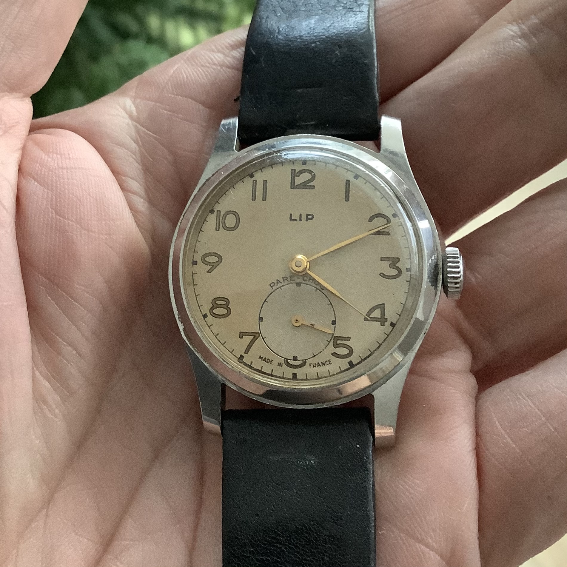

I’ve got a steel para-choc with gilt numerals. Very nice little watch for not much outlay.

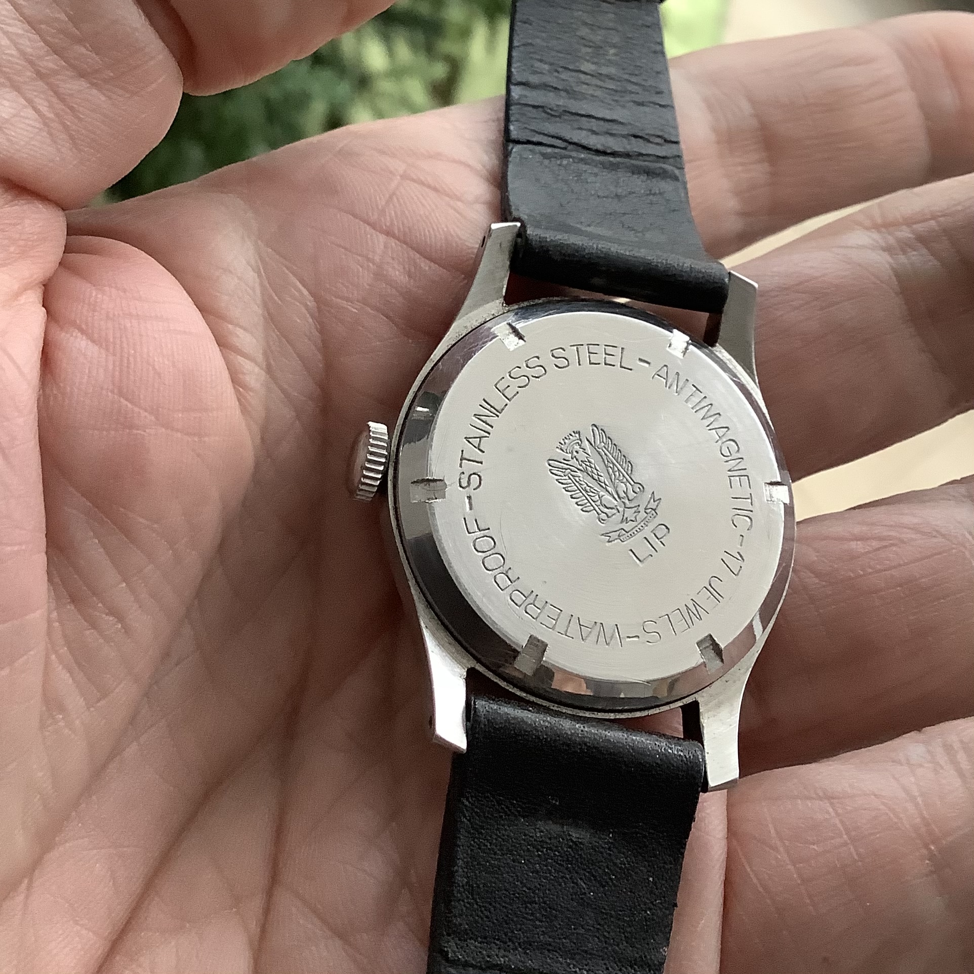

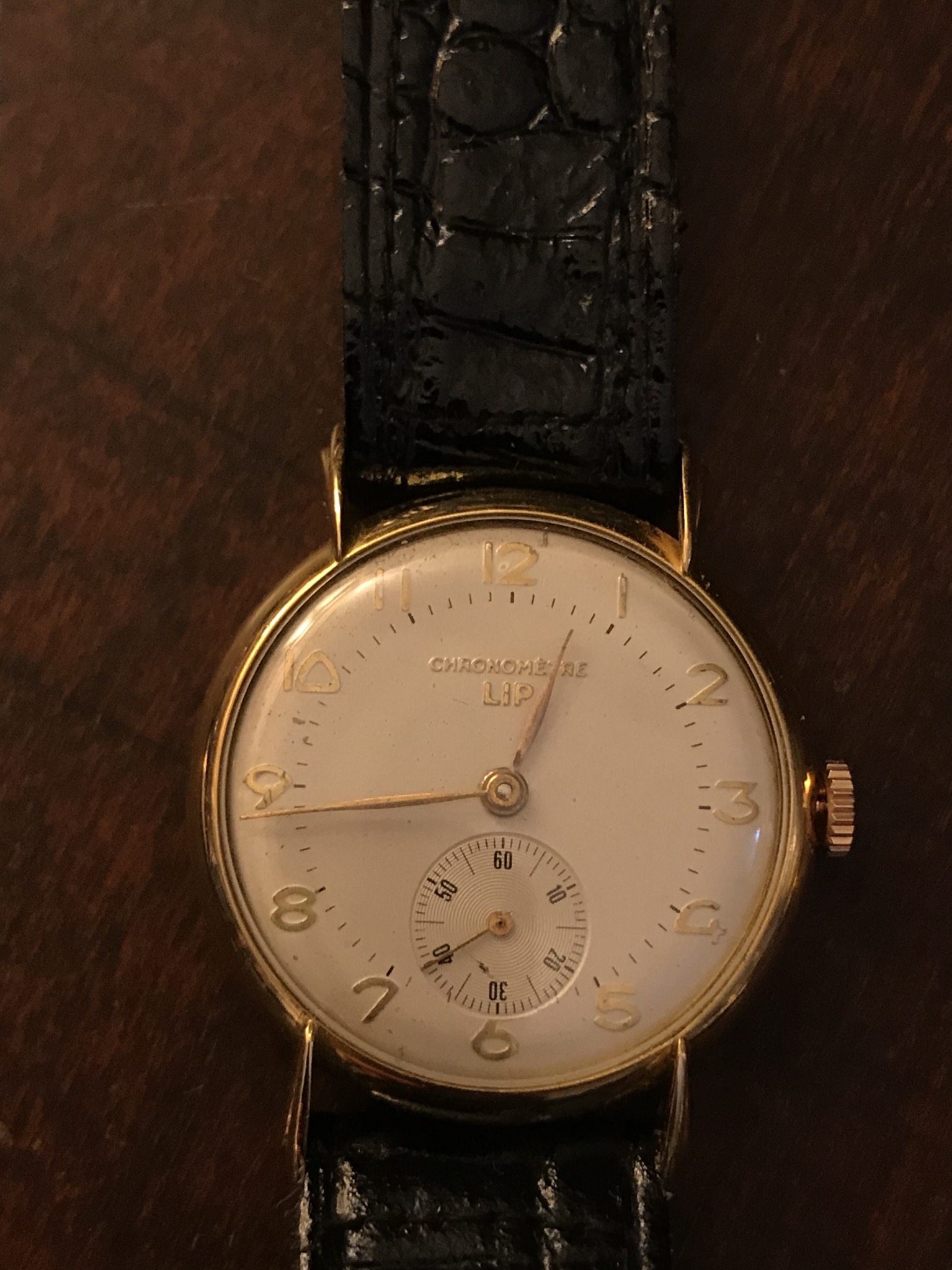

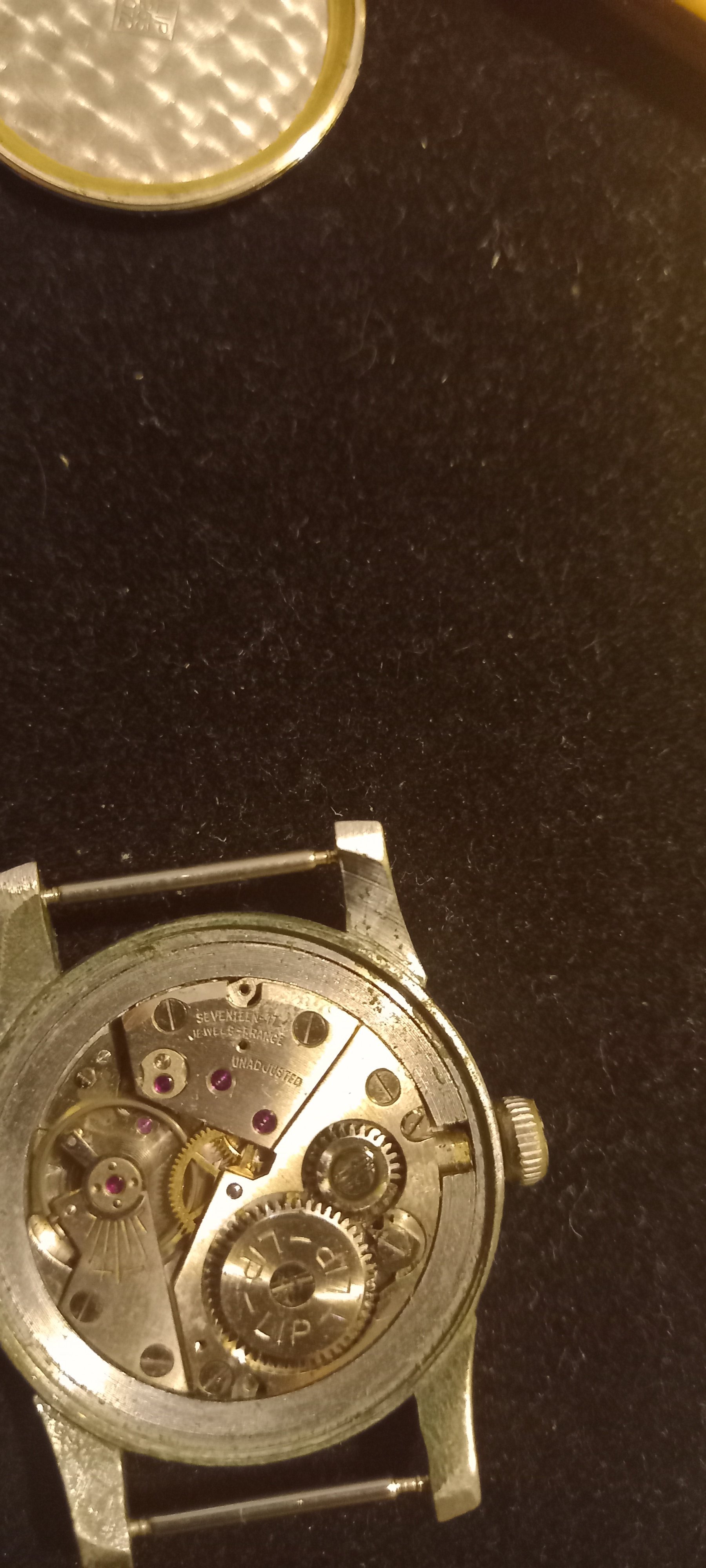

Looks nice! I guess there is a cal R 25 inside. I like this typical Lip back: strong and nicely stamped with Lip’s symbol.

My favorite movement, in a luxe version (18 ct gold), the R 25:

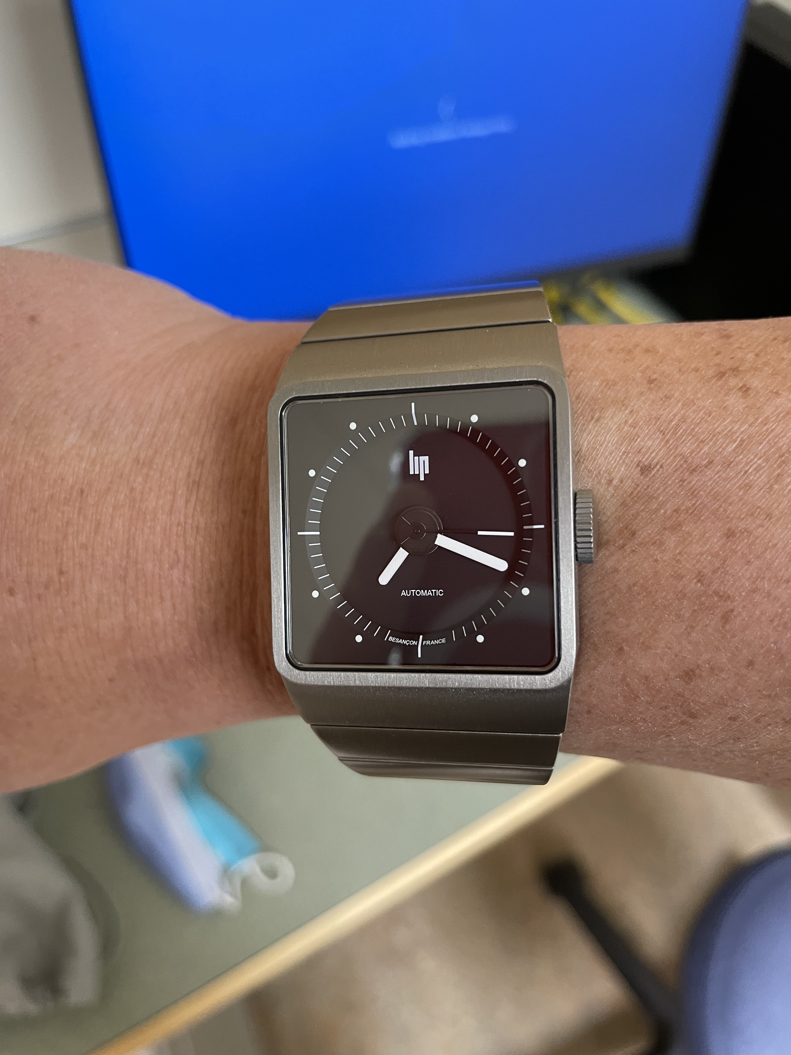

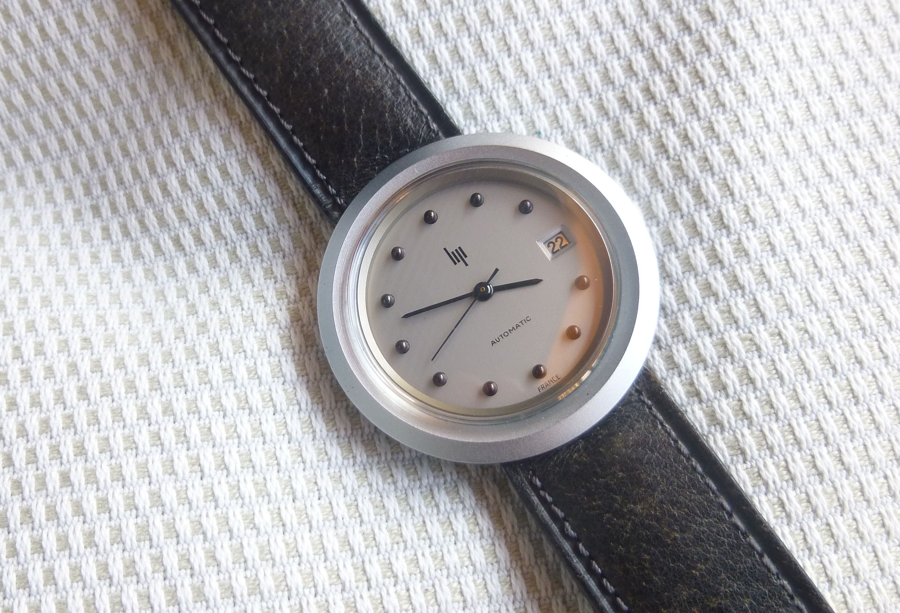

The design is cool. Miyota are no bad movements. Just that compared to the history of LIP, it's a little heartbreaking.
I like the titanium model very much.
