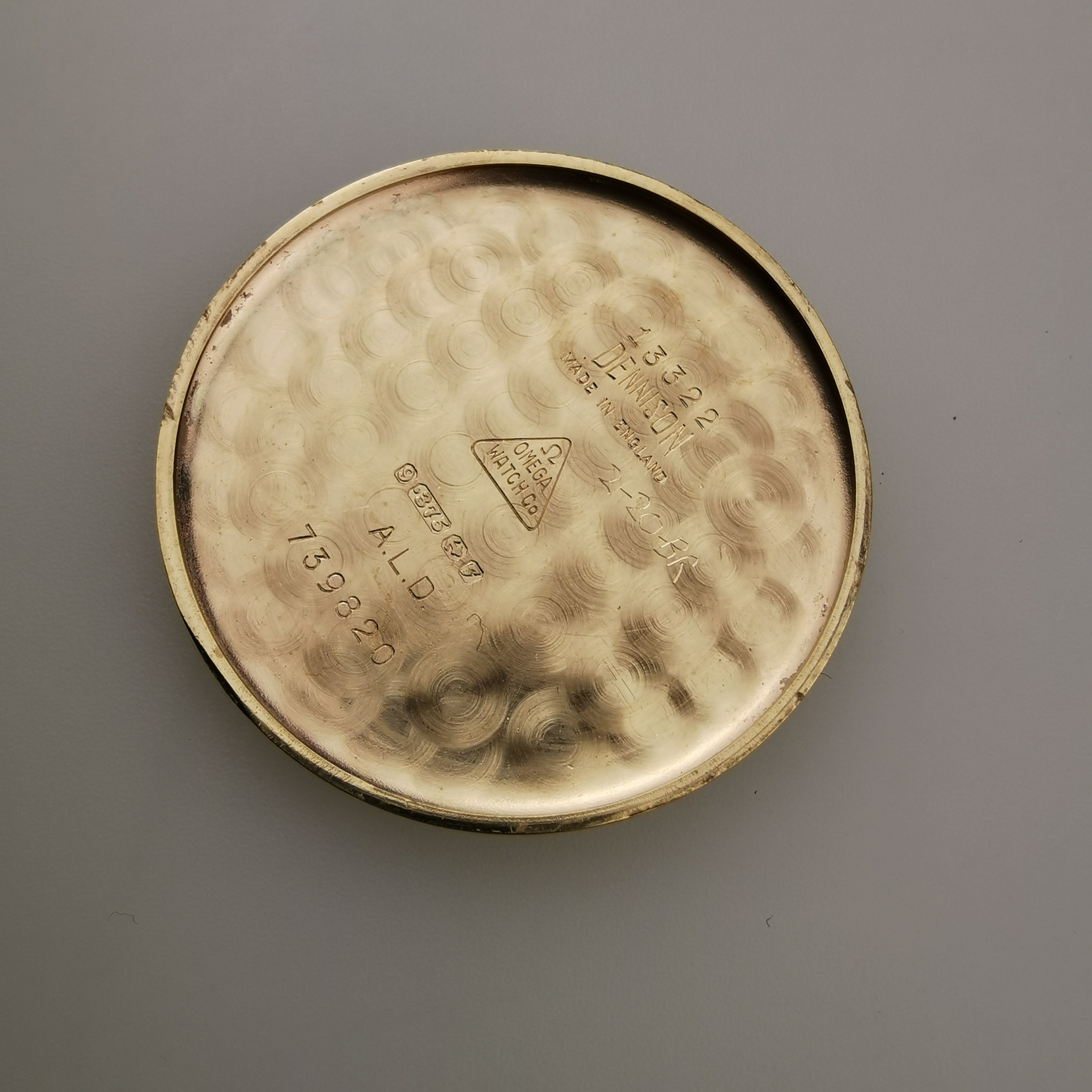

A movement and case back photo ?

Thanks standy I asked for caseback. They haven’t responded yet....

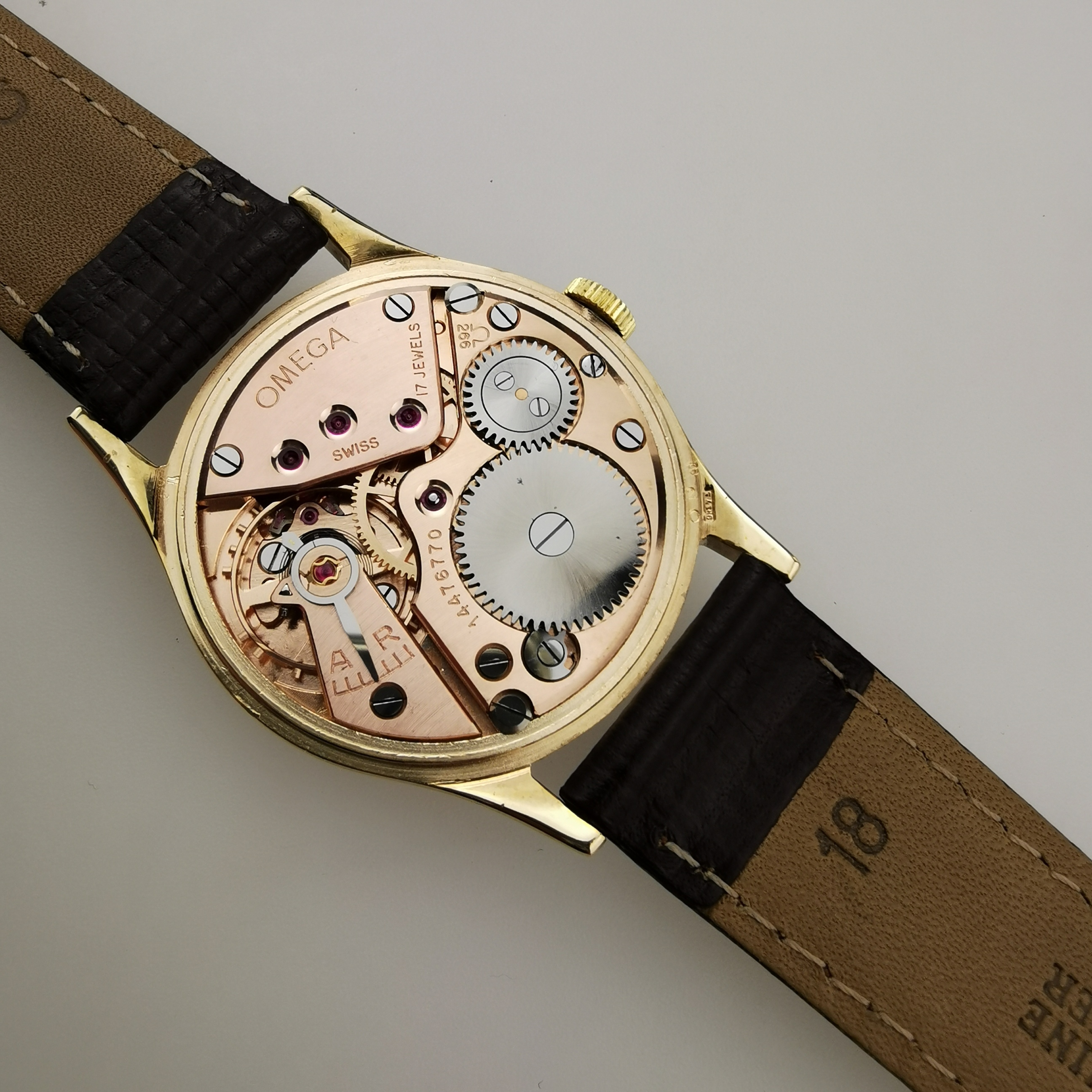

Well the movement condition definitely matches the dial condition which is always a good sign.

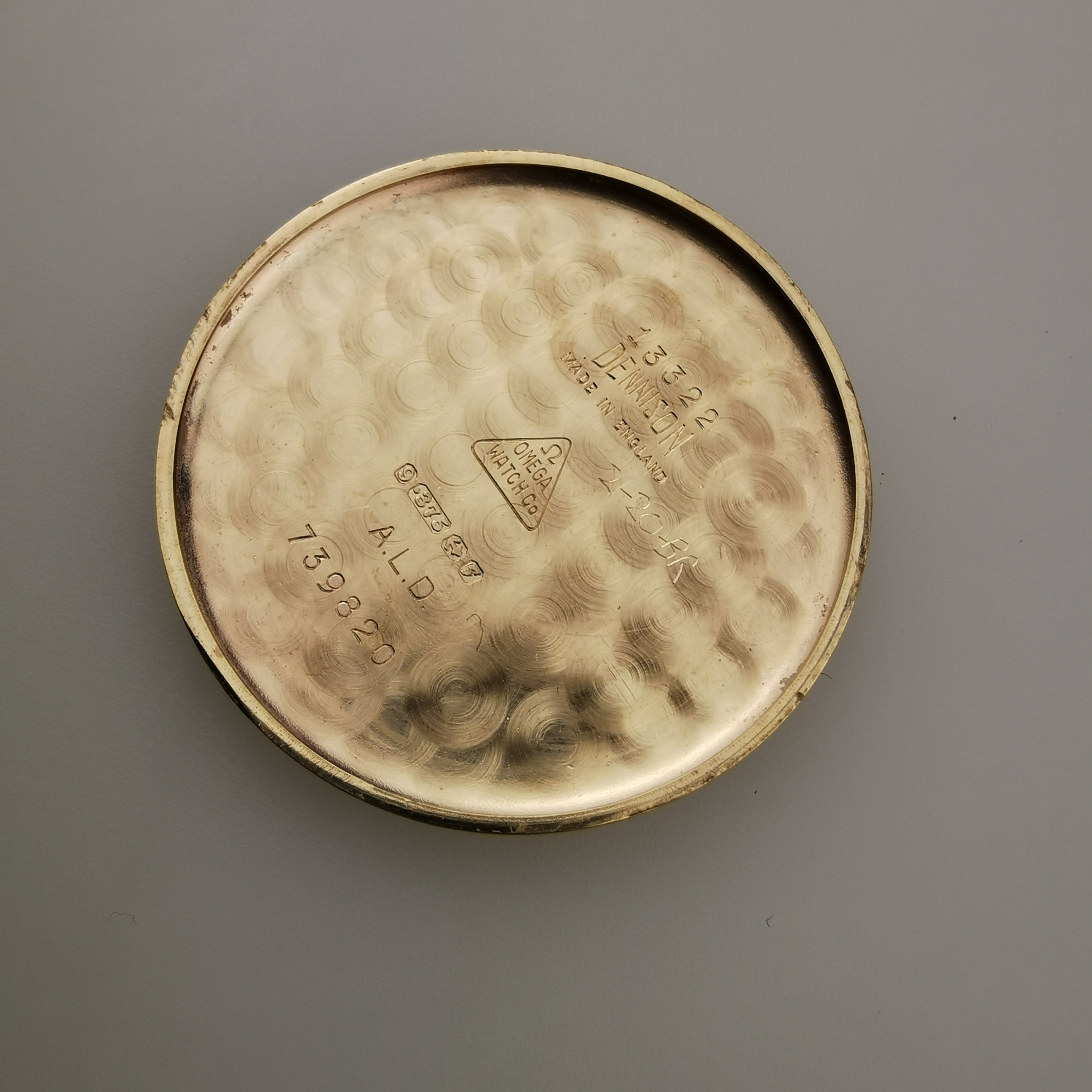

Y but now I see the assay mark on the caseback looks to be post 1975
Reference 13322 is a known 1950s Dennison reference.
What letter are you seeing for the date code?
BTW, I think the dial looks fine.

Tks x350. That sets my mind at rest. On the assay mark The stamp after the anchor i thought would be the date letter and it is illegible to me. The outline of the stamp does not match expected but it seems this isn’t a given.

Hallmark could easily be a badly pressed ‘F’, which would place it at ‘55/‘56
There have been other confusing examples where Dennison didn’t follow the accepted contemporaneous hallmark cartouche rules.
