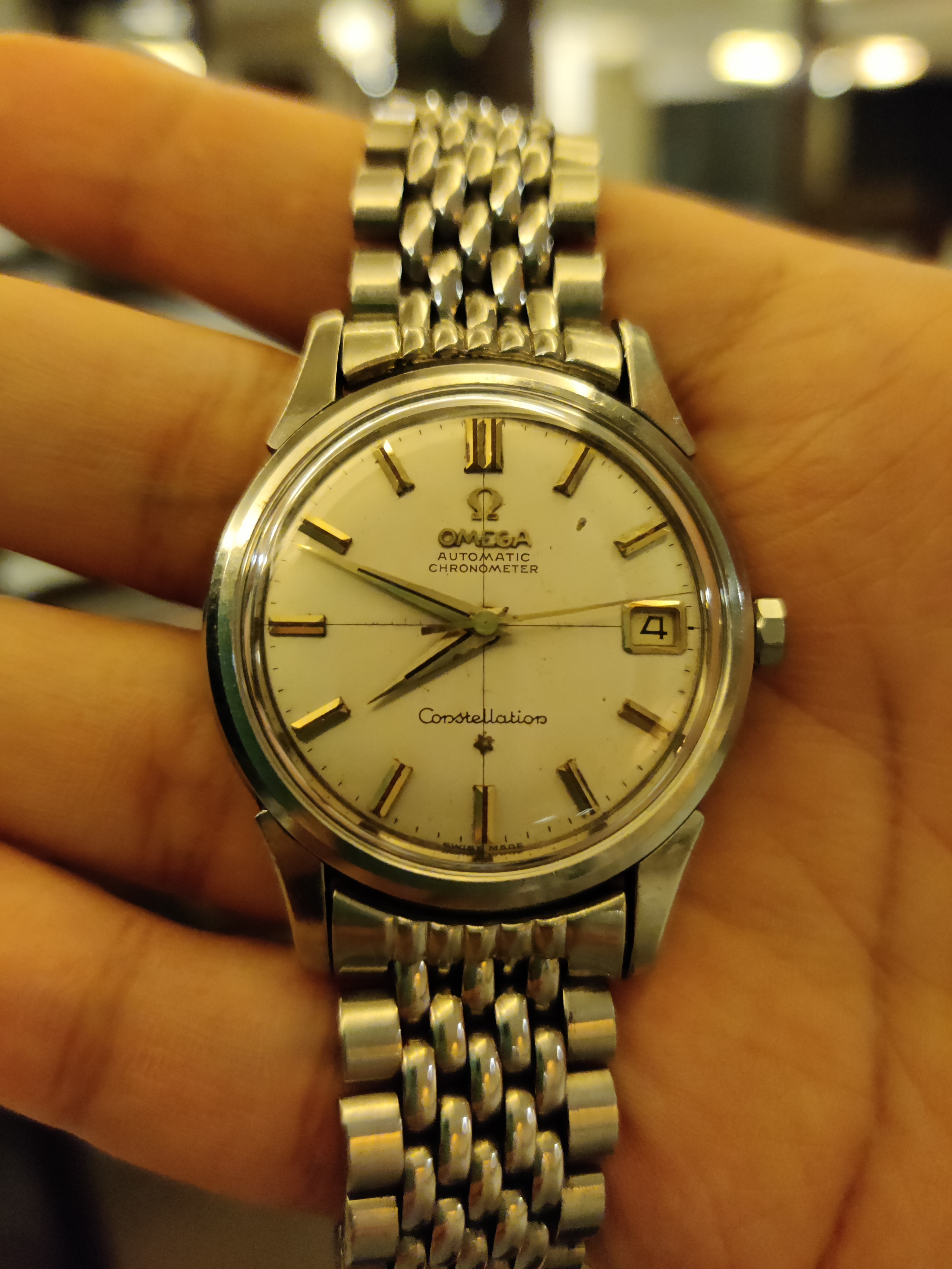

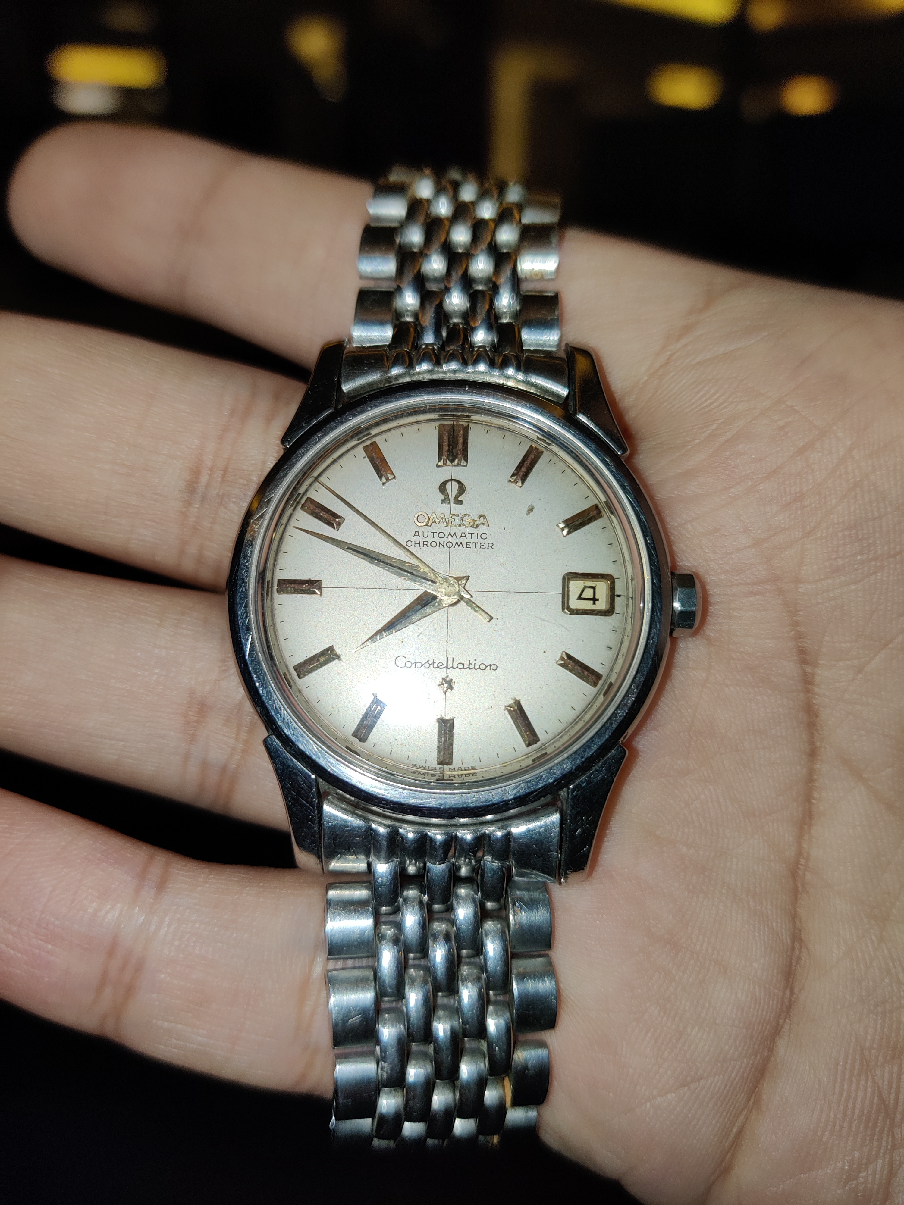

Is the right leg of the letter A of OMEGA too short? Or am I just too much of a perfectionist? 😀
2,298
3,157
Hands (no lume) and indices (lume) doesn't match
Printing on the dial looks correct
2,298
3,157
Take a look at the star too...
Seems to have been reattached, you can still the outlines of the original star position

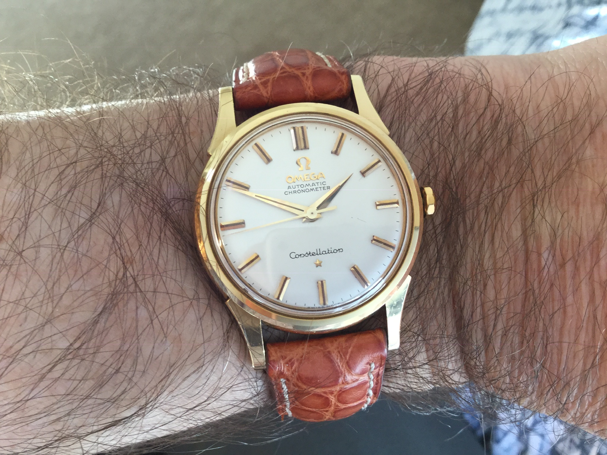

1,120
1,792
The star has likely twisted due to dial degradation. You can see the degradation going on around some of the markers. My Constellation has the same egg shell dial/markers and came to me with the same ‘wonky’ star issue (now corrected). The patina around the markers is common with this particular egg shell dial (approx 1959) whether Constellation or Seamaster. The star is an easy fix for a competent watchmaker.
