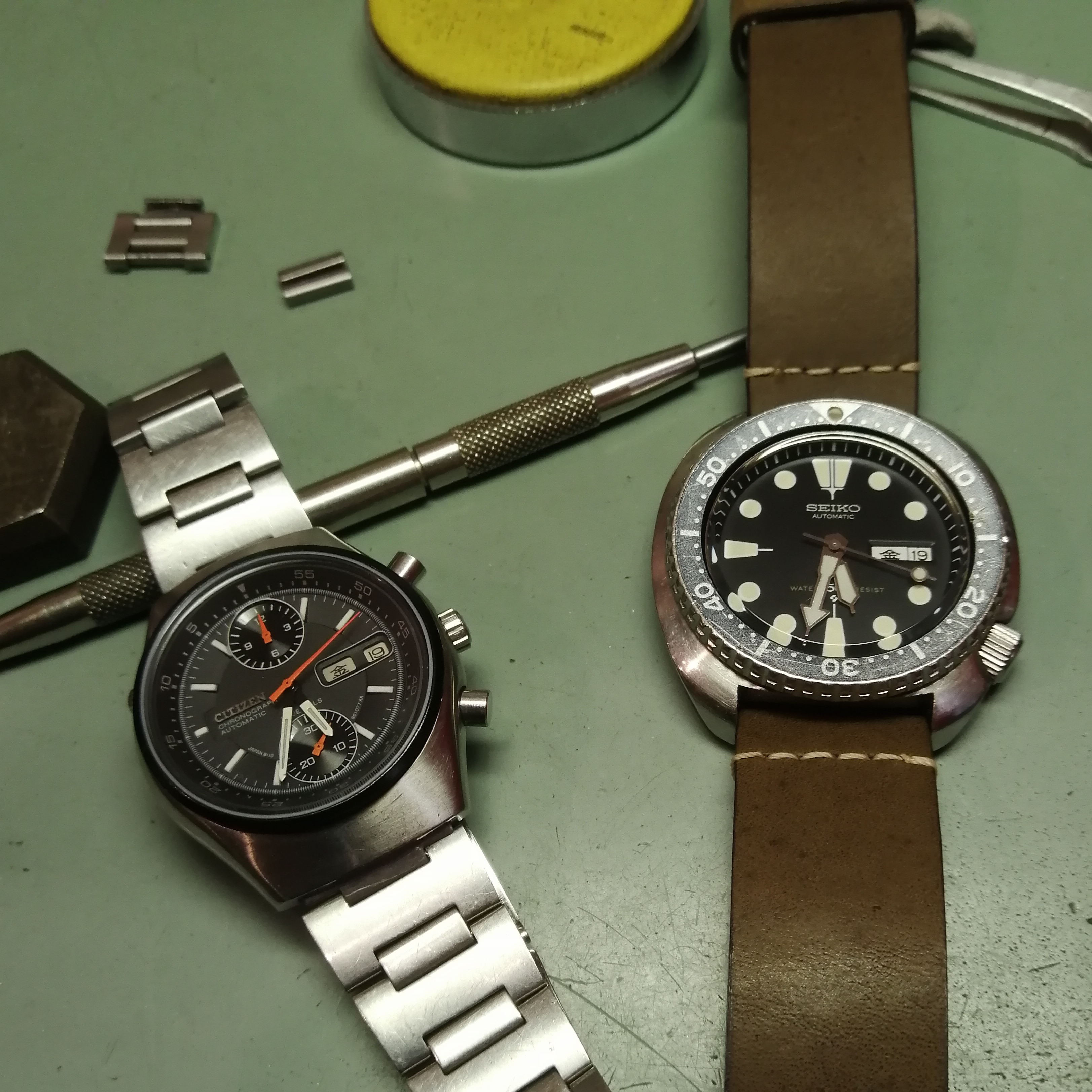

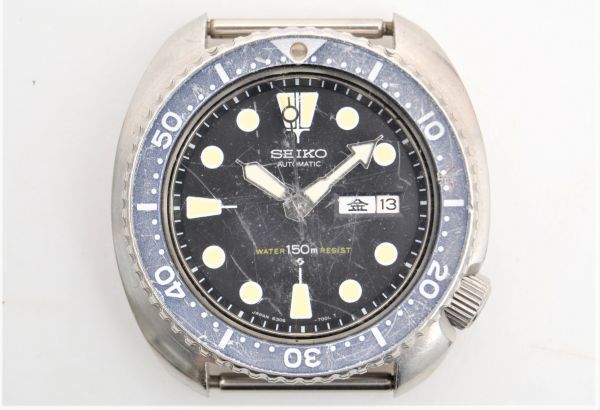

A pair of recents projects I just started:
The easy one, a 6306 with a cool patina, I'm waiting for it to start its trip from Japan. If I'm lucky it mostly a case of choosing a crystal, mineral or sapphire. Not too worried about servicing it. I tend to prefer faded blue bezels on those, and as those bezels were well made not many are ghosted like this. Scratched into oblivion sure, but faded not so much. It may look nice paired with the right strap...

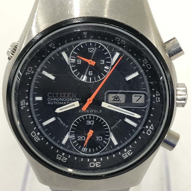

The not so easy one. Also mostly a crystal problem as it works OK but in this case I am not aware of any aftermarket crystal...
I could probably put a standard flat mineral instead but I would lose the bevel and I think it won't look great. I'm putting together from scraps a H-link Citizen bracelet for it too.
The crystal for the citizen is not perfect, but that will do for now...

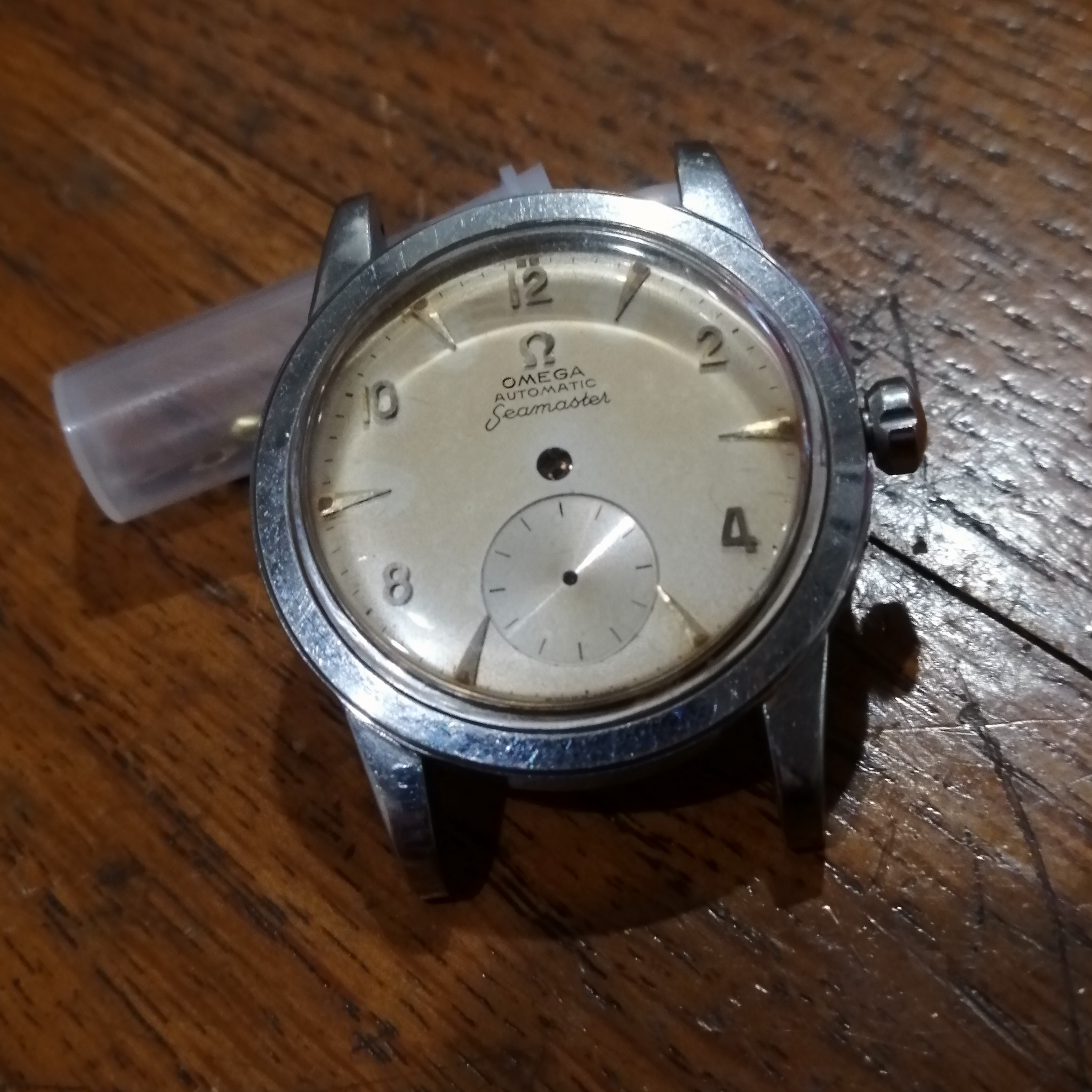

Some necro work...
Found a lone 2576 case marinating in a scrap pile, bought dial/hands recently (a very unexpected find), added a flat feet clover crown forgotten in a drawer. Still have to buy a complete movement, and find a better suited tension ring.

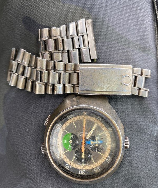

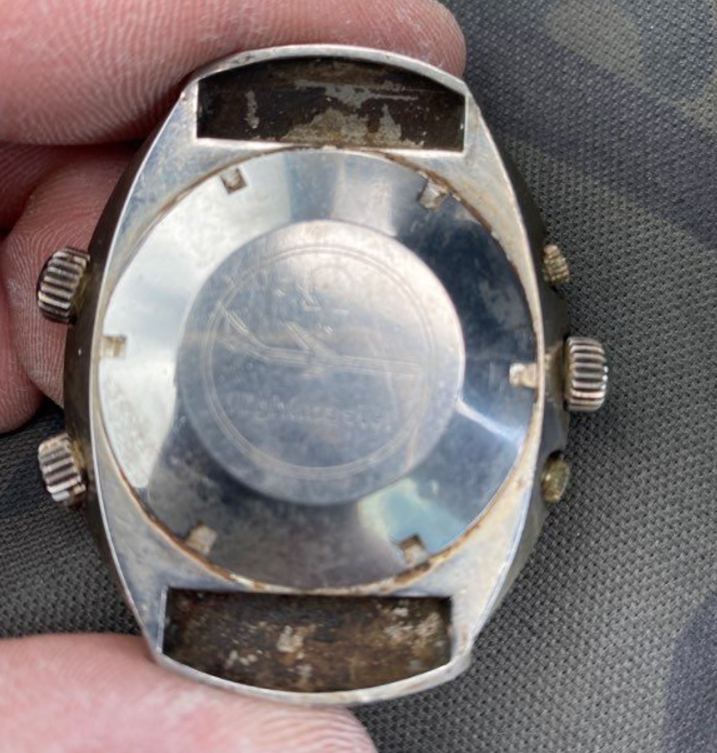

My new project : 145.013 first generation
Seller's pics (look at that gunk !!)...

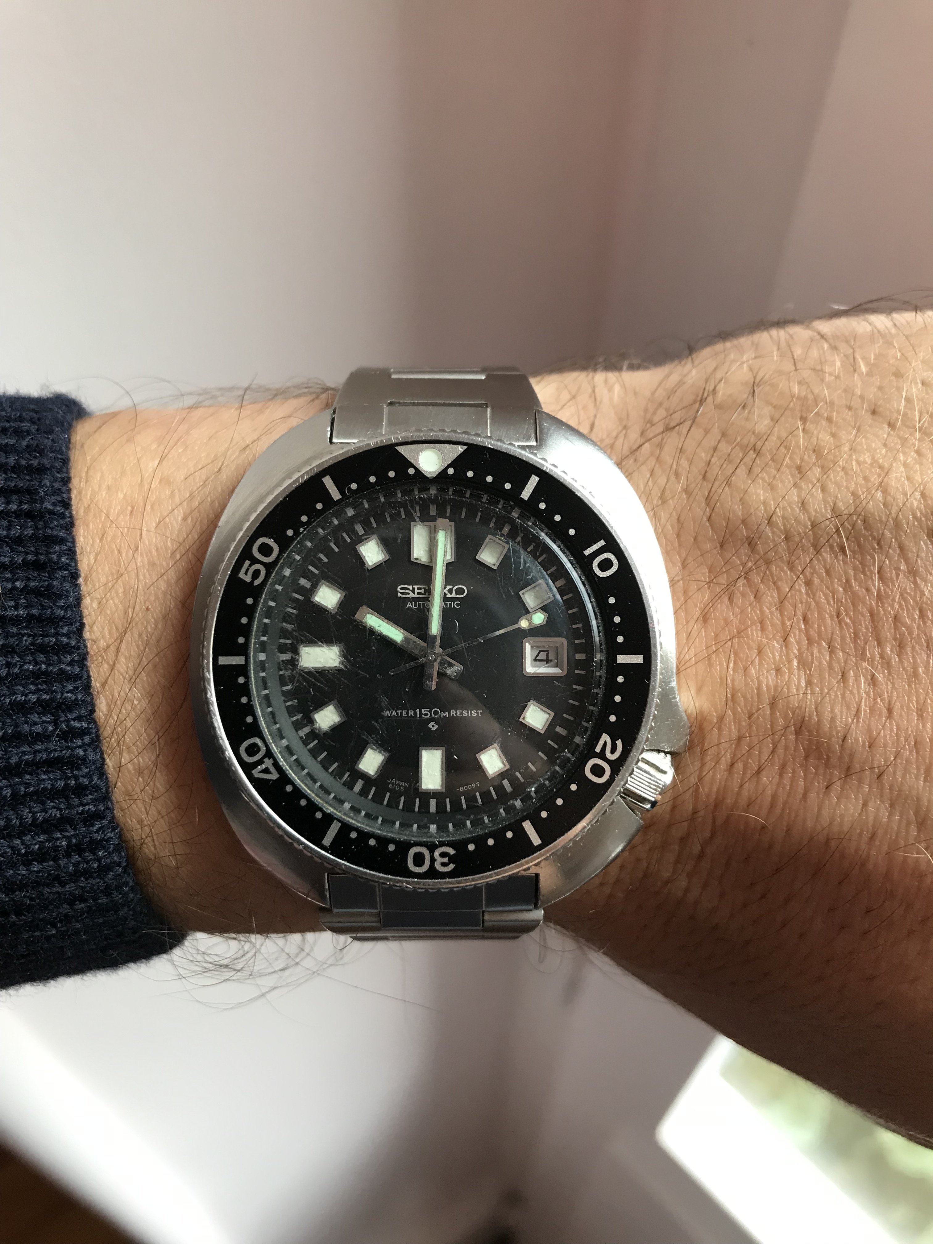

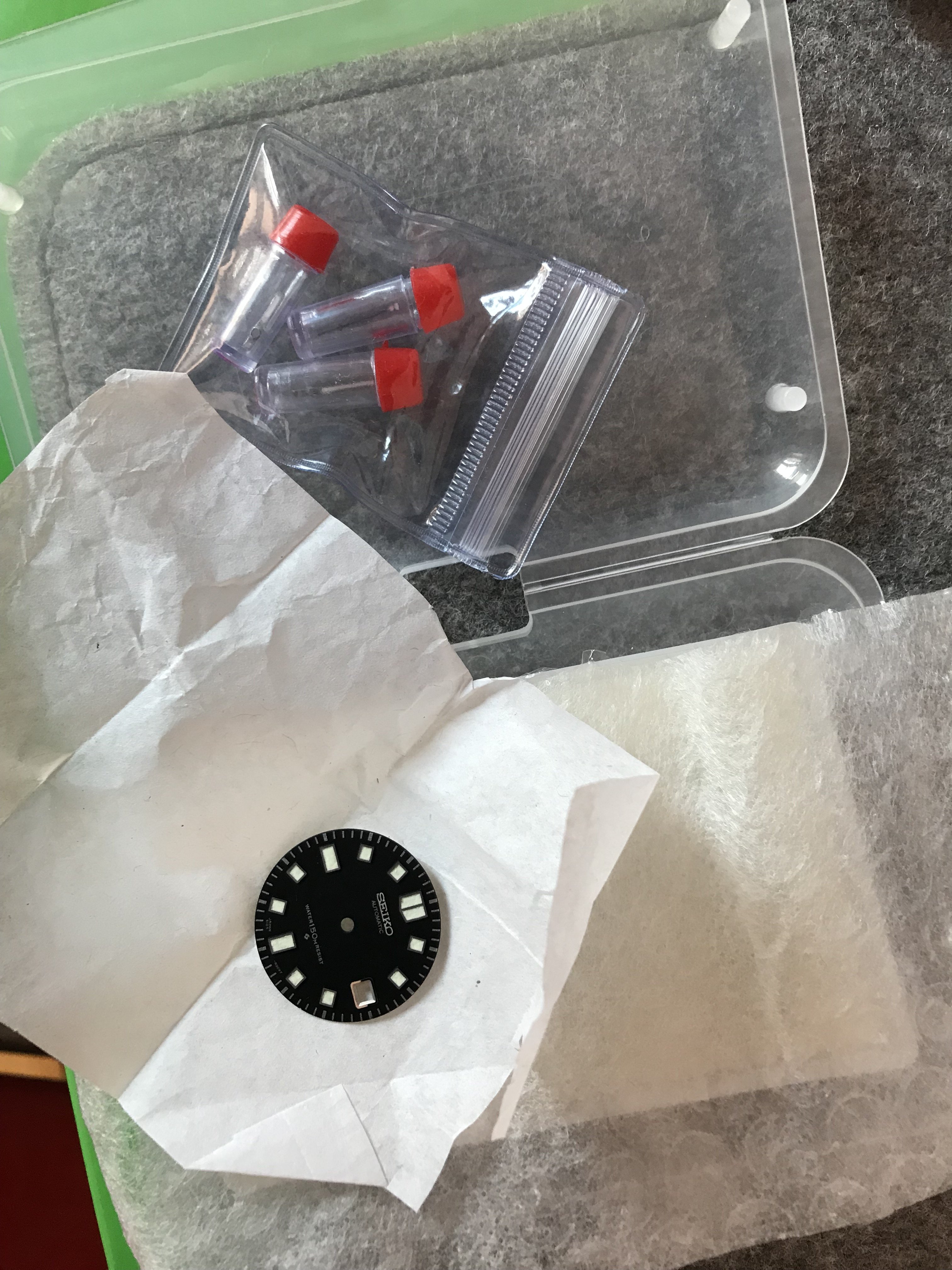

A seiko 6105_8110 in a very nice shape (case and dial, movement not needing a service, coming with original bracelet) from the son of the first owner but unfortunately with badly relumed hands (as confirmed by fellow OF members) so I had them relumed too with James Hyman in the UK and got a new crystal from Mr Klein in the US. All are sitting somewhere at my watchmaker for being put back together

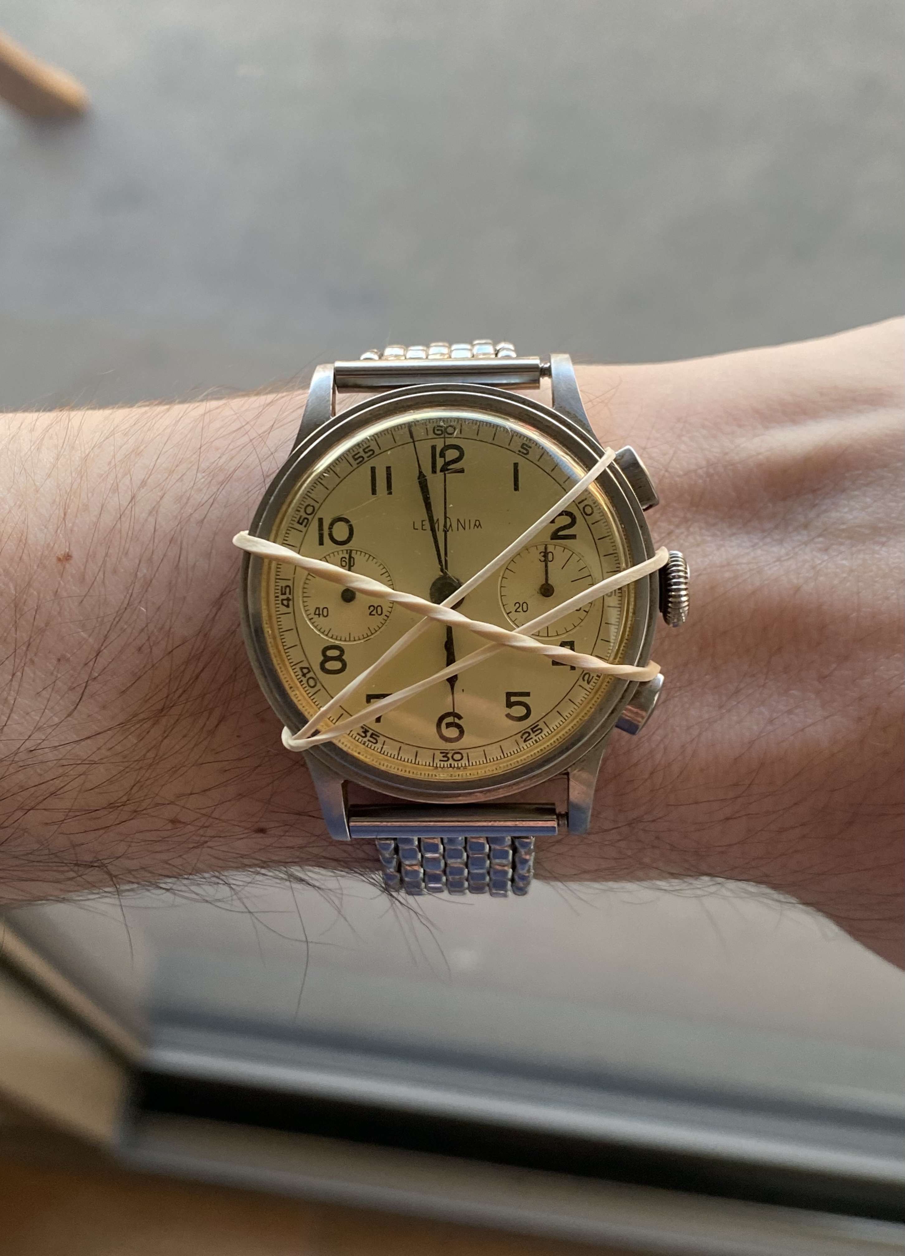

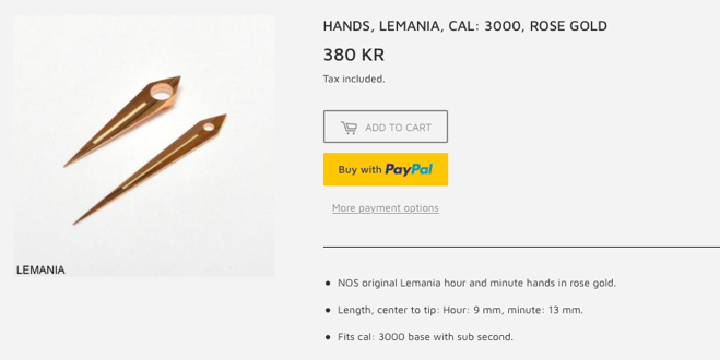

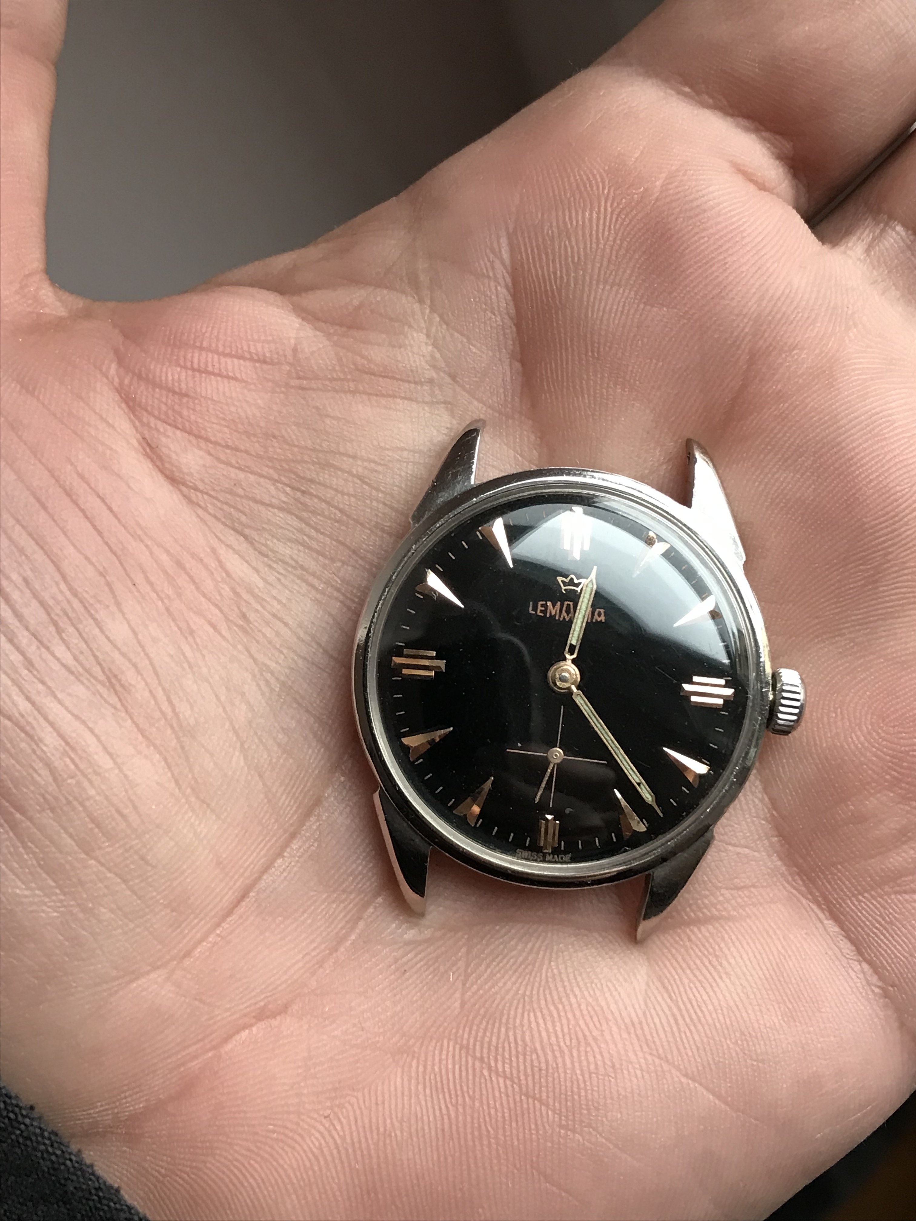

Another simple one : this one coming from a fellow OF member, a Lemania calibre 3000 with a very nice dial / indexes. After checking (thanks @Northernman ) it seems the hands were not correct so I got some NOS ones from the bay, again at my watchmaker for being reassembled together.

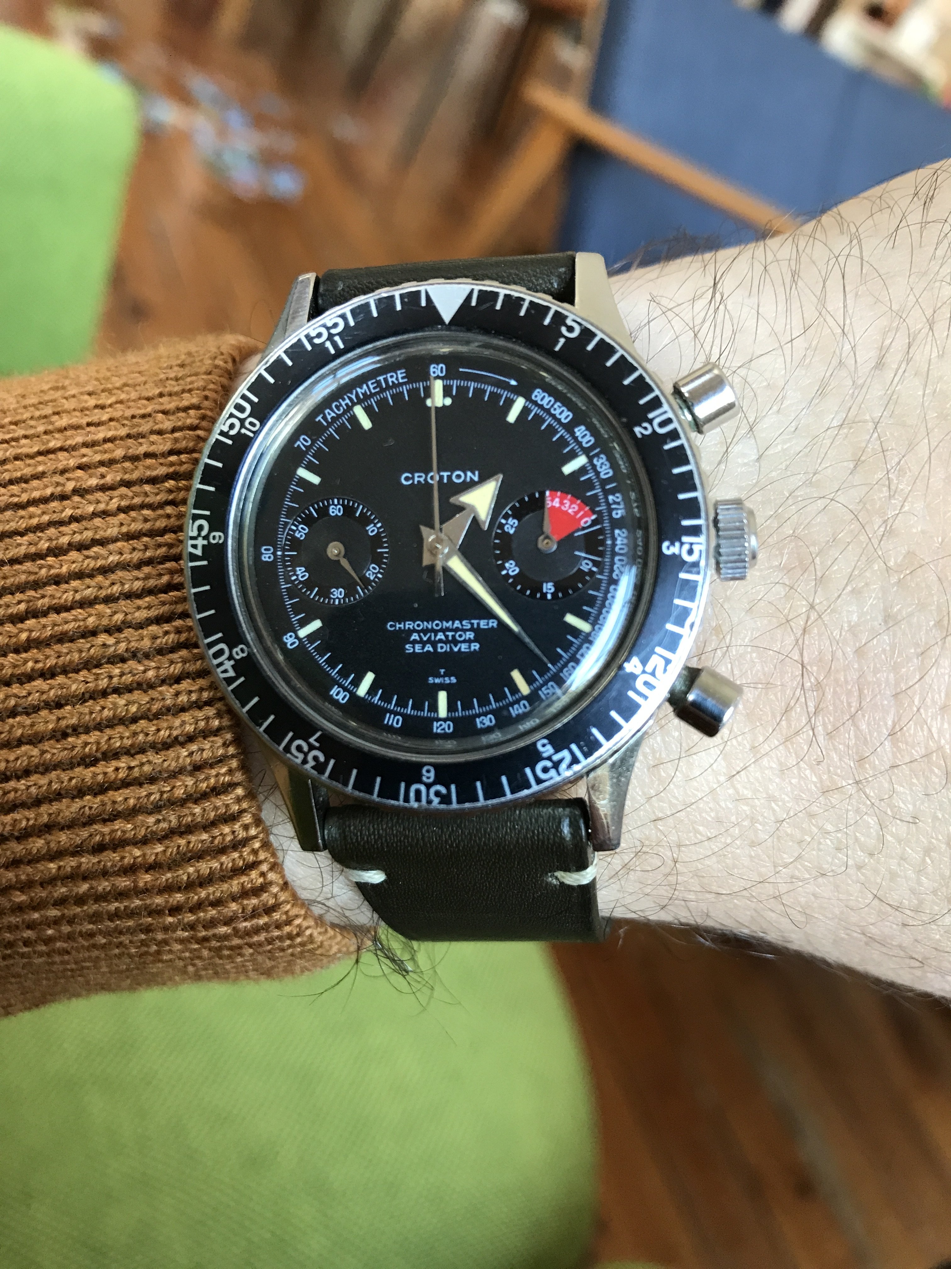

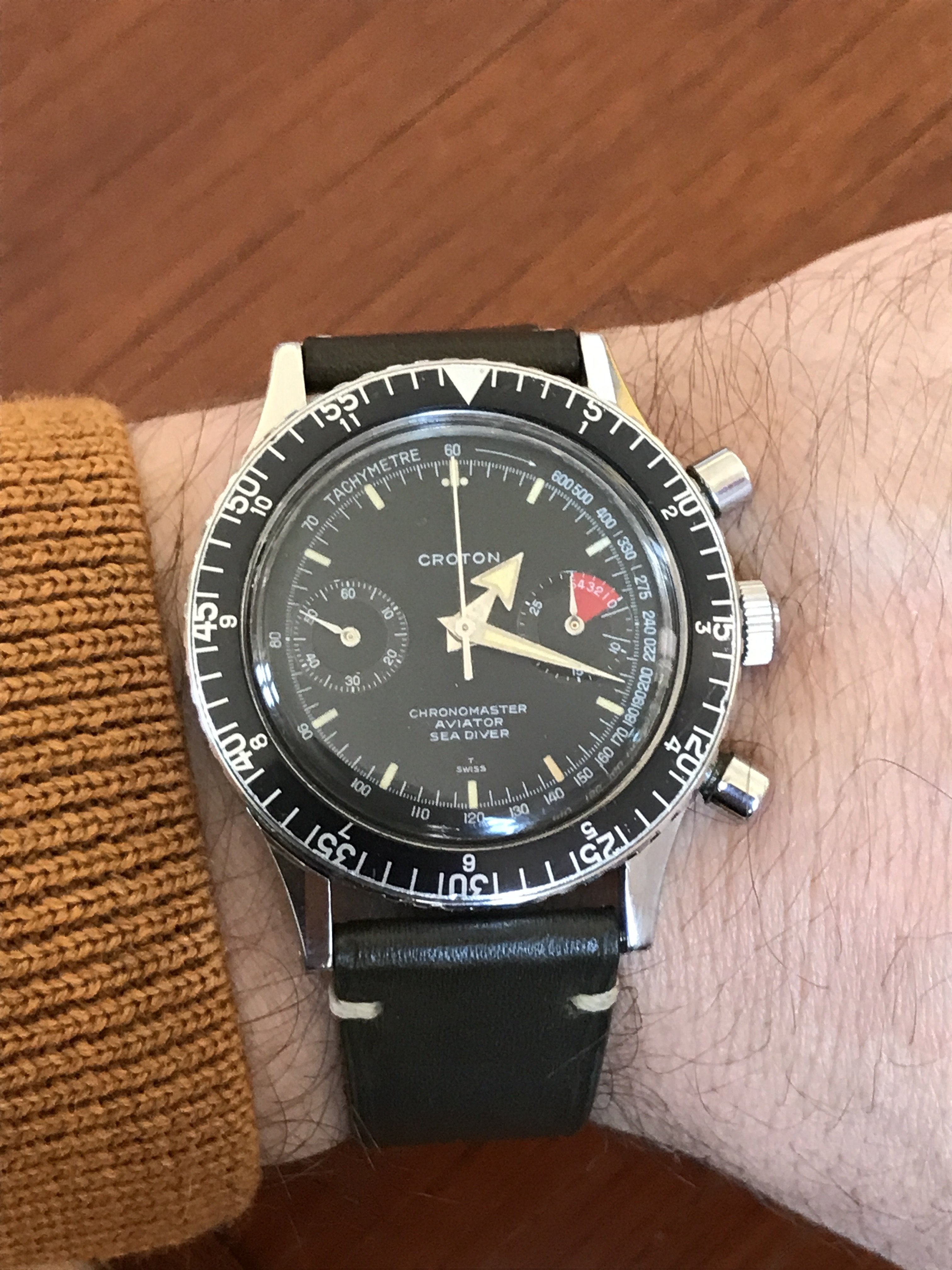

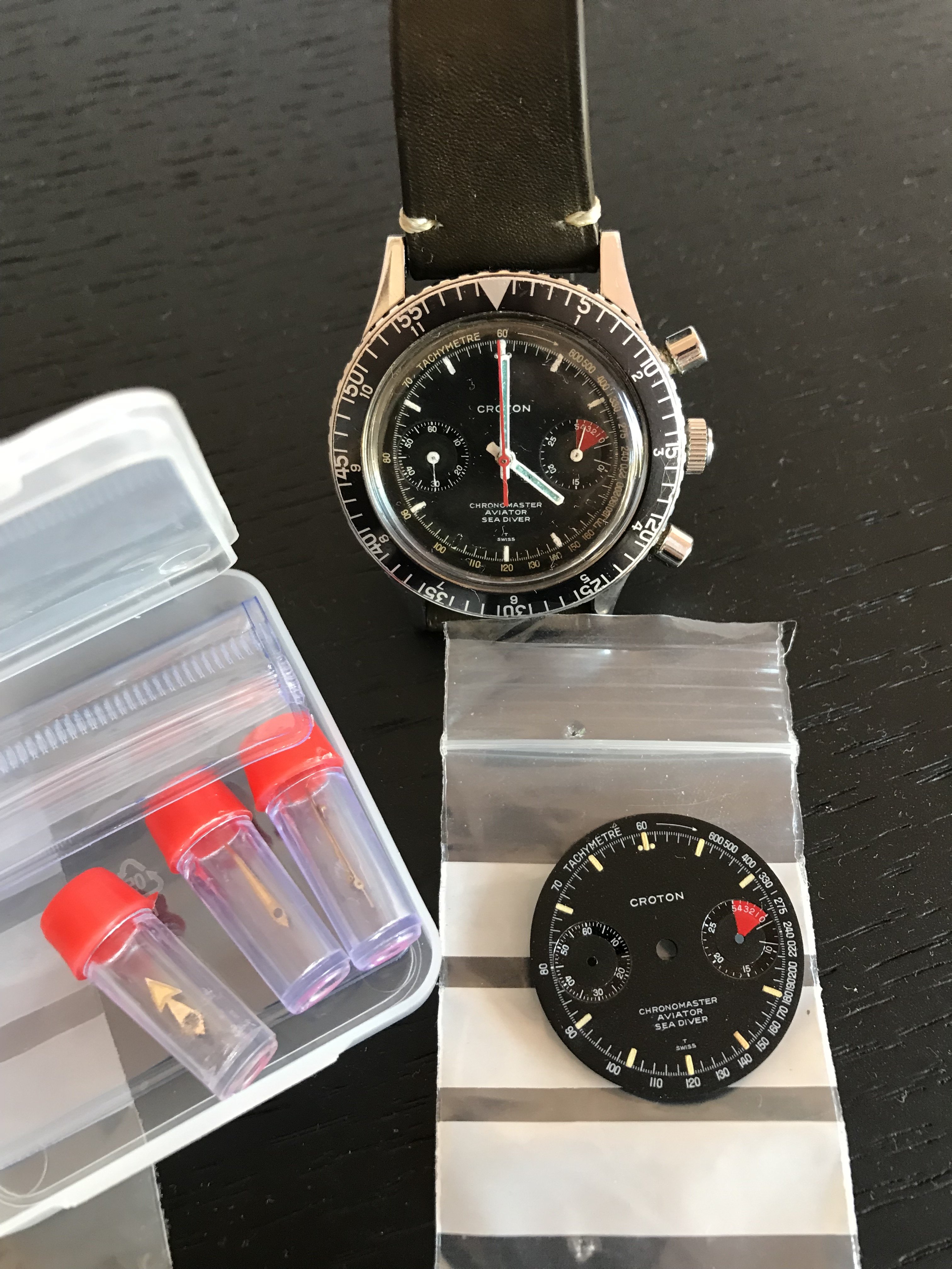

And the last project is a more complicated ? one with a long story that I've started mentioning in one thread. I'm now very close to finalize this but...not yet. To keep it short, I realized I purchased (before I joined OF) this Croton CASD V23 from a professional seller in C24 with the wrong hands 😡 (baton instead of broad arrow, I realized this thanks to this forum, this being later confirmed by the authors of 'chronometer only book', a book I finally purchased - should I've done this first). In the meantime while the watch was in for a service with the previous local watchmaker during the first covid wave, it lost some lume from the indexes😲, when I got this back the watchmaker had retired 😲. The good thing is the V23 movement is in a nice shape.
So chronologically, here is what happened in my quest to put it back to its original glory :
- I luckily found a NOS dial - exact match - through C24 from CH, 😀
- got my WTB thread partly answered by a fellow OF member with the hour and minute broad arrow hands from US, 😀 but without any lume left.
- send those hands to the UK to... yes you've got it James Hyman, 😀 who did a great job reluming them and 'cleaning' them.
- worked with him to find some fitting subdial hands from eBay that he managed to 'un-blue' by nicely polishing them, 👍 (and there again I got some good advice here in OF)
- send all those to my watchmaker to finally realized that the hour hand was not fitting correctly and so I had to look and find a new hour column wheel 👎 which I did 👍. (Thanks internet as I'm really not an engineer type of guy but you find everything nowadays, unfortunately that was not my watchmaker who really helped me here but some fellow OFmember again pointed me in the right direction : thanks @Archer)
- and now that it was all for reassembly then again my watchmaker tell me the sweeping central chrono hand is too long... Having checked on the eBay seller ad, it is said that it should be easy to cut to the correct length... I'll see if this can be done properly.🙄
Those project looks like 'house' project when you know when you start but don't know when it will end 😉 I hope I will feel 'proud' of myself when this watch will be back to the look it had when it left the factory (BTW I'm still interested in original subdial and central second chrono hands in case someone has that...)
Anyway that's what is in for me right now.
Have a good day
Finally got my croton CASD back with correct original broad arrow hands !
Feel very happy with that
Another shot for good measure
HOW can a watch become like this?? it just boggles my mind? was it dipped in tar? 👎😁

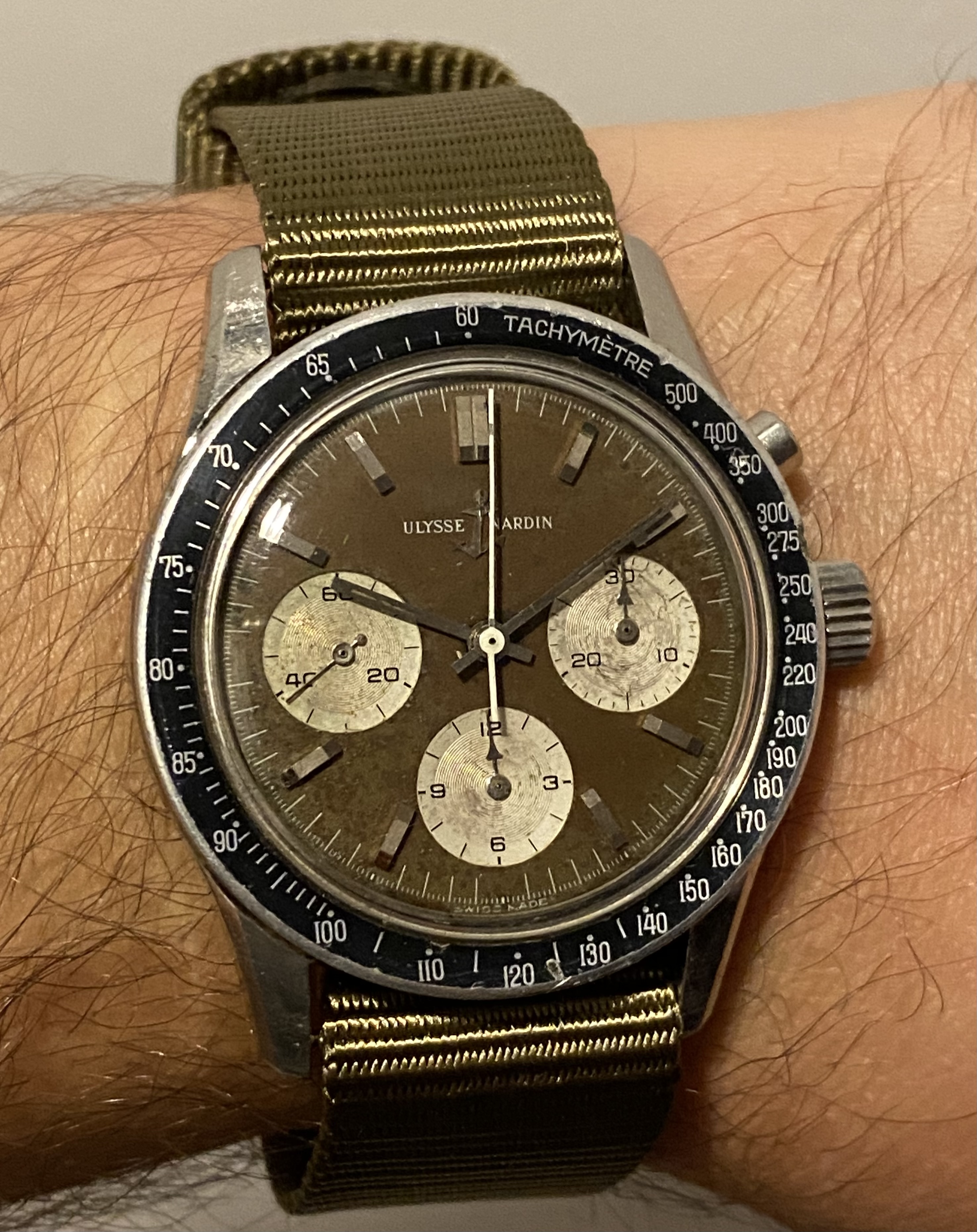

This bad boy needs a pusher and correct crown as it currently has an IWC fish logo on it. To be honest I have no idea where to start looking as I assume these parts are as rare as hen’s teeth, or maybe they aren’t, after all the correct crown is blank.
My best bet would probably be sending it a reputable watchmaker in Switzerland who would need to scourge vintage part suppliers with the hope of finding the correct parts, but it could be counterproductive to send it without the certainty that they are available. Any advice or recommendations would be appreciated.

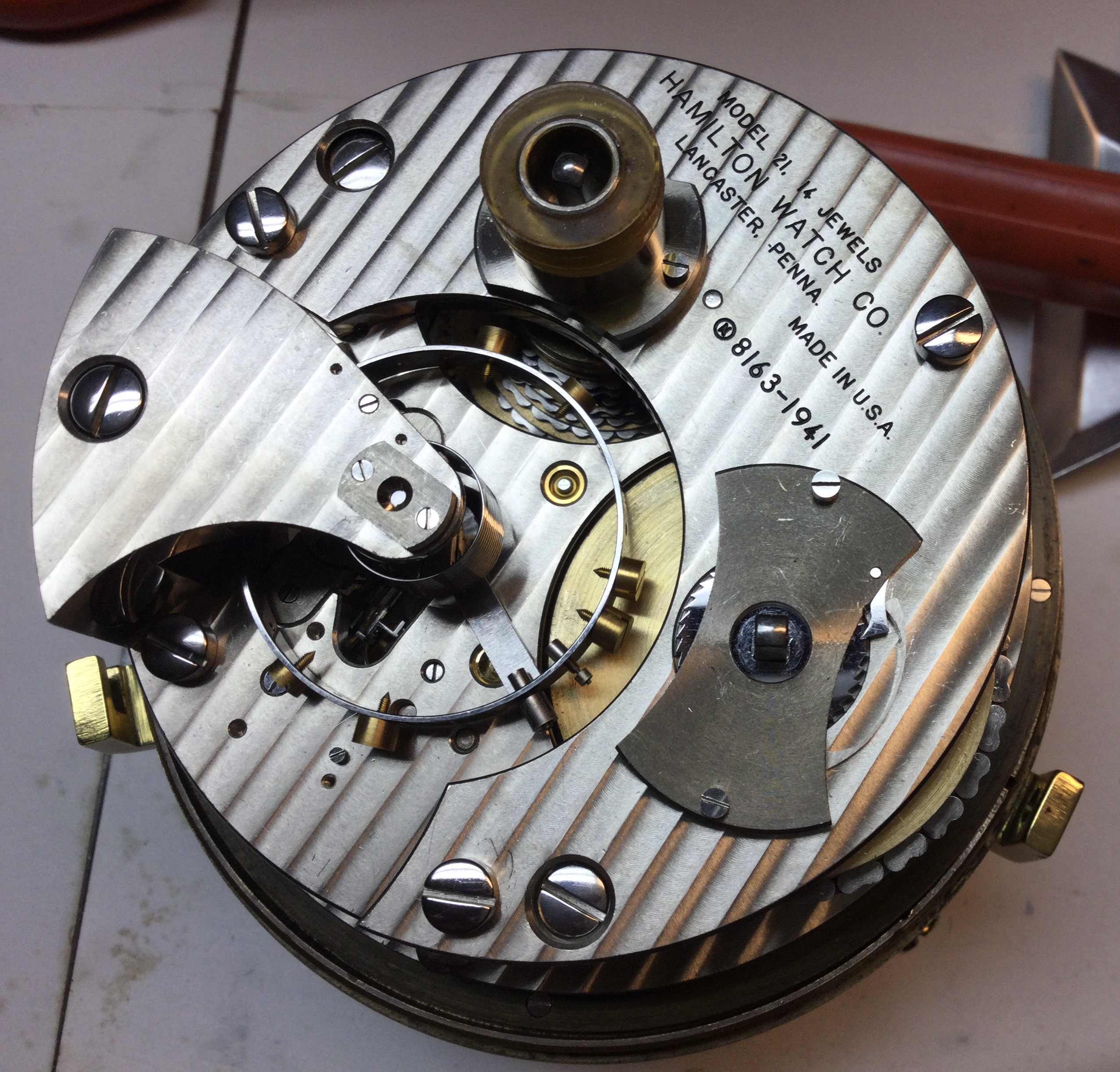

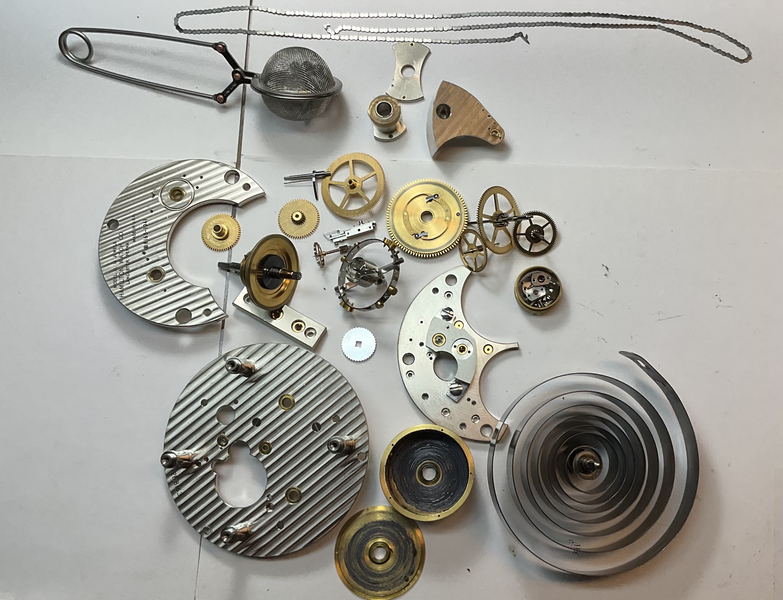

This project is a Hamilton model 21 marine chronometer that recently found a new home. Built by the Hamilton Watch Co. in Lancaster, PA., It has an Earnshaw detent escapement, 85-size, 14-jewels, key wound, key set, 14,400 bph escapement, chain-drive (fusee), runs 52-hours on a wind, one of approximately 10,500, this one was made circa 1947-48. It is fitted into a mahogany cabinet with gimbals, I serviced this chronometer in the mid 1980s for a friend, now deceased. By an indirect route involving the Omega board, the new owner became aware of the existence of this chronometer, and the pieces came together. I will service the chronometer before it finds its way to the new owner. Here it is, almost entirely dismantled, awaiting instructions to proceed with the job.

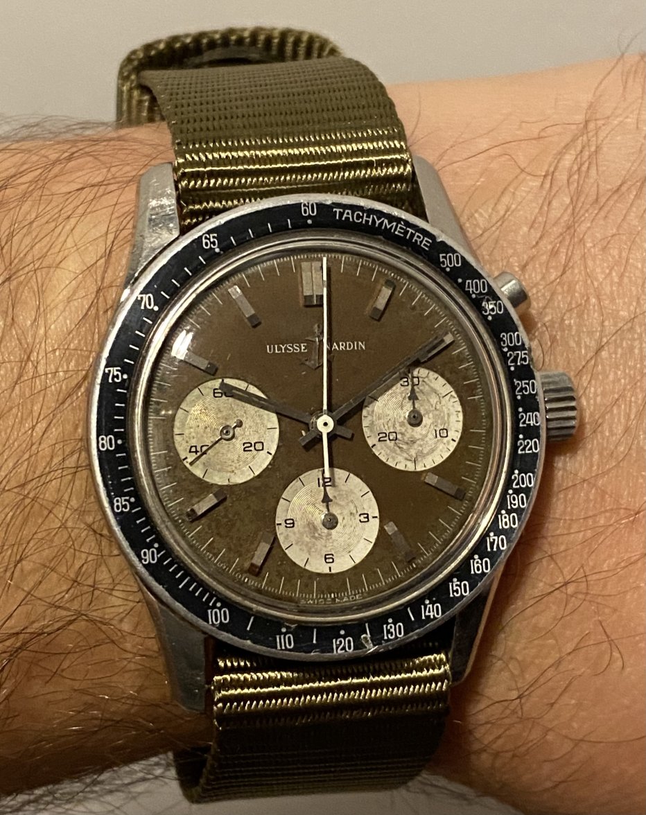

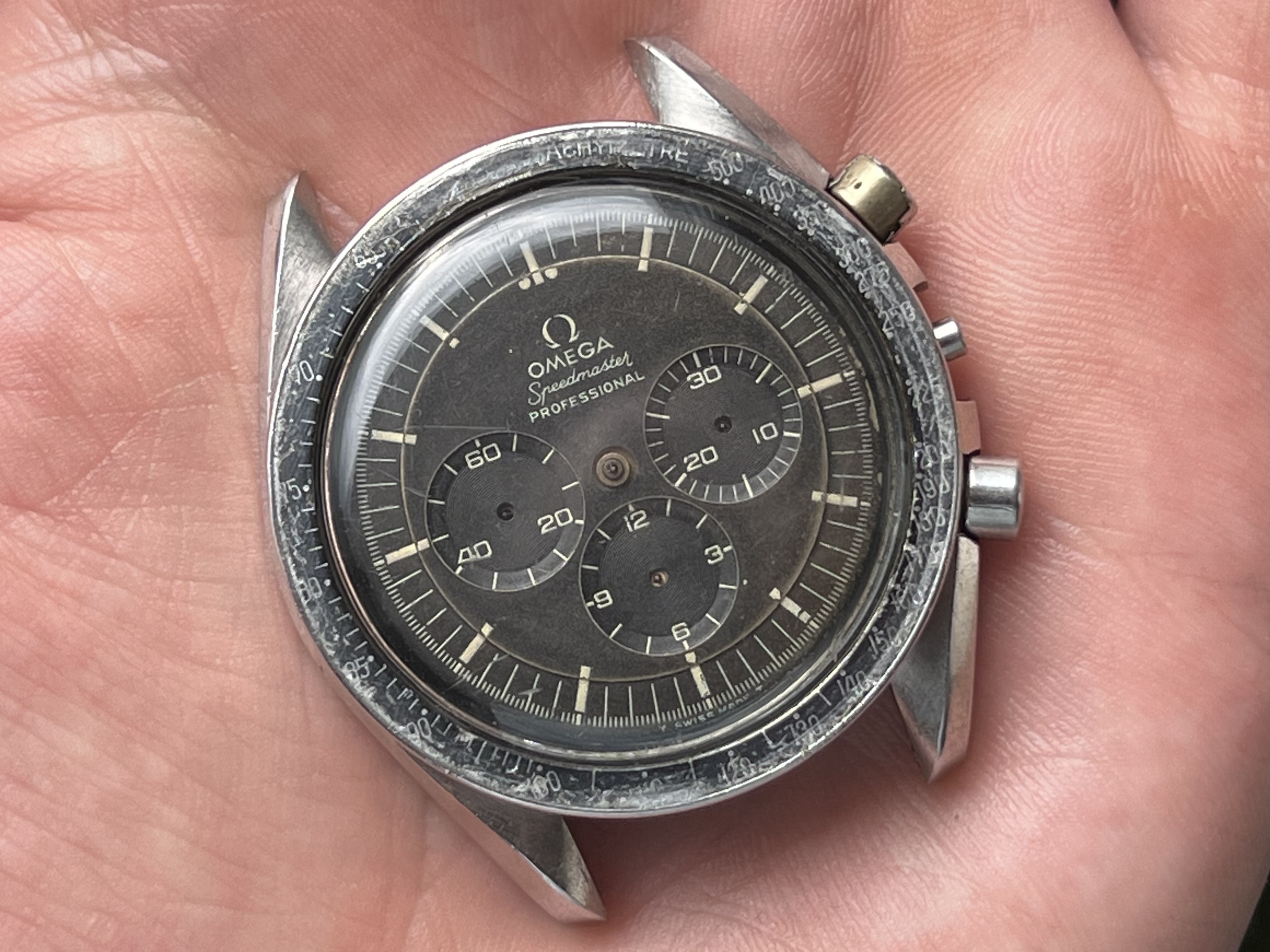

I like my dress watches to be in very good shape and certainly don’t say no to a Speedy that’s well preserved. In fact, my birth year example is in incredibly good condition and I do cherish it.
But there’s just something about an aged, well used example. I’m well aware this isn’t to everybody’s taste, but the combination of a brown-ish dial and a grey bezel just speaks to me. The case has dings all around but certainly isn’t overpolished, the dial is not out-of-the-oven-brown but unevenly, naturally so. The bezel has lost much of its color and looks like it was in a couple of motorcycle accidents. And still:
The right pushers and crown are on their way to me, so is a hand set. Can’t wait for the parts to arrive, to hand it over to my watchmaker and have him work his magic.
This one certainly won’t be pampered. It hasn’t been for the last 50-odd years, why should I start now. Looking forward to causing a ding or two myself. 😀

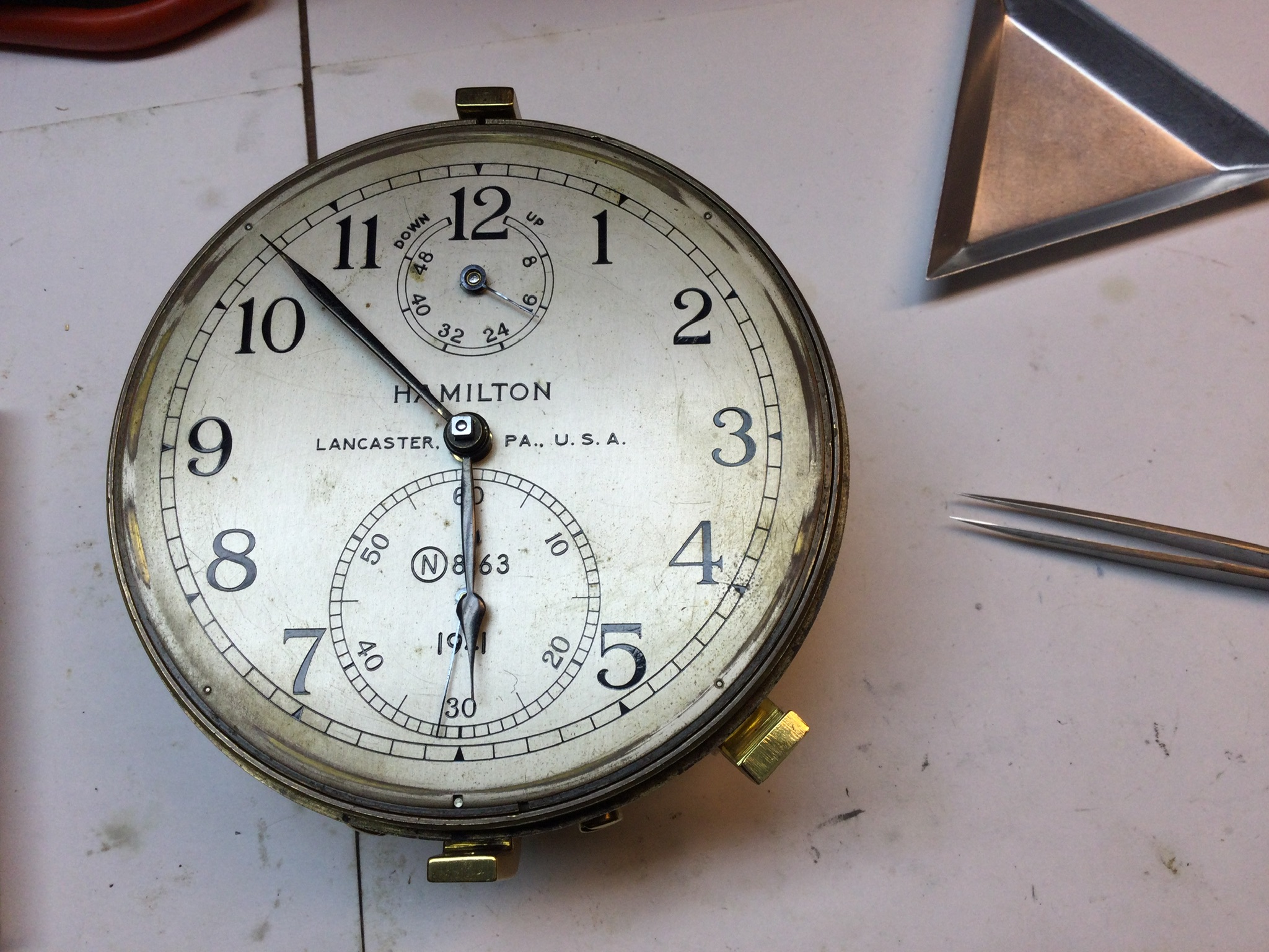

Parts arrived. Project almost finished. Test run out of the case for a few days, then case it, package it, and ship it to its new owner in California.
What a great-looking timepiece.
15,996
48,111
They are outstanding. Look for more when it is finished.

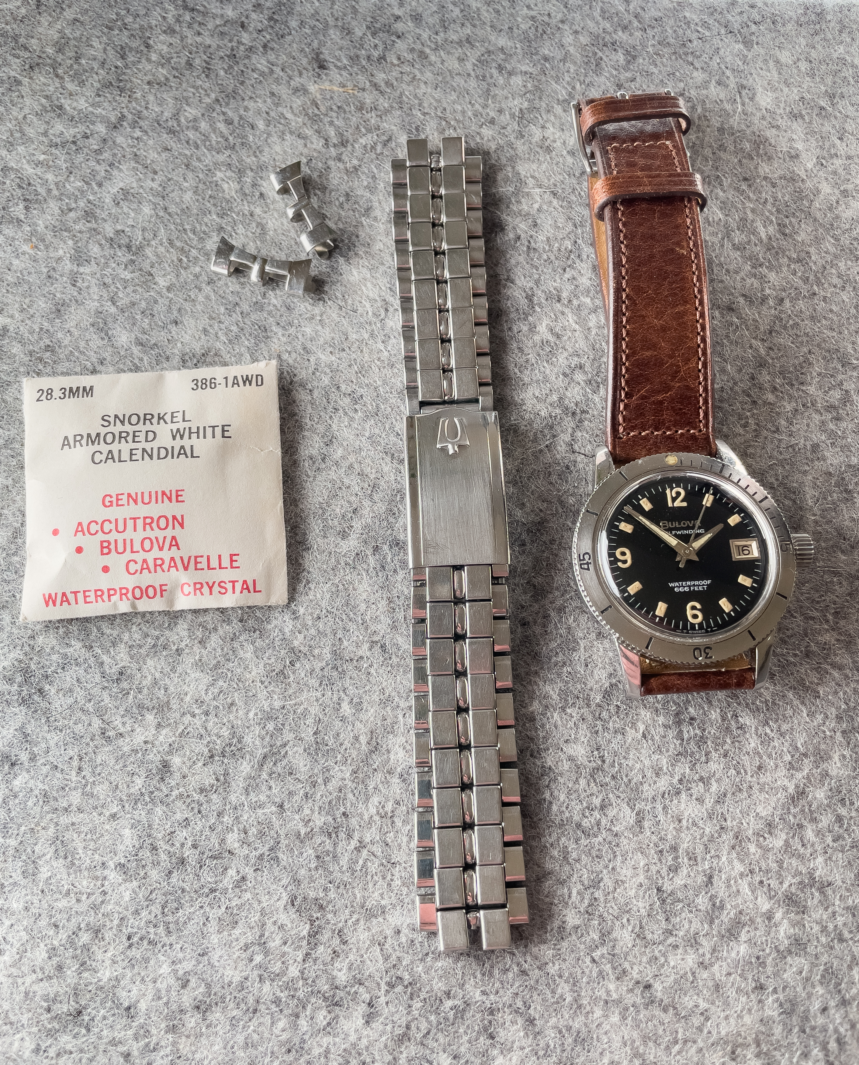

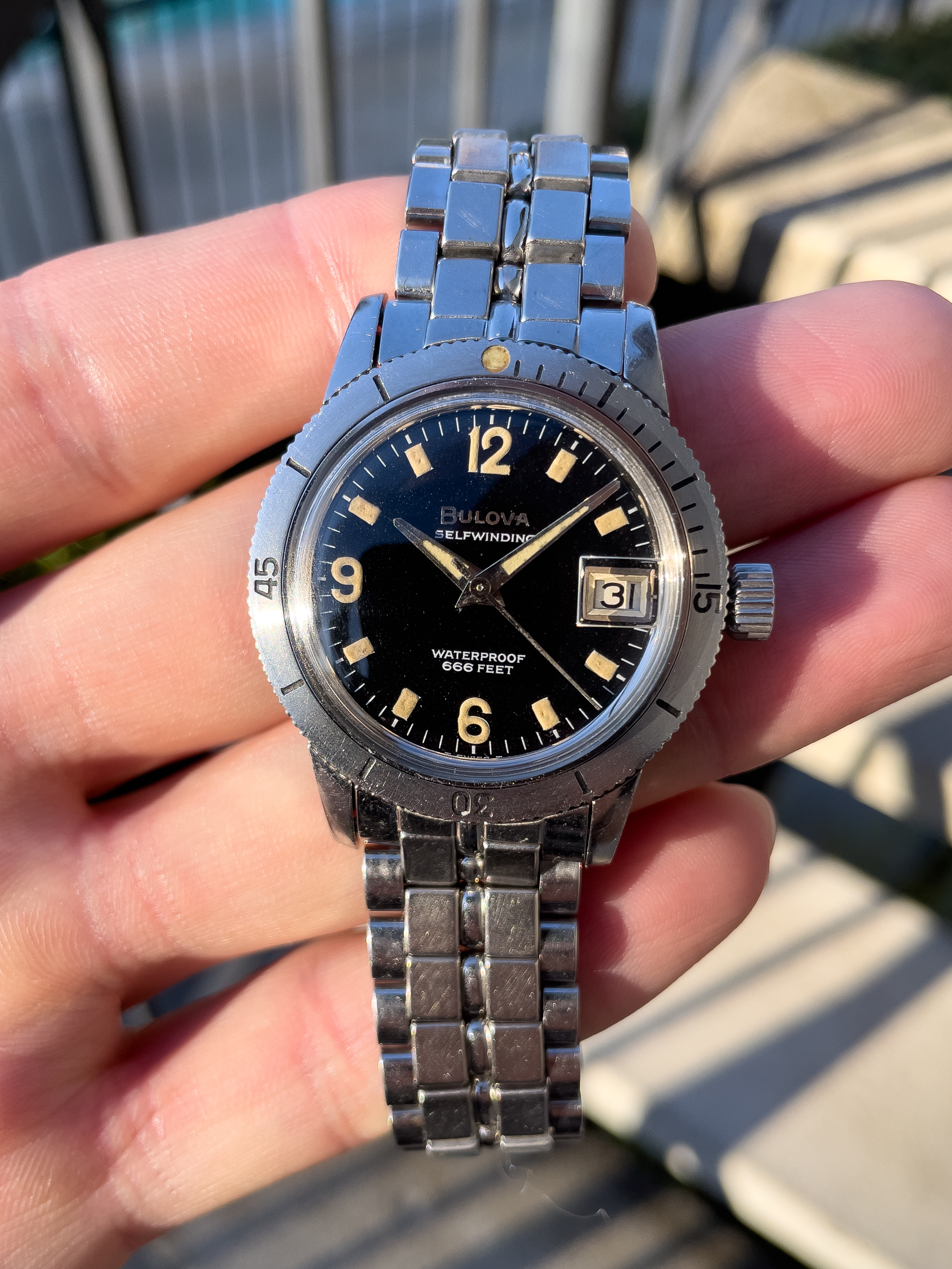

It is hard for me to consider this a project watch because it looked so good to start with, but this has been fun to bring this back to correctness. The final piece for this to be complete is a correct crown and stem. The crown is the harder part to find but it will allow me to practice my patience. Here is my '67 666 that came into my possession thanks to @Dan S
Before, with incorrect crystal/tension ring, incorrect crown, and no bracelet. Still looks really good and I could have been very happy with this.
But thanks to a couple forum members, I procured a correct bracelet and crystal/tension ring
Now all that is missing is a crown but it is looking mighty fine as is and is a real treat to wear

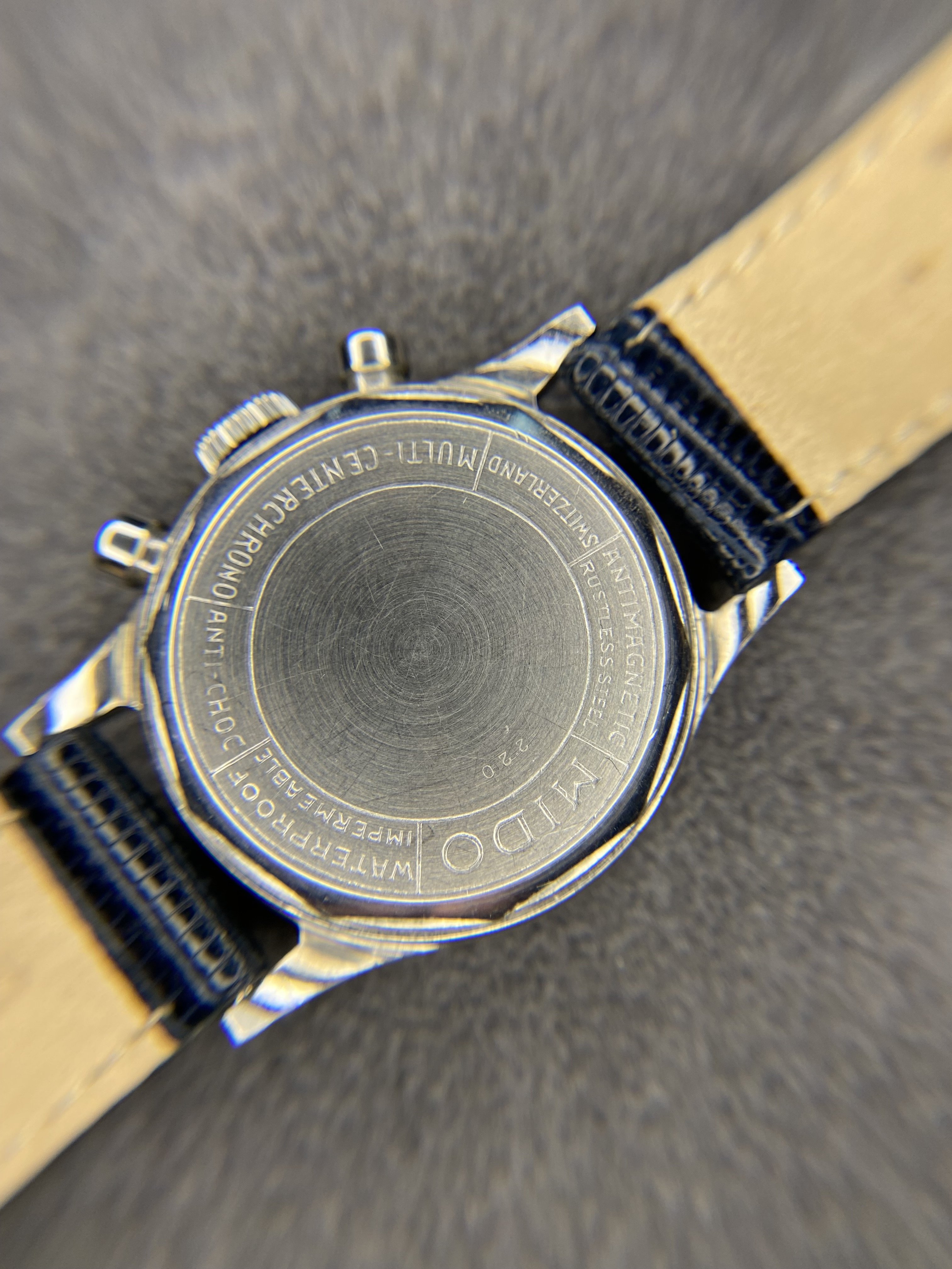

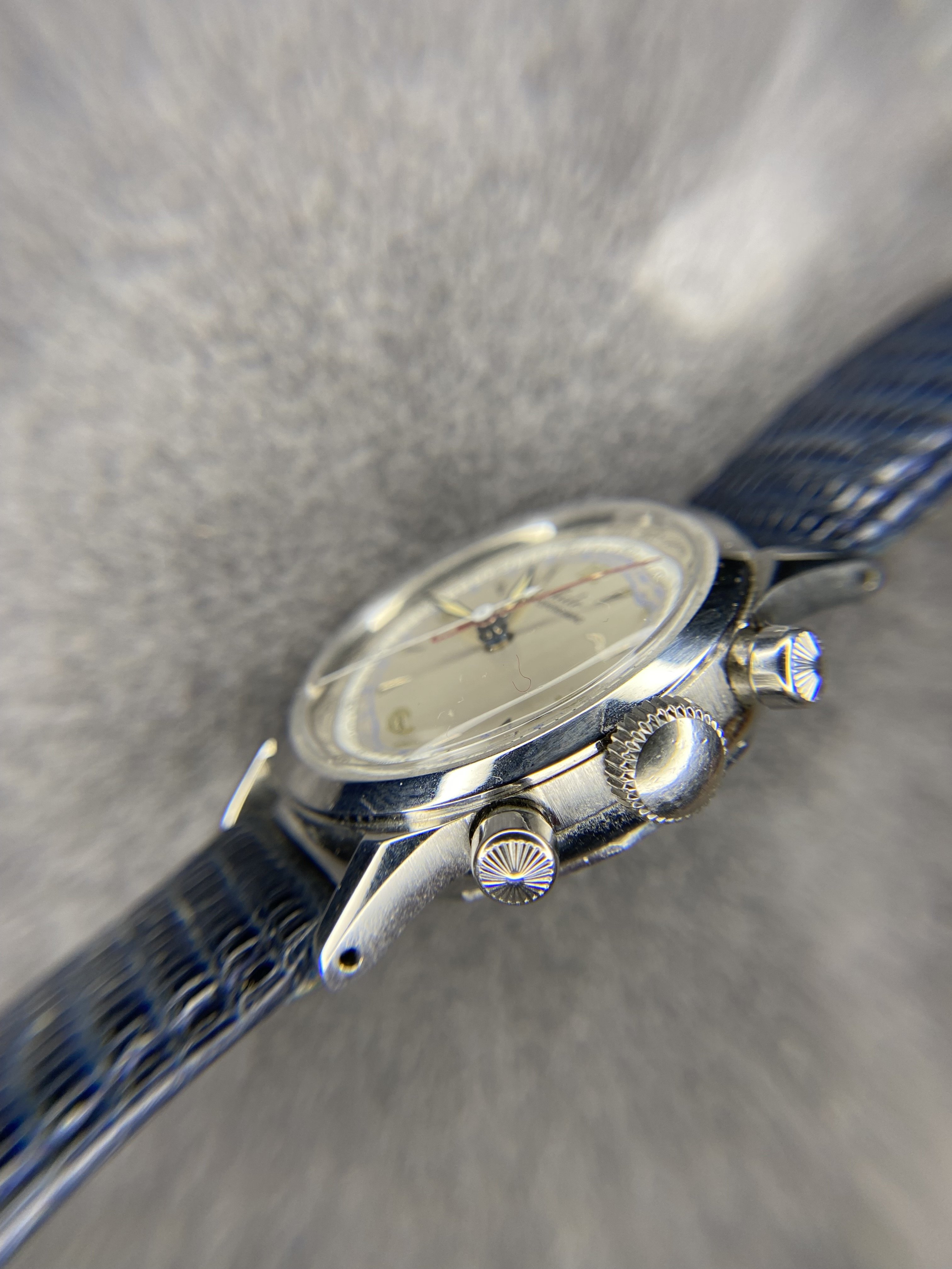

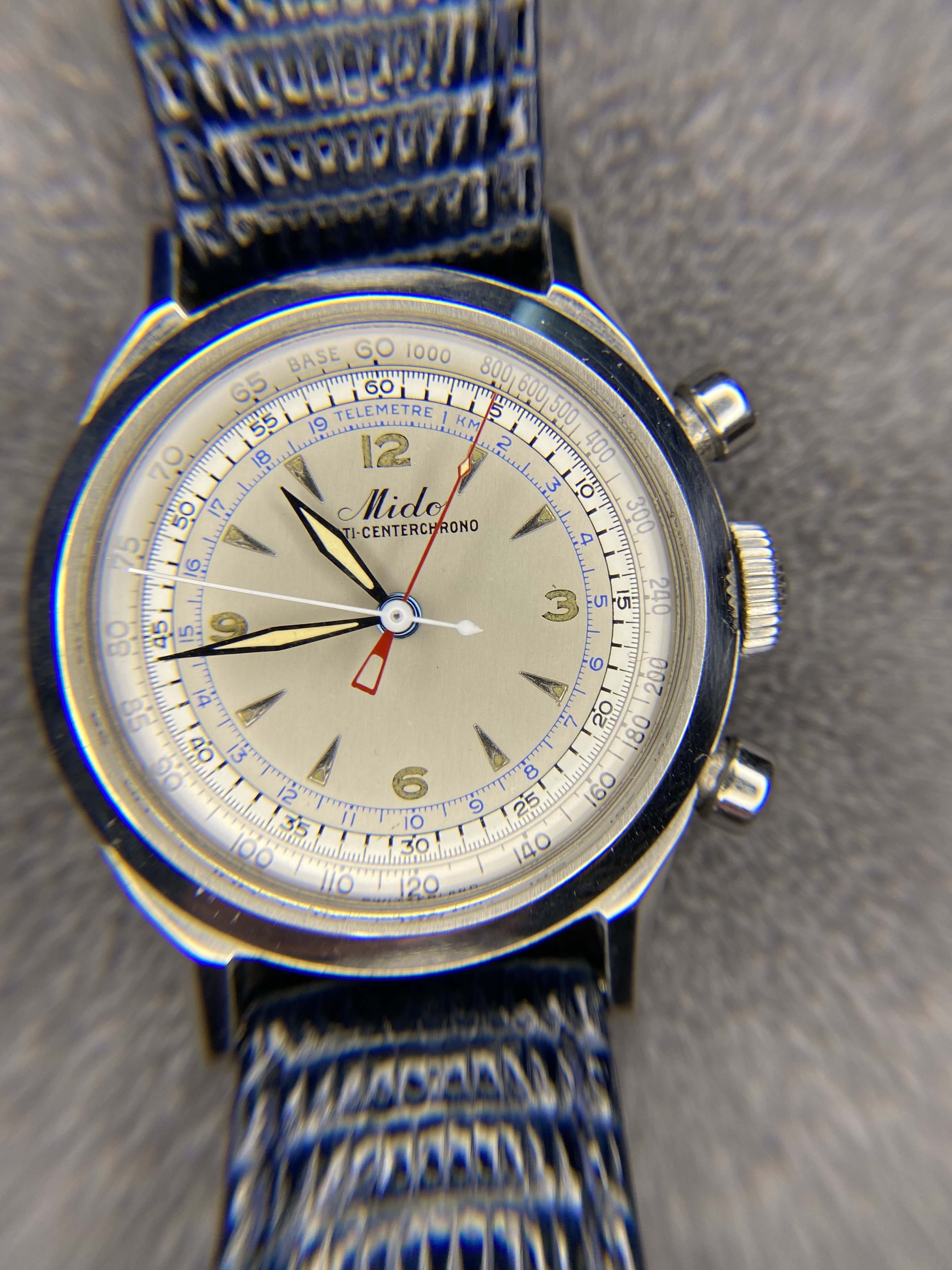

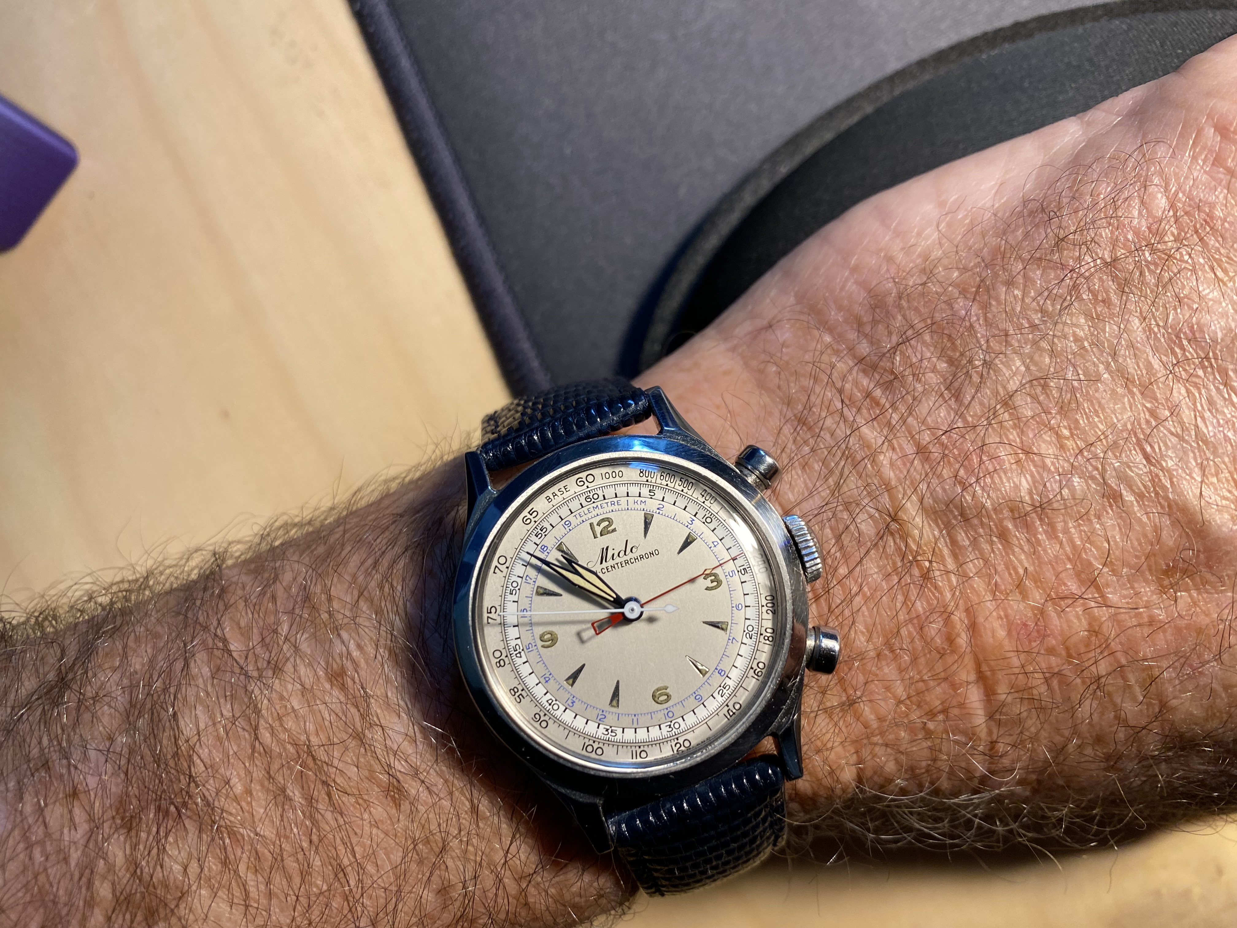

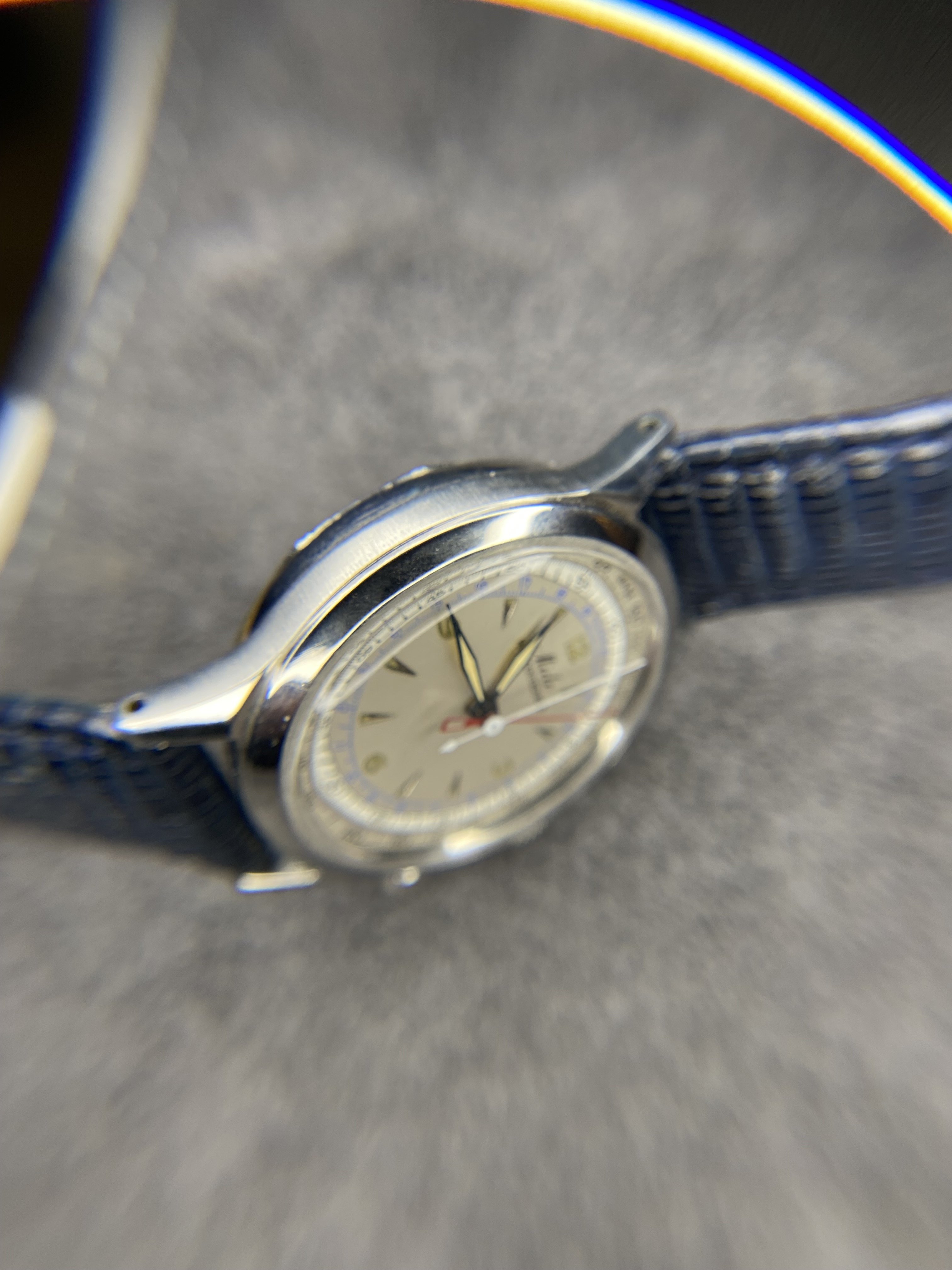

I sold off all my Mido MC chrono's a while back. Then found myself really wanting to wear one. So I went to the parts box and found a decent, slighty polished case with matching numbers. I also had several incomplete movements, pushers and a crown. Also a bunch of nos dials. Only thing missing were good hands that would match the nos dial in terms of condition. So I broke down and bought an expensive set from an online seller. Now, for the price of the hands and rebuild I've got a nice, new, regular wearer. Very happy with the way it turned out..
16,305
45,025
I would happily wear that bitsa anytime.
