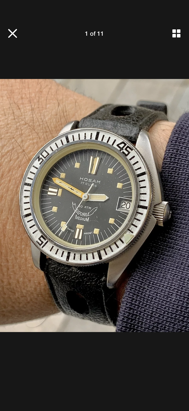

Yes- a 60’s diver with Bakelite bezel that was specified at 38mm. I PM’d the seller asking if the watch was indeed 38mm, he said he measured it twice- yes, 38mm . When I got it, it was 35mm not including the crown, 38mm with crown. 🤦 I wasn’t specific enough in specifying “without crown”.
It had come from Italy and I figured oh well- I didn’t ask the right questions so my bad. I ended up selling it to someone with small wrists who loved it so no loss on my end.
