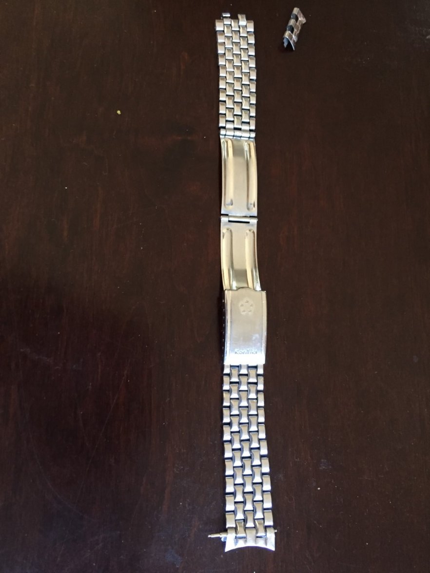

This is a bracelet from a mid 50's Eterna-Matic KonTiki. It is a link or two too short for my fat wrist. I been looking on and off for a while, but I've not seen any of these links offered for sale.
What options do I have to lengthen the bracelet?

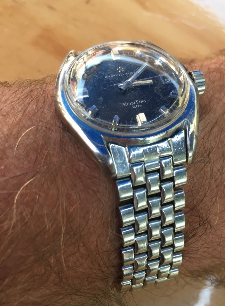

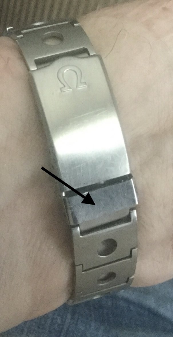

I had that problem a few months ago. I solved it as you see in the picture. But I understand that some watch material suppliers carry extenders that work just like mine does. This was not a neat job, but it will serve the purpose until,I find a better solution.
4,593
10,811
That's actually a pretty decent looking link you made and definitely serves the purpose.

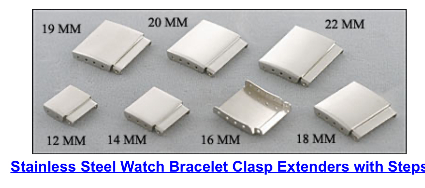

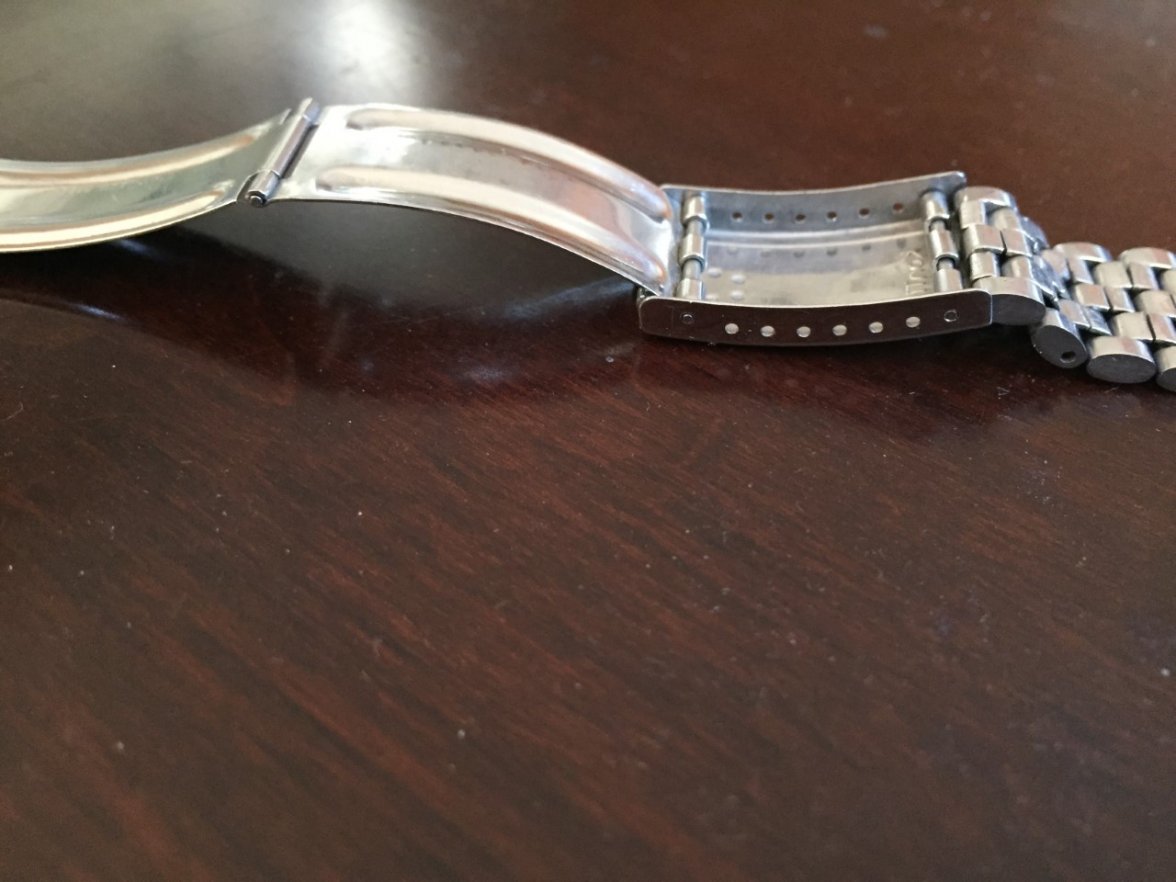

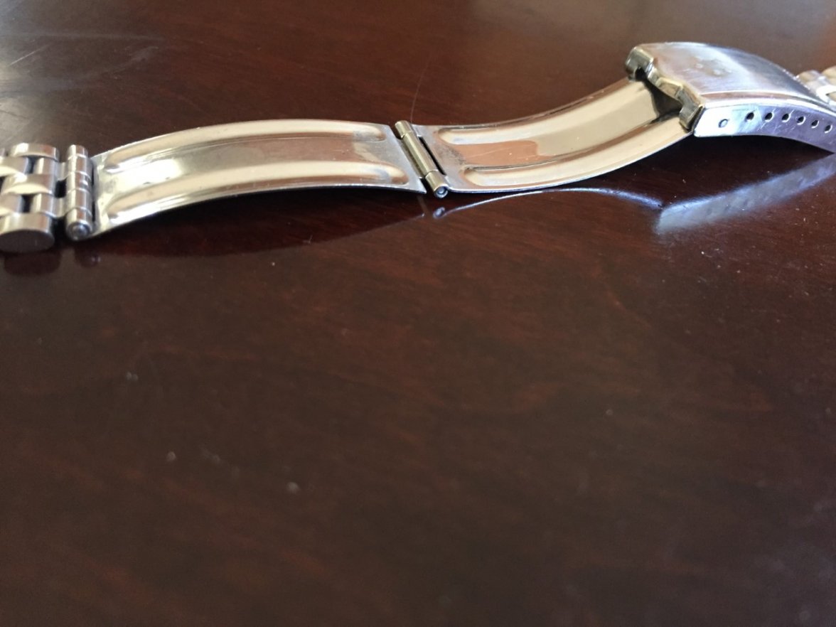

The bracelet on my 666 was a link too short and the clasp extender wouldn’t work because the placement of the last hole was just too far in. Luckily I had a JB Champion bracelet with a very long clasp cover (bracelet was also made by JBC) which did the trick. If the link extender doesn’t work- as suggested above, try a longer clasp cover.

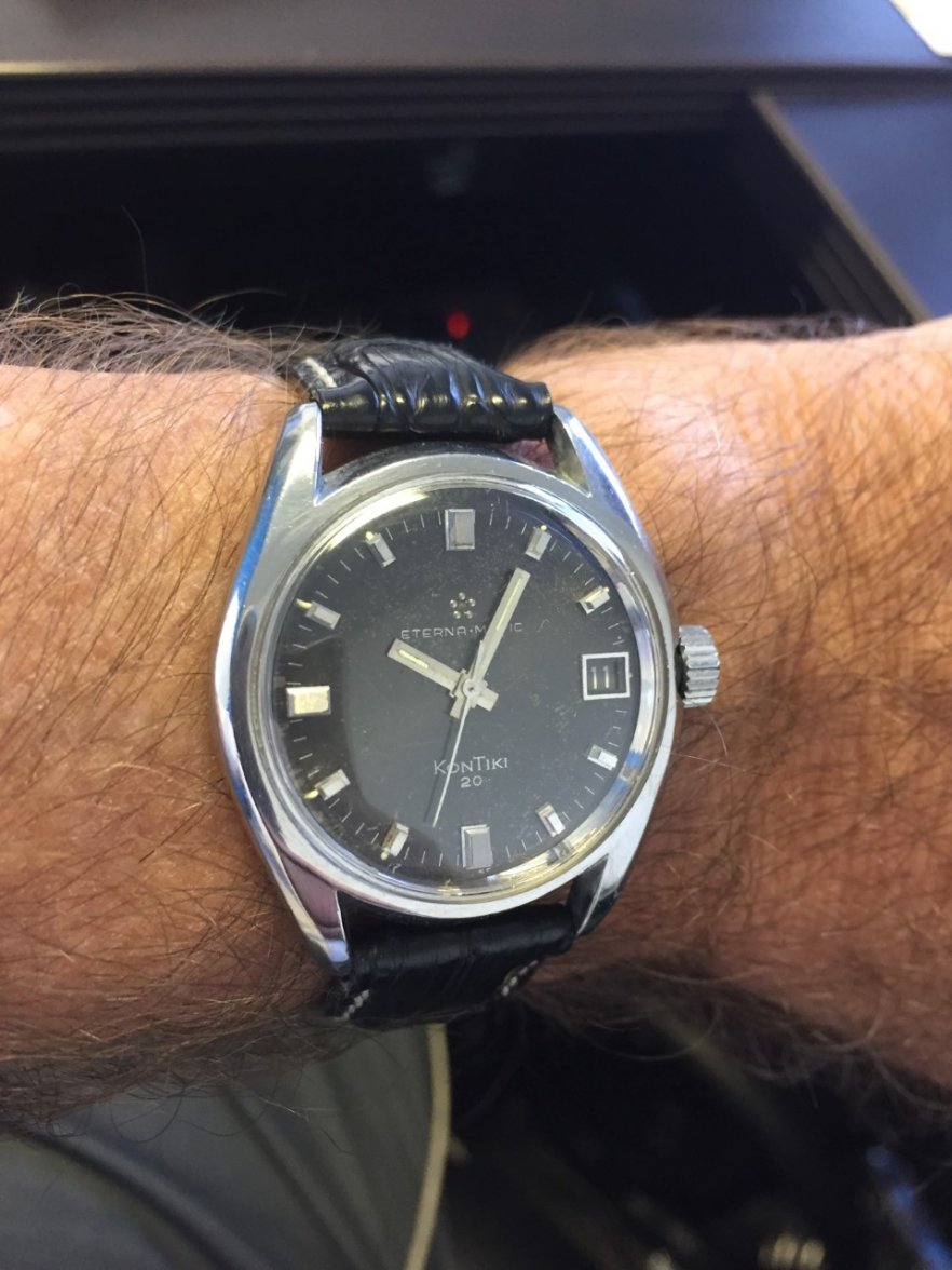

The watch. I want to see the watch. I have been aching for a vintage Kontiki on original bracelet for a long time.
All I have for now is watch sans bracelet.
This was the second vintage watch I purchased. At the time I had no concept of "over polishing." I'm not quite sure what to think about the dial. It has the effect of a metal flake automotive paint job, but it's definitely aging. The stripe that runs from the 12 to the 7 moves relative to the angle to the sun. Truth be told, I bought it because I fell in love the deck chairs.

Thanks for the replies everyone, I'll check out the extensions.

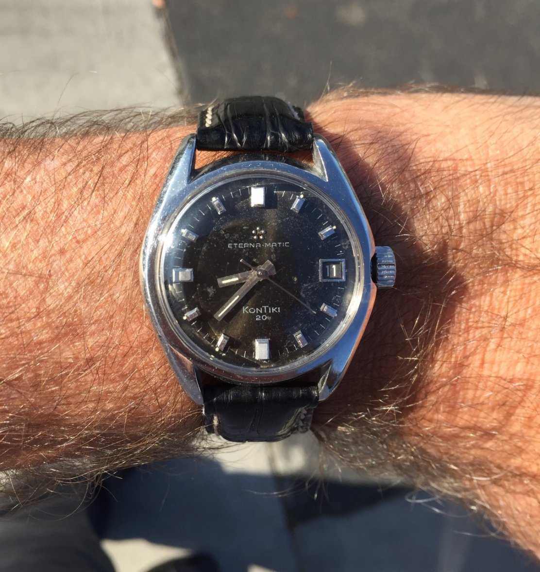

Lookin good! that baby is aged just right and is gonna look real good once you get the clasp extension and back on the bracelet.

Thanks for the advice, gang.
Here she is with the extended bracelet.
