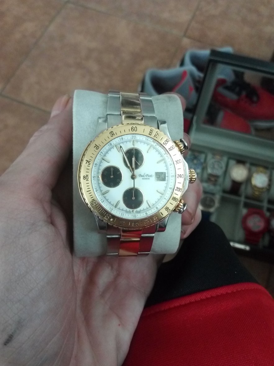

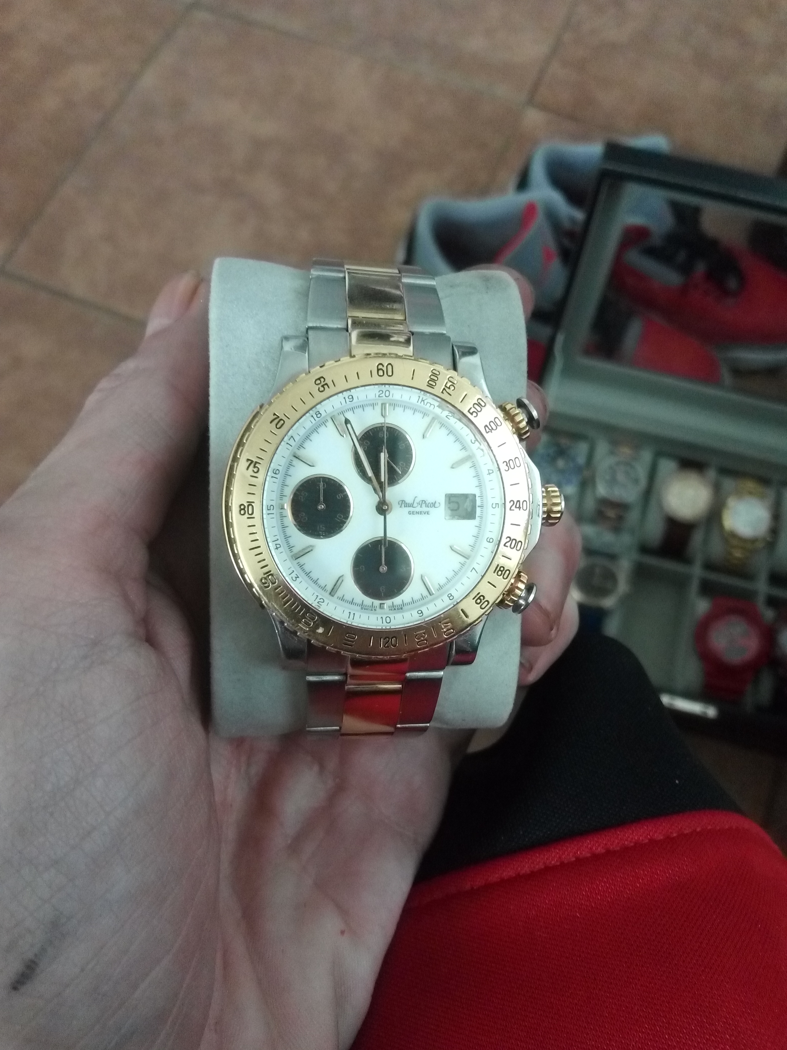

Are you sure it has a Lemania 5100? Because that dial layout looks like a Valjoux 7750. A Lemania 5100 wouldn’t have a minutes subdial and there would be 2 central hands - one a seconds counter and one a minutes counter.

It's not a Lemania 5100. Simple valjoux 7750. Lemania has 24 hour counter at 12 O' clock. Easy for every watchmaker. Kind regards. Achim

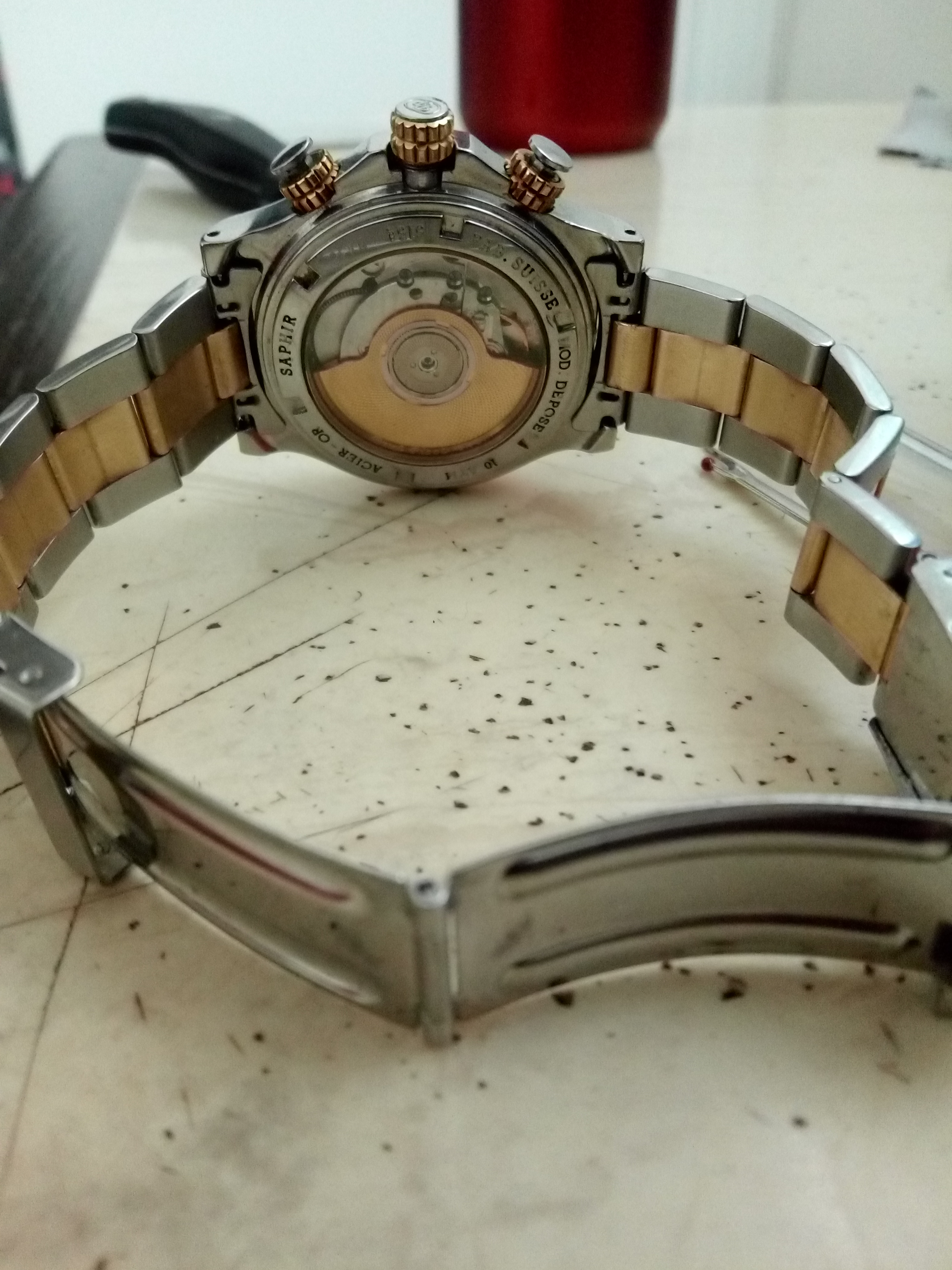

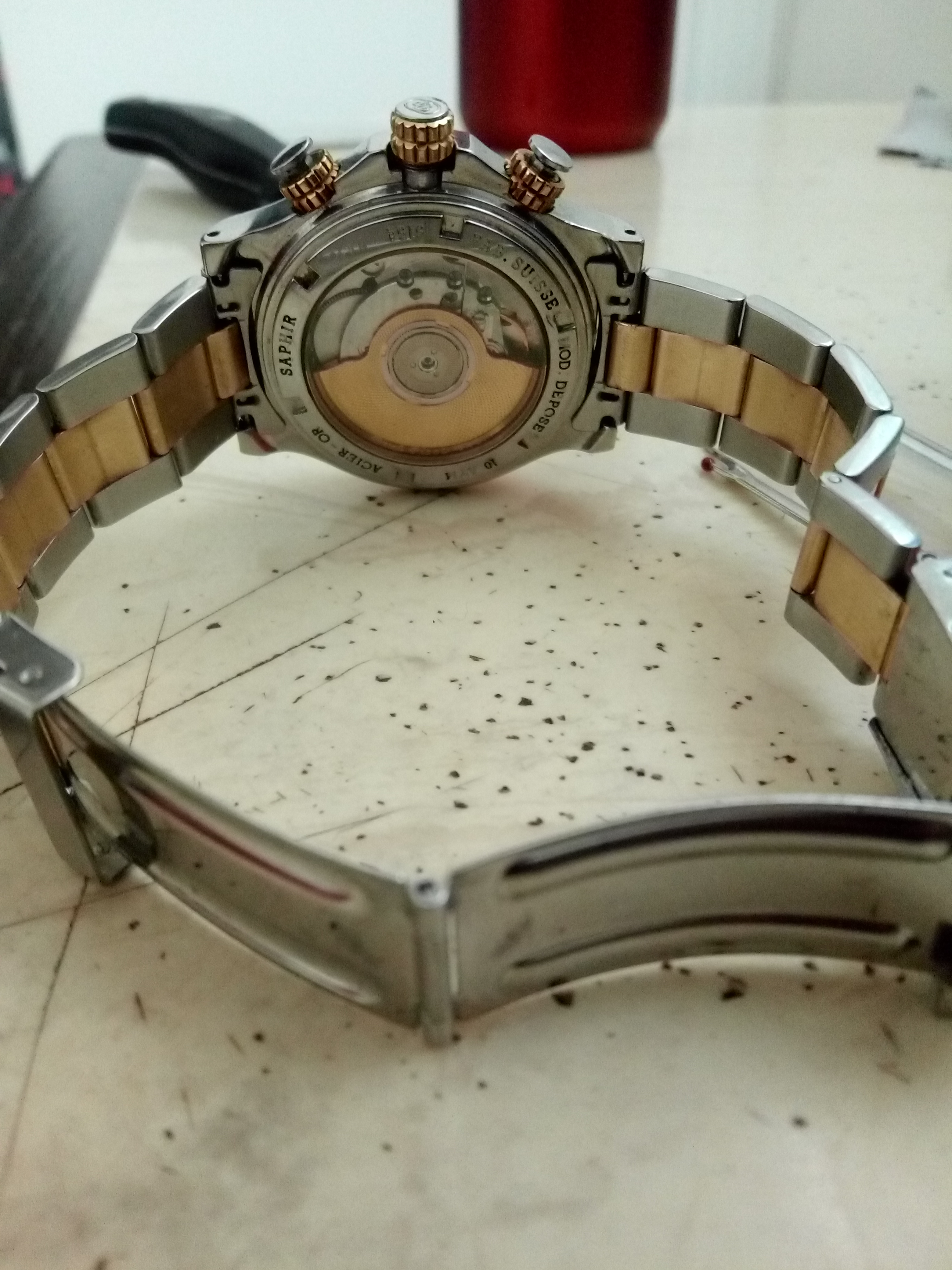

Valjoux 7750? Based on the movement shot, it looks like there's a base 2892, which suggests that the chrono function is a module?

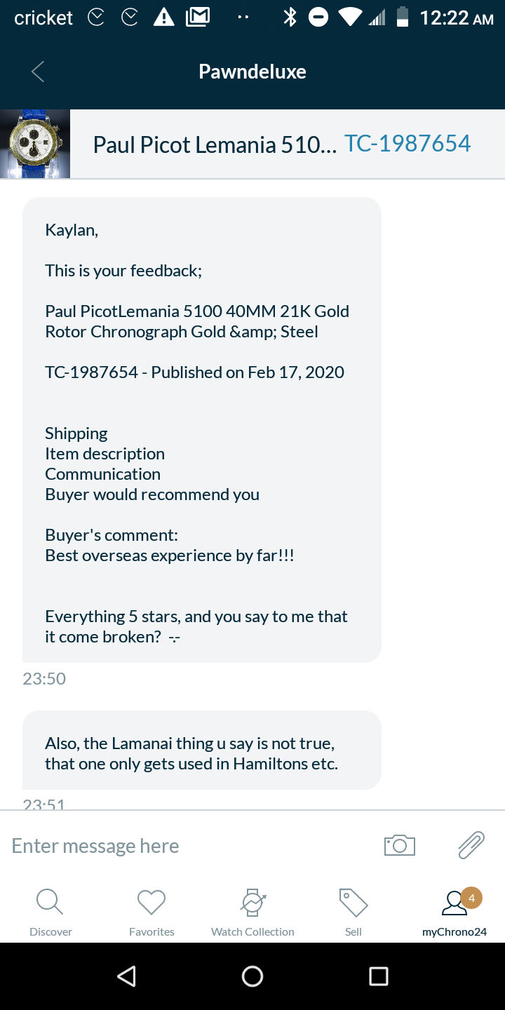

Yeah I don't know the difference. I was told it was a lemania by the dealer on chrono24 that sold the watch to me. He obviously doesn't know the difference either. Kinda sucks I feel like I've been ripped off by him.

I’m a big fan of the Lemania 5100. Just something about the watches it was in and it’s utilitarian design. You easiest clue is the 24 hour counter up top as mentioned by “watchyouwant”. As it has something of a following it would be worth more than if it’s powered by a 7750 or a 2892-2 (which would be my guess). So it’s quite right to feel aggrieved.
Yes, definitely a modular chronograph, so not a 5100 or 7750 based...
Not unusual at all that a watchmaker would turn this away...

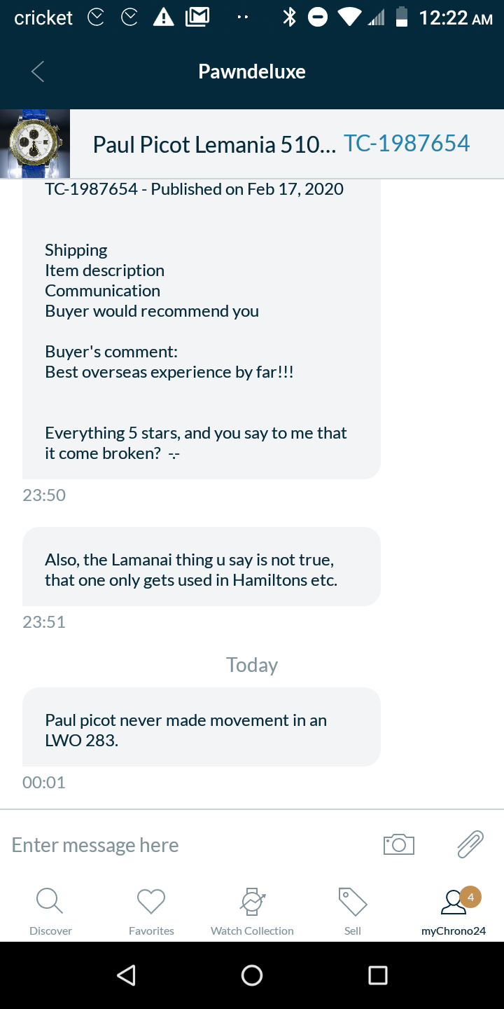

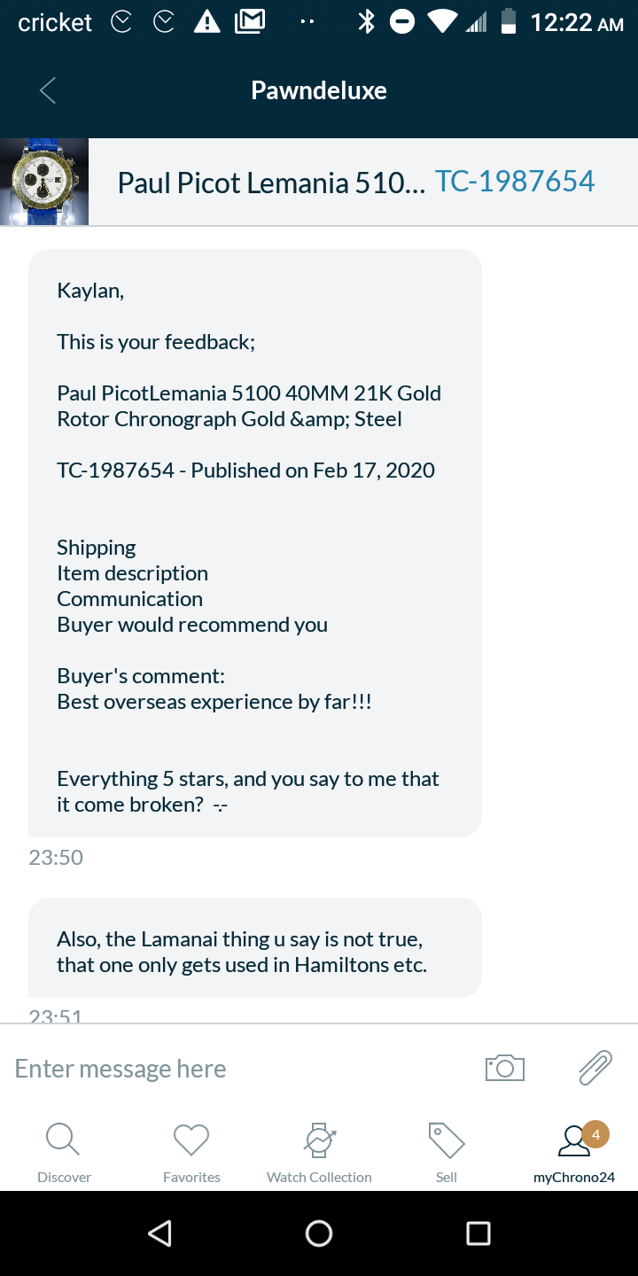

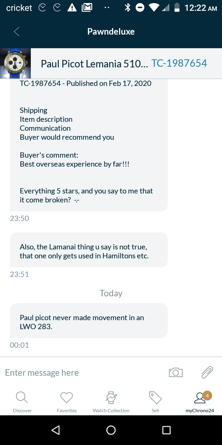

Yeah I really should have done my homework I'm really disappointed with this whole situation. when I received the watch the crown wouldn't wind the watch or set the time but date function worked. the seller is supposed to be a "watch expert" hes swearing its a lemania.

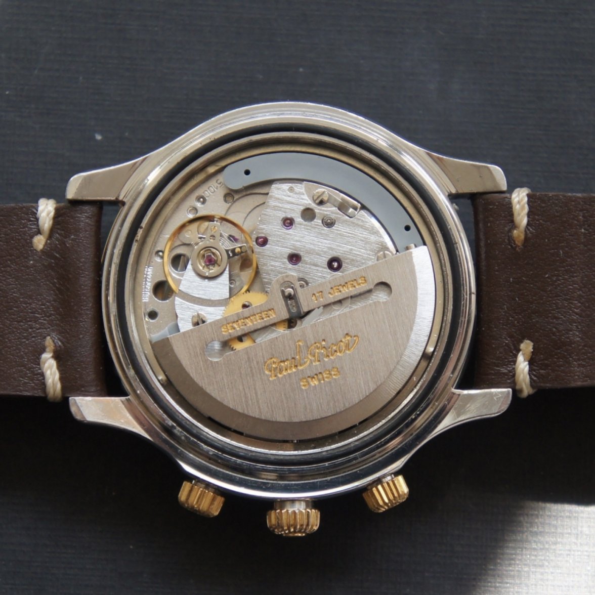

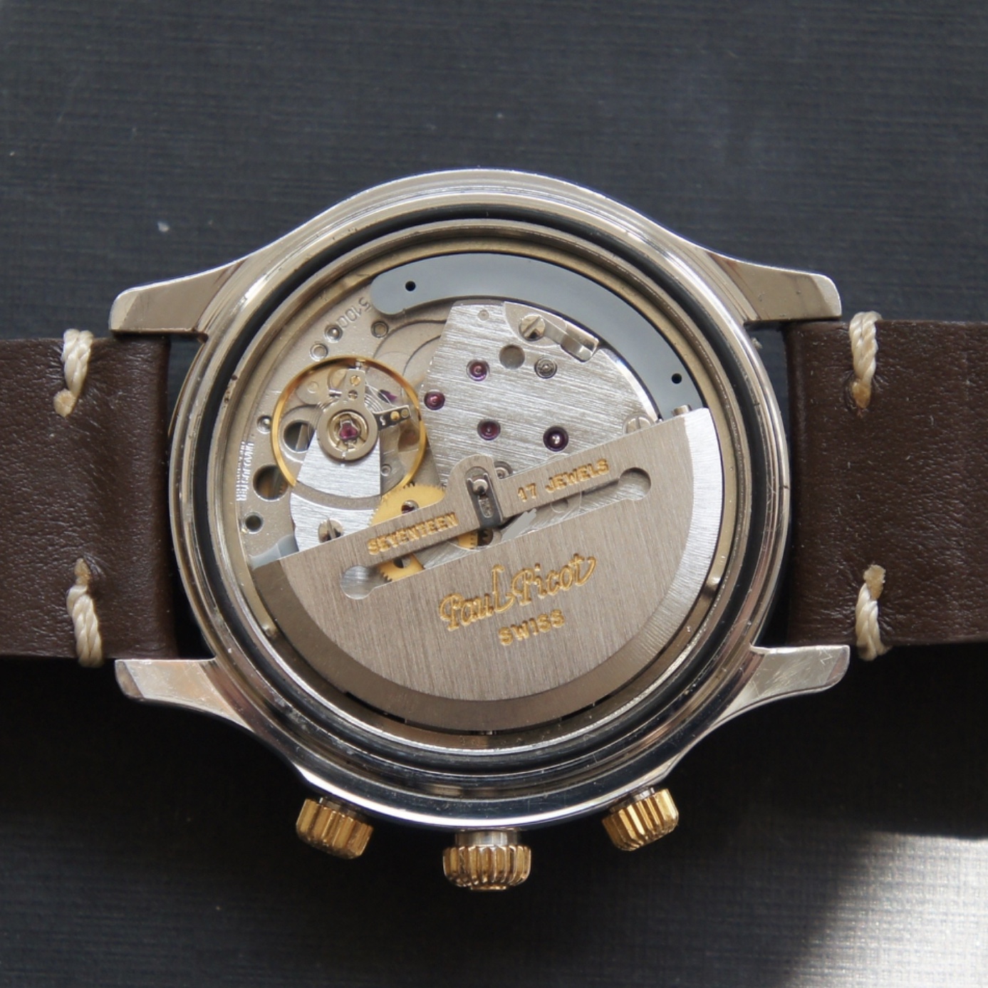

Here’s a Paul Picot with a 5100 from the sales forum here.
https://omegaforums.net/threads/paul-picot-u-boat-with-lemania-5100-price-drop-obro.75658/

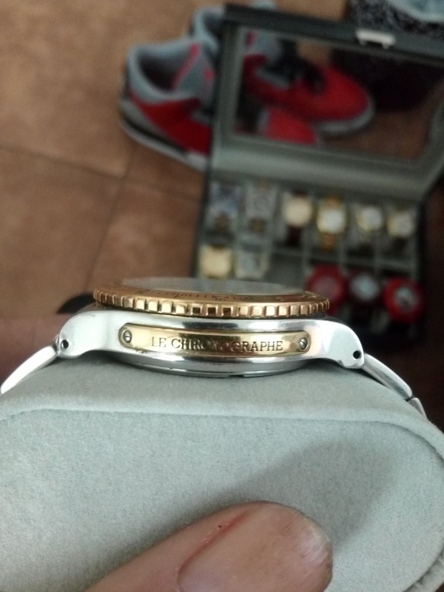

How on earth does that look anything like yours ? I’m pretty sure the rotor on the 5100 always looked like that too (with that characteristic long slot near the pivot). Also are you pushers on the same plane as the crown ? I think they’re offset lower on yours which means it can’t be a 5100.
