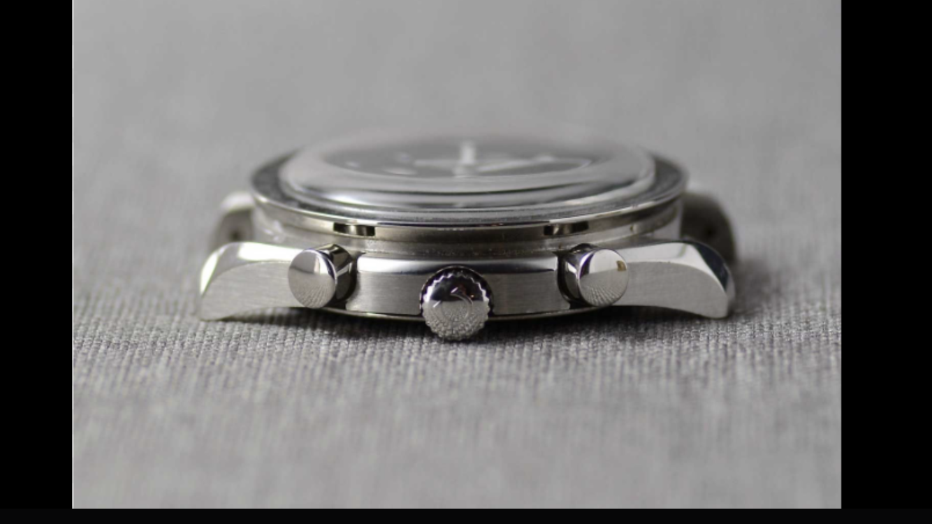

Hi all,
looking for advice please.
I’m looking at purchasing this speedy reduced from someone on social media, they have sent me the following video that I’ve linked
I know it can be difficult to tell without an in person check but what are your thoughts? Legit?
also any advice would be welcomed, how do you normally authenticate your watch? I have a goldsmiths near me i wonder if they’d take a look?
Thanks!

So the only thing I see that is suspicious is the minute sub-dial for the chronograph, but I don't have a reduced, so could be wrong about how they work. On the Professional, the 'minute' is a 'jump minute', meaning the minute indicates '0' until the second hand is ~2 seconds from 0, and then 'jumps' or 'clicks' quickly to '1'. I see right there that the minute hand is half way between 0 and 1.
Otherwise, I don't see anything suspicious (but again, I'm no expert). Chronographs are particularly difficult to fake (in that one of the hands is seemingly always 'doing the wrong thing' on the fakes), usually the 12 hr subdial being replaced with an additional 'hour' hand.
To get this authenticated, you'd have to go to some local Omega expert shop, no normal 'goldsmith' could take a look and make a reasoned opinion. You'd want the case back removed so the movement could be authenticated: I am not aware of any fake reduced Speedmaster (or professional!) movement that would pass a knowing eye looking inside the case back.

I looked around and watched some videos (including one on WatchBox) of a reduced, and it appears that the reduced does NOT have a jump-minute on the chrono minute subdial, so no reason to be concerned about that.

Easy way to check if legit on a reduced ( not a date, mk40, or racing with 7750 based movements). Often these other models of about the same size are incorrectly referred to as reduced but they have completely different movements.
A reduced will have the chrono pushers raised above the stem as a result of the piggy back module when viewed from the side.
no fake would have a movement like that.

Thanks all.
I guess it’s looking good, but as you say no way really knowing without a proper check from omega. I’m more confident that it’s authentic.

To reiterate what was said: while it’s true (I suppose) that an official Omega service will provide peace of mind—they’ll cross-check serials and open up the watch, so if there’s a fugazi movement in there you’ll find out—and you’ll get a comforting 2 year warranty and know that all is operating well—there are limitations to relying (only) on this approach.
As was said, if the pushers are in the right place, you can feel confident the watch is not a knockoff.
But even if the watch is legit on that most fundamental level, that’s no assurance that it hasn’t been otherwise adulterated, in ways that even Omega won’t notice or bother to indicate during a service. That’s where folks here can be far more useful. If you post good clear pics once the watch is in your possession, you’ll get great input.
