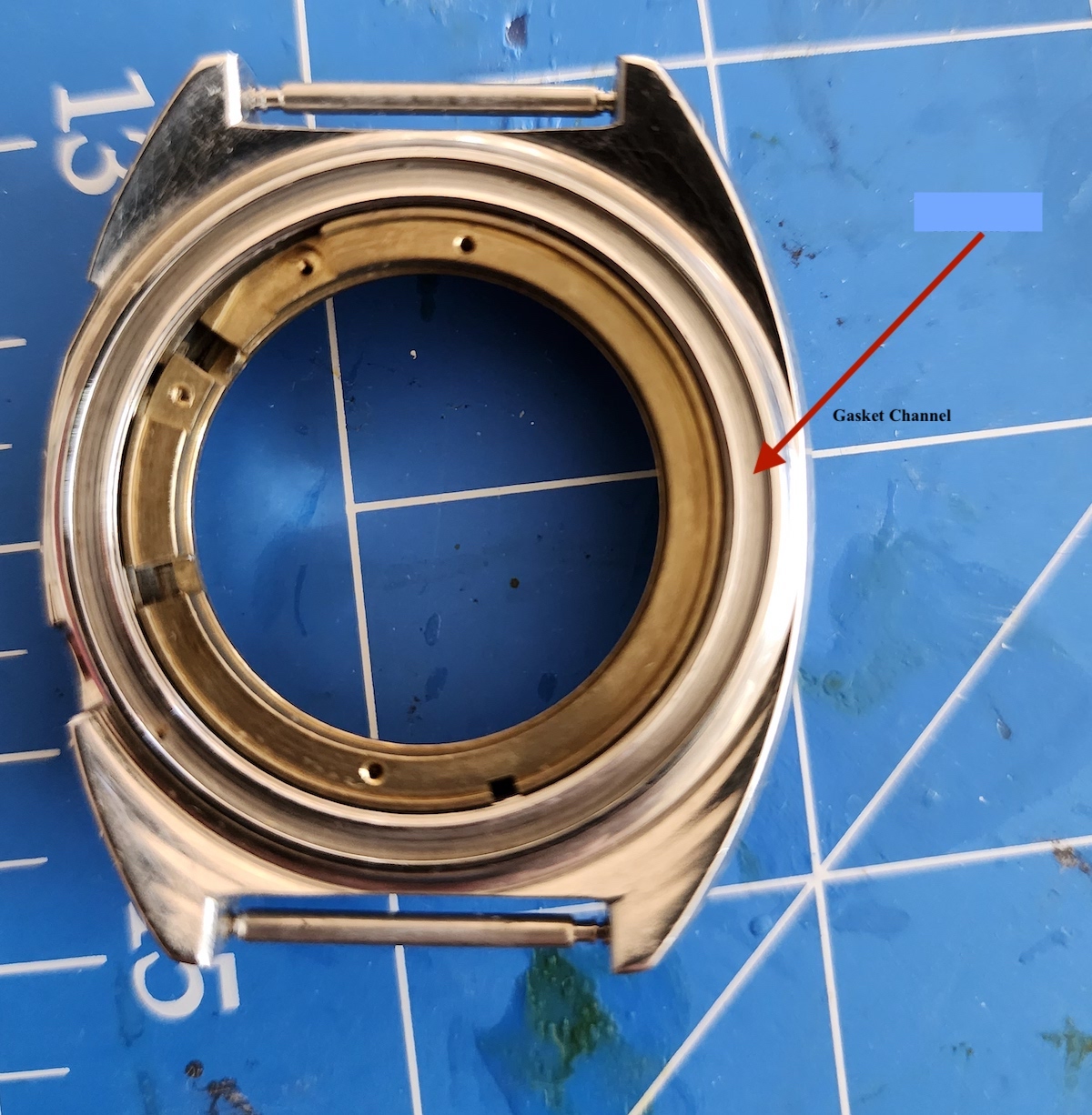

This is the watch and the empty channel to be filled...

Yes, the cross section of the seal should be equal to the width of the seat in the case. The seals should be slightly proud of the groove when seated, so it can be compressed.
Most seals top out at 1 mm cross section, even for watches rated to extreme depths. I do see on vintage Doxa's for example some very thick seals like what you need, so if this one is vintage and related at all to the Synchron group, it may be of the same design team. I have hundreds of different O-rings in stock, and looked in my stash for one for you, but this is the closest I have...
Note that watch material suppliers do stock these odd sizes sometimes, so not sure what they are like where you are, or if they deal with hobbyists, but it might be something to consider if you can't find them elsewhere.
