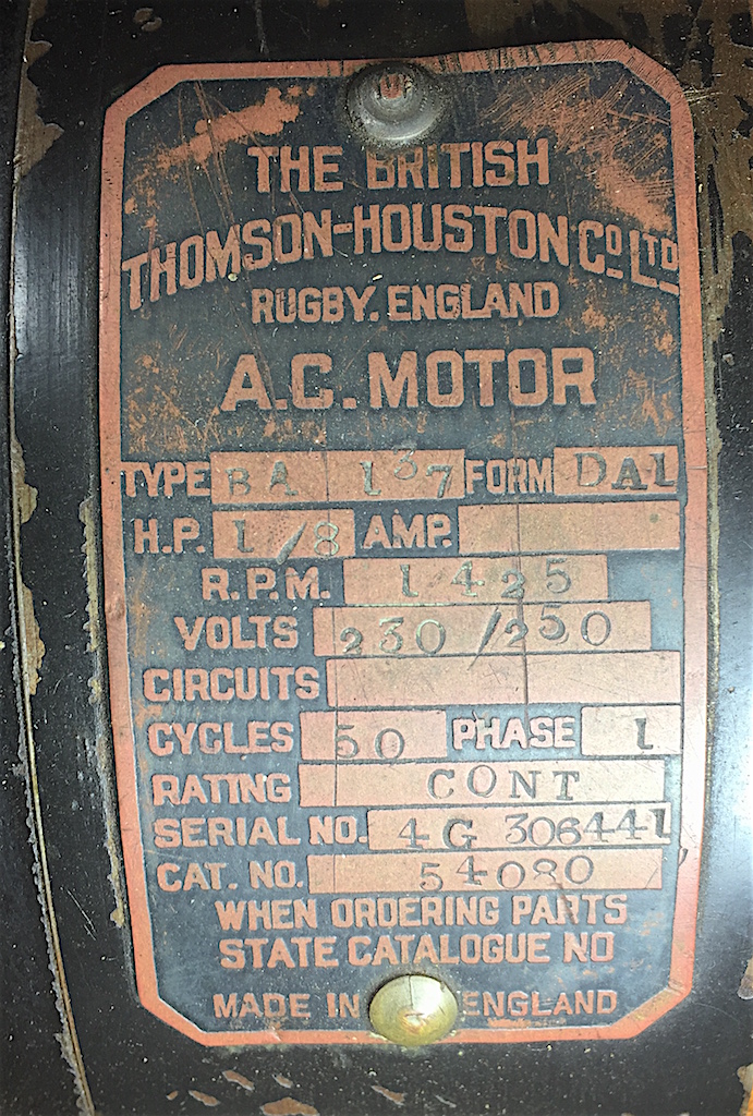

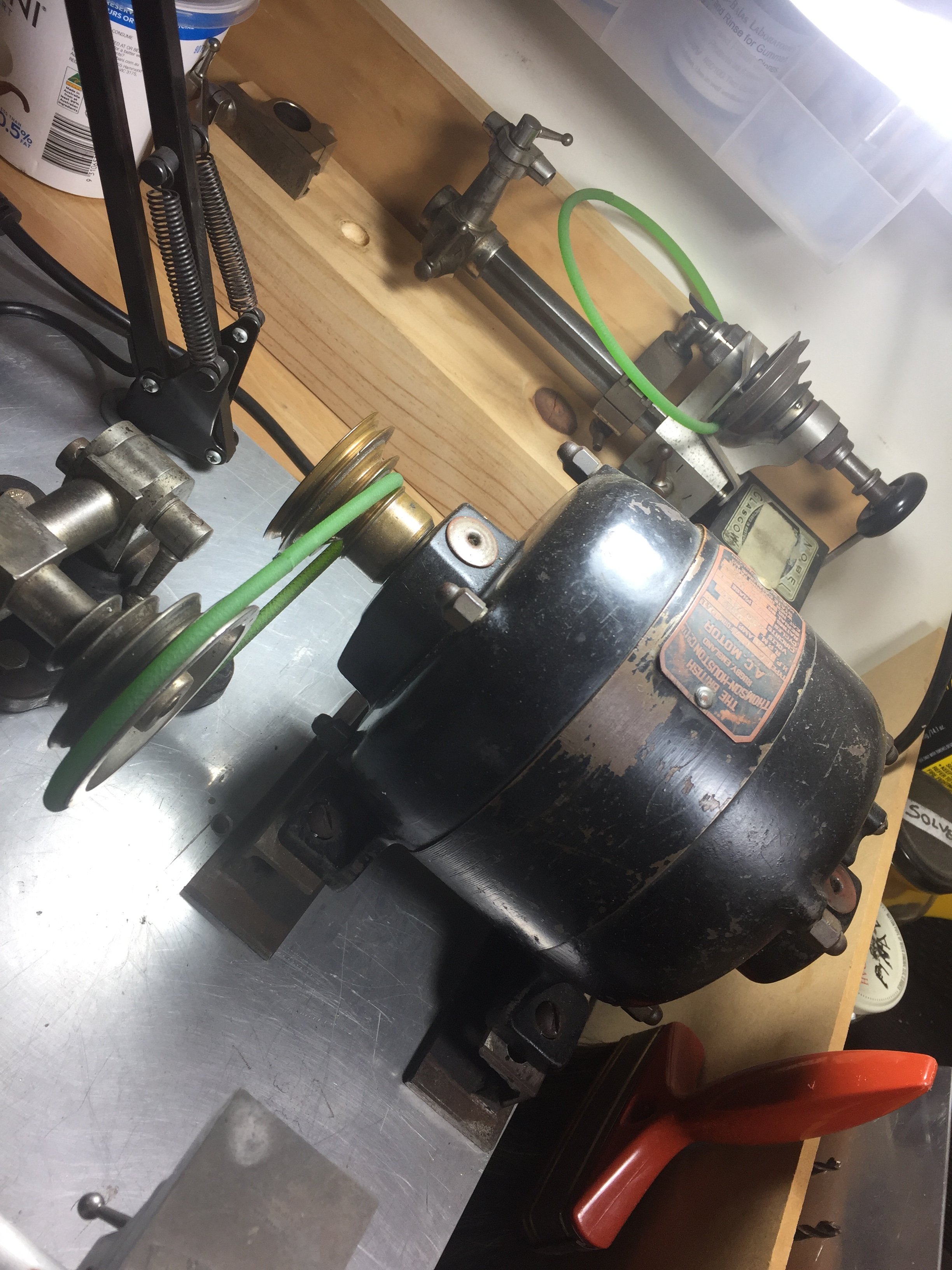

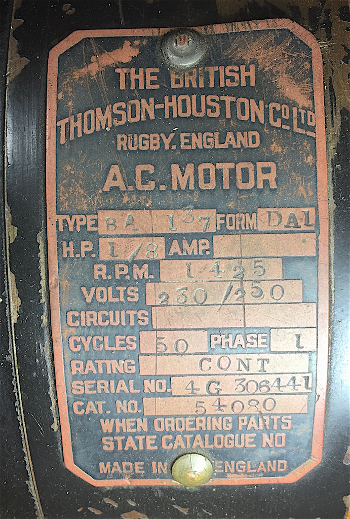

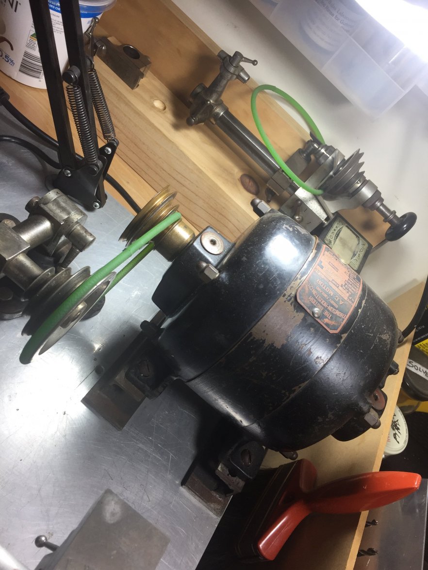

I has a modern sewing machine motor on my lathe but upgraded after I found a vintage English made beast in a junk shop.

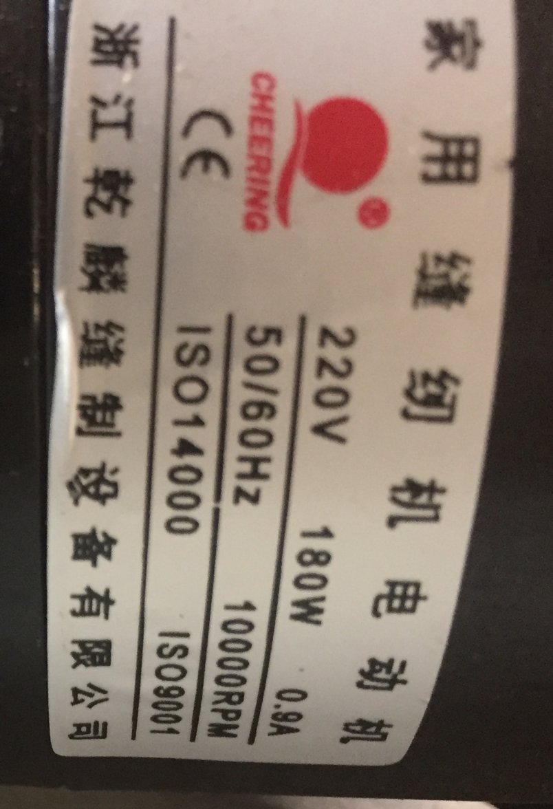

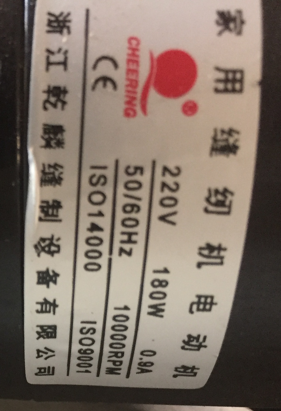

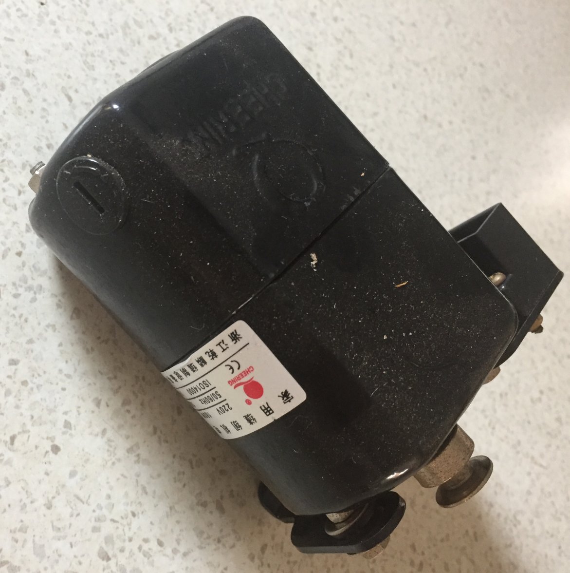

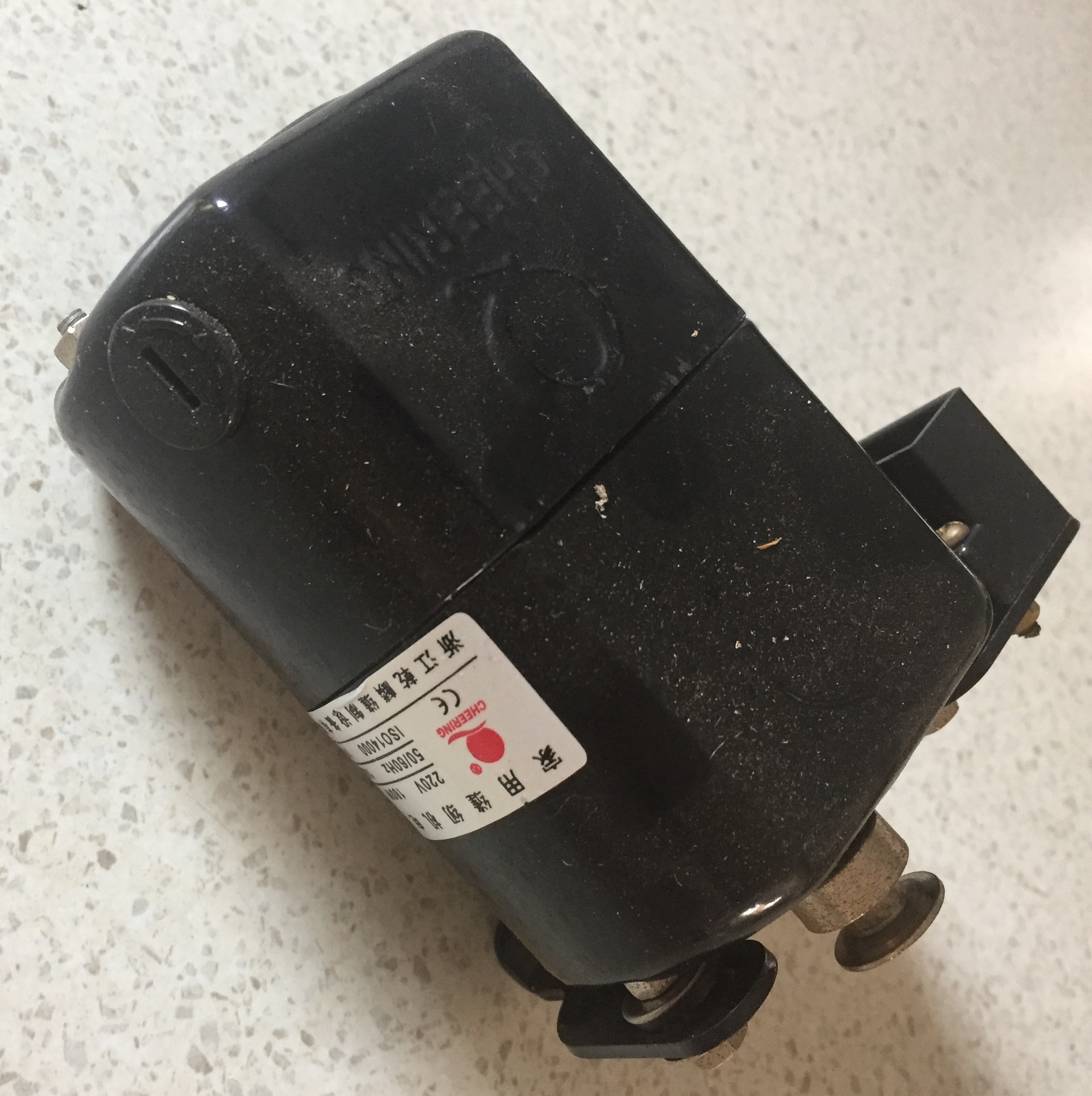

This is the sewing machine motor.
It's yours if you want to try it out, PM me your details. It seemed to work OK for me but I never did any really heavy work with it.
Other than that, try something from a water pump or other high torque application where the motor can be salvaged and re-used.

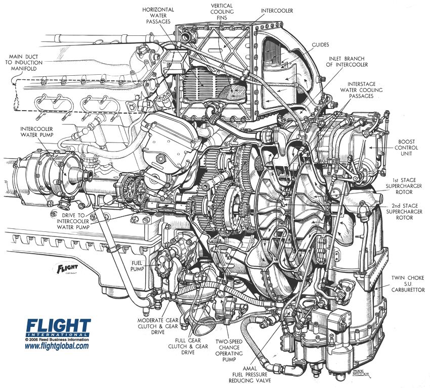

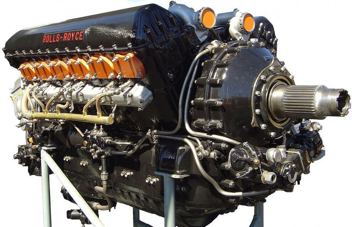

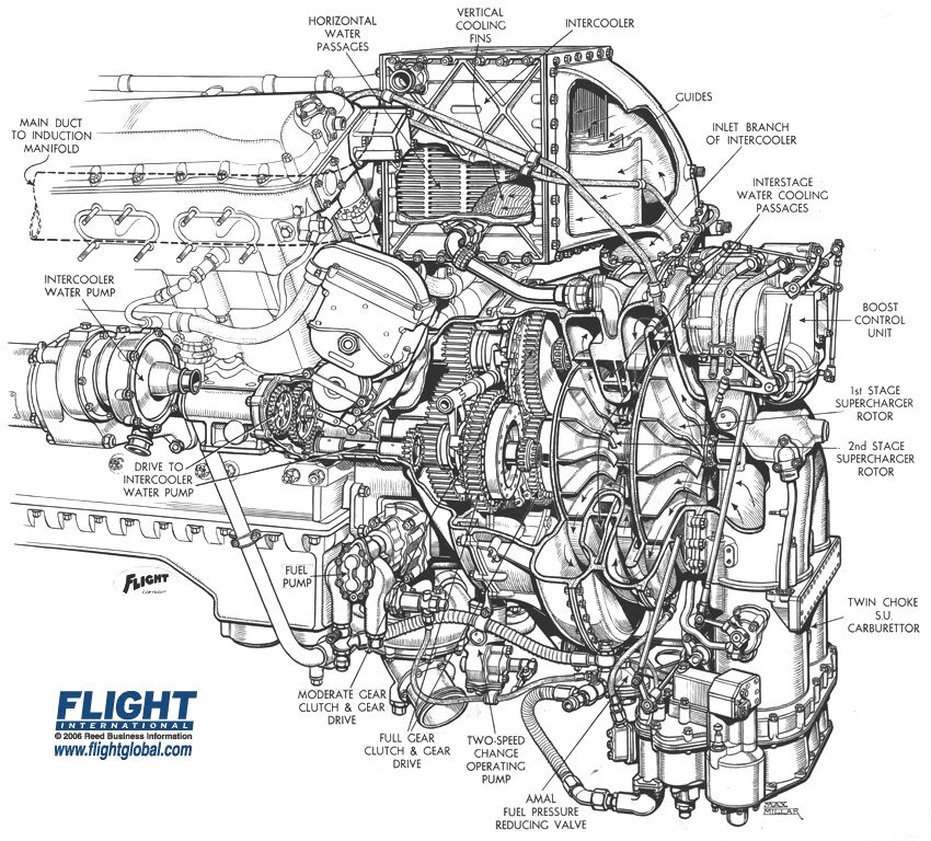

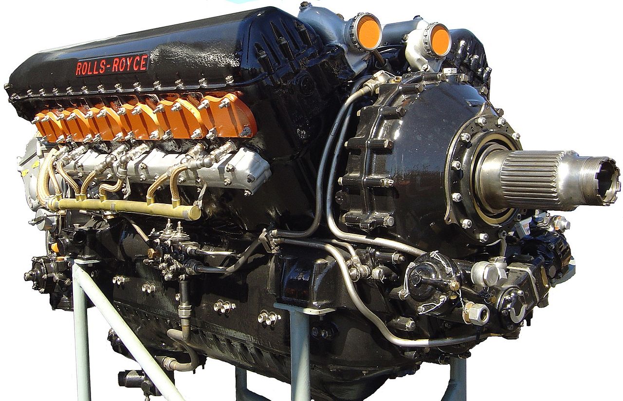

That looks like it might be underpowered!!!
Then the two-stage supercharger model should meet sir's needs.
Does sir have 130 octane fuel available, and lots of it?
