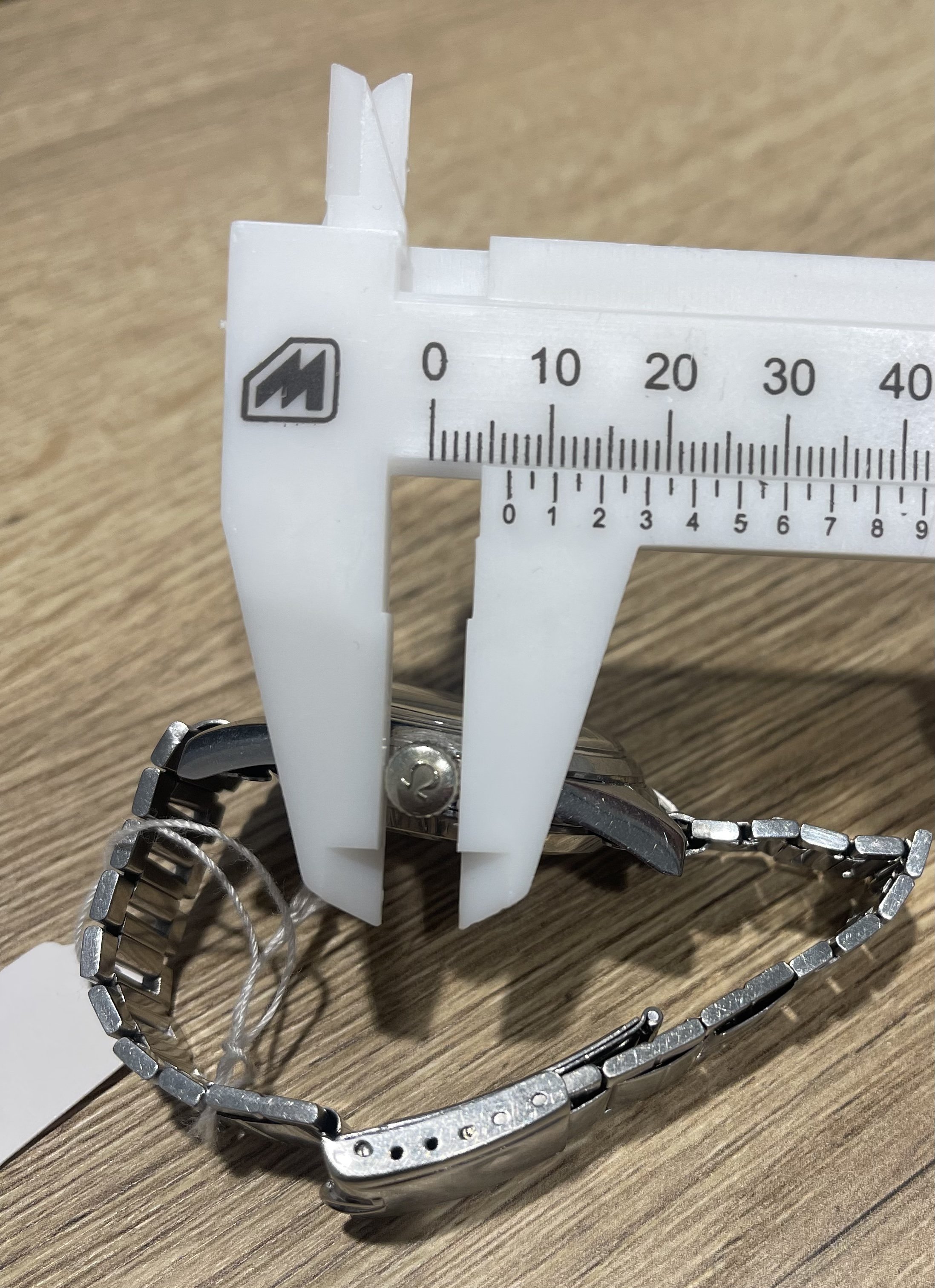

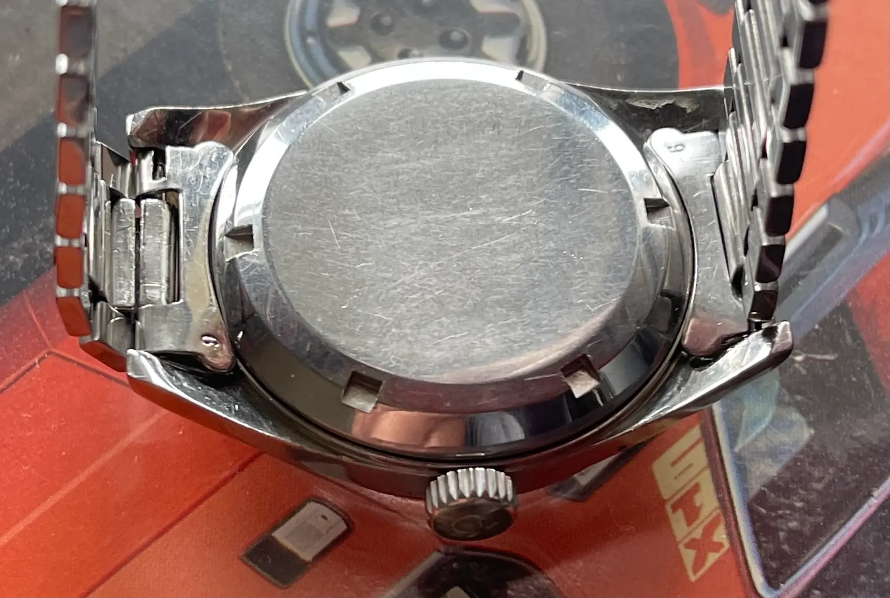

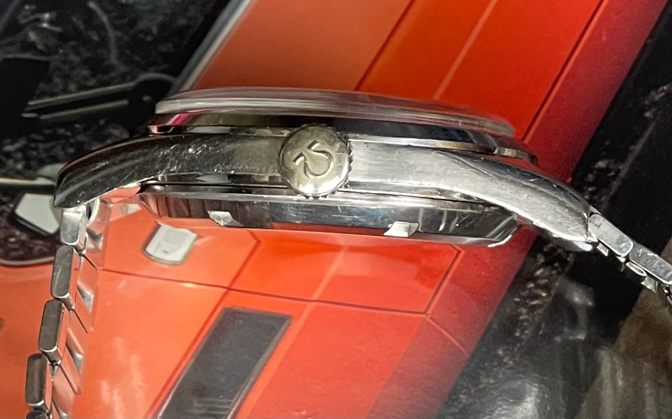

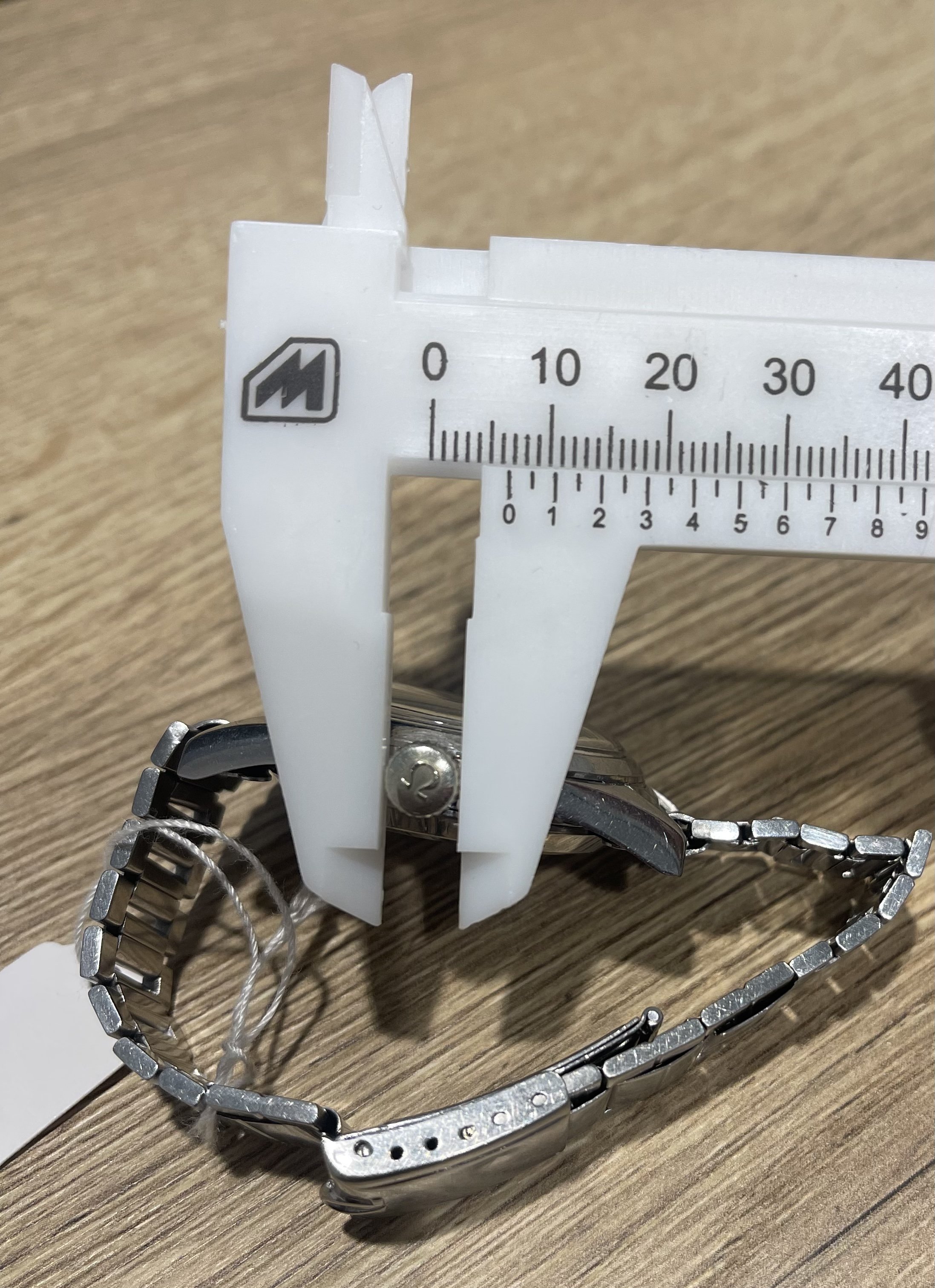

What`s the exact outer diameter of your crown now ?
Let me get back to you on monday when i'm home, appreciate your help
199
247
So I used the best caliper I could source around and the reading says 6.5mm.

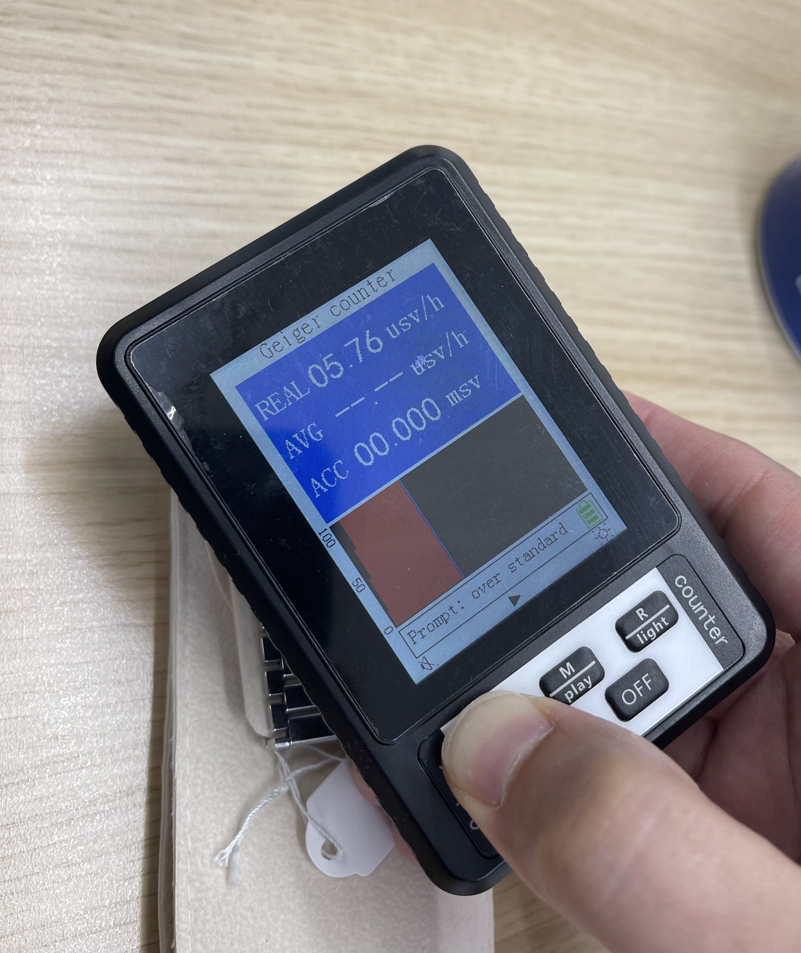

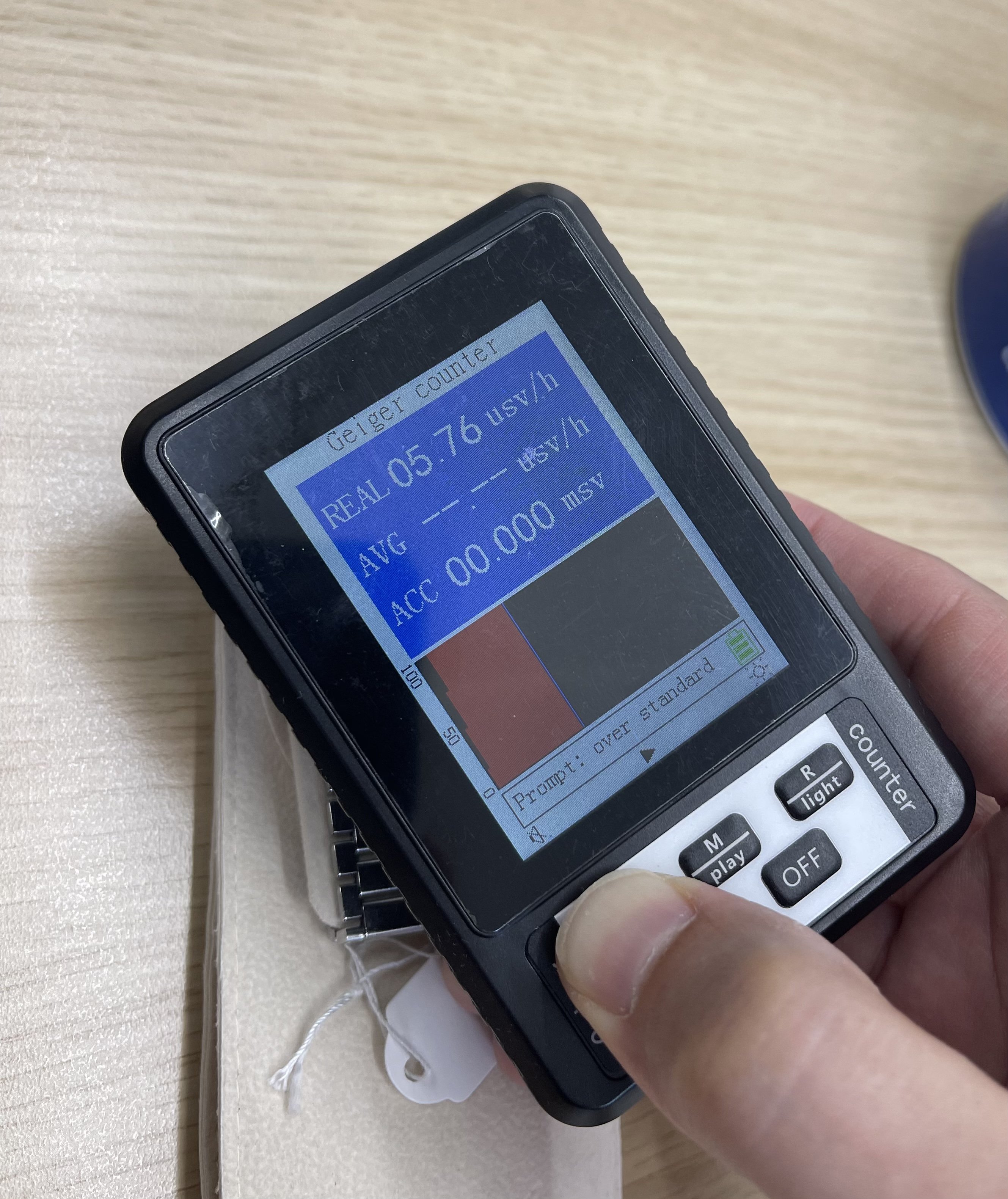

I also received my Geiger counter from Amazon, attaching the reading, it was making quite some noise..

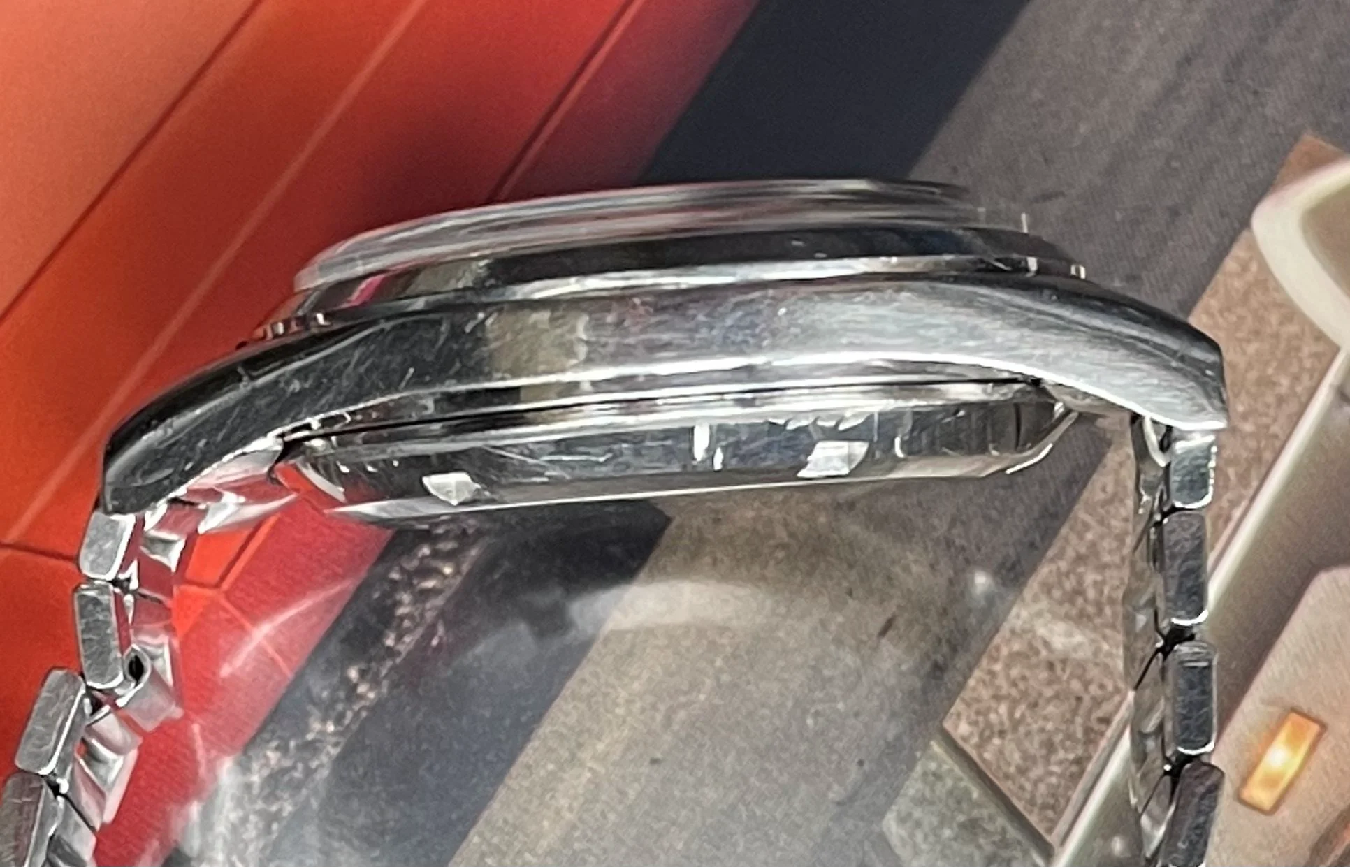

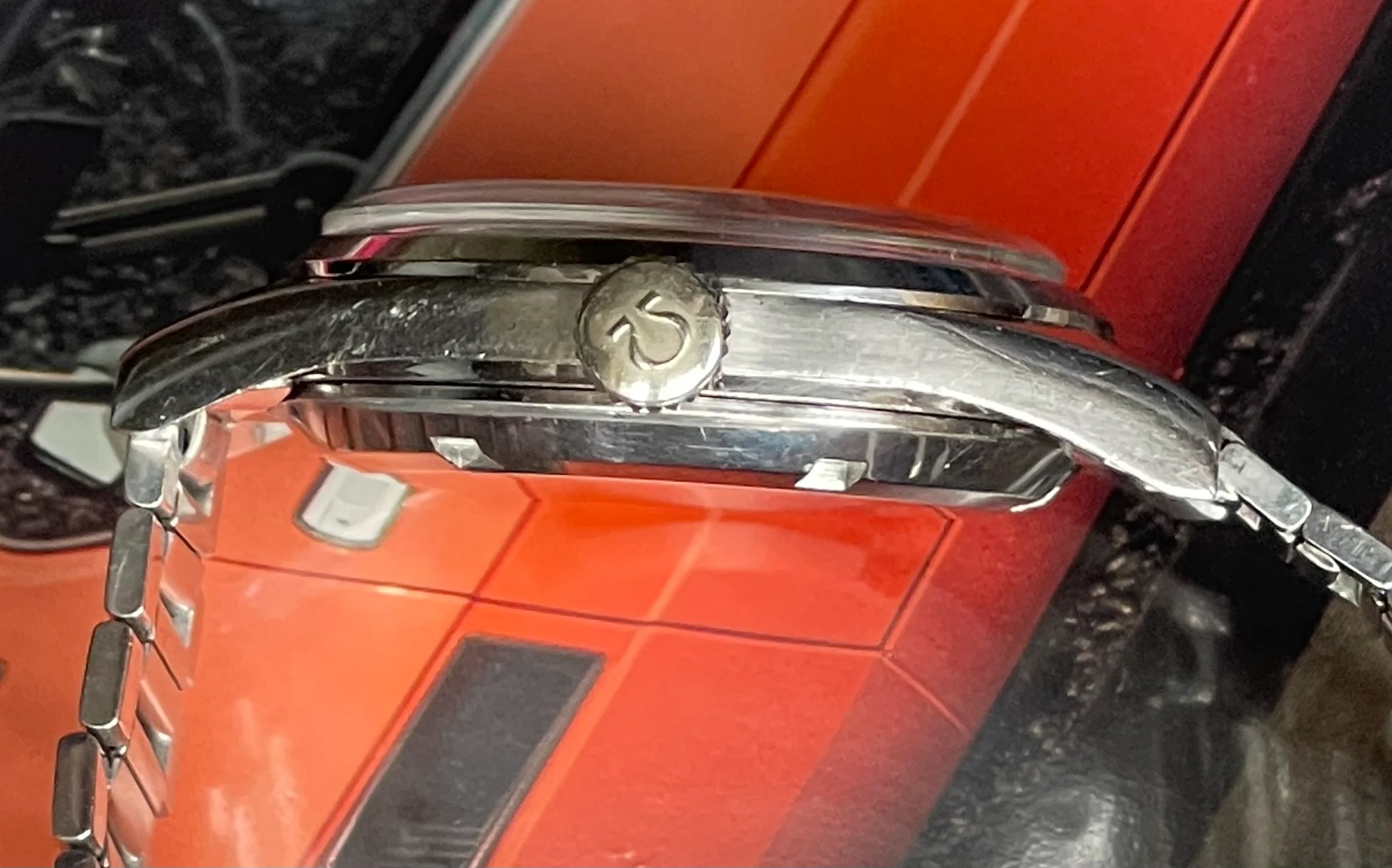

You could possibly get that weld splatter near the crown to pop off but it'll take surgical precision to not scratch the case. A fresh scratch will look 100 times worse.
It's likely the hot splatter made a surface bind with the case, as opposed to melting the case and combing the two metals. If you could get a dental probe under a crevice in the splatter while the case is locked down, you might be able to apply enough leverage to get it to pop off.
You'd probably have a discolored spot at best, and maybe a pit. There's a large potential for causing more damage. Someone who lasers and restores cases like LA watchworks might be able to remove it without doing damage.
I imagine most people who read this will have an apoplexic fit. It's not something I would attempt myself. But I think it's possible. I worked as a welder while in college and had lots of experience with splatters. Some came off, others didn't. The worst ones were the ones that went into your boots between your ankles. I had a lot of socks with holes.
Not impossible, but not likely to be removed without damage.

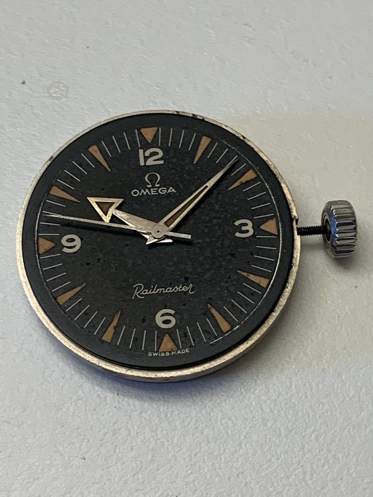

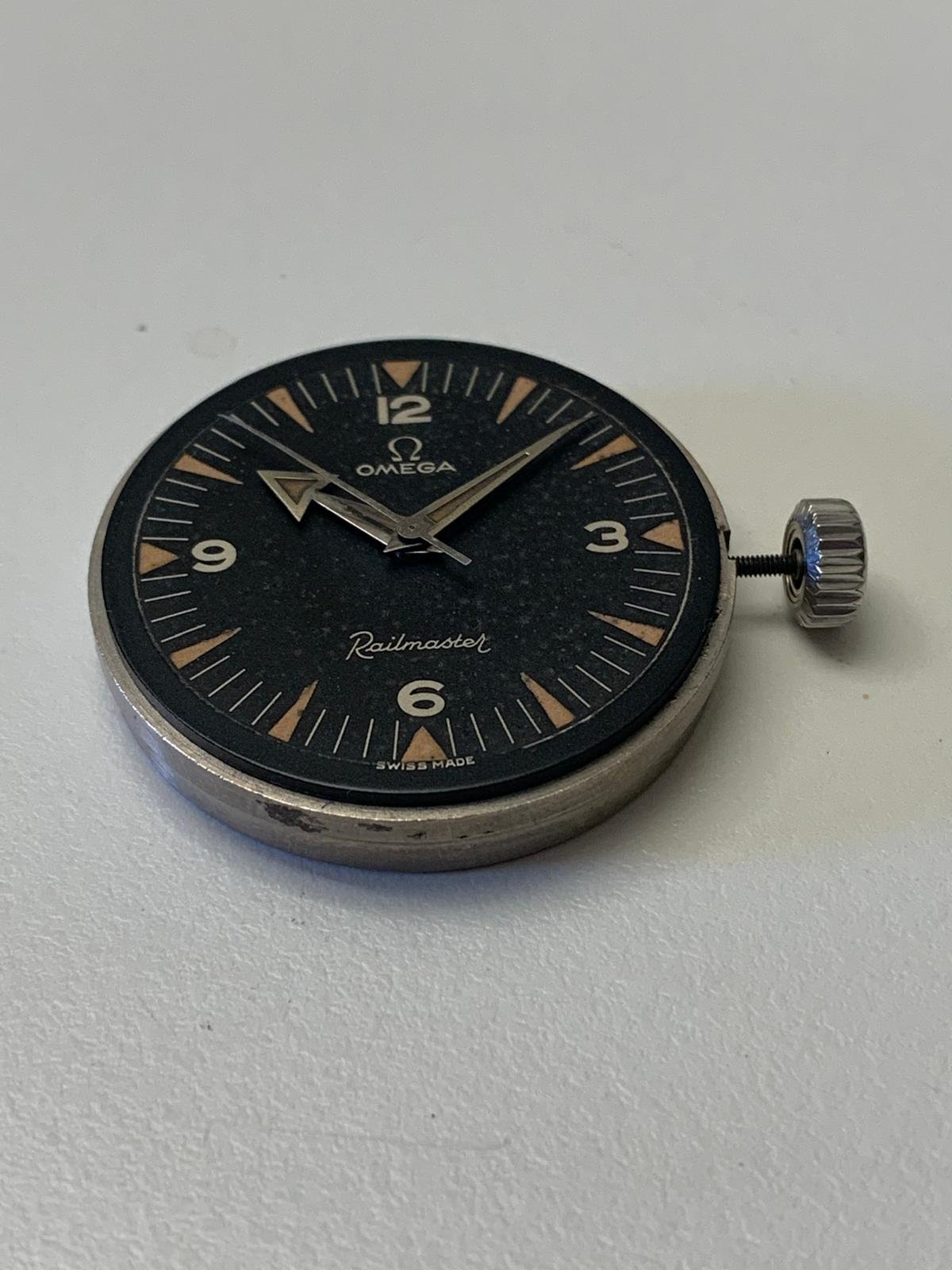

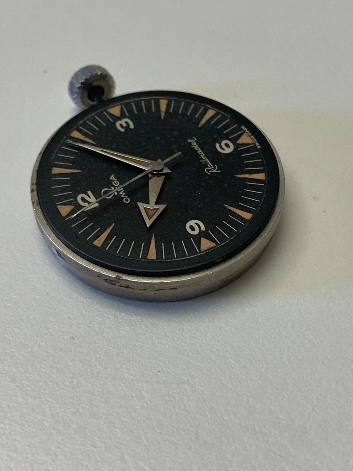

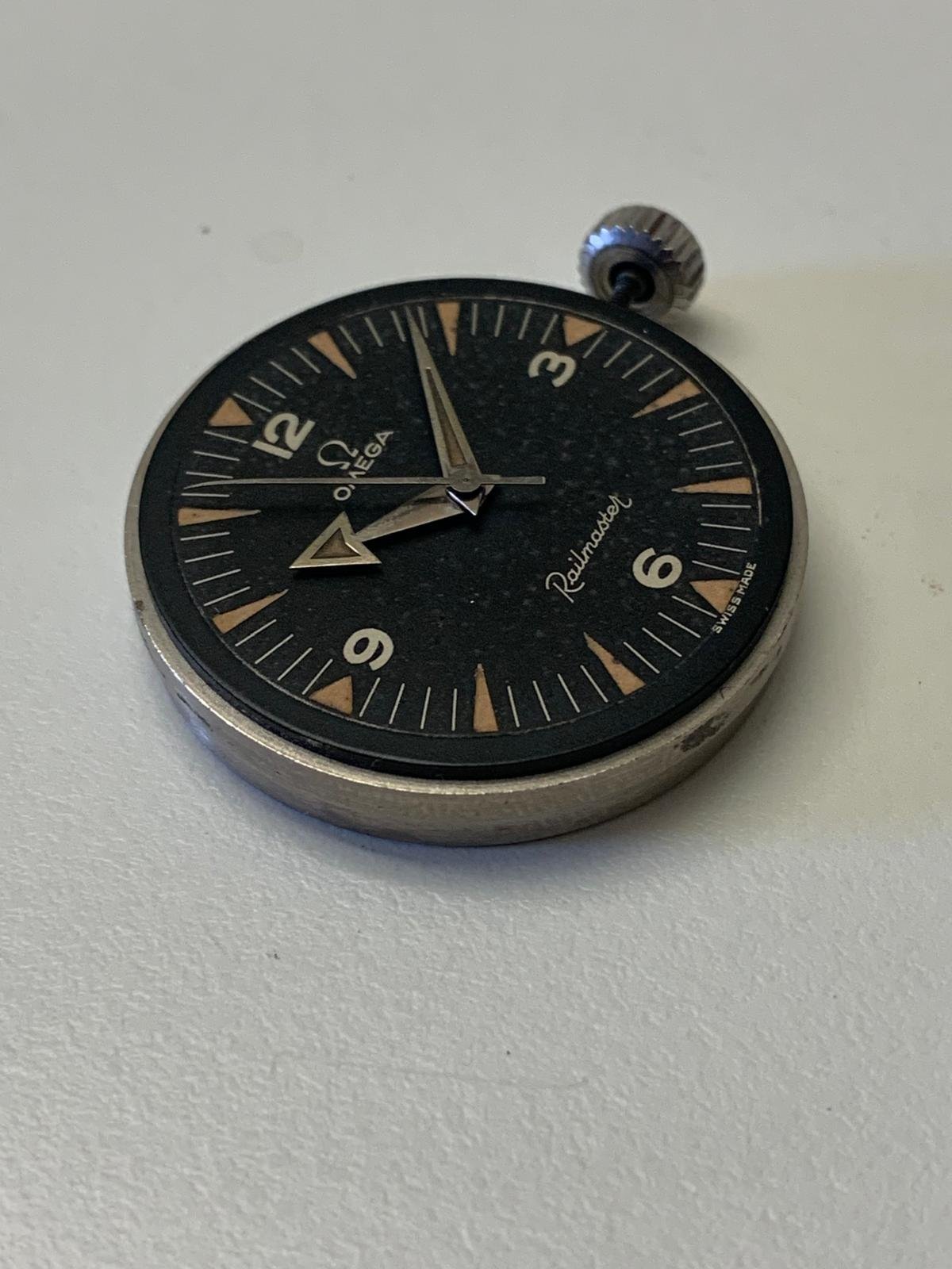

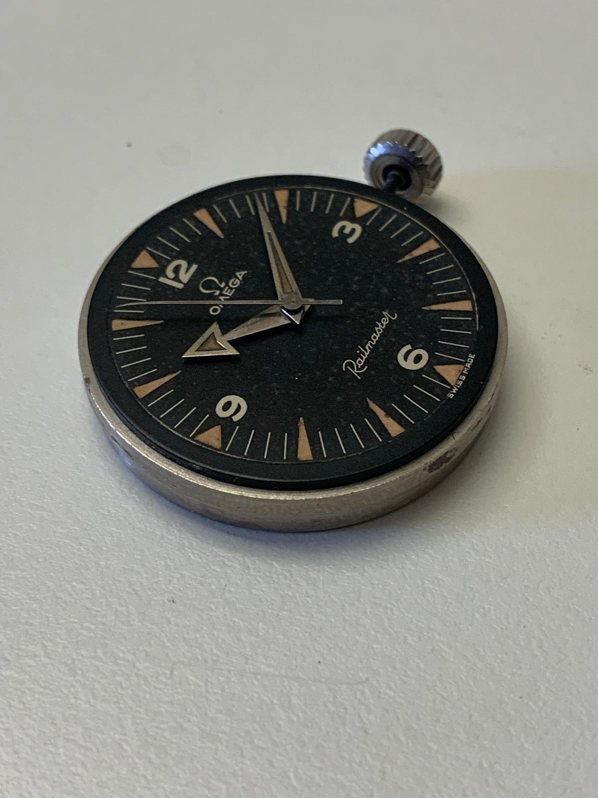

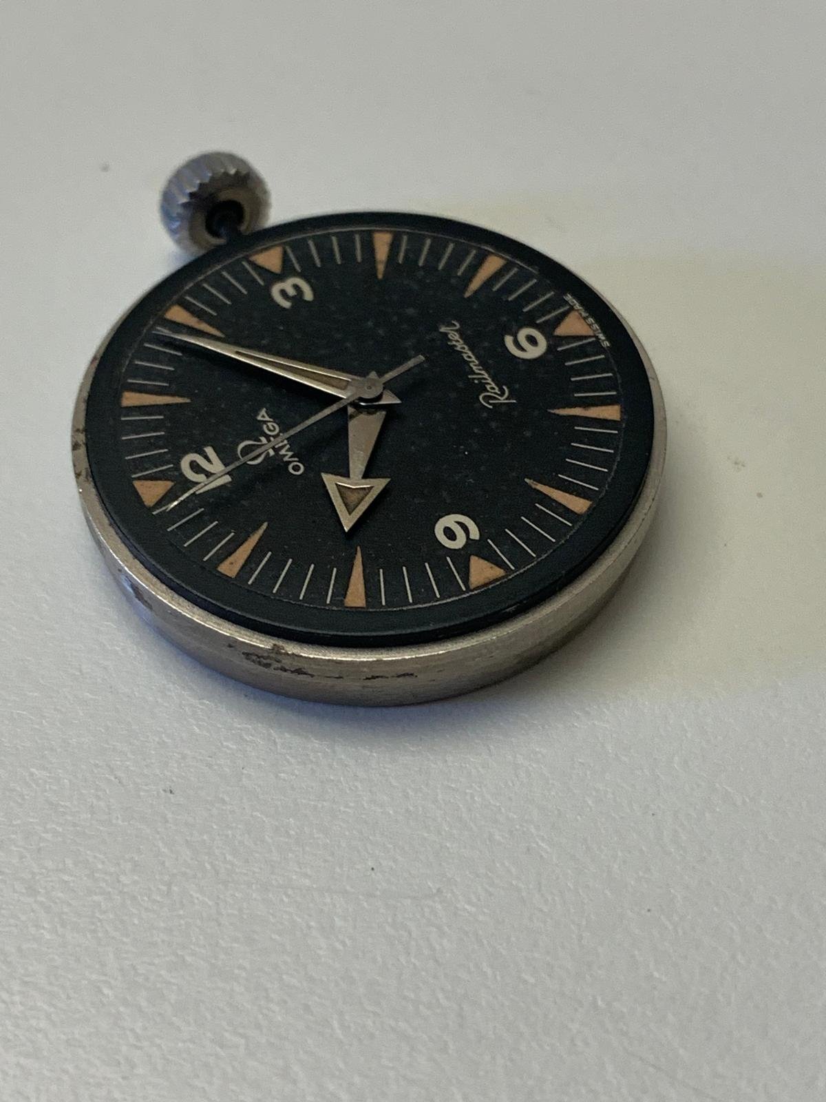

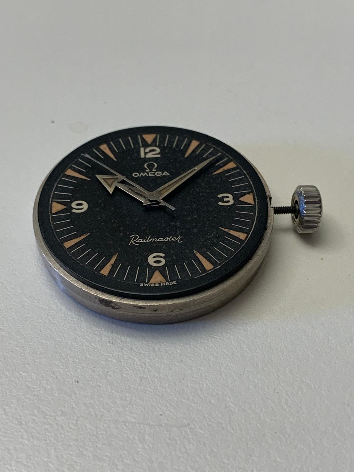

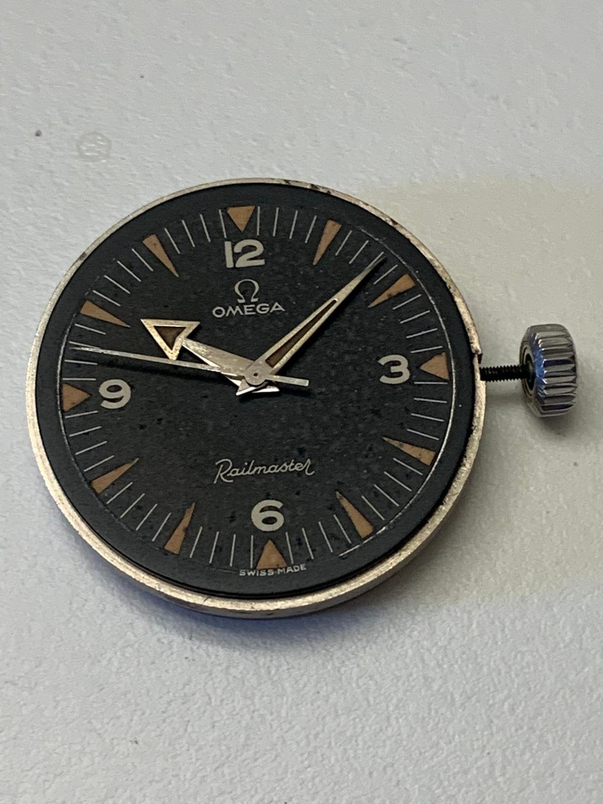

Hi everyone, as an update:
The watch is with my watchmaker, initial pictures of the dial show it’s in good condition.
Movement needs service but its in good shape.
The crown unfortunately needs to be replaced, I’m no expert and I may have the wrong English terms but the crown and the stem are no more completely attached to each other so I think that will take some time and probably I will have to find a service replacement because I understand originals are almost impossible to find.
The glass may be salvaged but there’s a noticeable crack, not sure if it’s a sign but in the past couple of weeks I saw a couple of posts of people worrying about radium in their watches and one of the most reassuring comments was: “it’s nothing to worry about, as long as the plexy has no damage and its well sealed” so now I’m also thinking about a replacement plexy, just for peace of mind.

Huge congrats!!
Dial is very nice, that lume color is just perfect...
Hope to see the finished results soon, under a clear crystal perhaps!!

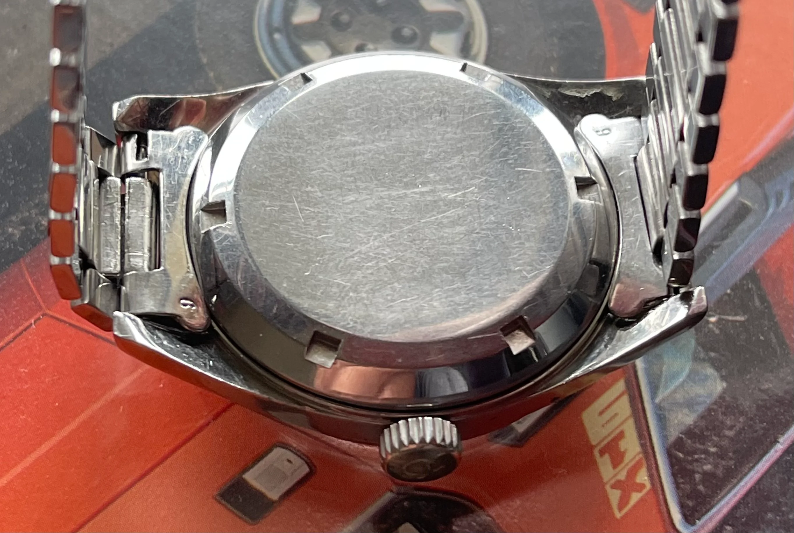

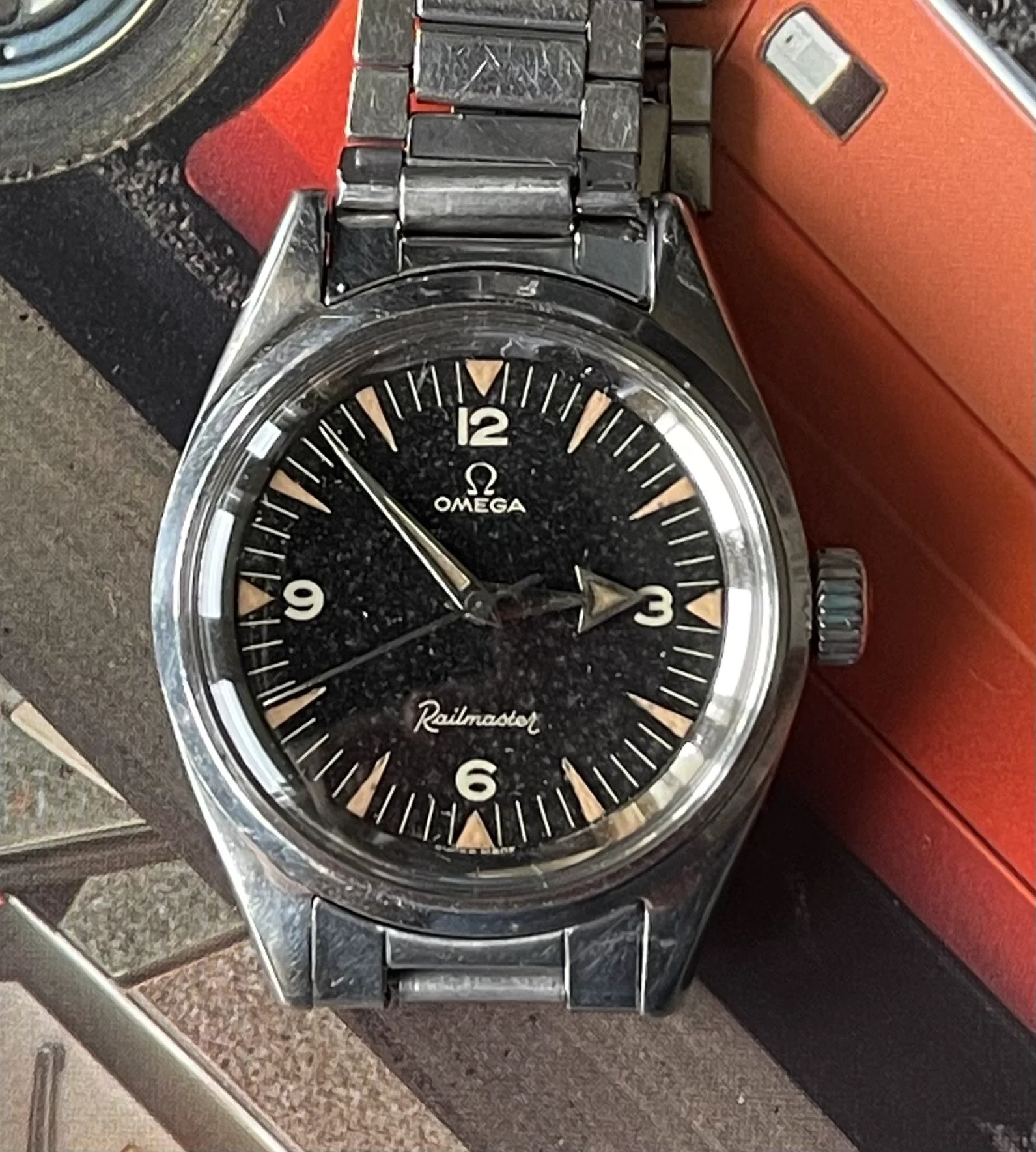

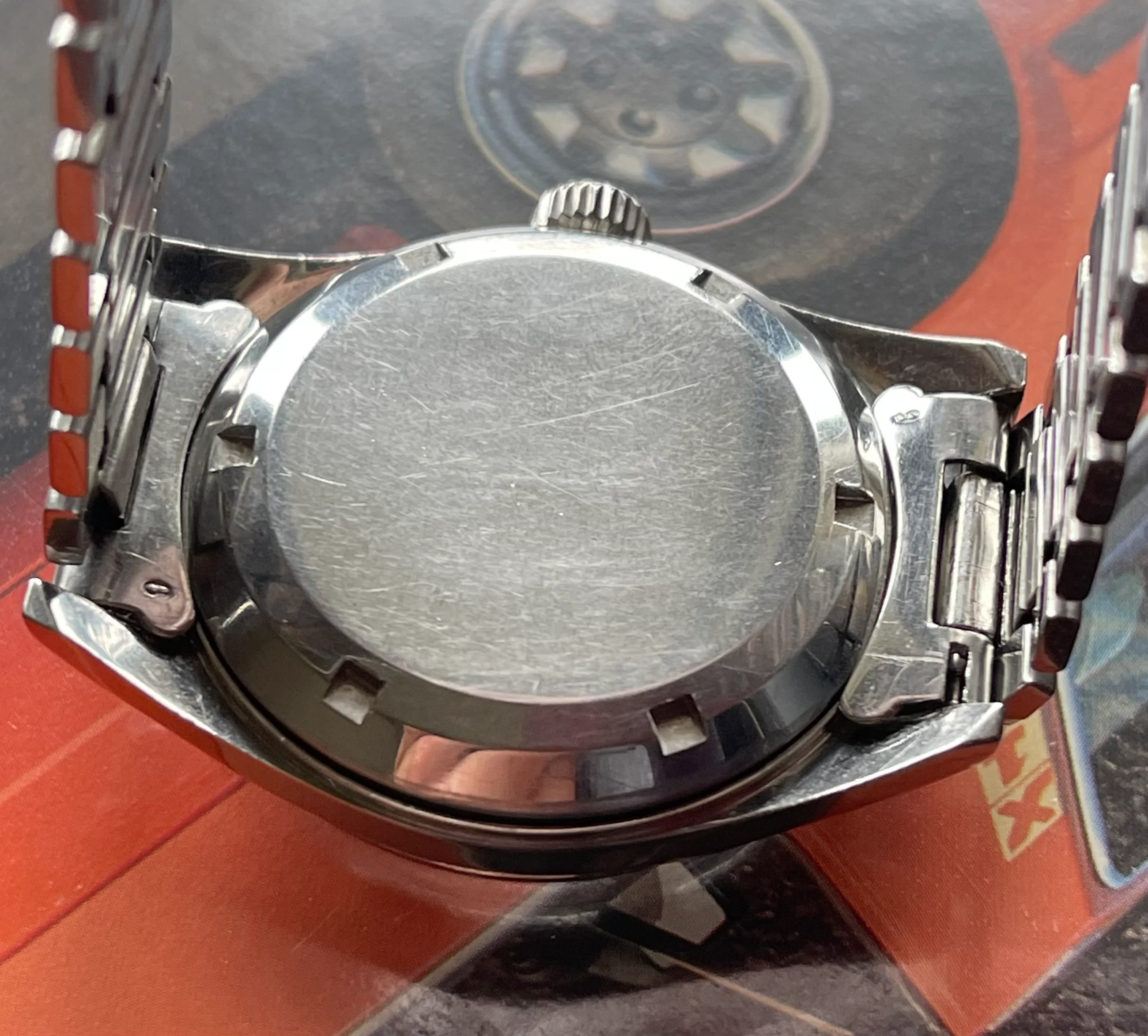

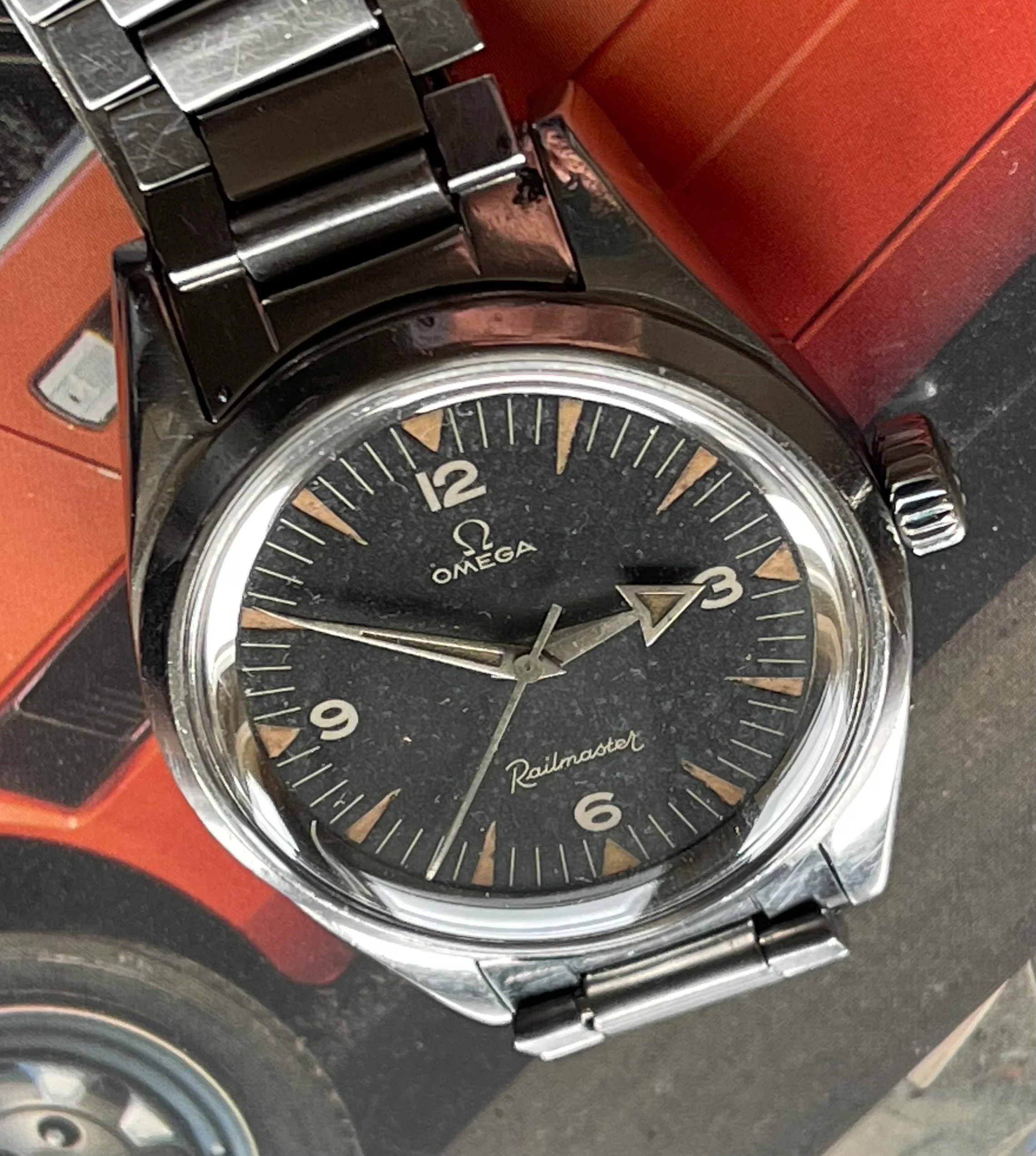

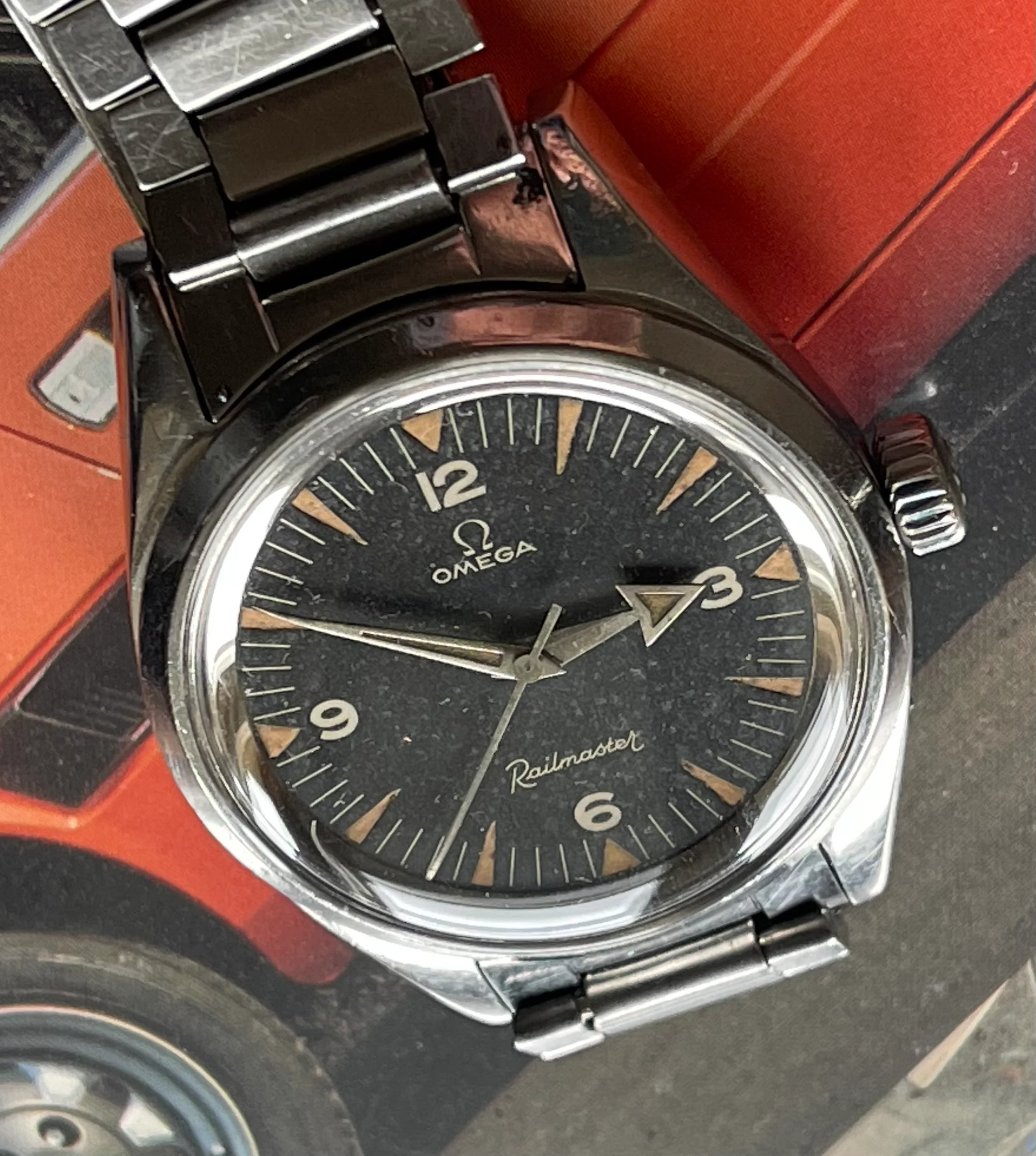

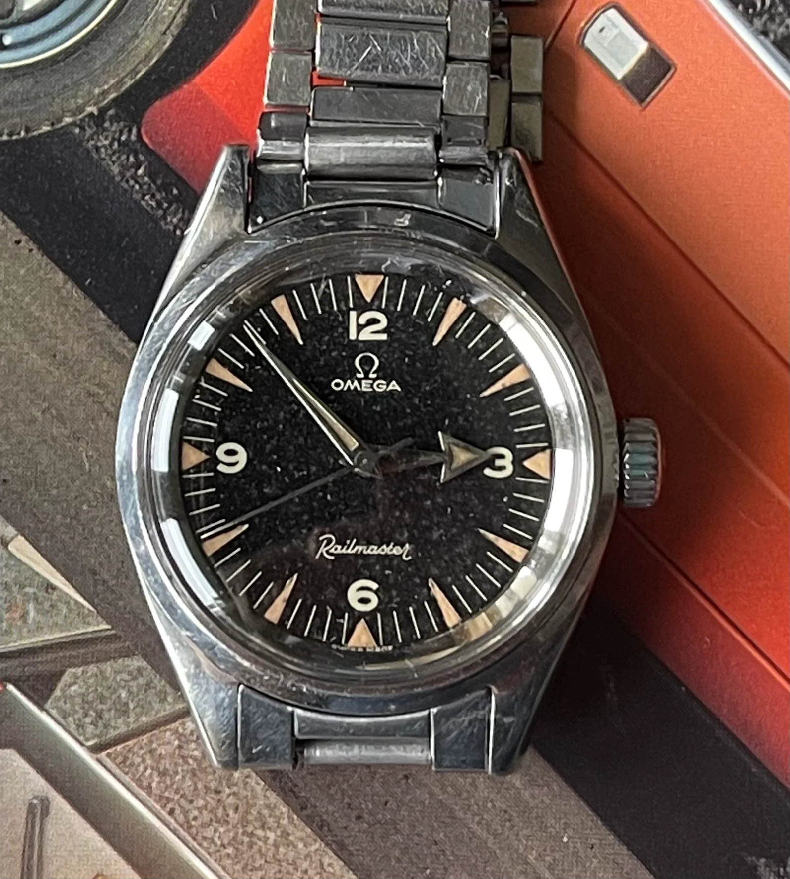

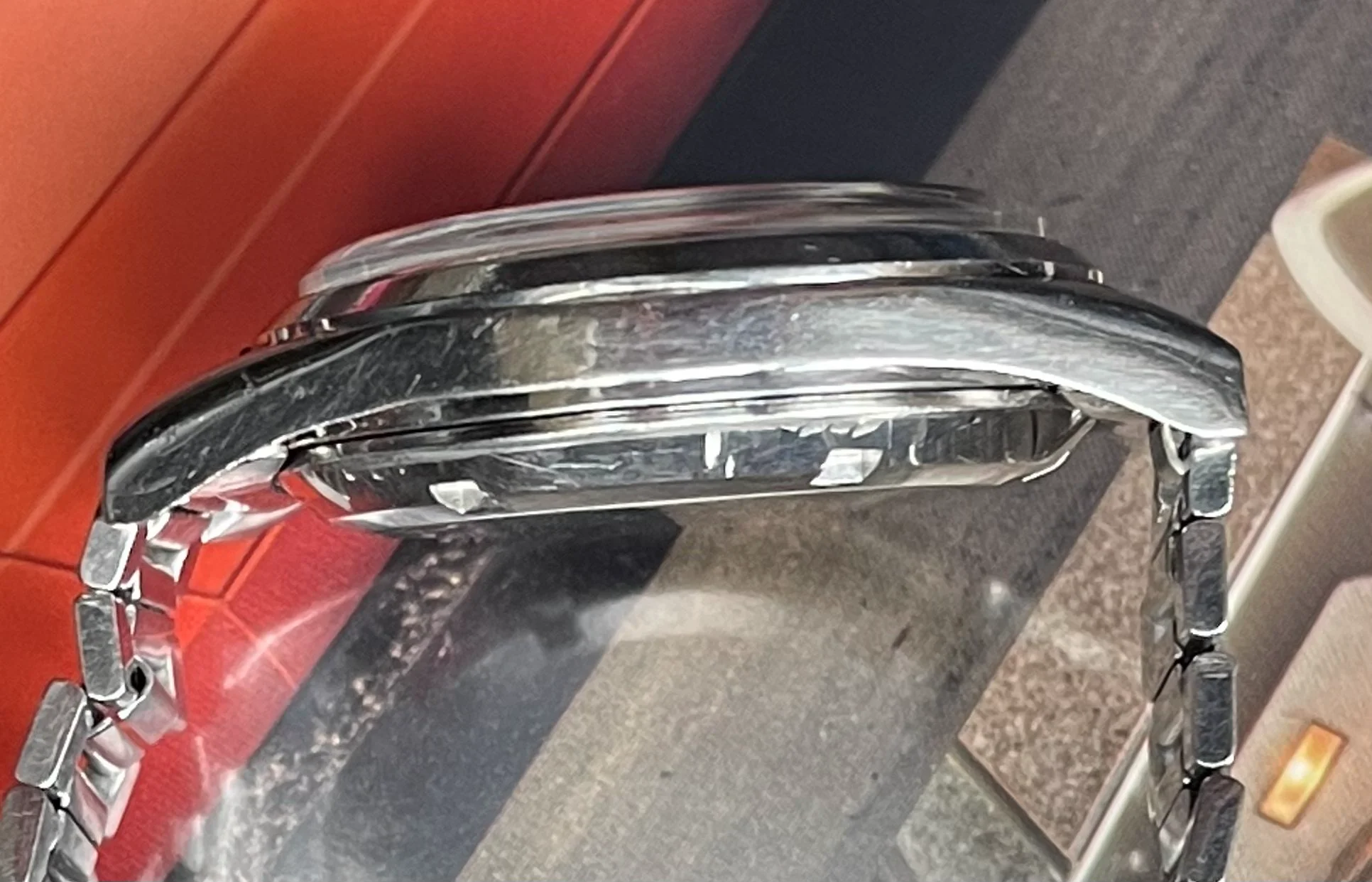

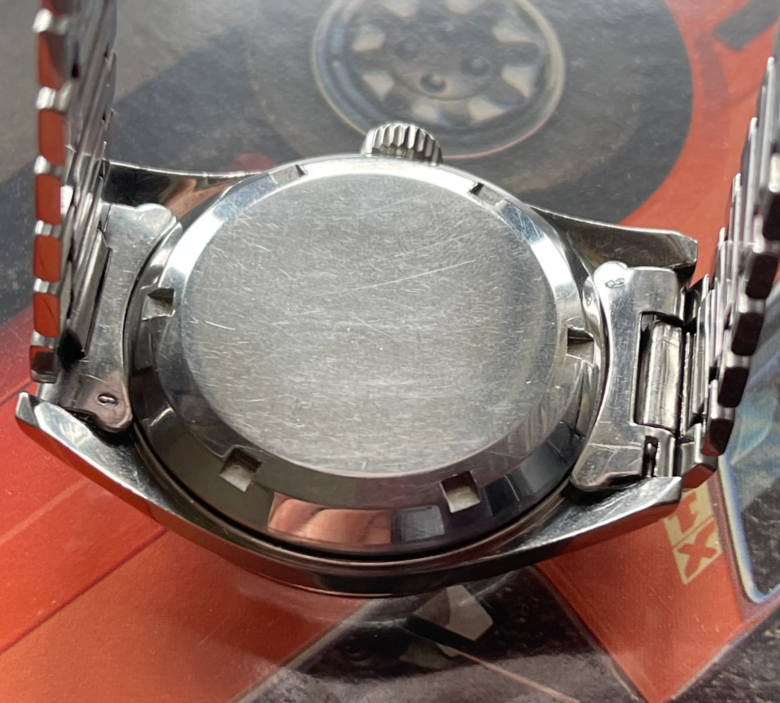

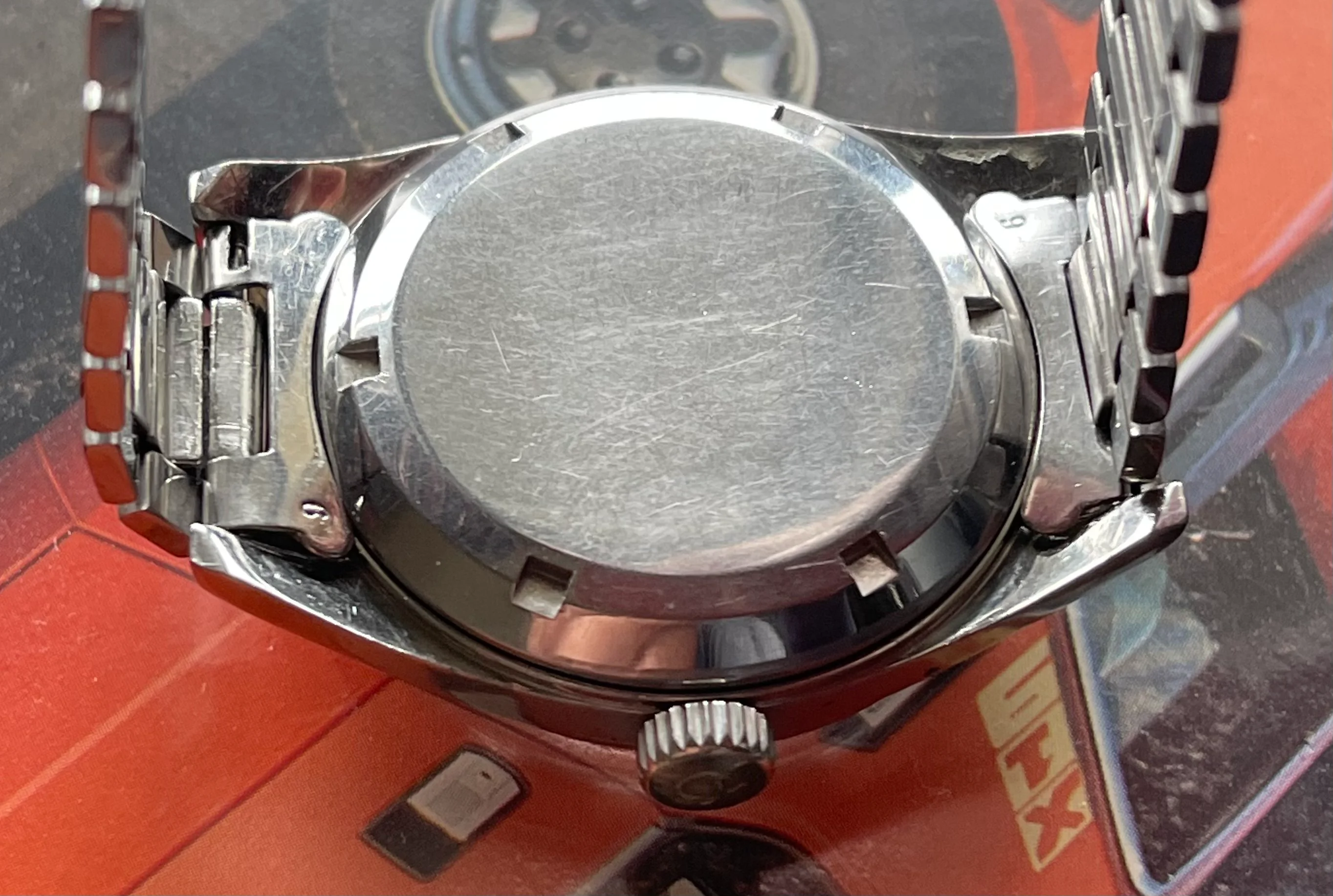

Hello all,
Just thought to provide an update after getting the watch back from service, i feel like in the near future i will need to have some additional work done but for the moment i am enjoying the watch with his signs of age.
-Crown: as mentioned the crown needs replacement, my watchmaker confirmed at some points it's due to detach from the stem and i will have to find a new one.
-Glass: the one it came with had no Omega logo and since there was a sizeable crack we opted for a modern replacement (attached a picture of the part number).
-Bracelet: my watchmaker improved the condition of the first links (the ones near the end link) since they both looked like amateurish DIY projects
Apart for the above we decided to leave the rest as is, service the movement replace gasket and enjoy, maybe at some point in the future i will get someone who knows how to replace the elastic band in the bracelet but i'm in no rush, i like for the watch to show its age.
And here are a few pics, have a great week all!
