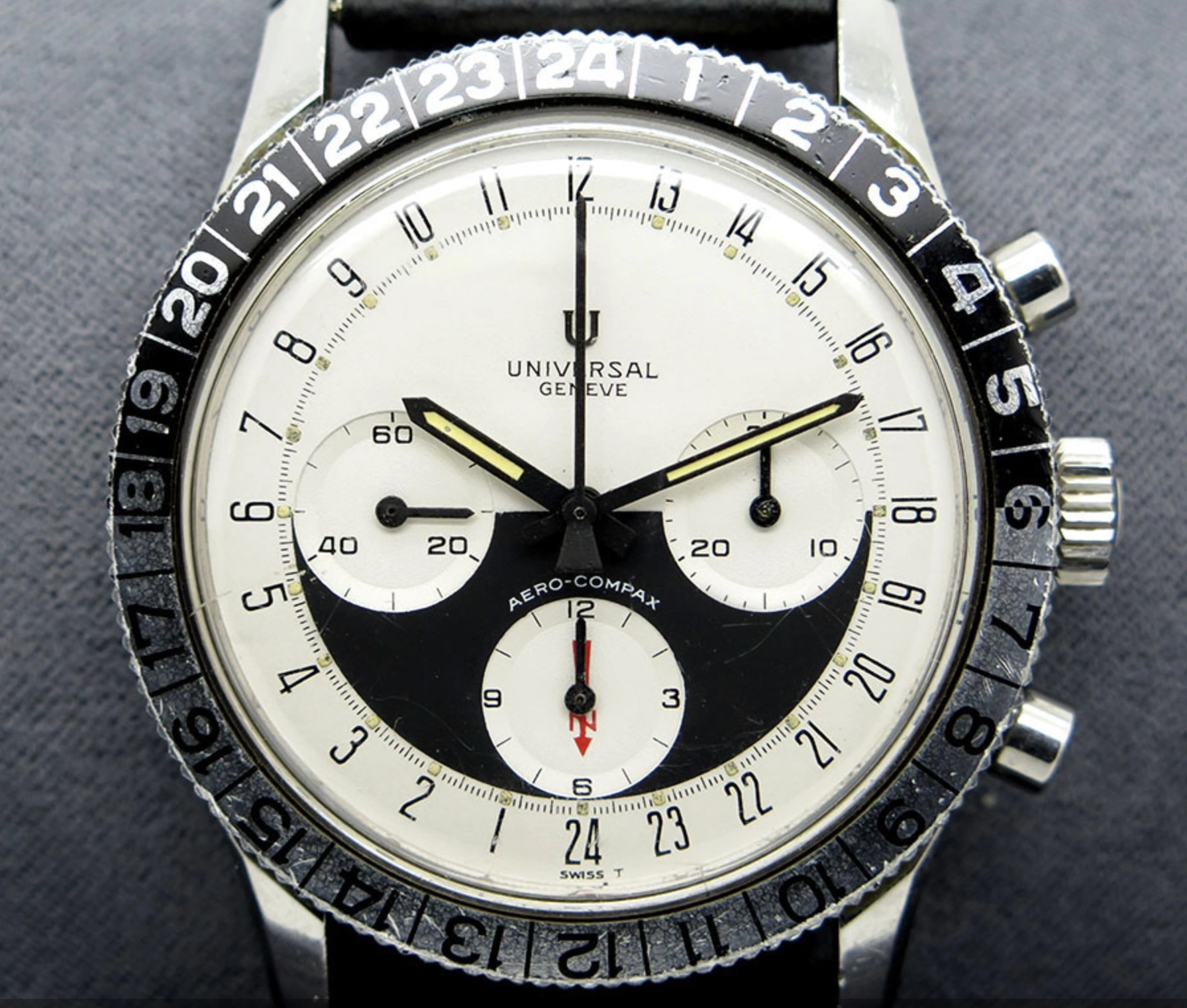

This is a great thread - another example of the collective spirit of this forum at work. I want to add some hard evidence to the discussion on these day/night dial UG aerocompax refs 890101s as I was recently lucky enough to land one and was discussing its merits with @chronoboy64 in another post. I won't get into the color scheme criticisms other than to say I have no readability issues with black hands on black dial and I like the hands better than the silver ones.

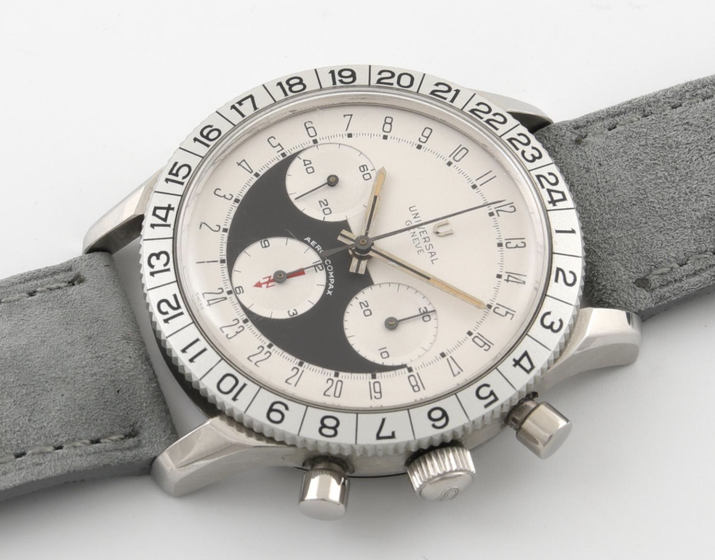

I'll present a few other day/night 890101 examples and their serial #s all with 2583xxx.
Also note @bubawatch day/night dial shown earlier in this thread is also a 2583xxx.

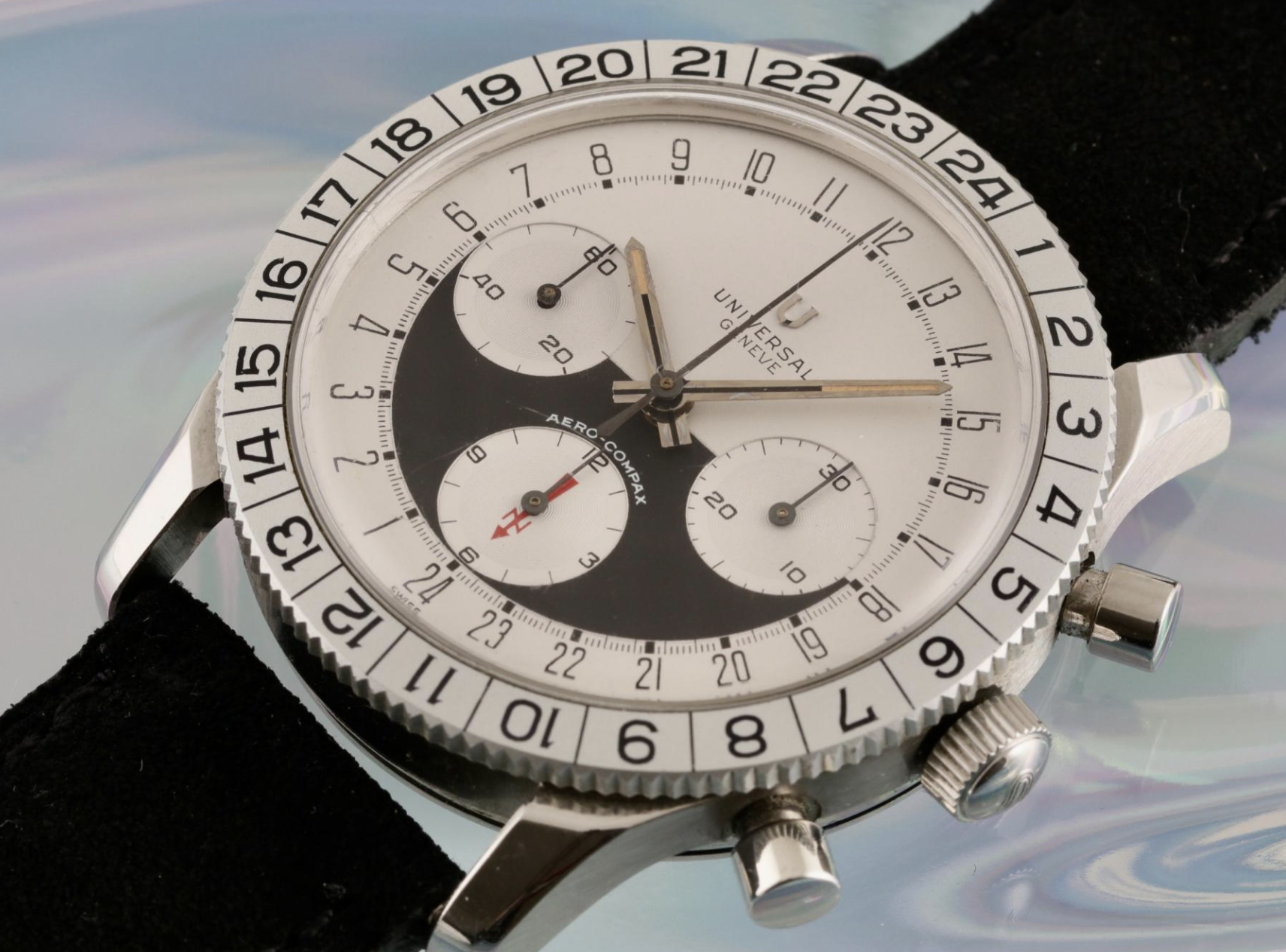

Here is one at sotheby's that sold last year (serial # is less than 10 off from mine): http://www.sothebys.com/en/auctions/ecatalogue/2018/important-watches-n09879/lot.293.html?locale=en
And another at Bernadini Milano: https://www.bernardinimilano.com/products/universal-geneve-aero-compax-4
Bernadini, Sotheby, and my day/nights all fall within 100 of each other and interestingly the Bernadini watch also shows the "HON" mark on the movement which would indicate imported to the US- like mine. I wish I could get the movement shot of the Sotheby's and @bubawatch ones to see if that too was marked HON.
Another counterpoint to the main argument member @Mlafra makes - that the day/night dial chrono register would probably tick every 30 seconds intervals- mine and the sotheby one doesn't (I can't say for the other two I mentioned). Mine counts at the proper intervals in regards to its dial- 1 minute ticks for 30 minutes.
Hopefully this can dispel some assumptions and add some more color regarding these beauties. If anybody has more to add in time we might be able to get deeper but for me the easiest explanation is that this 890101 day/night dial was just a variant that was offered in addition to all white dial 890101s that are more commonly seen/documented and all that I've seen fit within a reasonable range of serial #.

Hi @Mlafra - This is intriguing to me. Do you have any hard proof or are you just speculating based on what you think/feel should be right for the manufacturer's designs?
Anyway to explain the close range of serial # in the examples I've seen and the 1 minute counting movement function matching the day/night dial's 3'o'clock subdial which you initially thought would be the major indicator to prove your line of thought?
The old applied logo was still around in the 60's no? Why would that be such a dramatic anomaly?
Basically you are saying whoever installed the day/night dial on these serials (all within close range of each other) also modified the movement to count 1 minute ticks instead of 30 sec ticks. So a guy got a hold of a number of them within a close Serial range of 2583xxx and then mounted these day/night dials and modified the movements and brought them to market. I think that is what you're saying but please correct me if I'm wrong.
Any other members with thoughts and more importantly facts please chime in. One of the draws to the brand is the mystery, not everything is cut and dry, and debating them is part of the fun.
*edit - member contacted me and said he didn't understand our discussion re. the movement and 3 O'clock subdial differences on the references so added a photo explanation:

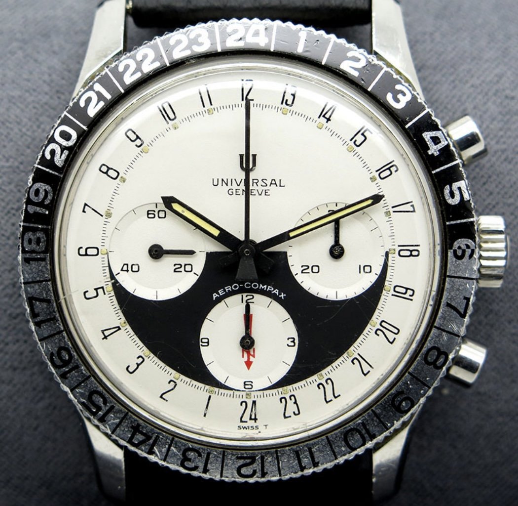

I did some more homework and I appreciate the members who have helped me dig into this so far and also apologize to @Mlafra if my last post sounded sarcastic - wasn't intended I just get excited with the investigation.
1st Update-
I made a mistake - I put the 1st Day/ Night dial shown very early in this thread back when it started in 2014 within serial range of the 3 others that I mentioned (mine, sothebys and Bernadini) but that one is a 2538xxx not a 2583xxx so about 5 thousand off the other 3 examples.
Also confirmed by the owner of that watch that it does not function in accordance to its day/night dial- its chrono counts to 15 minutes in 30 second increments - the same way the all white dial 890100s and 890101s were designed and not the way it should given the Day/Night dial presently mounted. Possibly this is one of the watches that have added confusion to the day/nights by throwing people off and giving credence to doubts...
2nd point- I was able to confirm that the Sotheby day/night watch's movement was marked for US import. So mine, Sotheby and Bernadini - all less than 100 digits serial range (mine and Sotheby within 10 of each other) - were all 3 marked for US import. That's important because its possible this day/night version was only distributed to the US.
Here is also what Sotheby said of the watch they sold:
"This was either a full on prototype made in a small number, or simply a variation (also made in small numbers and possibly only for the American market)."
3rd- I reached out to Sala showing him my watch, and it's ref/ serial and asked him A) Has he ever seen one before and is it a legit variant or a transplant/franken from the all white dials 890101s.
His response:
"About your question, I can say that the typology of your dial I had already seen on a serial 25837XX refs. 890101/01.
Then if the quoted serial is 2583xxx, I would say that it holds up the varying dial, and also the white and black fanlights...etc...I don't have anymore deepened the matter....because I don't was interested in these typology of production."
My guess was he was using google translate but either way- he's seen one before and his considerations clear. It is now the 4th day night dial with serial 2583xxx.
I also reached out to Universal asking them if they had any advertising or any kind of documentation really that would shed light on the difference of this day/night ref from its white dial brethren and they came back with a standard archival report that is a an emphasized fwiw which isn't much but I'll keep the data recorded. The main thing of interest is the Date of manufacture: 1967. I have seen Nina's with that manufacture date and the applied logo.
I also see the other points members have made re. the watch and its idiosyncrasies/mysterious origins. It all brings me to what styggpyggeno1 said in another thread once that stuck with me: "For me it often comes down to probability x execution x price/"who would gain" math"
Yes the hands are inconsistent, and the records extremely limited, but for someone to have snapped up a handful of these watches, the ones investigated in very good shape and within short serial range of one another- take the risk of removing the perfectly beautiful white dial, adding a day/night dial, then modifying the movement to match the new dial's counter, then bring it into market- seems like a very big and difficult risk to take. Its not like the white dial ones are going cheap. Couple that with Universal's known penchant for the inconstant re. their dials, handsets, case combos, etc.- that logic just doesn't add up for me. I think it's more reasonable that some people have been transplanting these day nights into legit all white dial 890101s and that is where the confusion and doubt has come in- for the very few legit day/nights that are around
Sala had one more tidbit for me that I'll paraphrase because the translate was screwed up:
"However this period has been a particular period for Universal, if you agree, infact in this period anything could have happened....."
I think in the end- whether this confirms or doesn't for you, this is the best part of this hobby. You either will believe or you won't and this is what makes the brand awesome for me. My theory is the simplest of all. Universal would've been dumb af not to use this dial once it was made because it's just too damn pretty.

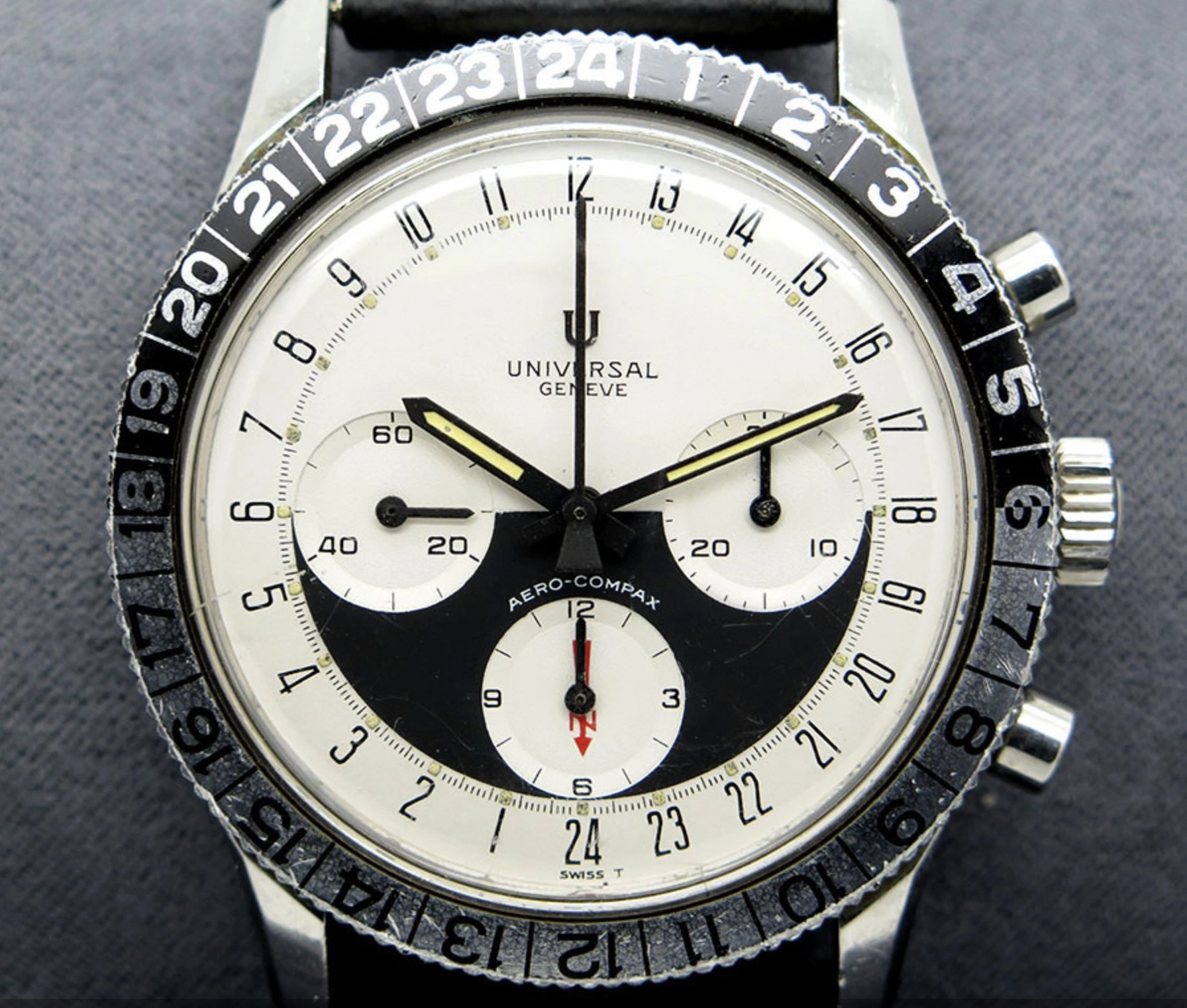

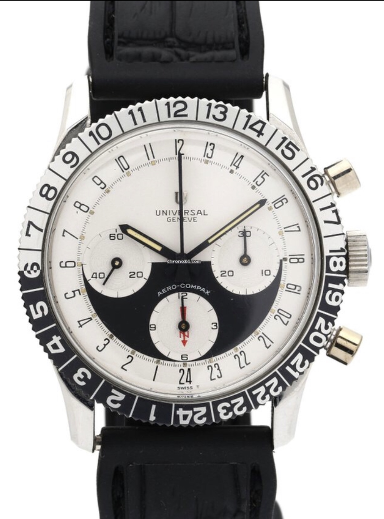

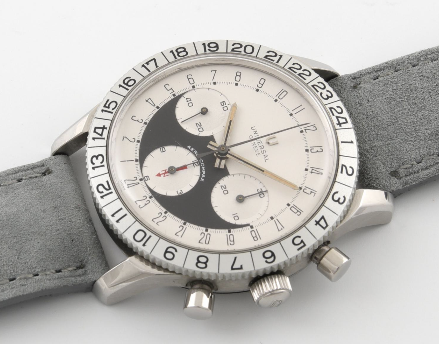

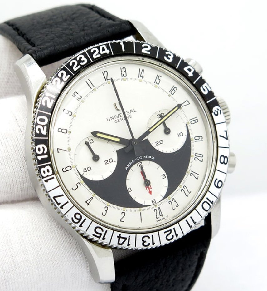

A thread revival of (hopefully) some import to the discussion RE the day/night variant (unless being widely discussed on another thread I’ve missed, in which case 😬

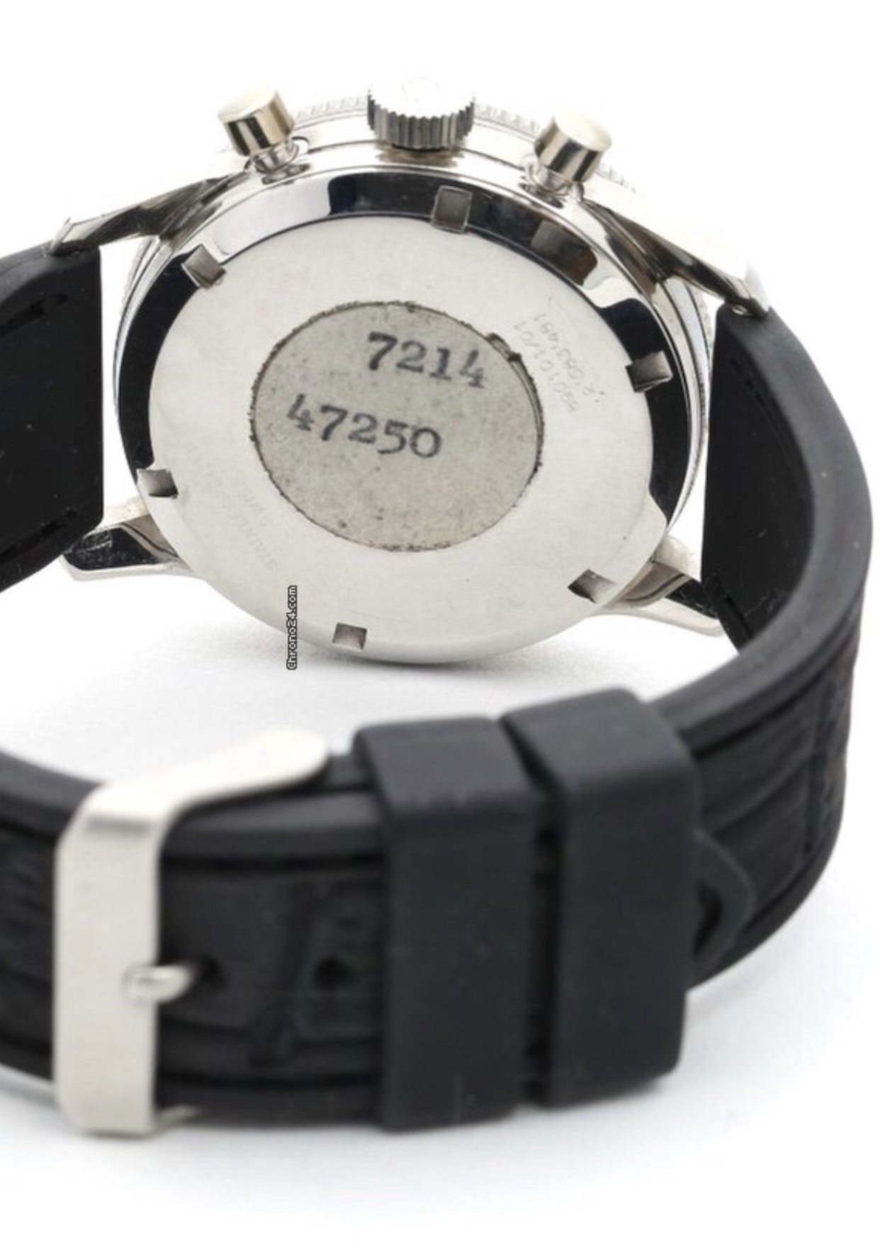

A purportedly NOS example being sold by Timeless in Liechtenstein:
https://shop.timeless.li/Universal-Geneve-Aero-Compax-Vintage-Chronograph-NEW-OLD-STOCK_1

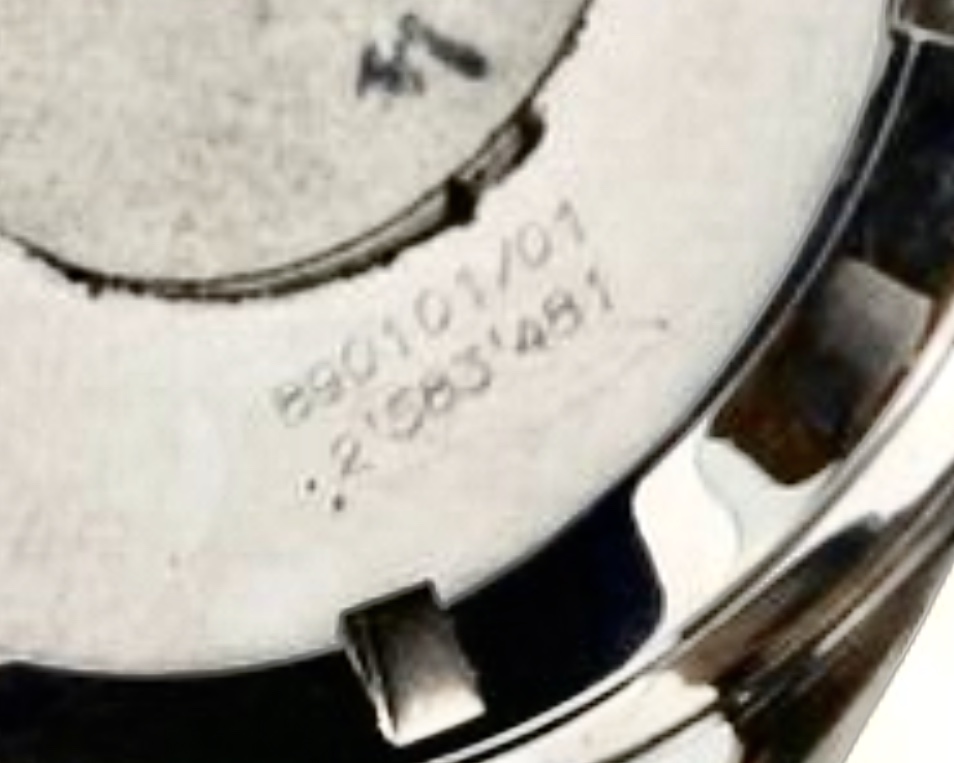

I come bearing photos, particularly the last one (to which I made some readability enhancements):

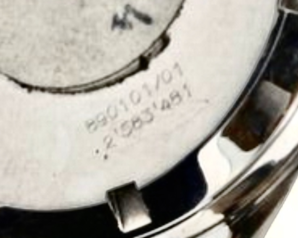

Based on and following this thread’s previous discussions:
An 890101/01
A S# 2583481
Black hands
AM/PM bezel
Purportedly NOS
So:
Set aside the NOS designation for the moment.
The S# is within striking distance of the other 4 examples grouped in earlier posts (will be interested to learn how close), and within the 101 case.
I have written the seller via the web query function on the website, asking whether the sub-dial at 3 moves in 15 second or 1 minute increments. I’ll report back if anything comes of it.
Given the seller’s location and purported NOS status, I’d be interested to know if the movement shows any signs of having been designated for the U.S. market. I did not ask this via the web query (as I take from this sellers Chrono24 postings that English may be not be well suited to complex questions.)
If there are any members familiar with this seller and that could speak with them, better answers and information may result.
I’ll add one observation/question regarding the subject of the long vs short hour marker as it relates to the dial configuration. The versions with outer hours and elongated hour hand all appear to also share another distinguishing characteristic: they actually have a minute chapter inside the hours chapter. In contrast, the day/night dials simply don’t have minutes; which, as far as I can tell, means the dial itself is deficient in a way that may not tell us anything about “correct” hands. Would an elongated hour hand on this dial have made it more or less intelligible? Unclear to me.
Perhaps the lack of minute chapter (perhaos explainable by the graphically-challenging white and black dial background) is arguably a grounds for this watch having not been popular, or even having never been put into production?
Which contra, finally, brings me back to the NOS point. I tend to think all the visible parts are consistent with (at worst) nearly NOS. If so, I would think it may support the view that these dials and handsets, etc., were offered in this configuration. Otherwise, it seems unlikely that such a pristine dial finds its way into such a pristine case/bezel. (Recognizing that this thread included @chronoboy64 with a decent to great looking free floating dial, I can imagine the effort it would take to pair with a crisp case.)
Should anyone care to purchase this example for me, I’ll happily share all the information on it that I gather from staring at it for several months.

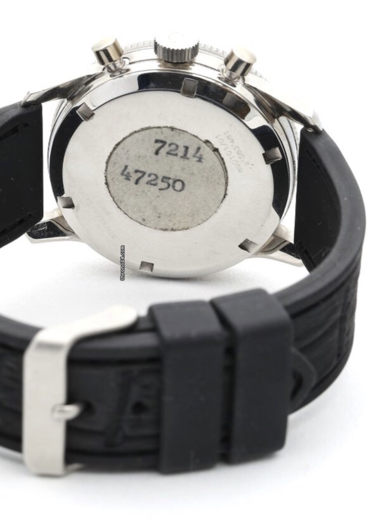

When I look at the subdial hand in the second sub register I can not confirm that this is all original, but more likely put together.
Best

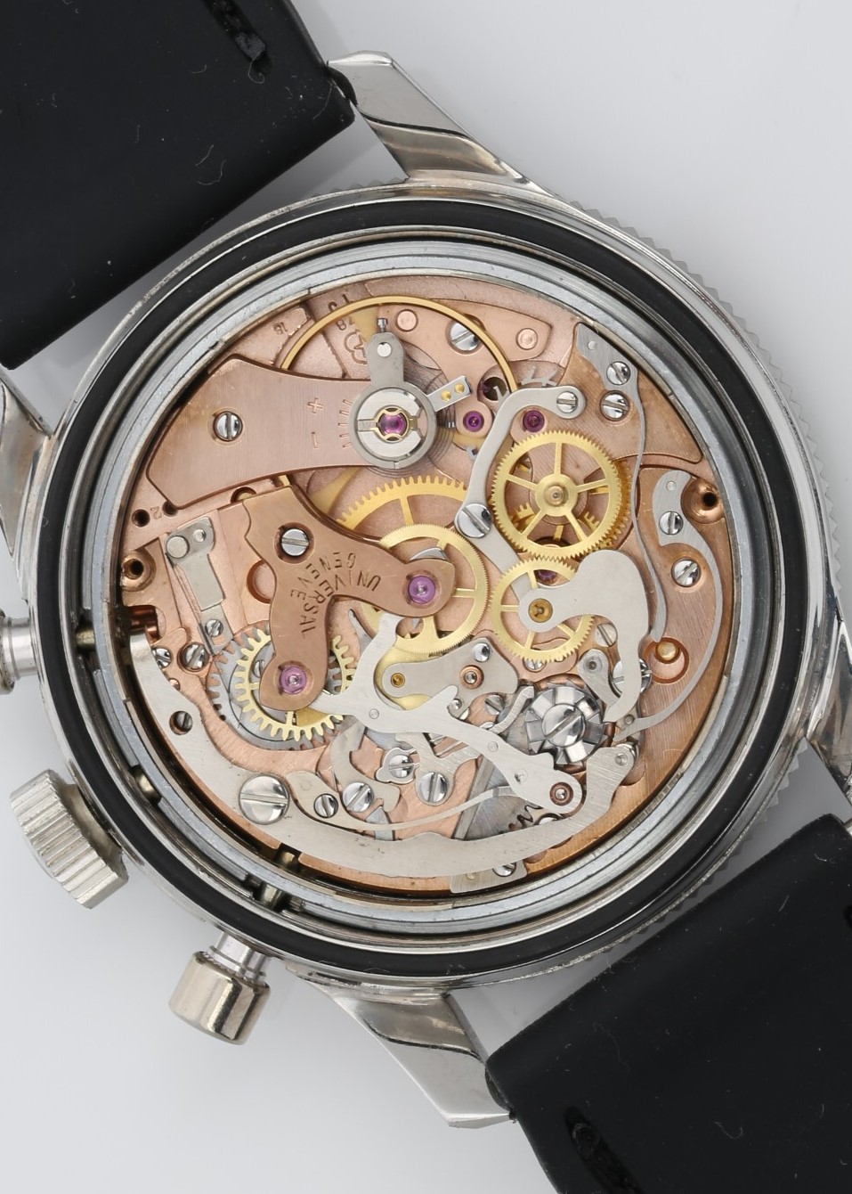

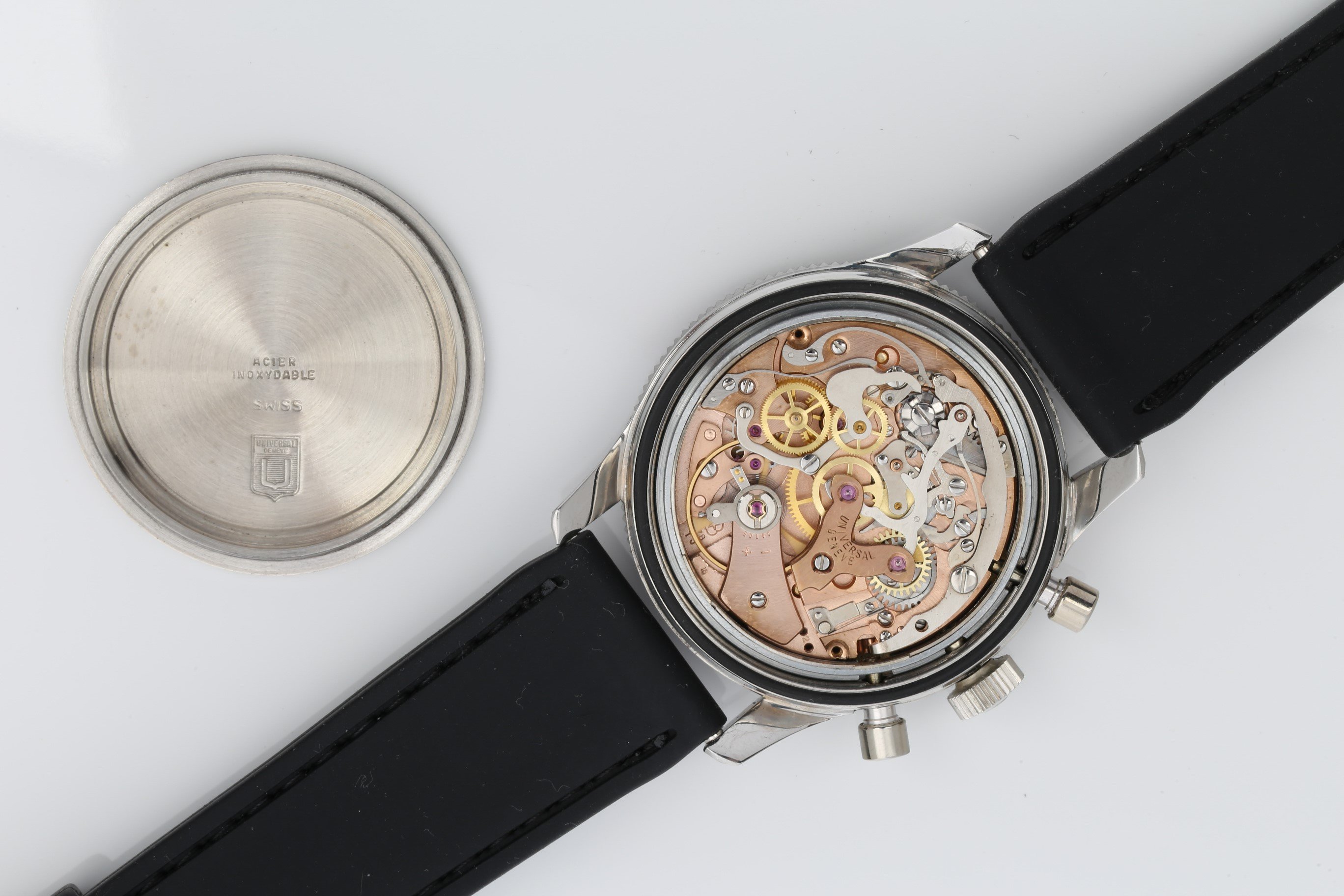

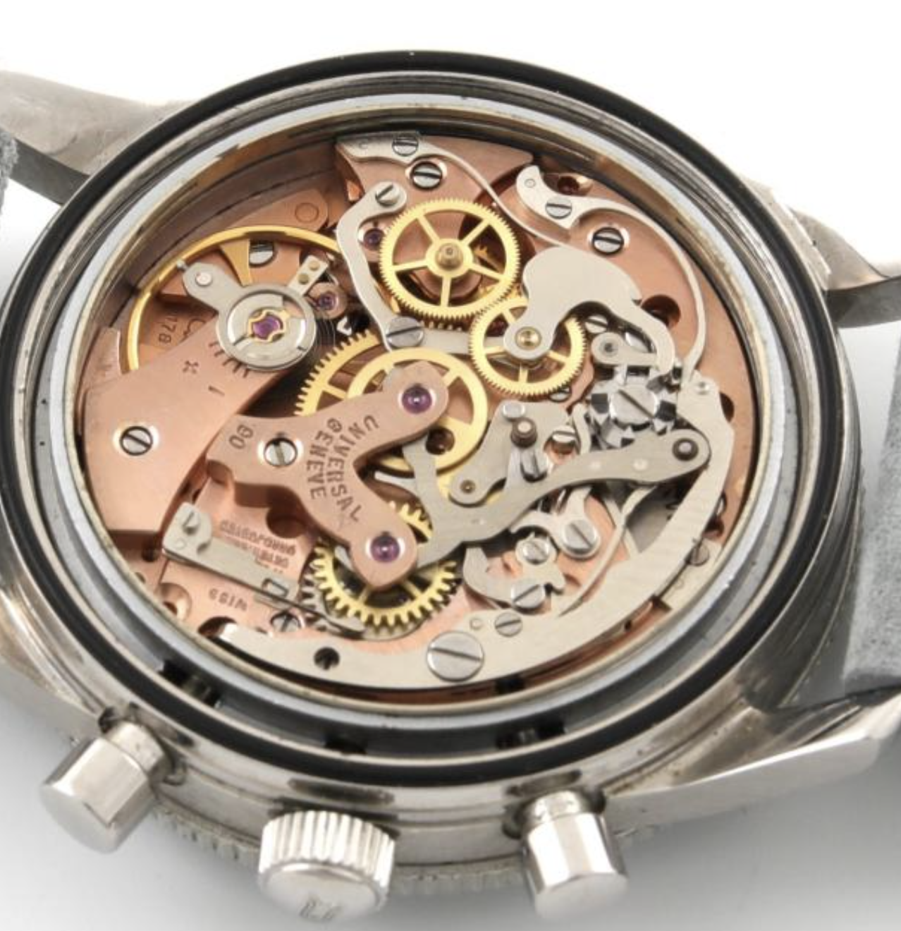

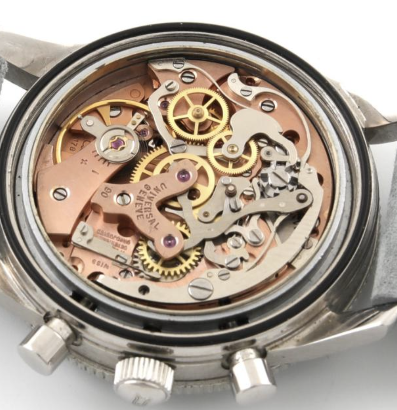

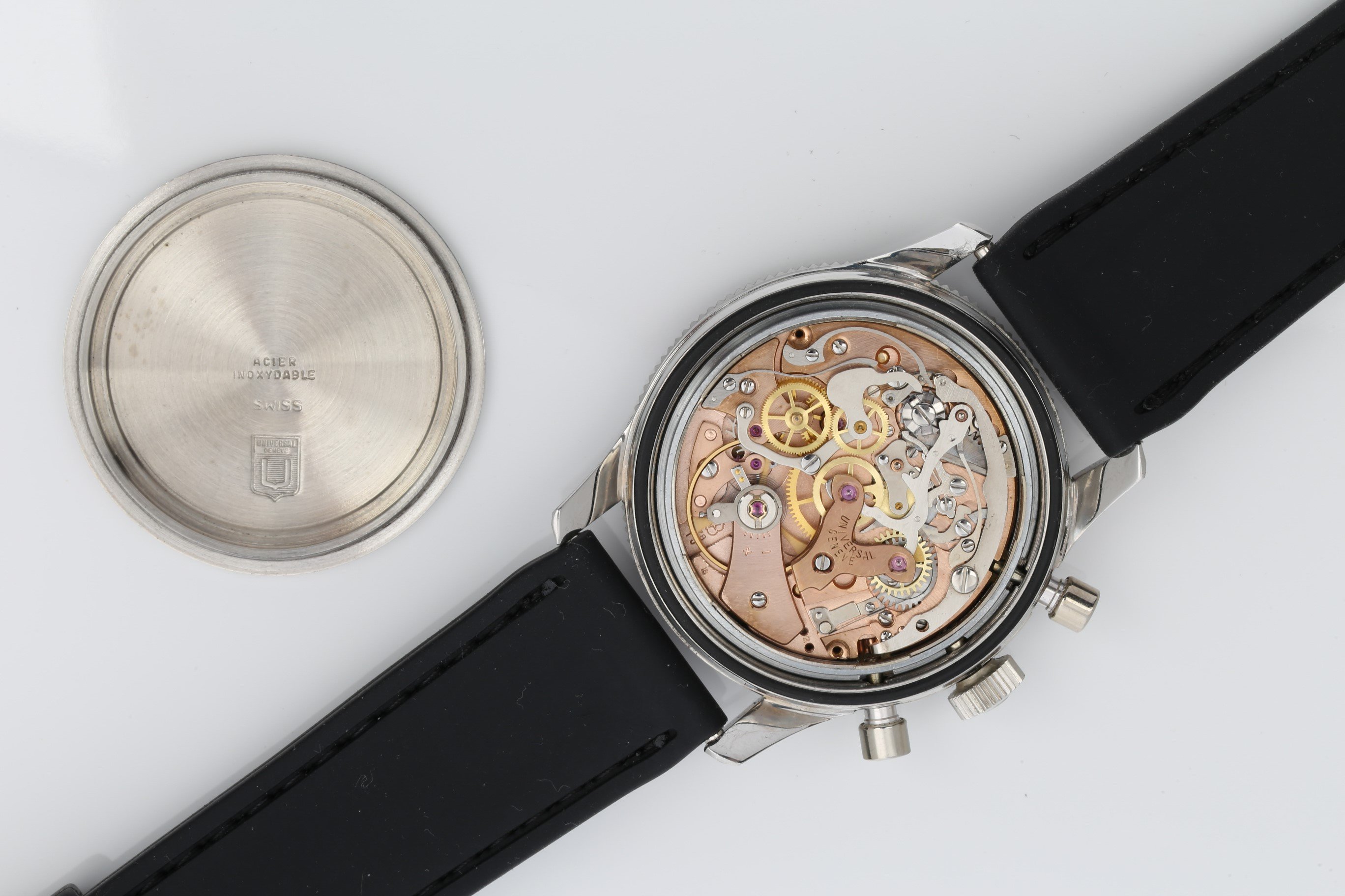

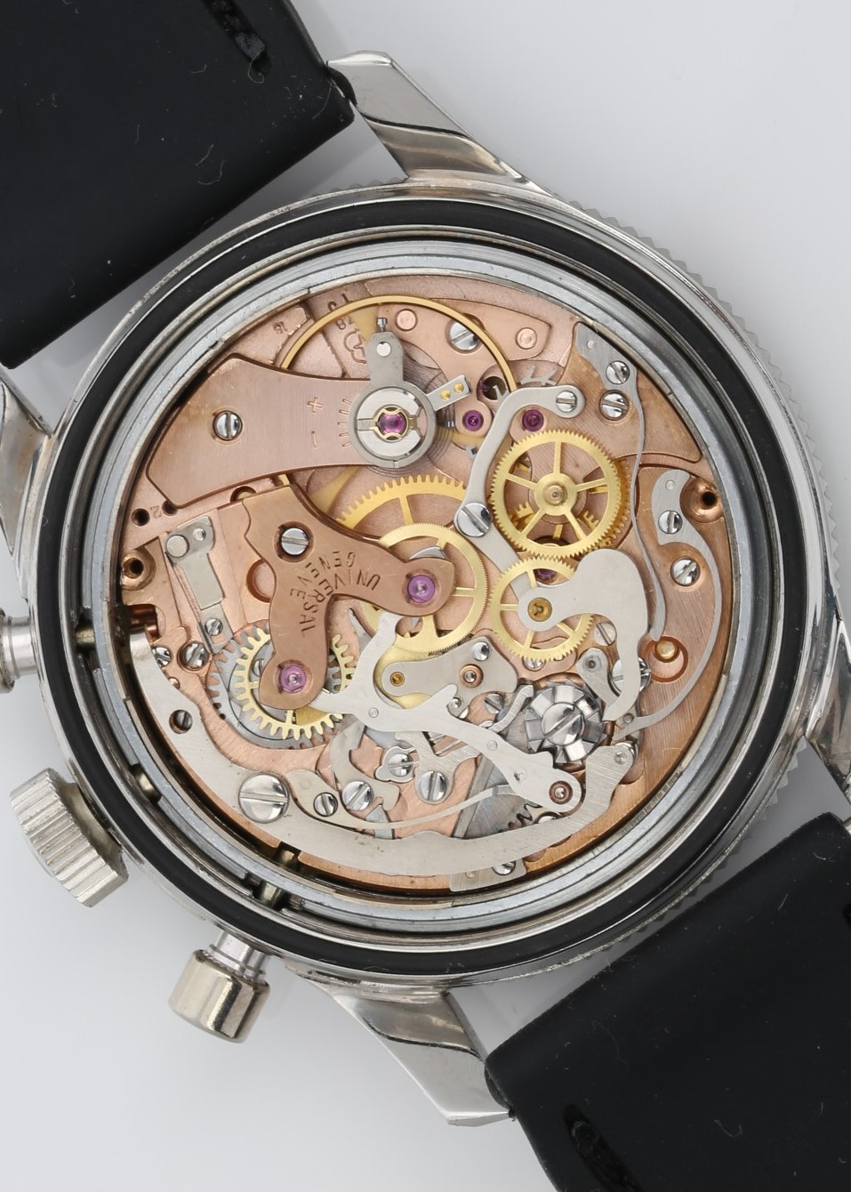

An update or two on the purported NOS example mentioned in my post above.
I requested of seller whether the jump second moved at 30 or 1 minute intervals; seller (who presumably is not primarily fluent in English) responded that:
"the register at "3" is the minute-counter and works continuos [sic]. We have stopped it and the counter workds exactly for 30 mins."
At first read, it would suggest perhaps the minute counter does not 'jump'. But I also requested a photo of the movement, and with that plus a helping of advice from @Archer it would appear the seller may have been miss-communicating.
@Archer tells me it's impossible for this watch to not jump (though perhaps if out of adjustment could could wobble around a bit).
But, in all, it would seem the seller does suggest more clearly that the minute counter takes 30 minutes to make its circuit. In which case, this movement is set up so as to not work in the more common variants with the 15 second minute recorder.
Meanwhile, notice in the photo of the movement that while containing the UG branding, the ca.90 indication is missing from its usual position. Someone with better familiarity with these may be able to point out further info, as to my eyes certain other inscriptions appear missing from the usual places I've seen (e.g., no 17 jewel, etc.) and others there when I don't remember seeing (e.g., the "2' at about 5 o'clock position).
Anyhow, thought I'd post these movement pics and observations here for posterity.

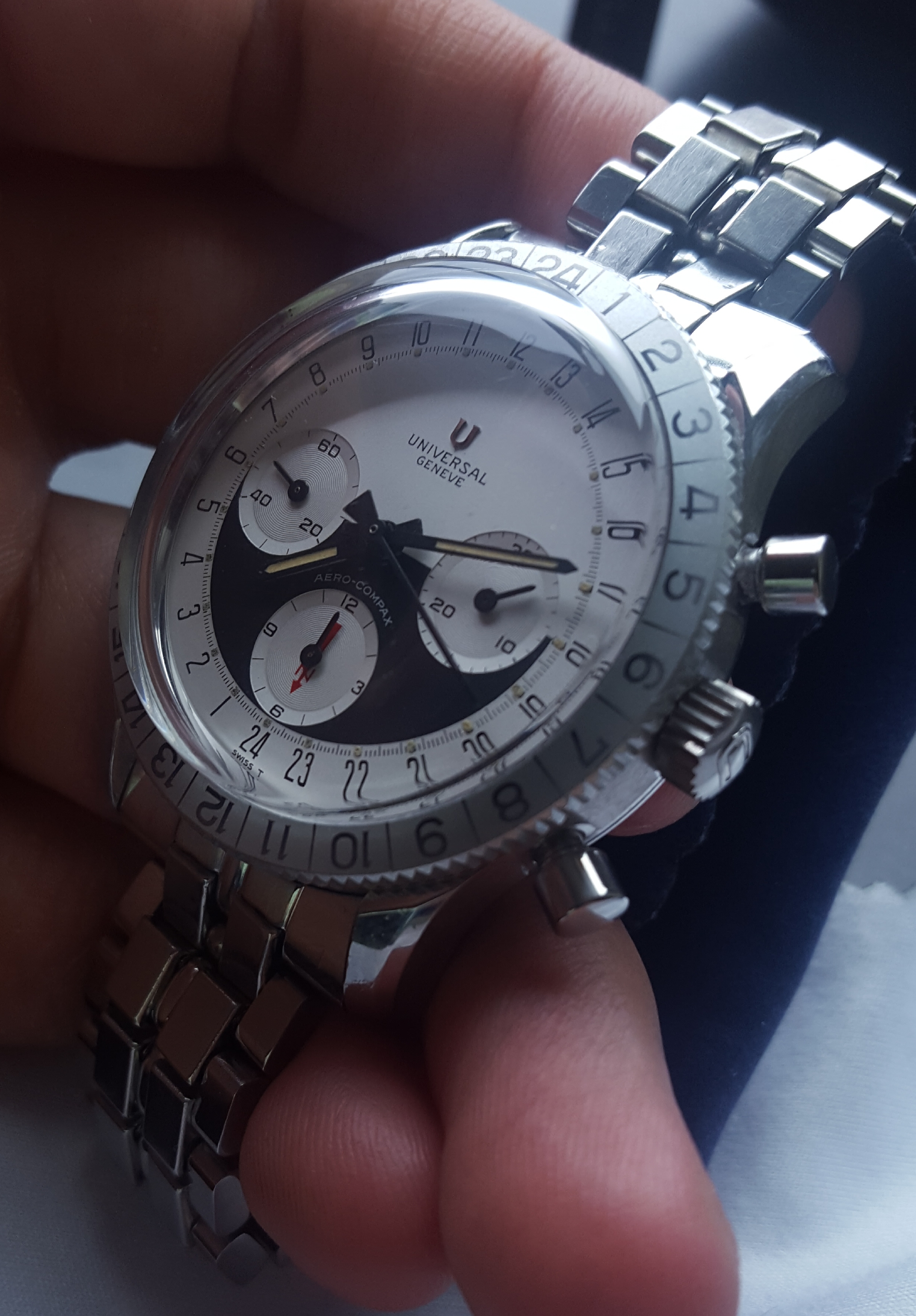

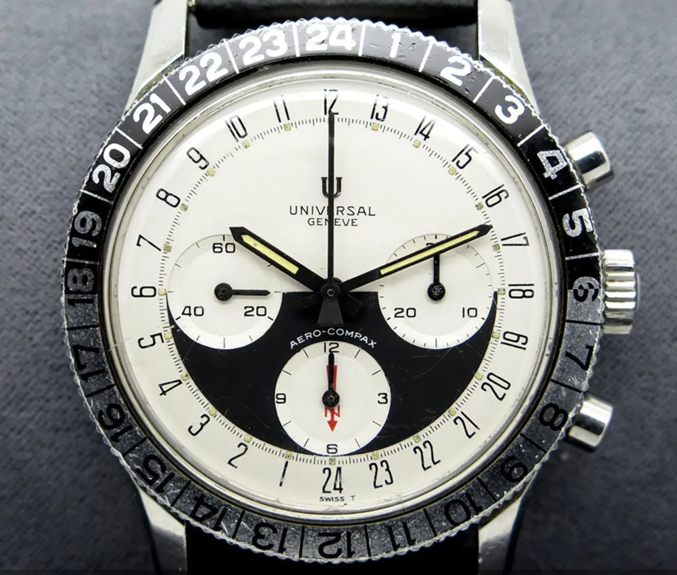

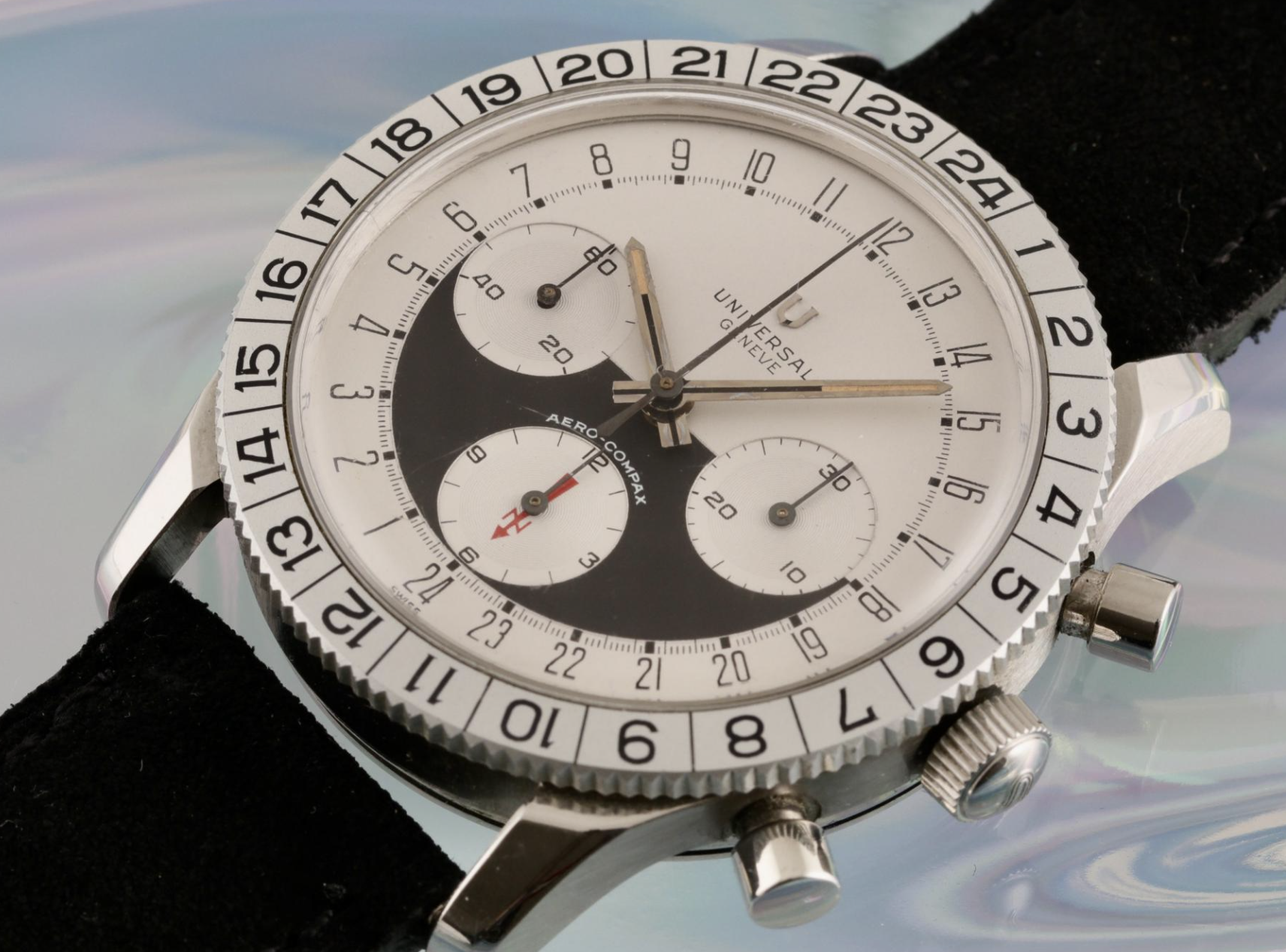

Bringing up this old, but hopefully not dead thread:
I love this wonderful day/night dial and I am collecting every bit of information I can get a hand on. Too bad that Mr. Sala is not interested in these models, but it has been a nice Email communication with him, nevertheless.
I did not expect to find most of the information about this specific UG dial in the Omegaforums, but hey - we are not narrow sighted, right?
There is a chance for me to buy a nice 890101/01 with the Bat dial in a good condition. Knowing that there is no final answers about the original provenance of this dial, but two things make me think about it:
First of all, there's the Reference number. /01 means that it should be a white dial, but obviously it is black and white.
And second, there's the minute counter at 3 o'clock: The dial has the 30 minutes counter, but the clockwork is counting in 15 minutes. Obviously, no changes have been done to the clockwork to fit this dial.
Any thoughts about the chance that we are not talking about a Franken watch?
And is there e valid chance to buy an original white dial with matching hands to revert it to it's as-delivered condition, just in case?
Regards
Andreas
You have already answered your question imo..Still a nice looking watch but it will be hard to convince a buyer if you wanted to re-sell it later..

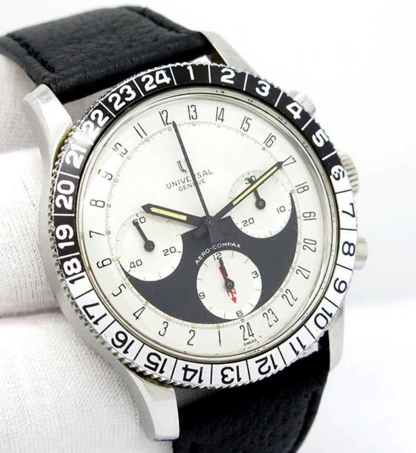

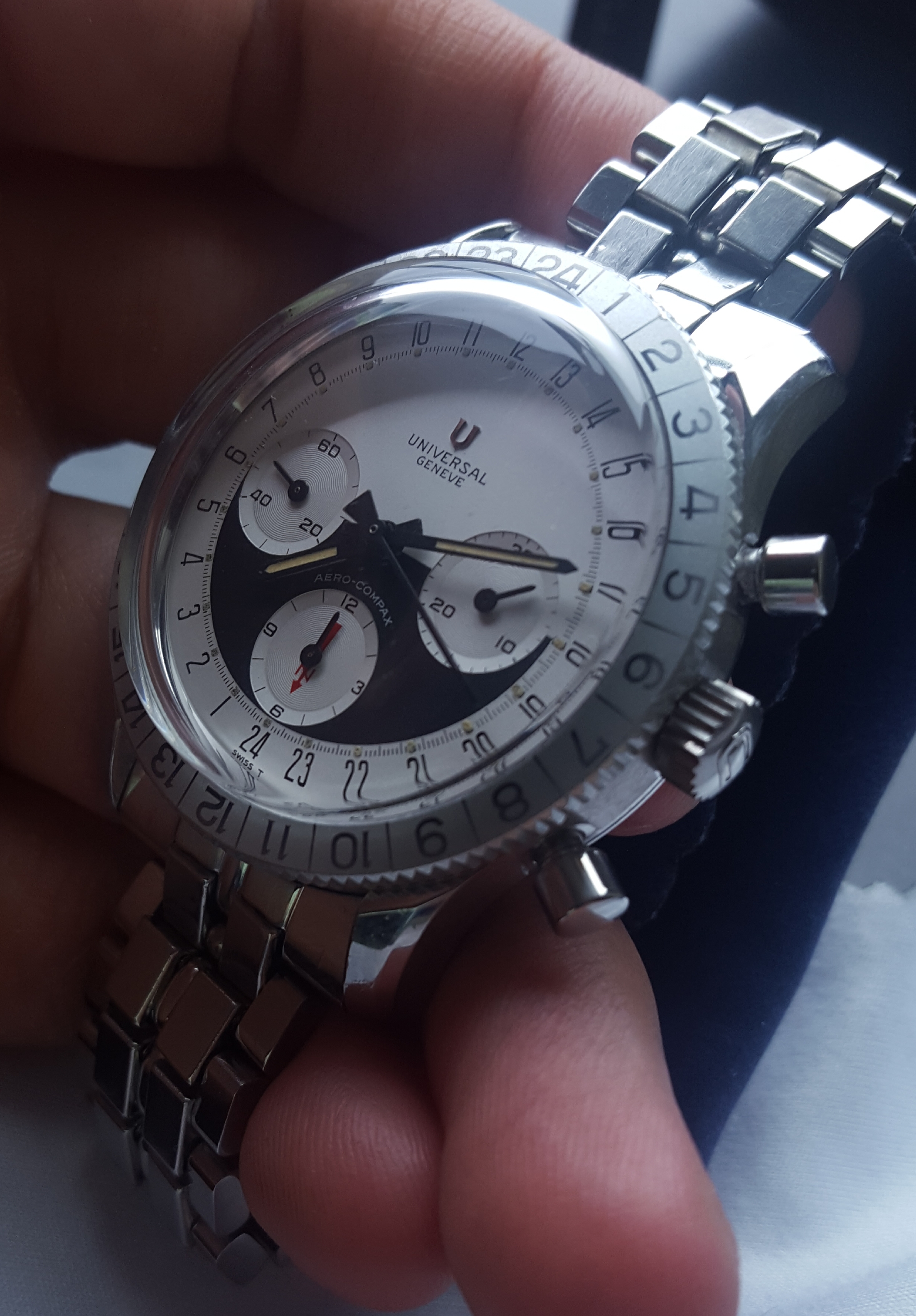

Fantastic thread!

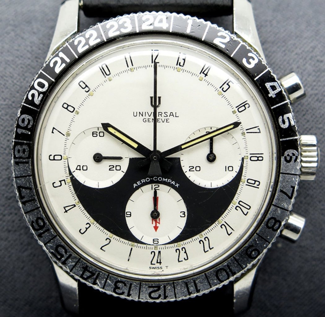

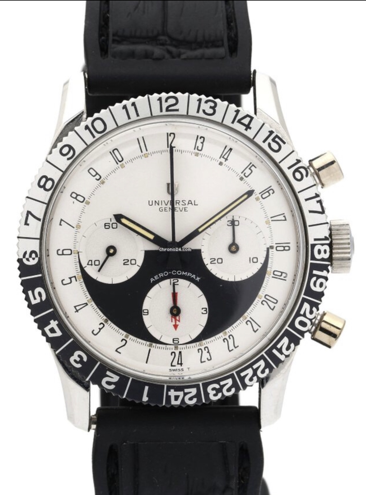

Have been looking at the “ying-yang” aero compax for a little while - not sure I quite understand all the subtleties about the jumping sub-dials. From what I gather (and maybe I read it wrong), is there any definitive proof of what a “correct” 890101/01 should look like?
I was looking at this one thats up for sale from a dealer down in Florida:

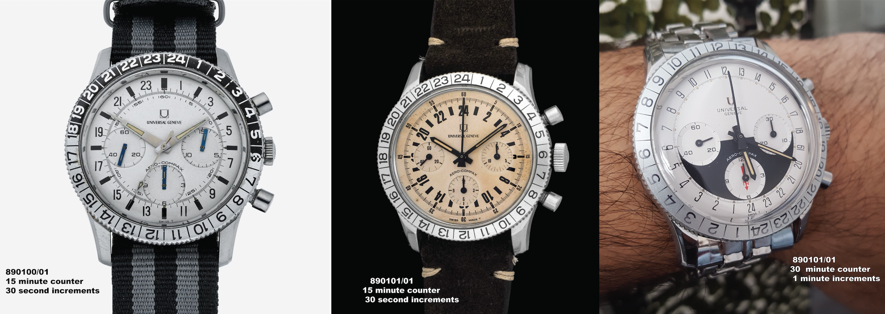

I’m concerned about three things looking at this particular watch:
- which subdial hand combination set is correct? Thin black as seen here, or the fatter lumed black hands, like on the similar all white version?
- the hour and minutes hands are black + lume but ive seen on other versions silver, black and lume hands (much prettier imo). Which one is original? Which one isnt? Based on convos in this thread it looks to me like nobody really knows.
- should i ask if the subdial jumps in 15 second increments, or 30 seconds - to determine if this is not a readaptation of the white dial version?
to me it looks like this could be someone who bought the similar white dial version for $3k-5k, bought the yinyang dial and bezel on ebay (there are some currently available for cheap), and then is reselling it as a $12k watch.
in advance, thank you for your comments!

It does indeed look as if there is not much in-depth expertise on this very special model.
Most watches have the "thick" hands on the totalisers, just like the model with the white dial, the 890100/01. The narrow hands of the totalisers and hour & minute with the small amount of tritium are probably the big exception. I've rarely seen them.
Do not forget: Many watches from that time have minimal deviations from the factory, they were simply produced using what was available or on stock. Or maybe a watchmaker used available hands during a revision.
The equally rare model 890100/01 is not really much cheaper than the even rarer model 890101/01, so a counterfeit would hardly be worthwhile. Especially as the feature 15 minutes vs. 30 minutes makes it easy to differentiate.
So, ask the seller about it.

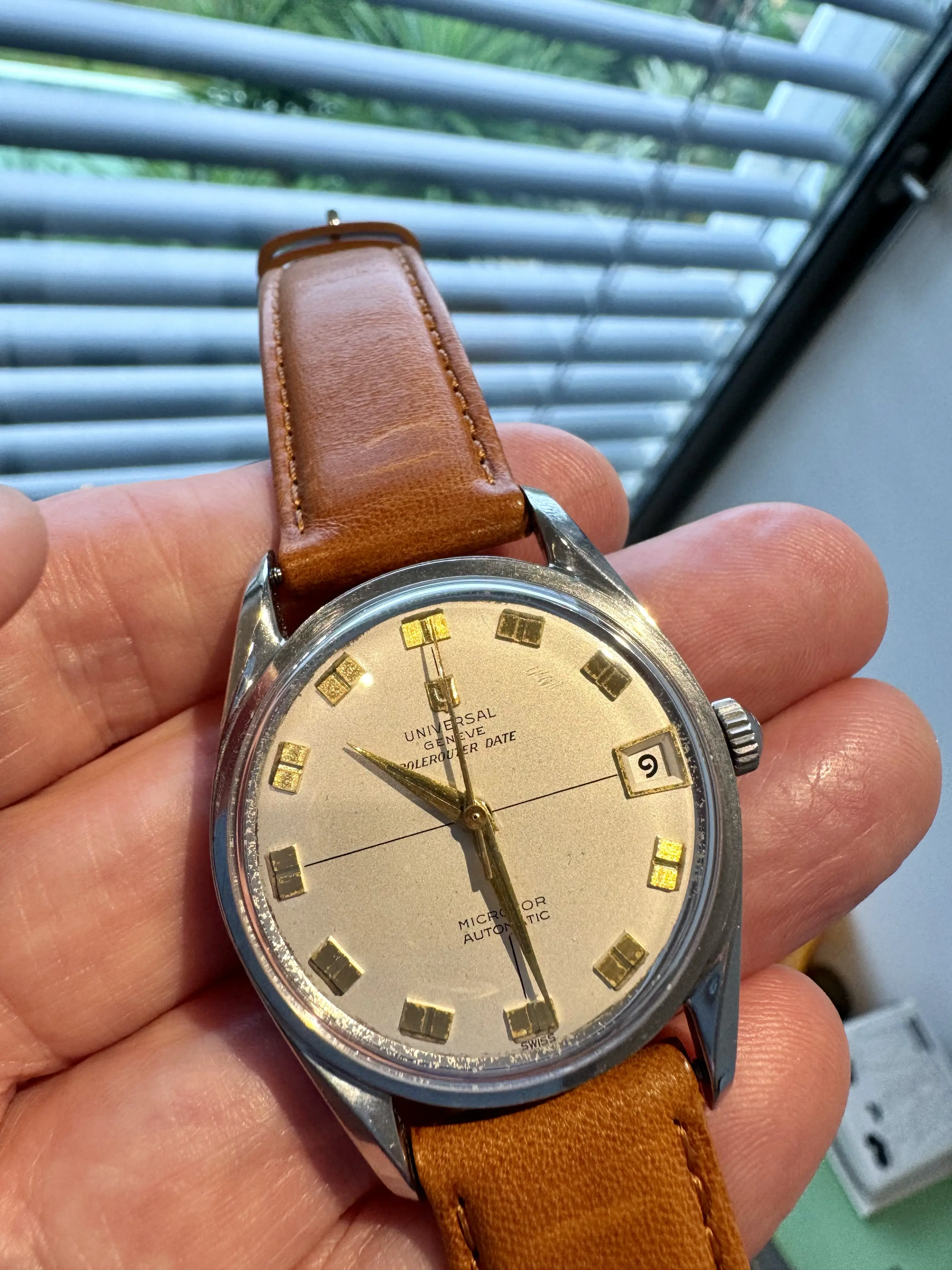

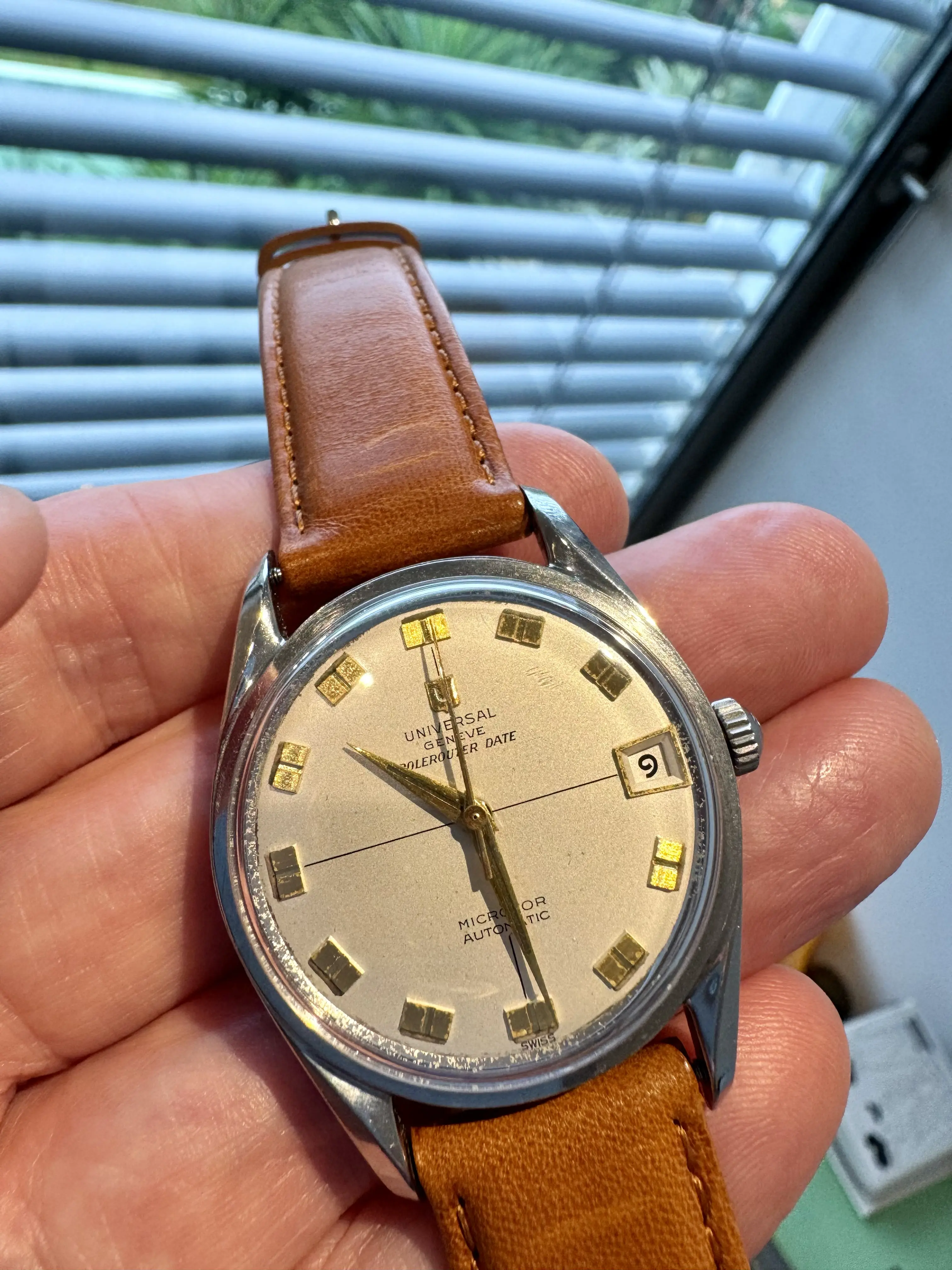

Hello Forum and thanks to all who have contributed such a depth of information on these references. I just bought this watch, but haven't received it yet so I can't add any useful information yet.
In a way I wish I'd found this thread before buying, but in a way I also don't mind. When I saw the watch I was smitten and there was no hope. I love the balance between the day/night bezel and the day/night dial. If it's original, great, but if it isn't that will not diminish my pleasure at looking at it and wearing it. But as a collector of UGs, including their dress watches, I am becoming ever more aware of how many 'anomalies' there are in UG production - seemingly a characteristic going back to the early decades of C20 production. I find it charming that there could be such a freewheeling approach to the line-up by a high-profile manufacturer, and it must have kept UG's designers very busy and very happy. It contrasts in my mind very favourably with some of the other major brands which have maintained a comparatively rigid approach to their model range.
As just one example, the Polerouter reference 204503/1 is such a digression from the 'standard' Polerouter design language used in the other 204503 sub-references, and in the majority of the Polerouter range. I wonder what happened...did some designer just get fed up with tinkering with the standard language and convince the management to throw a curveball on something he'd doodled on a napkin, just for the hell of it?
But to get back to the 890101/01 I now own, I'll post any additional information on it as soon as I can.
