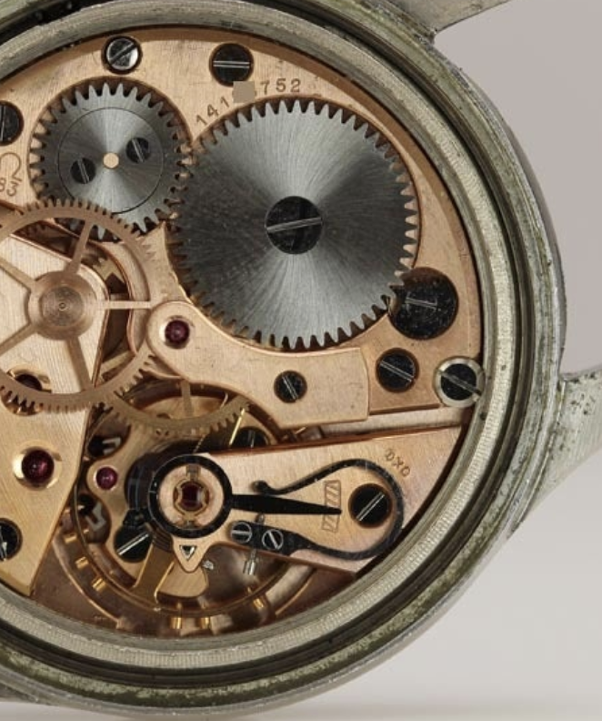

The "neck of a goose" is a Reed's Regulator, it's used to speed up or slow down the watch by changing the effective length of the hairspring.
You are lucky to have one in such good condition, they are often broken (no goose neck), missing the adjusting screw, or missing completely with only two holes in the cock to indicate where it used to live.
The OXG stamp is also interesting when I look at all of the other pictures, but it's a puzzle beyond my capability.
PS: Did you happen to notice of there is an unusual case maker's stamp inside the lid that fits to the back of the watch?
OXG would indicate delivery to the US.

Yes I know, but a Swiss case? Is that a bit unusual?
CK 2777?
With spring bars?

Yes, decidedly so.
The spring bars are also unusual, but my sense is it's tied somehow to the regulator, which would also be a bit of a mystery if it is indeed a CK 2777.

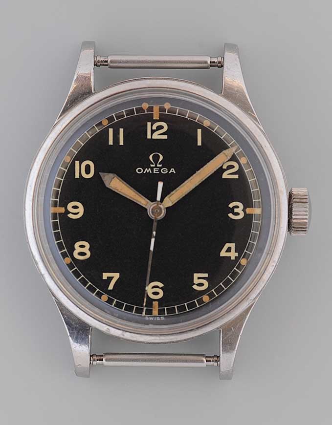

2777 - 2 Railmaster?
BINGO! 👍👍👍
I wonder that it took so long until somebody solved the puzzle although I showed all the crucial parts to identify it correctly.

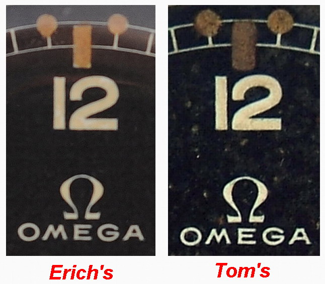

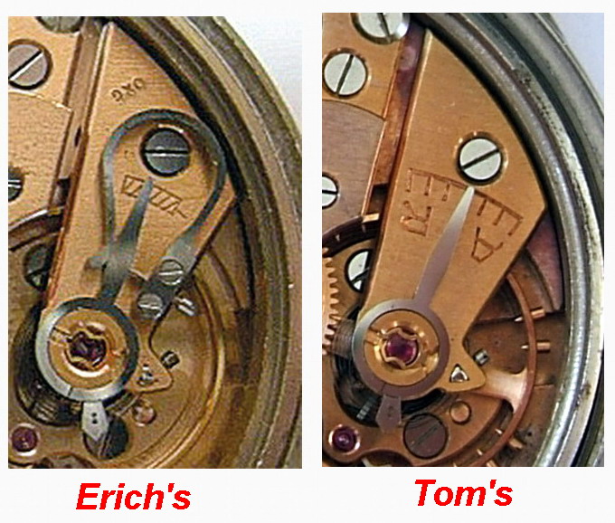

I have a 2777-1 thin arrow and I show here comparisons with Erich’s dial and balance images. The dial looks OK. The balance is the first problem. And then we move onto the OXG - because (AFAIK) the 2777-1 was supplied to the RAF, and the OXG would therefore not fit.
The 2777-1 had fixed lugs and Erich’s has spring bars.
So it must be a later derivative. And Erich will therefore tell us that it’s very valuable.

Sorry, I crossed with Erich's. I still think there are unanswered questions!

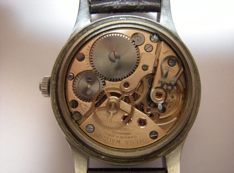

OXG - 2777- 2 😀
d4c03708-6d7f-42f6-b16c-8459dab5bde6-jpeg.620826
https://omegaforums.net/threads/2777-2-on-ebay.81851/
OK- same watch!😗

I do not think the 2777-2 were necessarily assigned and have fived bars, they were supposed to be a prototype, perhaps to test the civilian market. Can't see why they should not have gone to US.

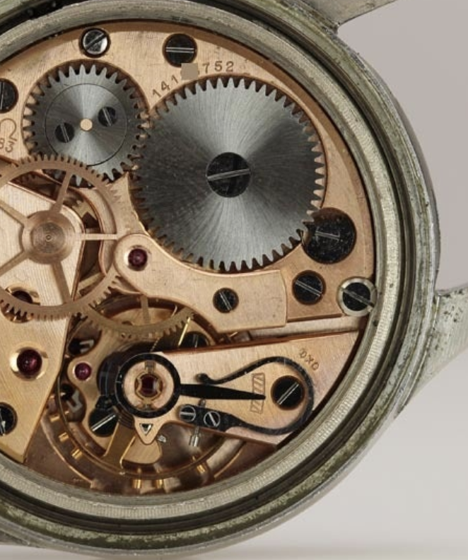

Cannot easily see the soft iron antimagnetic case in the OXG, is it there?
Here is another OXG, only 2 serial numbers away:
Hi Franco,
yes, all there: iron cage, including iron movement holder ring, inner iron case back with the holding spring, 1 mm thick iron dial...
there have been few of these recognized and called "Railmaster prototypes"
