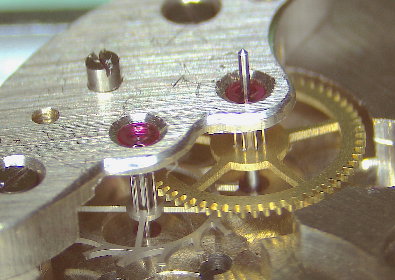

Presto tool arrived this morning.
Amazing how easy a task is when you have the right tool.
Chrono Driving Wheel is off and no damaged jewel, no bent shaft and no damage to the bridge (not that I did anyway). I will have to tidy up that eccentric screw.

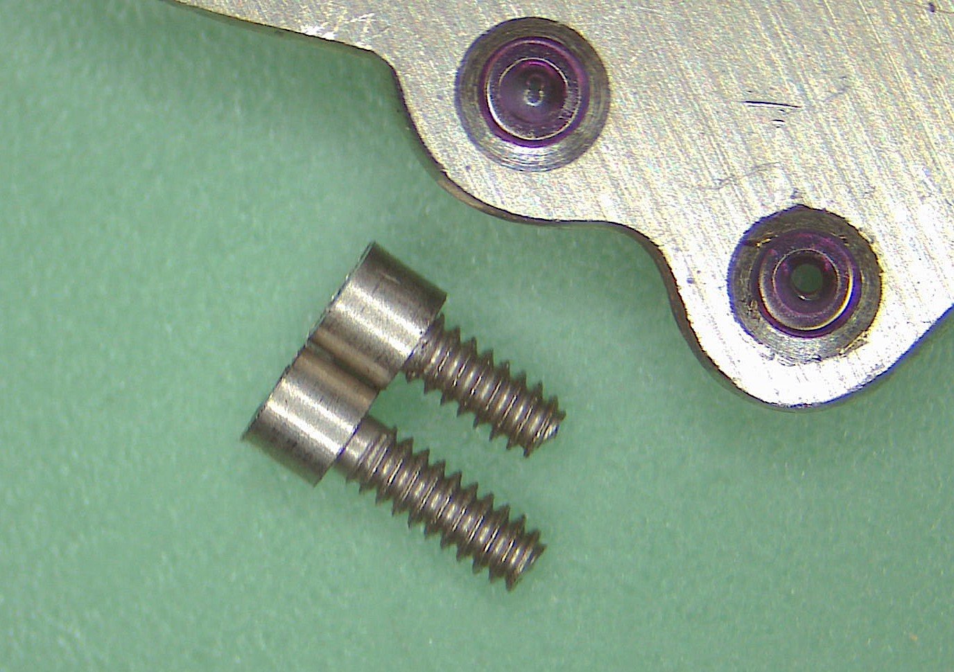

With the driving wheel off I could remove the train bridge. Can anyone spot the issue?
@sheepdoll 😉.

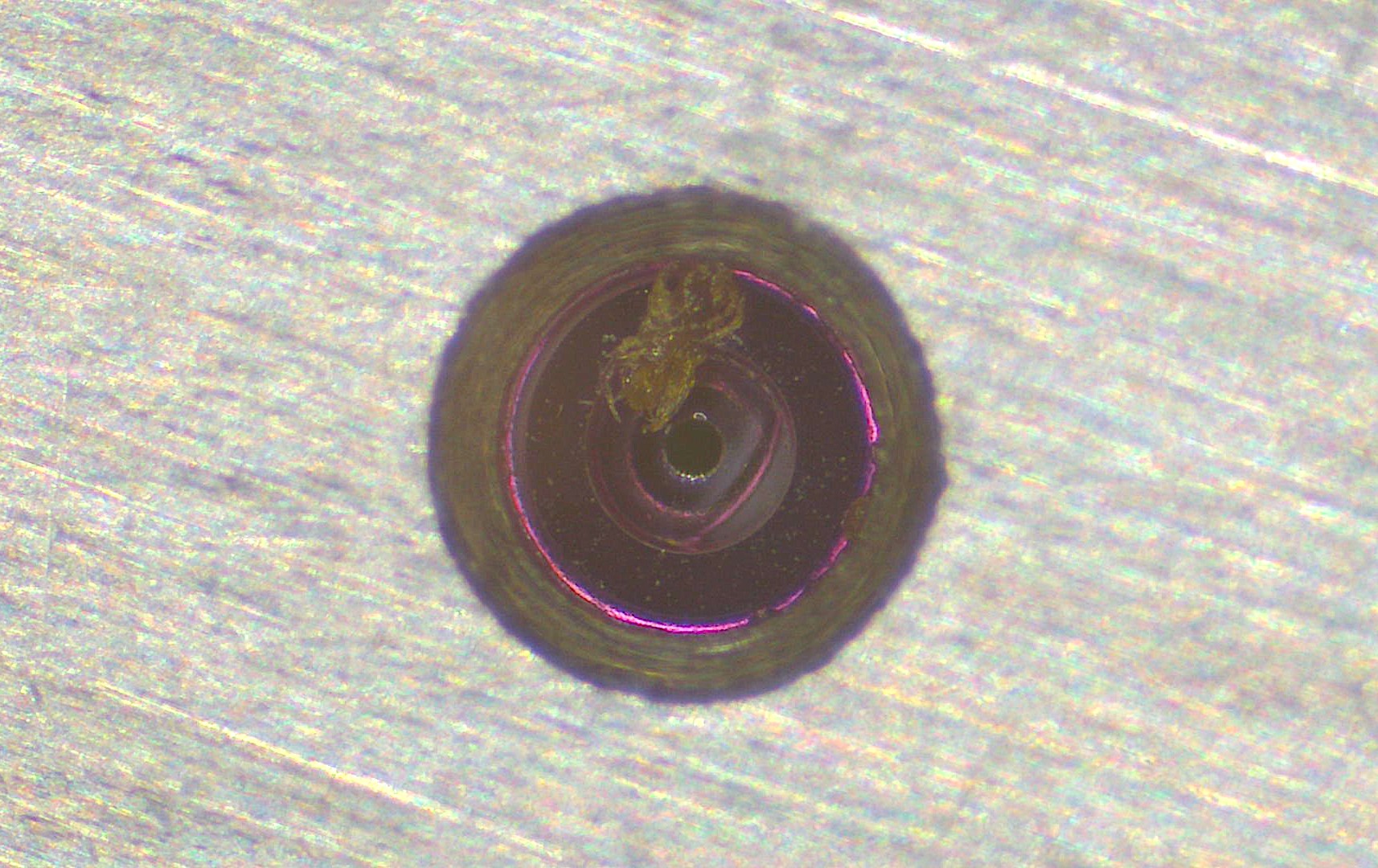

Well, I'm used to finding dried out oil and gunk in jewels when pegging them out, but this is the first time I've seen a bug in the jewel sink.
It looks like some kind of tiny spider, the abdomen fell off when I was trying to lift it out and put it on a slide.
@sheepdoll 😉.
I mentioned this above. The balance bridge screw is the longest plate screw. I see these mixed up all the time.

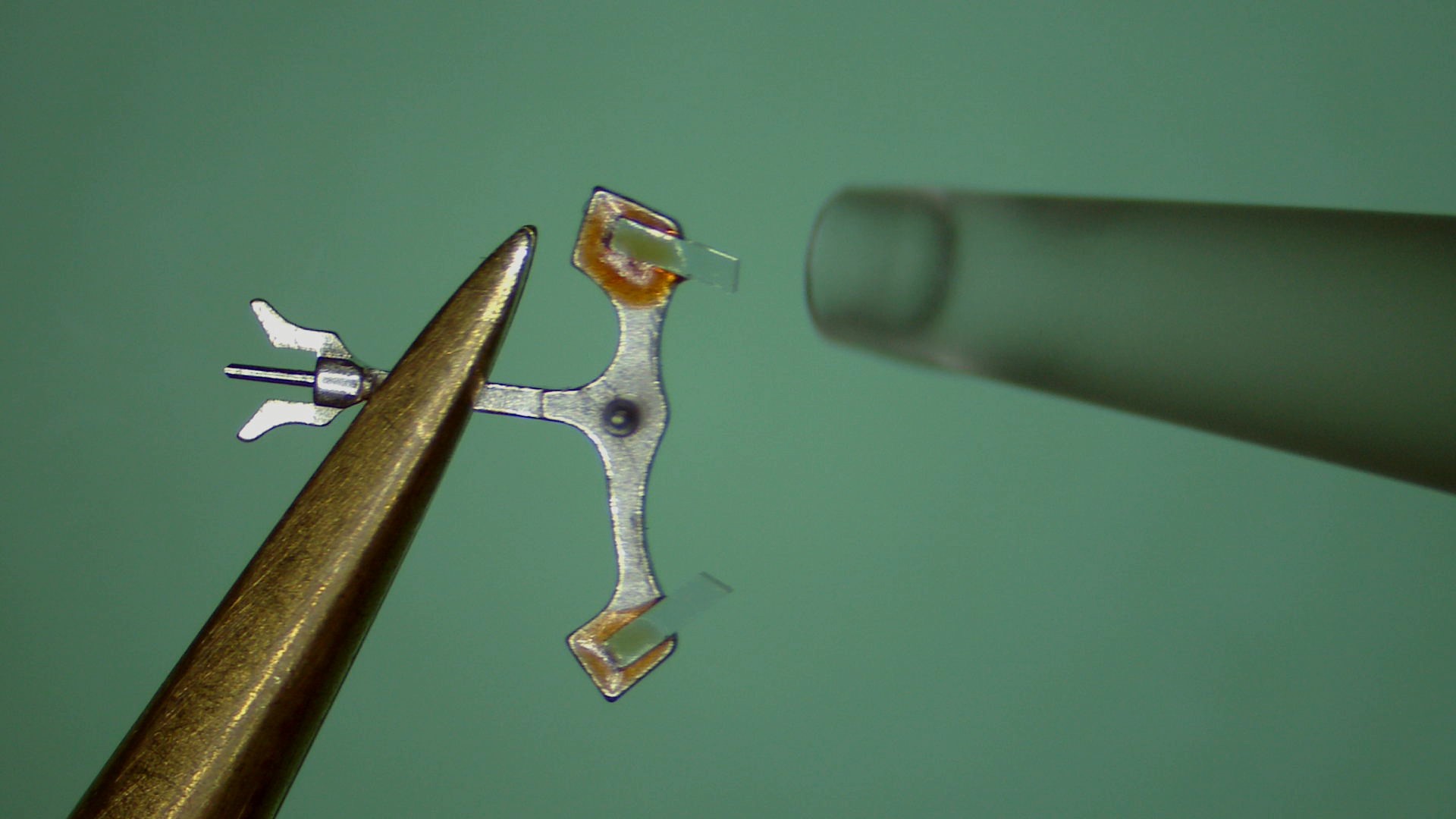

Dang! 😡🤬
I was so focussed on applying epitome to the pallet stones I completely forgot to do the escape wheel!
Didn't realise until I was watching the movement ticking away to wear the epilame from the pallet stones.
Had to let down the mainspring to prevent the escape/pallet from self destroying and I'll pull it apart tomorrow and do the pallet.
Having a beer now to calm the "inner blame devil" saying "you dumb bugger!" over and over again.
Anyway, here's a pic of when I DID remember to do the right thing.
