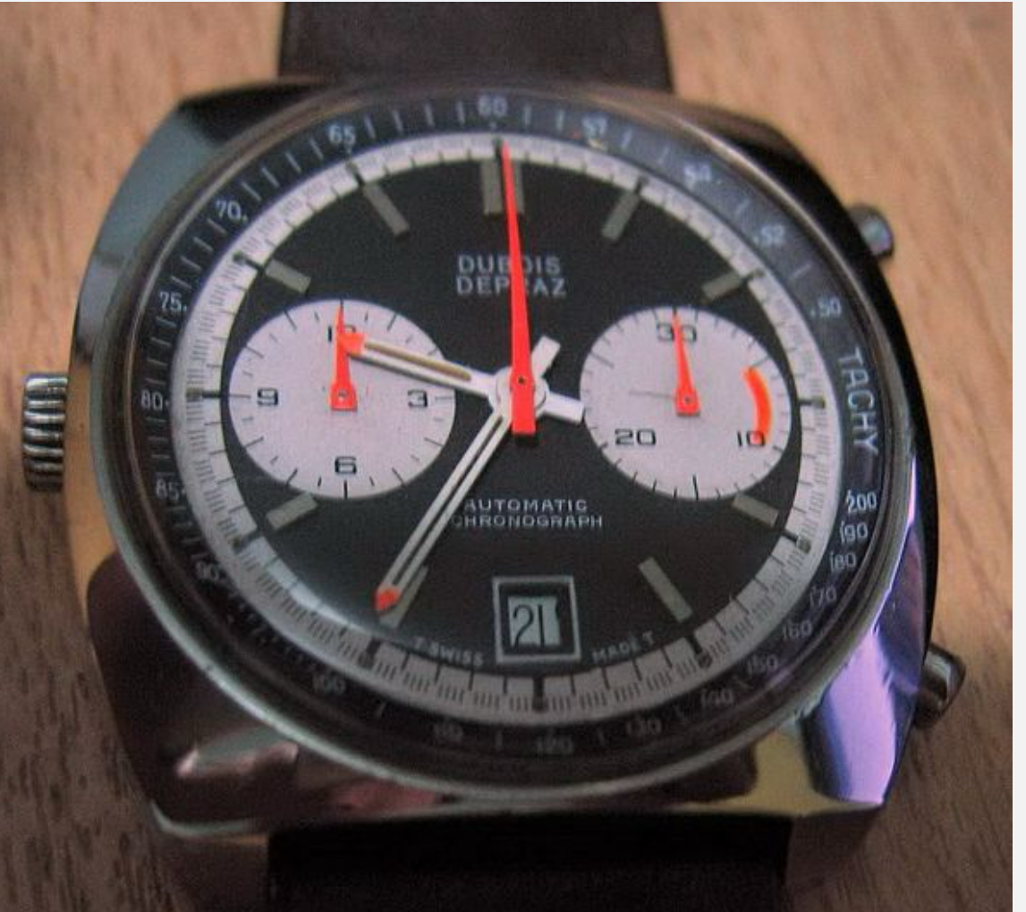

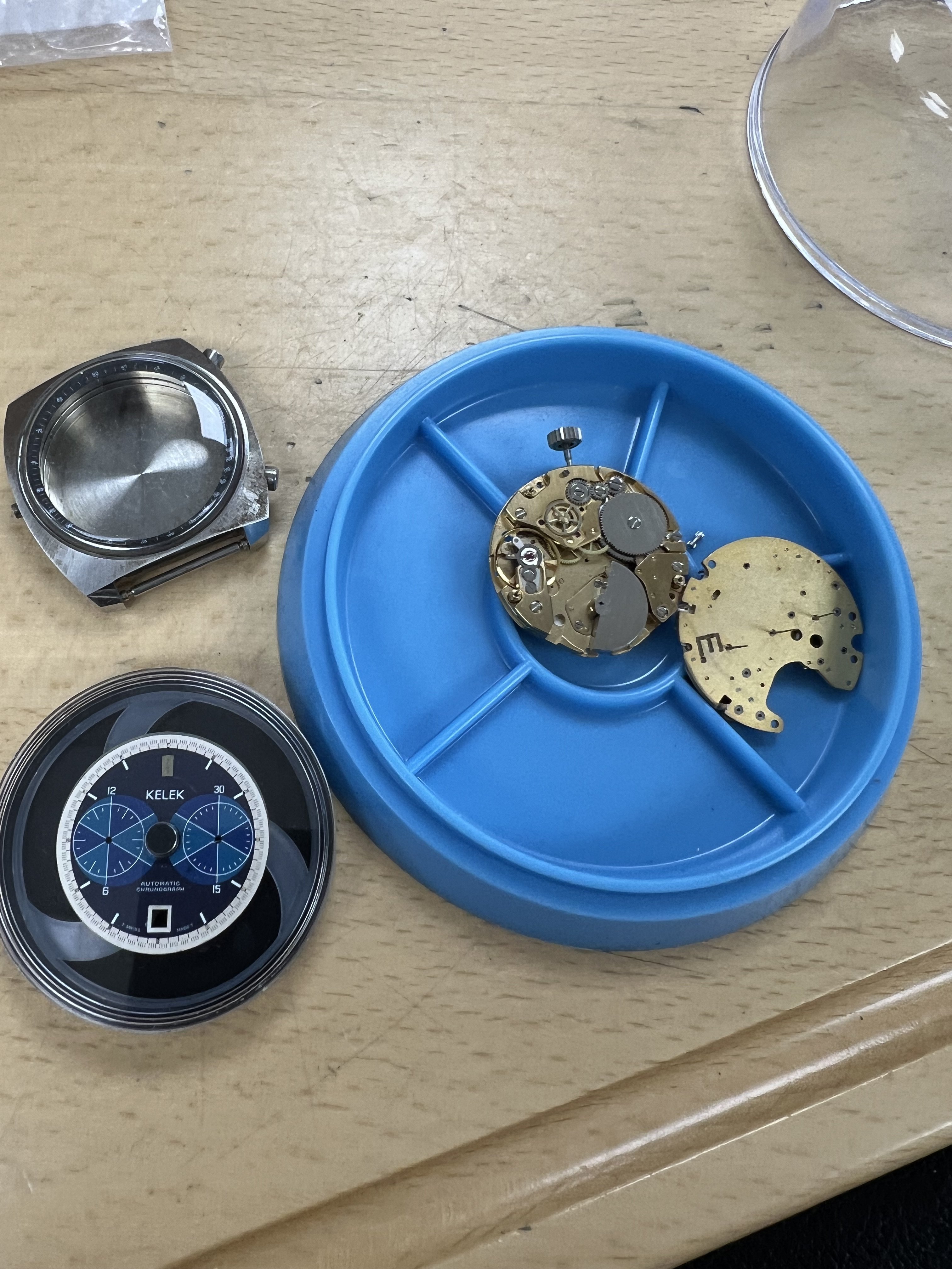

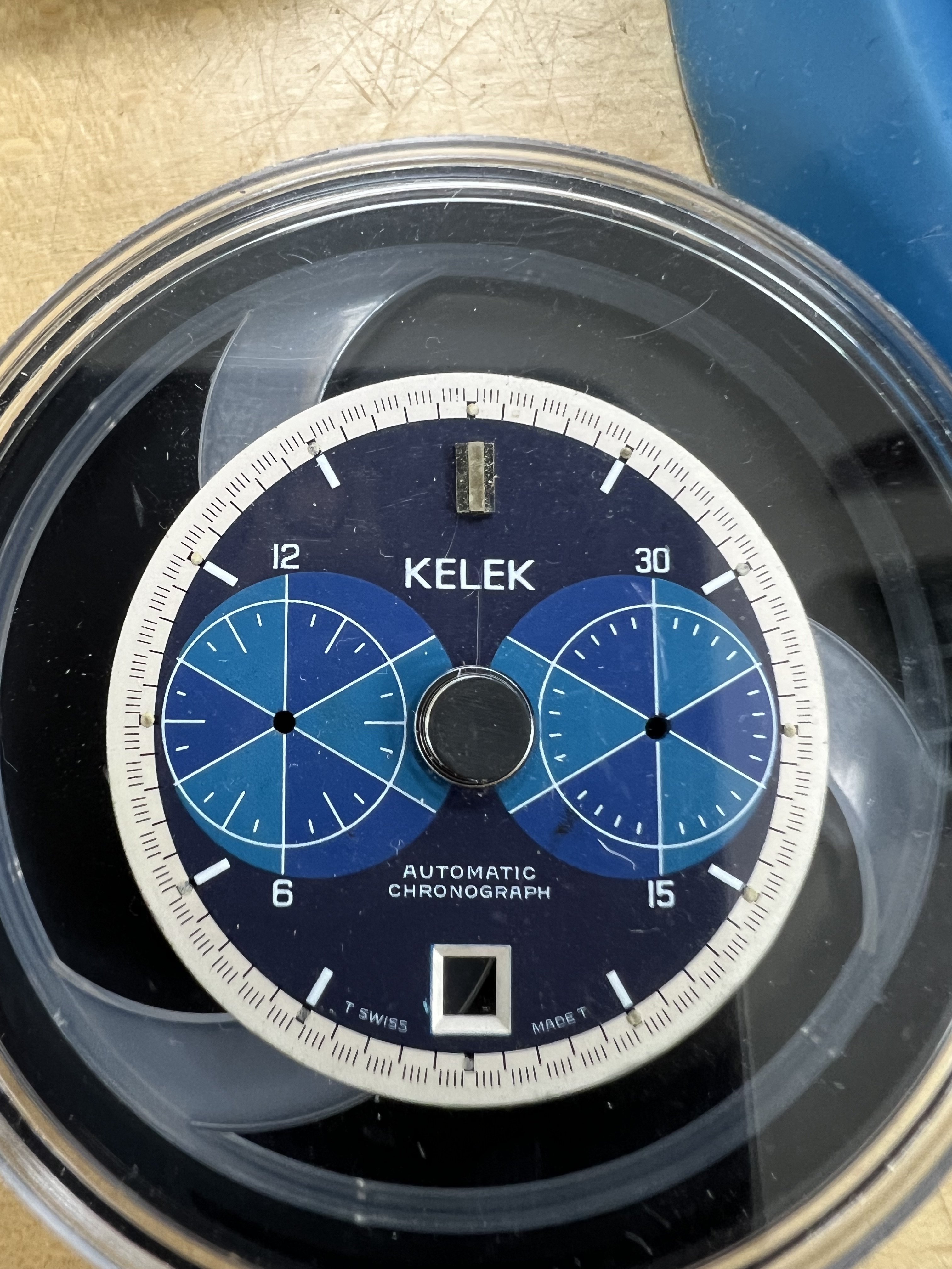

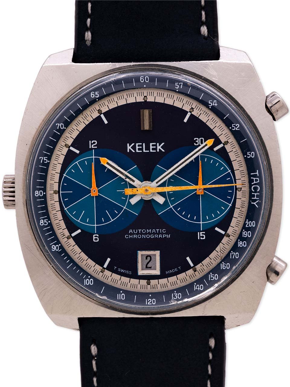

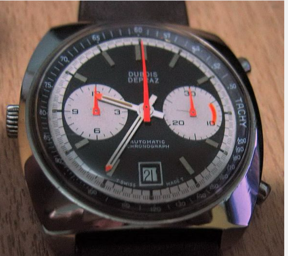

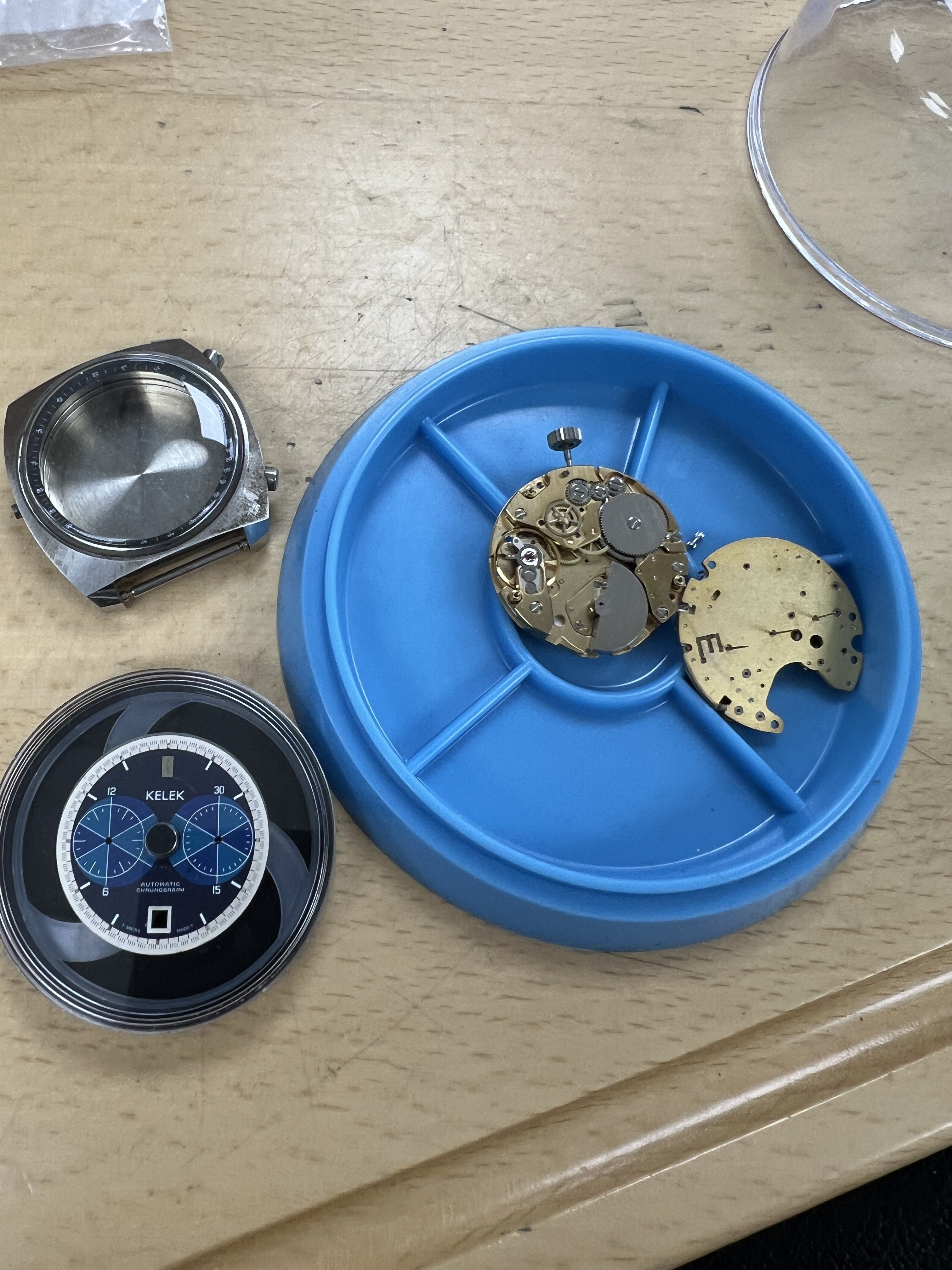

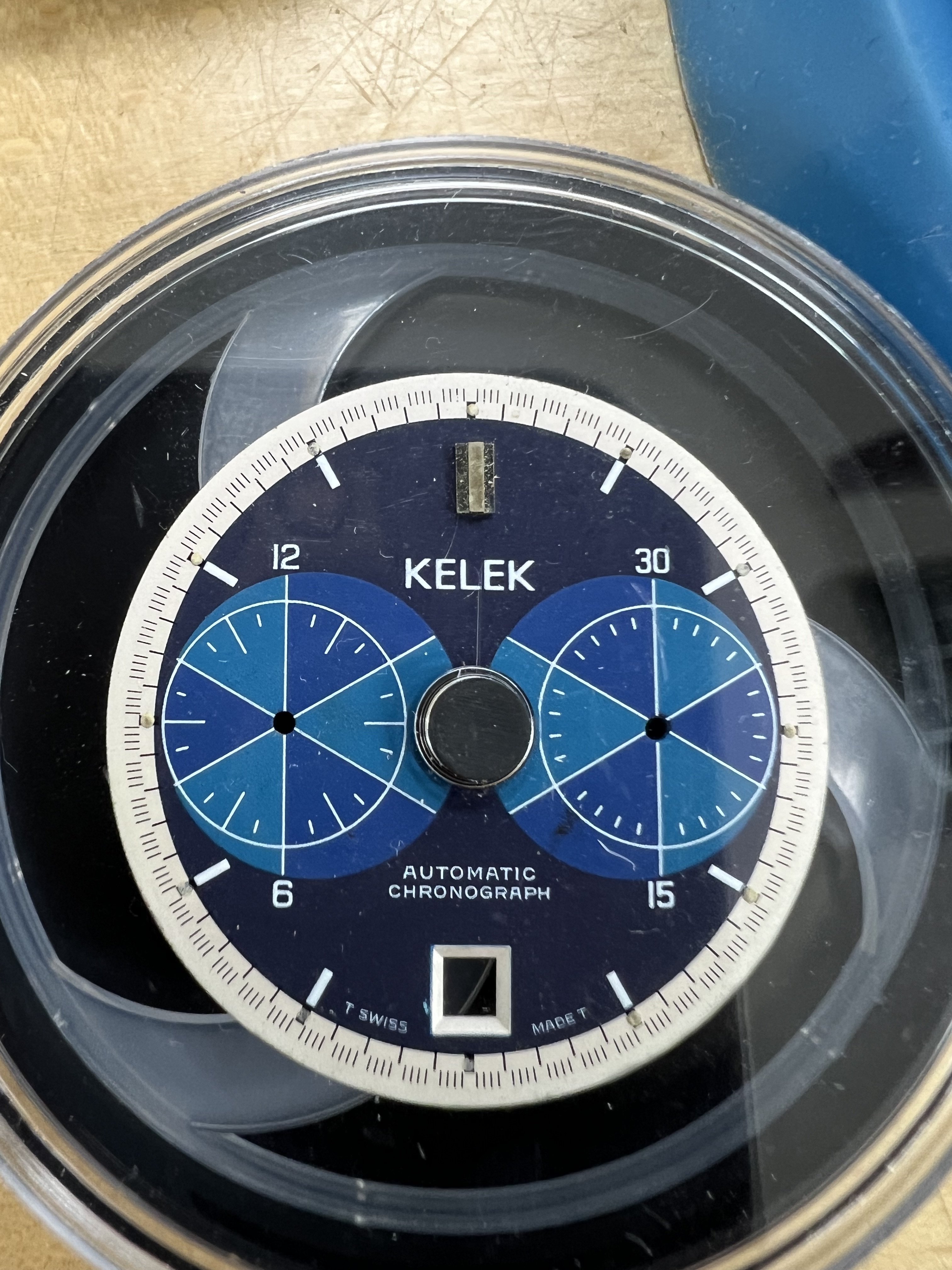

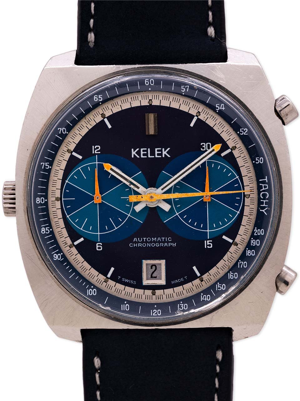

Purchased this awesome Kelek watch sometime ago. The movement is a Buren caliber 11 and the dial is just plain amazing to me. The only thing we are mssing is the hands. We have tried every supplier we can think of but to no avail. I've attached a picture I found online of a what the hands should look like. My watchmaker and I were discussing the possibility of custom making hands. Curious to hear some thoughts on this subject.
13,686
19,065

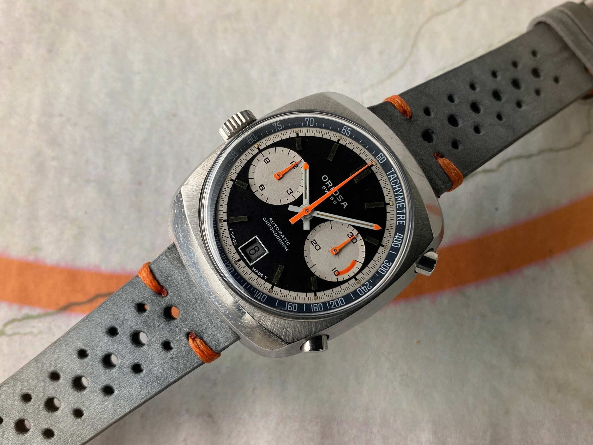

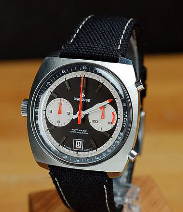

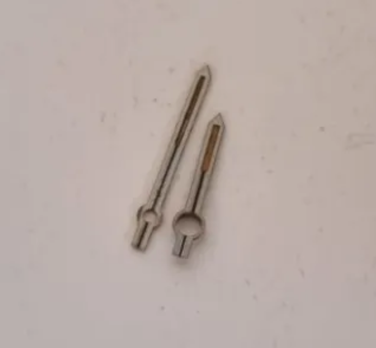

The hands on the watch were made for some Heuer watches. They are just different colors, which can probably be painted.

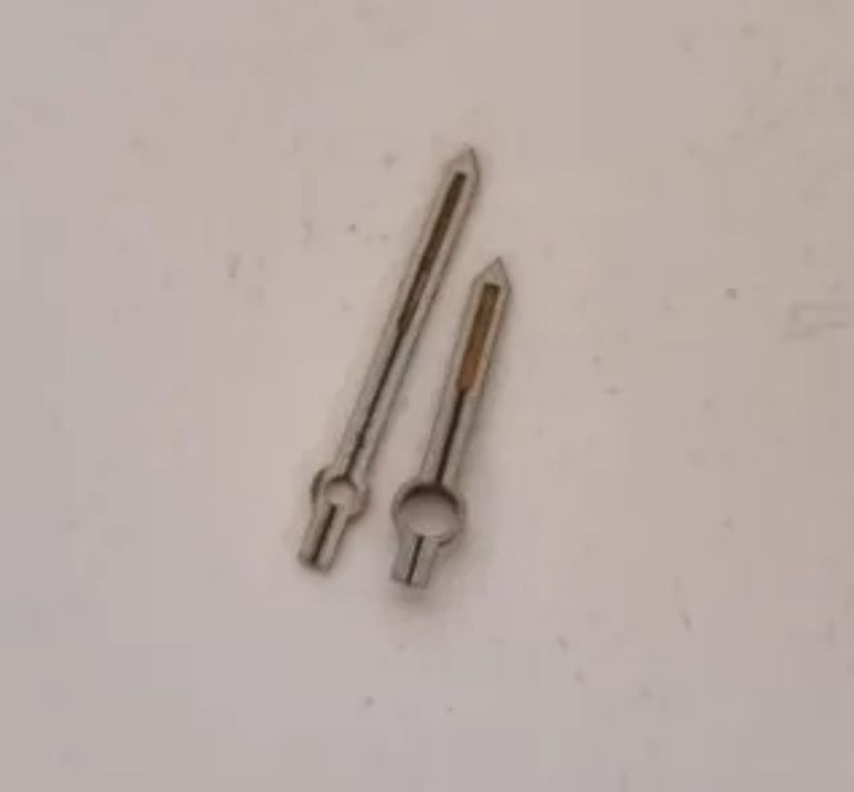

There is, at the moment, a set of hour/minute hands for this watch (Carrera Ref. 1153) on sale at eBay. Not cheap, and not exactly the same shape.
https://www.ebay.com/itm/325841456174
The question is whether your watchmaker can paint them and can work around the original radioactive tritium.

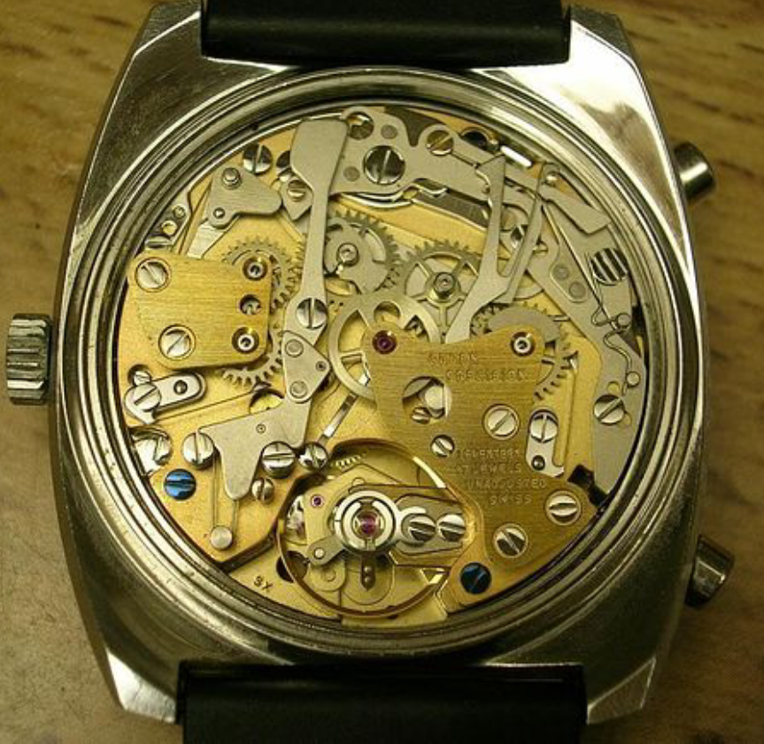

PS - I have a very similar watch with a Gruen name. Only thing different is the branding on the dial and movement bridges.

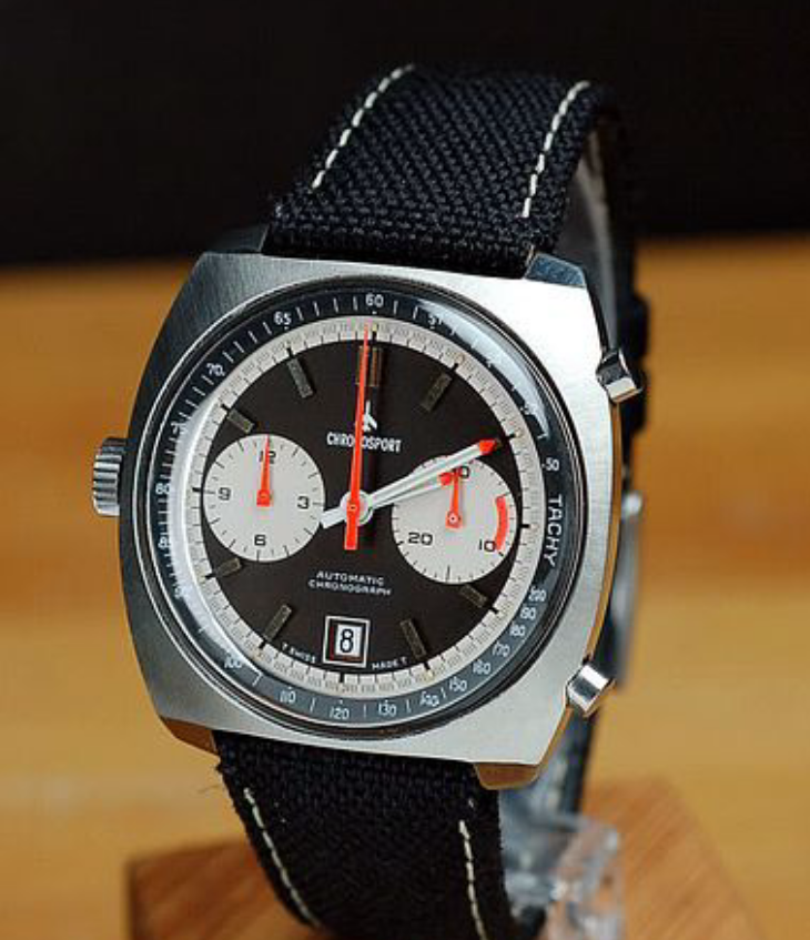

DSCN2085.jpg~original
Wow! The Gruen uses the same hands (or close enough for my likes). Thanks @gatorcpa
I'm going to search for hands using Gruen and see if I can get lucky. Do you happen to know the case reference/model number

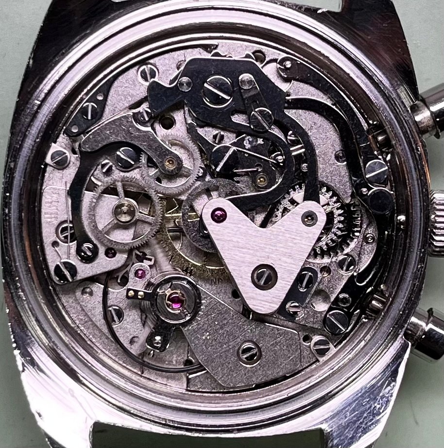

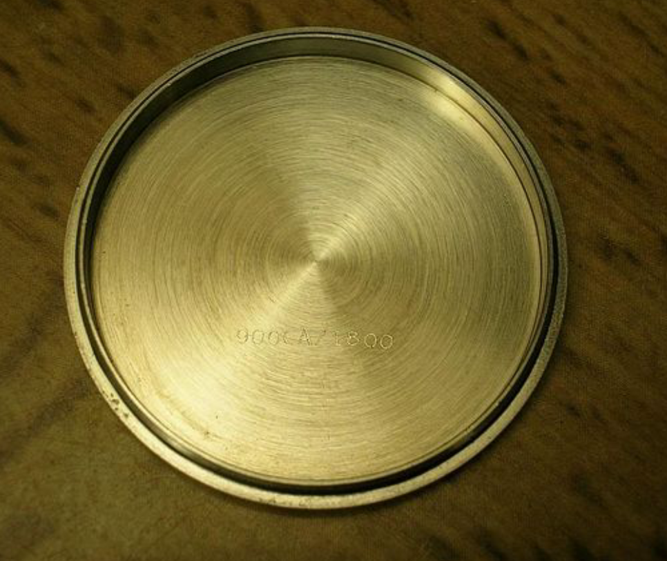

There is something engraved on the inside of the case:
I’ve never tried to look it up as a case reference. The reason is that by the early 1970’s, when this watch was made, Gruen had ceased to exist as a watch manufacturer. A Swiss company had purchased the company and was marketing generic watches in the U.S. using the name. However, identical watches exist under other names:
I think it’s highly unlikely that you will find a handset for these watches in the proper colors. They were just not that popular when they were made and were quickly rendered obsolete by quartz watches within a few years.

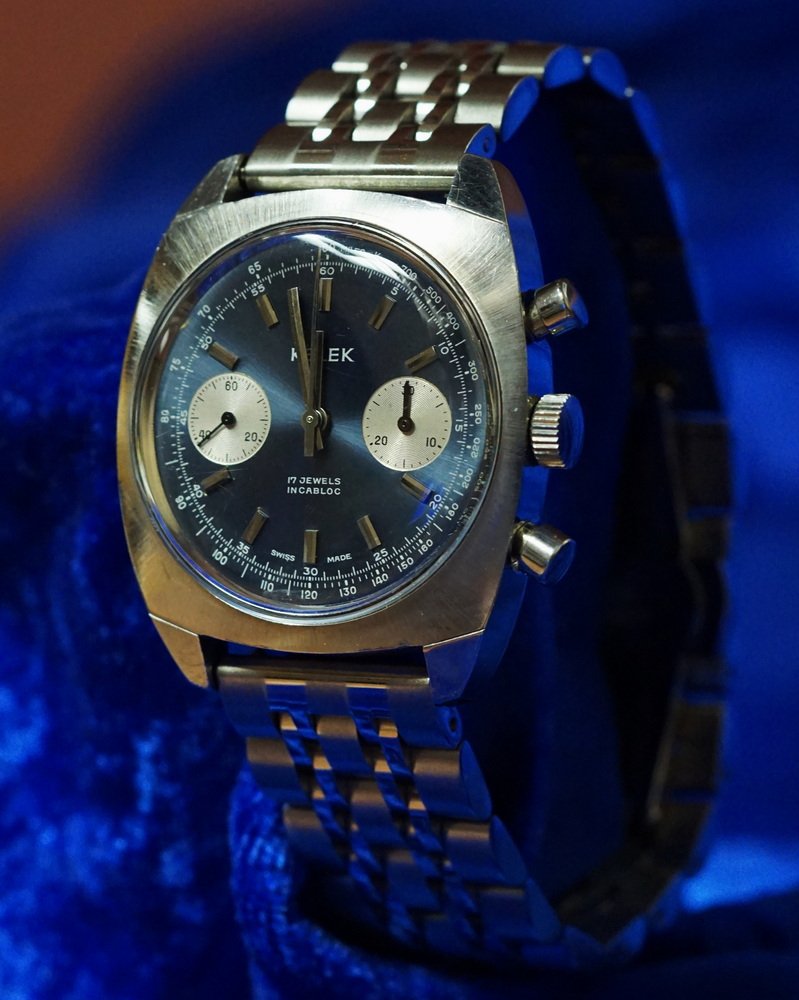

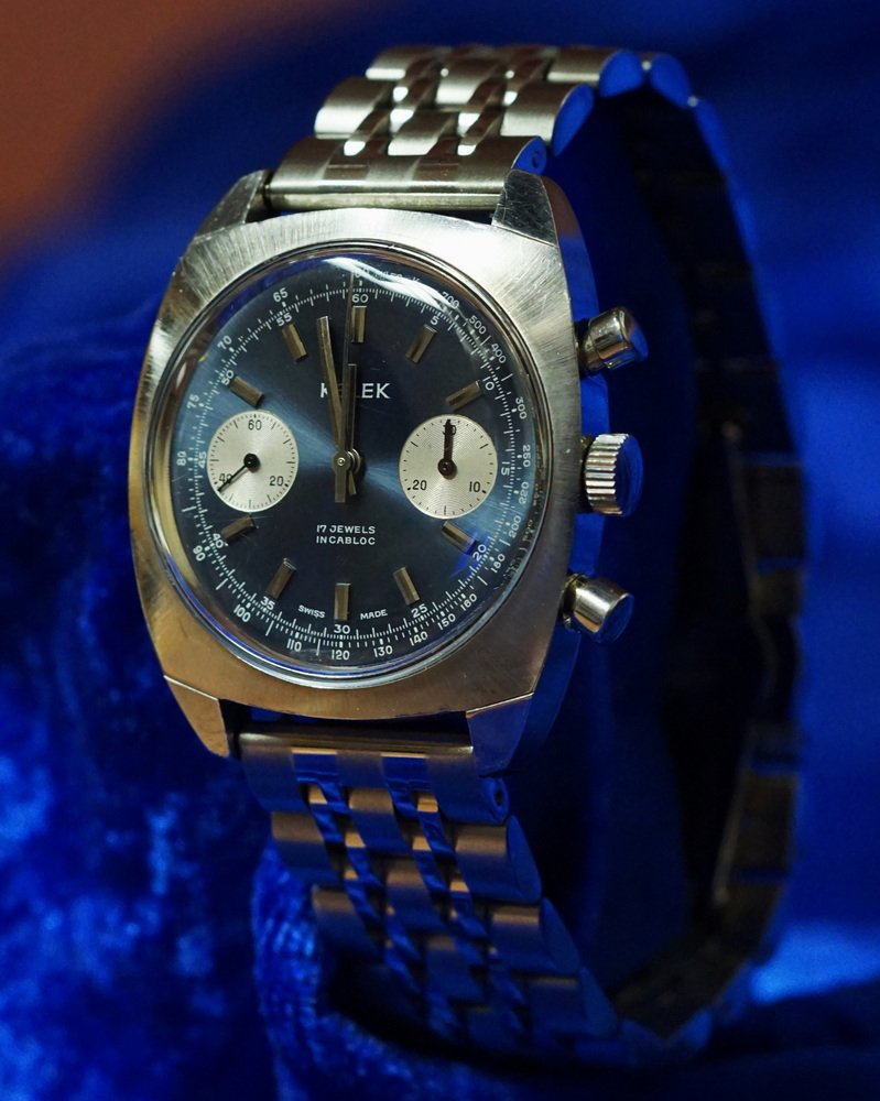

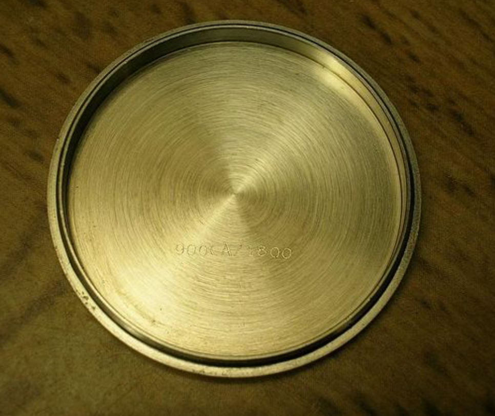

Here's a couple of shots of my Kelek, which I had serviced about a year ago. It is a favorite. Of course it isn't in the same class as yours, as it has a VJ7733 instead of the Cal. 11 you have.
