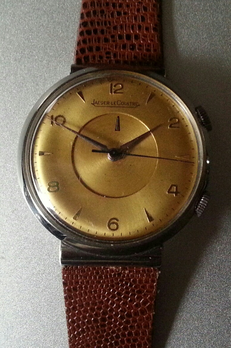

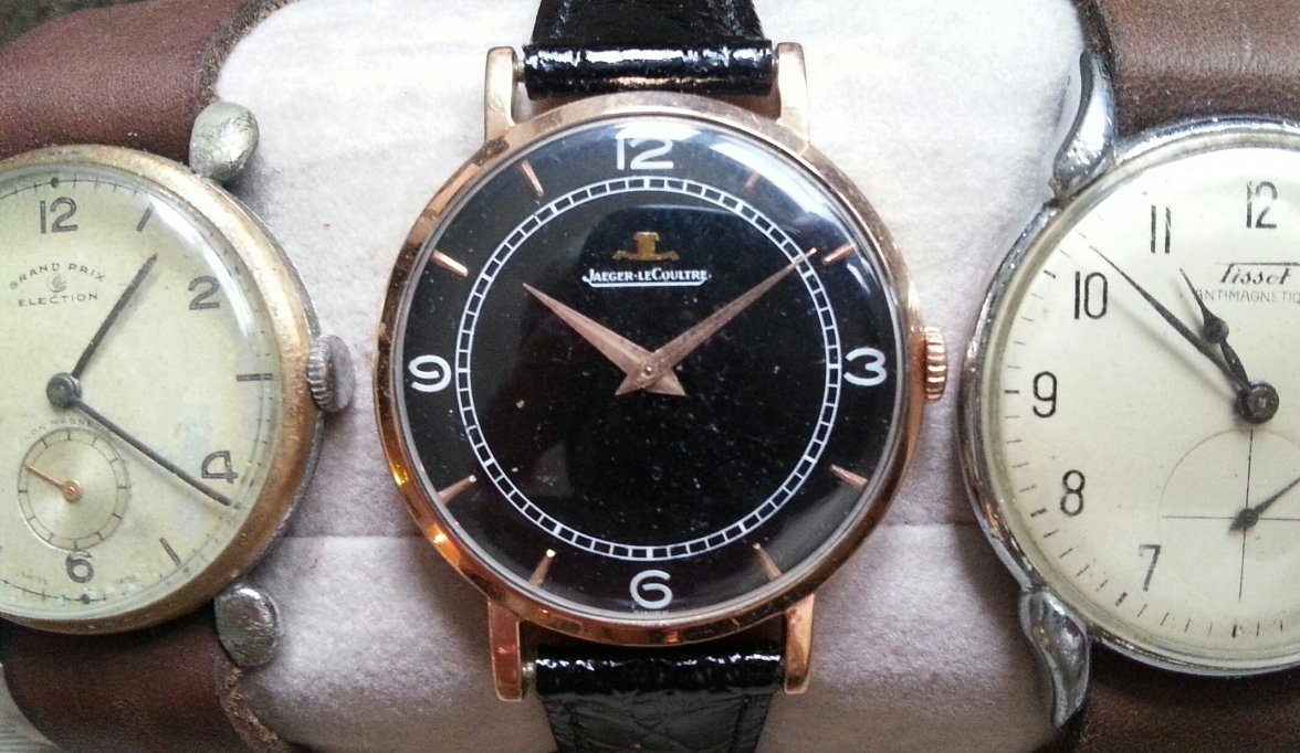

    OK But I don't have a whole lot to say and normally when I post, no one answers so I was keen on finding out if anyone is interested before troubling anyone with this question WITH PICTURES about some watches I happened to pick up.
    This is the comparatively well known barrel lug watch with which JLC says it introduced the world to the alarm watch at the Basel fair in 1950. It has 523064 on the back.
    If anyone is bored by this message, here is another one I got in the same trade. to zing the thread up a bit . It has an adorable Minuscule LC marking on the case back!

    I'd say that both JLC dials are suspect, and likely to be redials. Also, just to be clear, while JLC may have introduced their own alarm watch to the world in 1950, other manufacturers had made them long before that date.

    Both dials shown so far are, IMO, redials.

  11. DManzaluni May 4, 2016
    386
    165

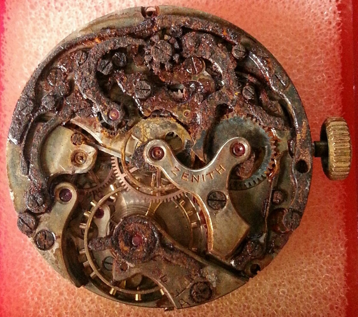

    I know people dont like to hear this but a nicely redone dial is preferable to 9for example) this other watch i got in this same deal

  13. Thomas P. The P is for Palladium and Platinum May 4, 2016
    380
    600
    Ouch that watch must have sat in salt water.
  14. DManzaluni May 5, 2016
    386
    165
    FWIW the balance swings!

  16. DManzaluni May 5, 2016
    386
    165
    It is a Universal Cal 285, isnt it?
  17. sah Nov 7, 2018
    862
    6,604
    I would like to see what the tannic acid in black tea would do to the rust.
