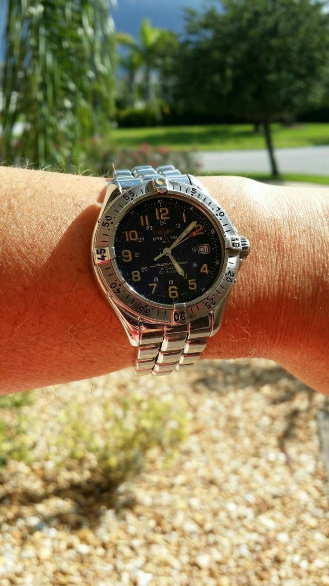

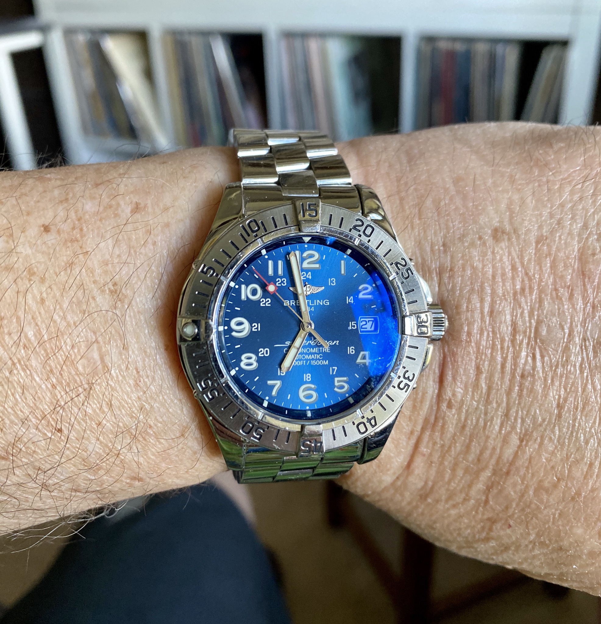

I've a Breitling 17040 SuperOcean (circa 1998), runs beautiful(+4/day, 0.1 BE) except the screw down crown has stripped. Its been going out for the last year with only 1/2 turn left and then bam two weeks ago the last bit stripped.
Looking up the cost to repair...with no watchmakers anywhere nearby I looked at the Breitling website for service, and it looks like 490 for the service and then ~250 for crown/case repair, and they would probably recommend hands and crystal for another ~300, so basically a grand to get it to as-new, which I would have heaved a heavy sigh and probably done it....except the case is clean and the movement is running great as I note above, but Breitling won't do a repair without a service so then I thought 'hey my jr watchmaker license is still good' (the one I gave myself about 5yrs ago). Assuming good design I'm thinking the crown is the sacrificial wear part between the crown and case tube, and then looking into the tube I see threads clearly (and inside the crown I didn't see any, as expected).
So off to ebay I go and find a crown for $40, and then to youtube for confirmation my expected repair steps are right (an Esslinger video no less...cool).
Took about 20 minutes start to finish. Now I have 4 full screwdown winds back and everything is hunky dory!
Wanted to share this as most of us know not every watch project turns out this easy, or cheap.
