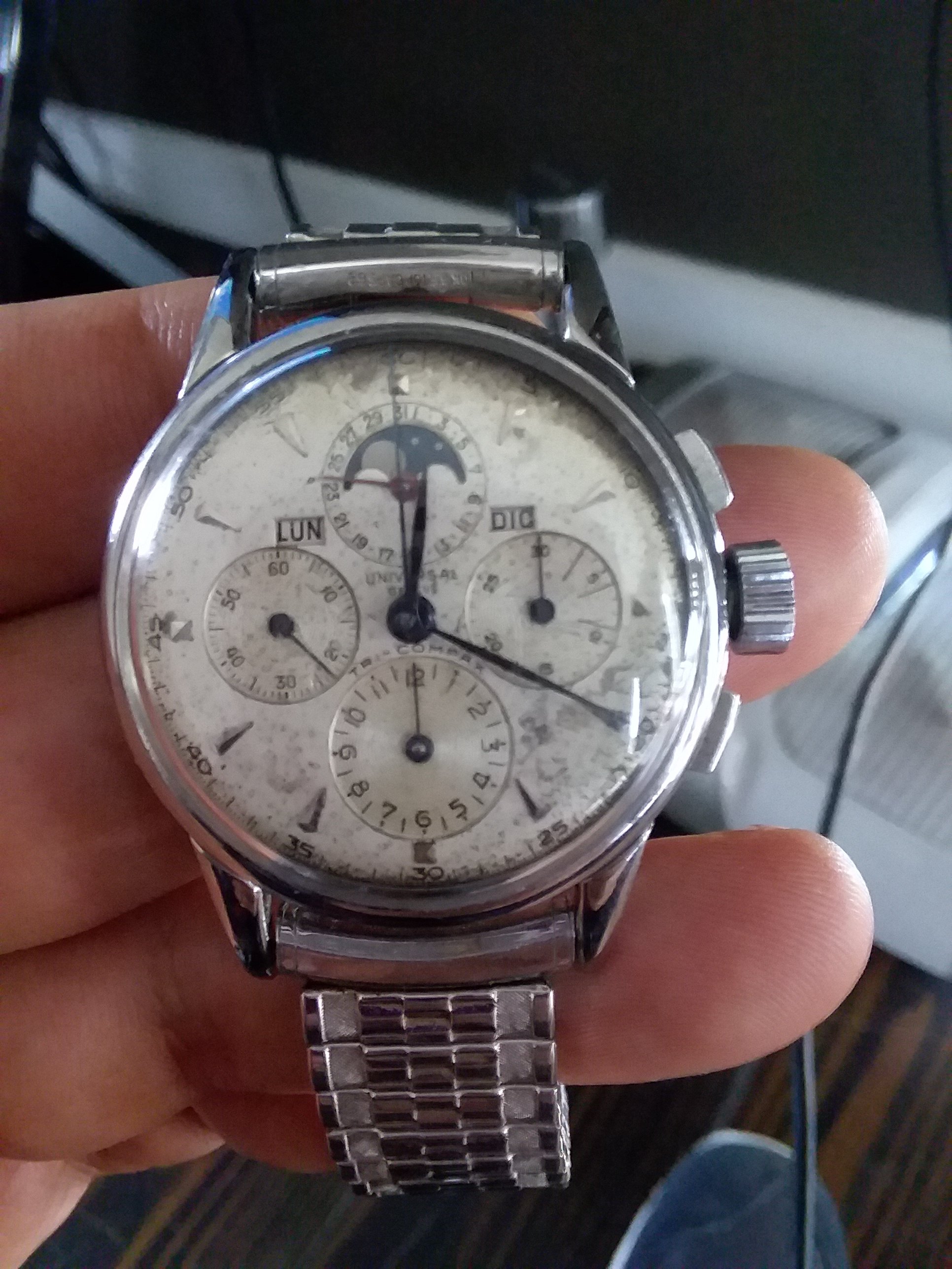

So the customer had the indices changed. Jeweler sad (in French) “But you will cover the numbers! Customer said (in French) “I don’t care “ ... everyone was happy. Then it went into a sock drawer at somebody point and now Florent owns it.

That one is an egregious redial.

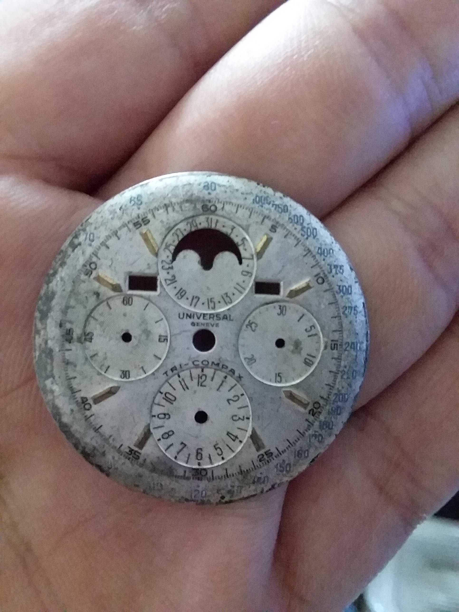

for reference:
Here are a couple dials with indeces from my collection ! Some spacing between indeces and arabic numerals on these two !

How someone can even think this is not an original UG dial is beyond me, but I agree the forum is here to discuss and discussions would not exist without conflicting opinions so be it.
Also, for the 1000th time: dials DO NOT have anything to do with references in UG. Only the combination case material/case shape/movement does. ANY period correct dial/hands combination could have been chosen by the client for a given references.
Finally, UG tolerances on dials were far greater than let's say Patek or Vacheron at the time, given their massive volume of production (and dear I say price point): hence imperfections and inconsistencies are well known and documented and should not surprise if within acceptable levels. And this dial falls right into that category. It is magnificent and I congratulate the owner for such an incredible find!
