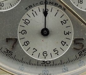

Beauty! I'm fascinated that the hour markers appear to overlap the dial printing.
This would be the very first time that I see the indexes overlap the printing on an original UG dial.
Also the 30 overlapping the hour counter at 6 is interesting and the not perfectly centered left and right sub dials. But the latter might be:
Camera angle?
@Florent, would you post a clear on top view so that the camera angle would not fool the eyes?
994
3,206
Indeed, indexes slightly overlap the printing (first time I see such a thing on an UG dial also)
Anyway, if you look closely to the one a 5, you will notice that this index overlap because it can鈥檛 be more centered, since it鈥檚 almost overlaping the hour counter itself.
The dialmaker probably preferred to overlap the printing than the hour counter !
About 30 overlap hour counter at 6, thit is a variant, relatively common on those 馃槈

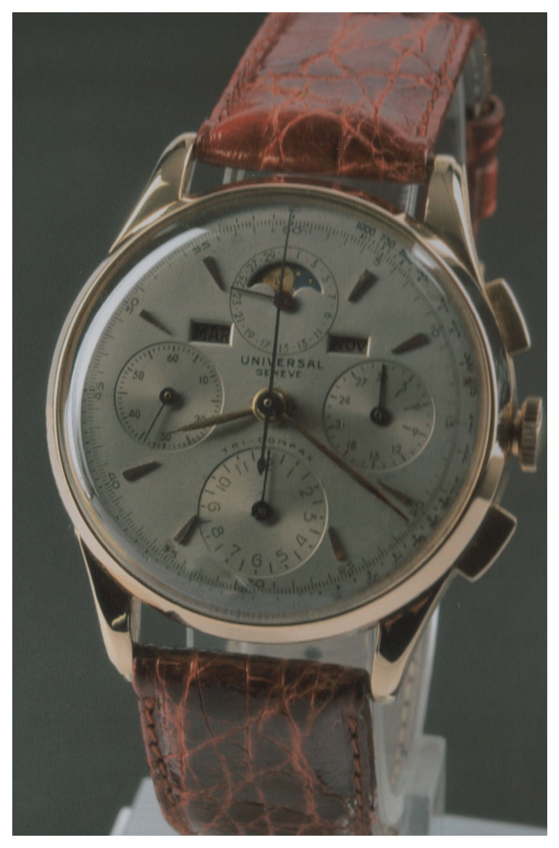

Sorry to be a little bit sceptical. Sala's book has its problems and mistakes, but the 12552 in it looks different:
Note how much wider the seconds and tachy scale are so that there is more space.
Additionally, I would expect the index at seven also touching the 12 hour counter on your watch but it doesn't.

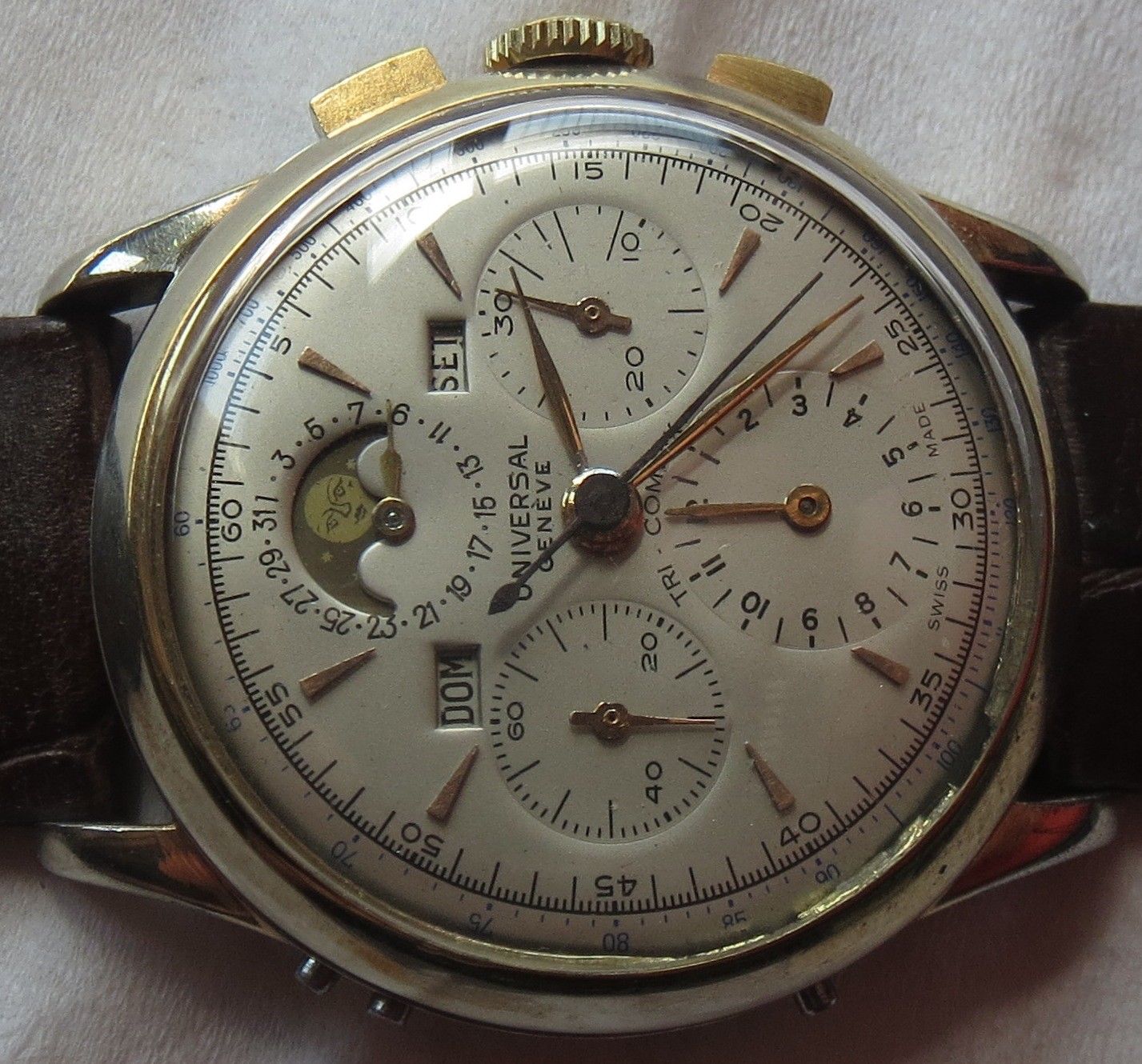

Hi All,
I have same reference, still at the SPA to correct a problem with a welded golden hand (hour hand), my dial is different.
Initially I was amazed by the quality and freshness of this dial, but I agree that the overlapping of the hours markers is not common I presume.
Also in mine the 30 does not overlap the hours subdial, but on the inverse, it seems it was cutted by it.
Moon is either service or period correct as this is when the face went away. So here we go again !!!!!!!
When did UG stop printing the face in the moonphase disc?
Thanks and some pics of my dial

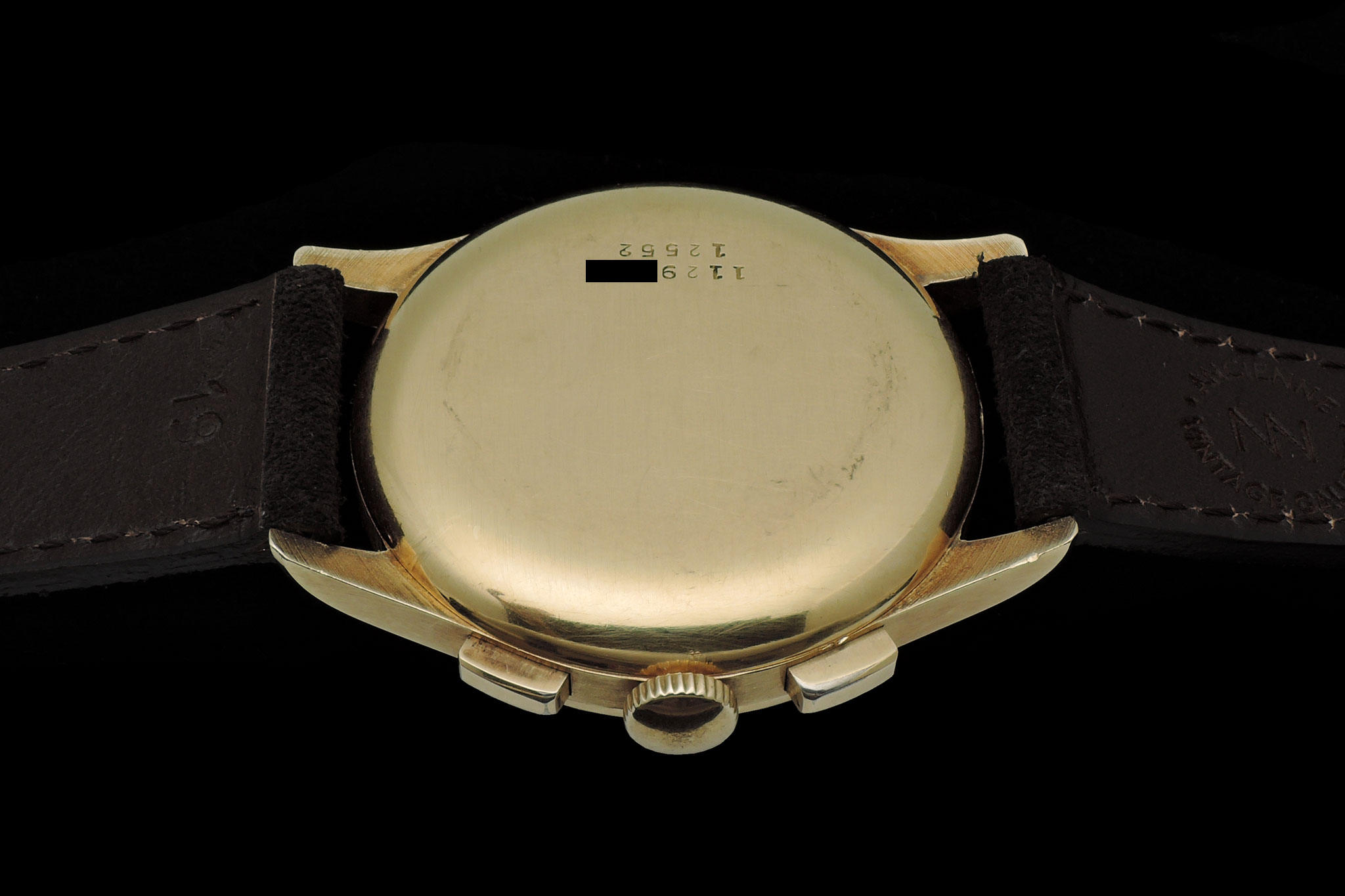

We also know there was a ton of customization done... especially in France where they even made cases as Florent suggests.. generally indices are wired on. PS Florent let鈥檚 see the case back 馃榿 . Wow we have two French watches in a span of days that kicked off a debate!
