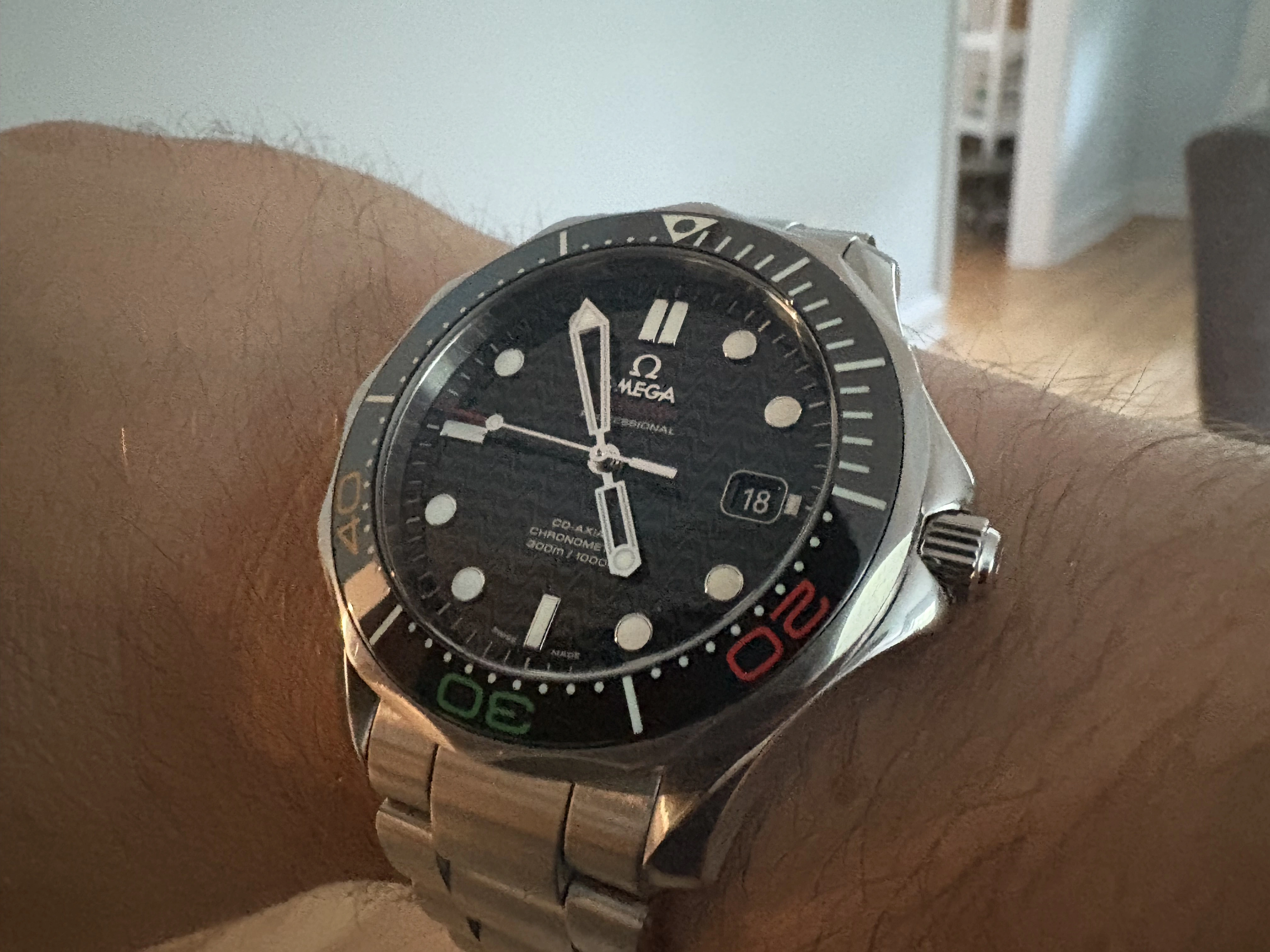

Obligatory pic—it lives on the Aqua Terra bracelet I picked up for it—love that combo!!!

Is that an Aqua Terra bracelet on the SMP?
It is. Whenever I have my 2220.80 Seamaster on a bracelet, it’s normally the AT bracelet.

Correct, re: the AT bracelet (as mentioned in my OP). I don’t love the original SMP non tapered dive bracelet, so it stays in the box. Found the AT bracelet on eBay. Have never looked back—tapered oyster with a concealed clasp? Love it on the SMP.

That's my favorite bracelet for my SMP's. I have probably 10+ including everything made by Forstner and Uncle Straps but the 1st gen AT bracelet is my favorite. And it's paired with the current gen Heritage 300 on the go adjustable clasp.

Had no idea the 1st Gen. AT bracelet fits this 3rd gen. How is the tolerance of the endlinks towards the case? Any play or space?
1,882
2,868
There’s a very slight overhand at the lug, but it’s not noticeable day to day. I posted about it a few months back with a pic. Will see if I can find that thread. It’s an excellent fit! No gap, no play.
