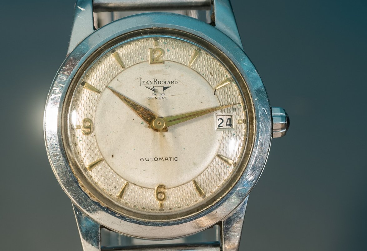

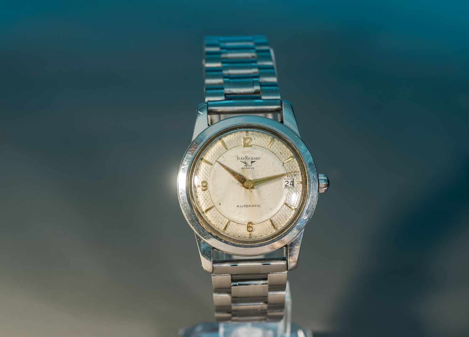

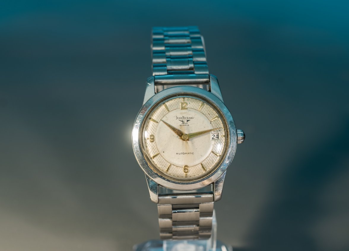

Anybody here who can tell me anything about this watch? Is it a rare and valuable watch or just an ordinary low cost vintage watch?
16,305
45,011
Rare, but not particularly valuable IMO.
A lot out there in this category- all the more fun to collect.
16,305
45,011
Are you looking to buy or have you already bought it? If priced right, it’s an attractive watch and a clean-up would make it fabulous. Size is also a factor on these older ones.
Case is honest and looks sharp, crystal would just need a wet-sand and de-gunkified- will be a looker
24,743
54,959

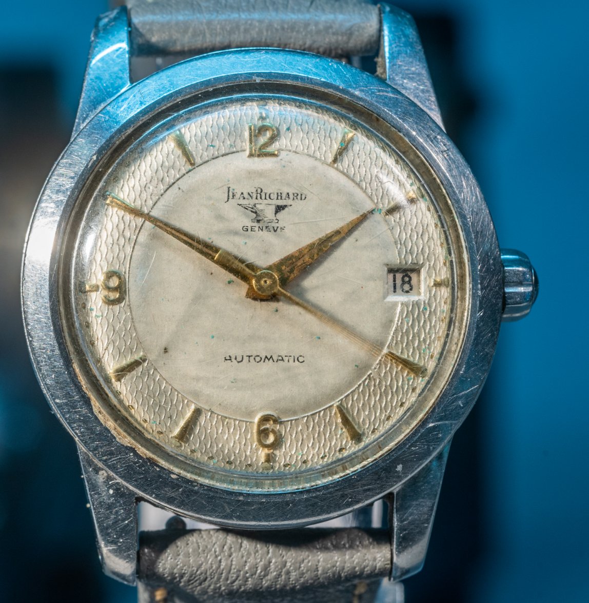

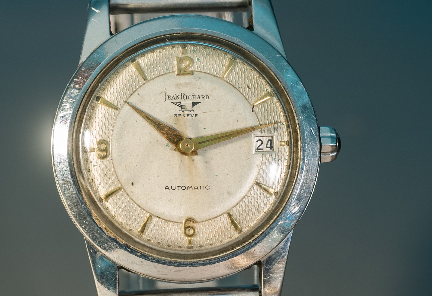

Looks like an embossed plastic dial, so it could possibly be cleaned.
100
33
I have already bought it. Maybe I could remove the crystal from the front and clean the dial but I´m a bit afraid that also the text will dissapear if I do so. Which kind of cleaning agents are advicable to use on these dials?
16,305
45,011
Let a watchmaker take it apart. The only cleaning that should be done on a dial is using rodico (although many watchmakers will disagree as rodico can leave residue) or the Bergeon sticky swabs (a gel type swab that you dab on the surface to lift grime but doesn’t abrade or leave a residue).
There are many threads online about magical cleaning techniques (like the lemon juice trick) but I can tell you from personal experience that it may work once, but will more than likely destroy the dial (yes, I destroyed a Seamaster dial after getting my confidence up saving a cheap watch dial…I will never do that again). There are a few wet swab tricks to spot cleaning, but it requires skill, experience and nothing to lose on the watch owners part- you roll the dice when they get into cleaning dials.
I personally can’t stand any patina on a dial. But some love it. If you are like me, then sell the watch as-is to someone who will love it as is.
100
33
Ok. I understand. Maybe I should only sell it as it is. maybe I should change the crystal because it has some cracks but I think also that will be a lot of work to find the right shape and size and a dealer to buy from.
24,743
54,959
If your goal is to sell the watch, you can't even afford to pay someone $50 to change the crystal and clean the dial, since you might not get much more for it. Not worth typing any more, honestly.
18,483
38,426
Hard words, but good advice.
The watch would struggle to make more than $100 IMO, so any money spent before selling it would be dollars down the drain.
