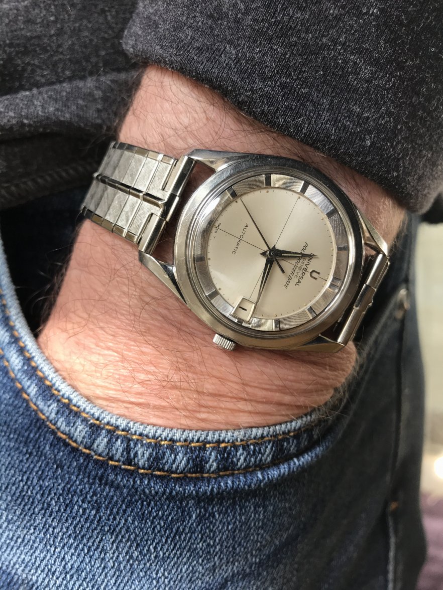

Here's the non-UG signed version from JB Champion, with straight end links, which I just picked up recently...couldn't be happier (well, I could if I had a UG signed one, but I'd likely need to rob a bank first...).

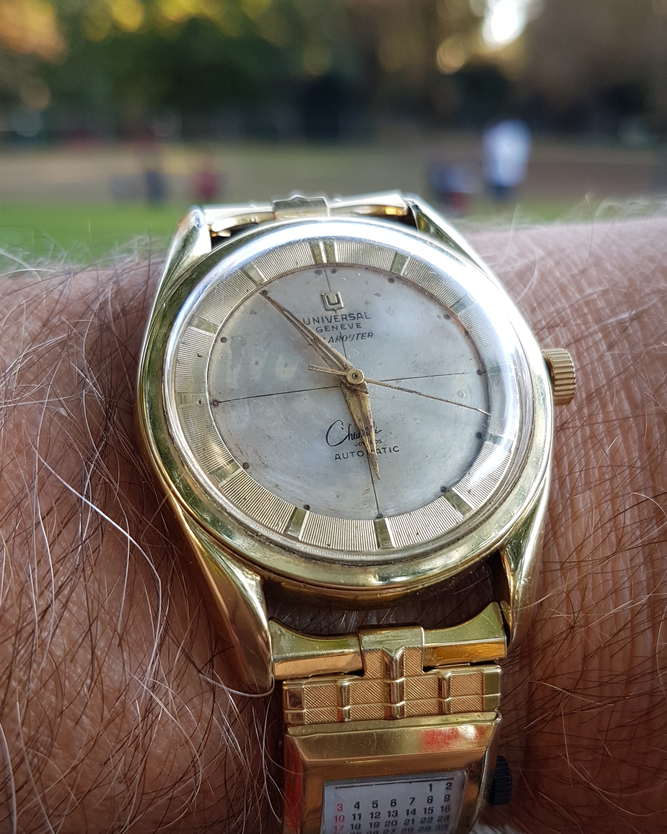

I didn´t know the JB Champion connection, but already have choosen an unsigned JB Champion bracelet with an integrated calendar for my Polarouter some monthes ago too.
