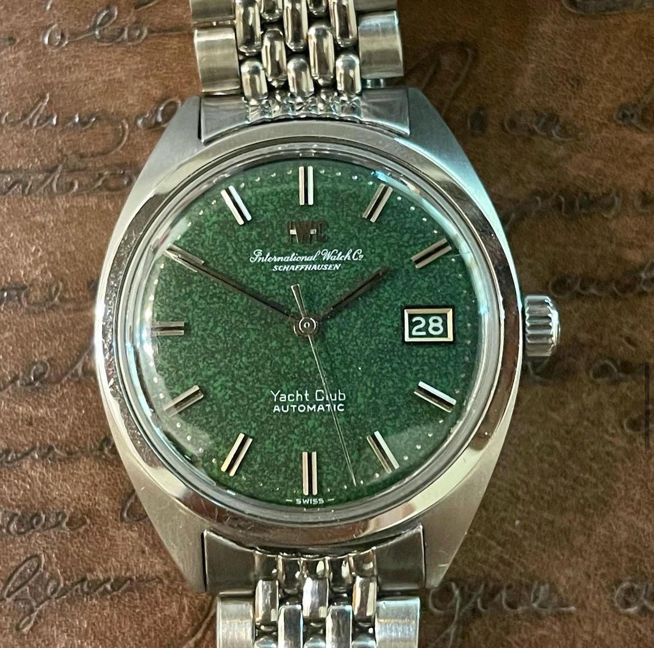

231
301

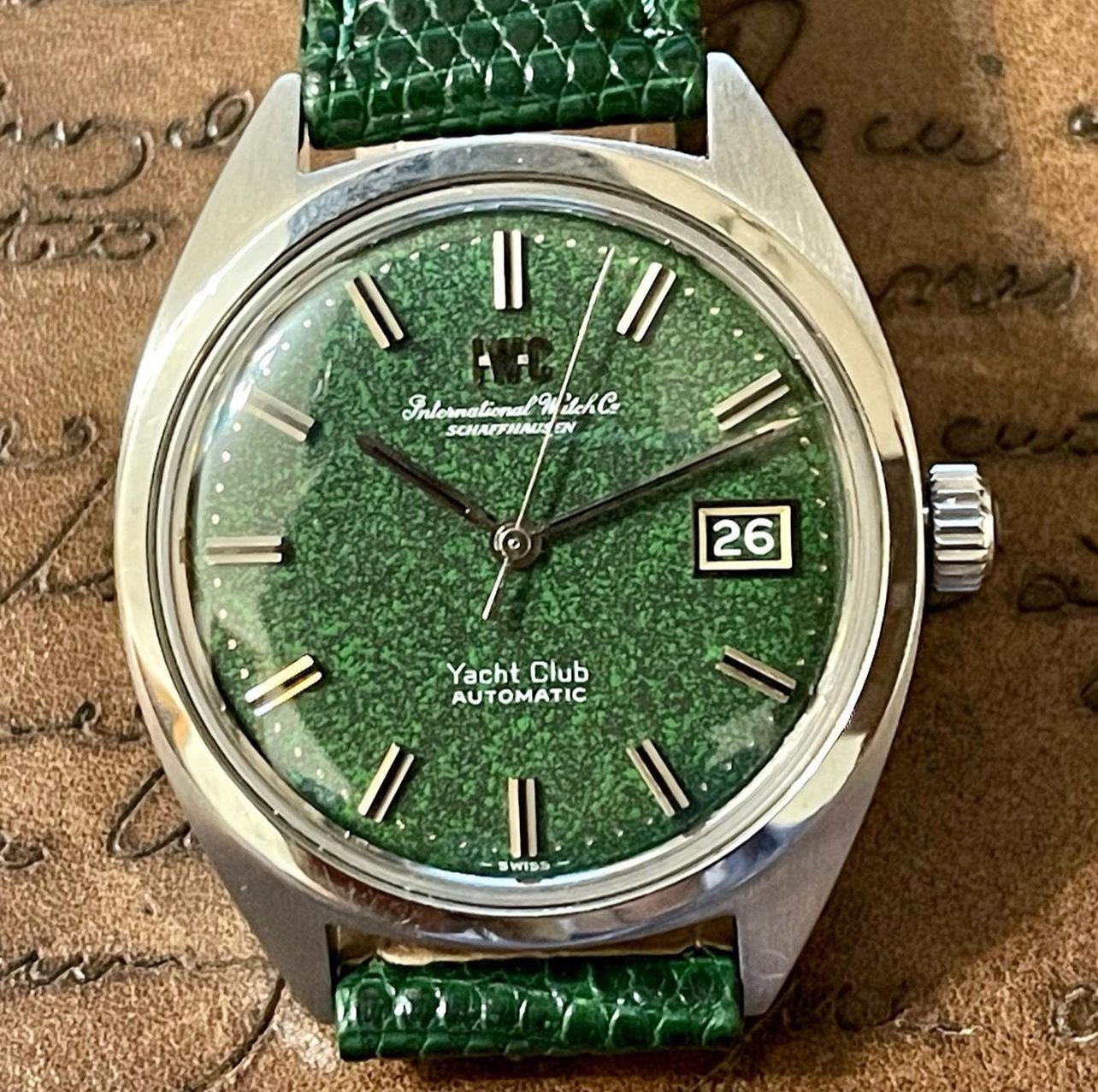

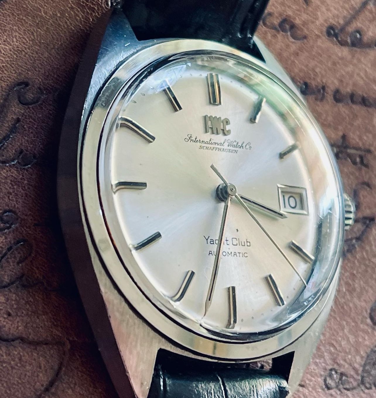

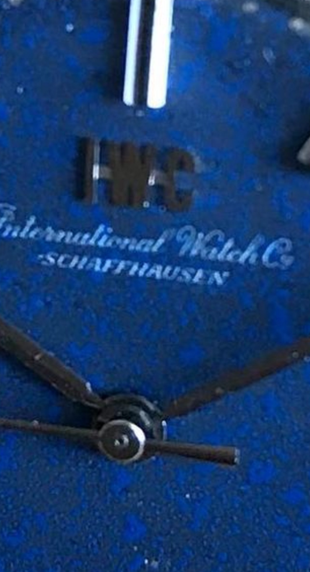

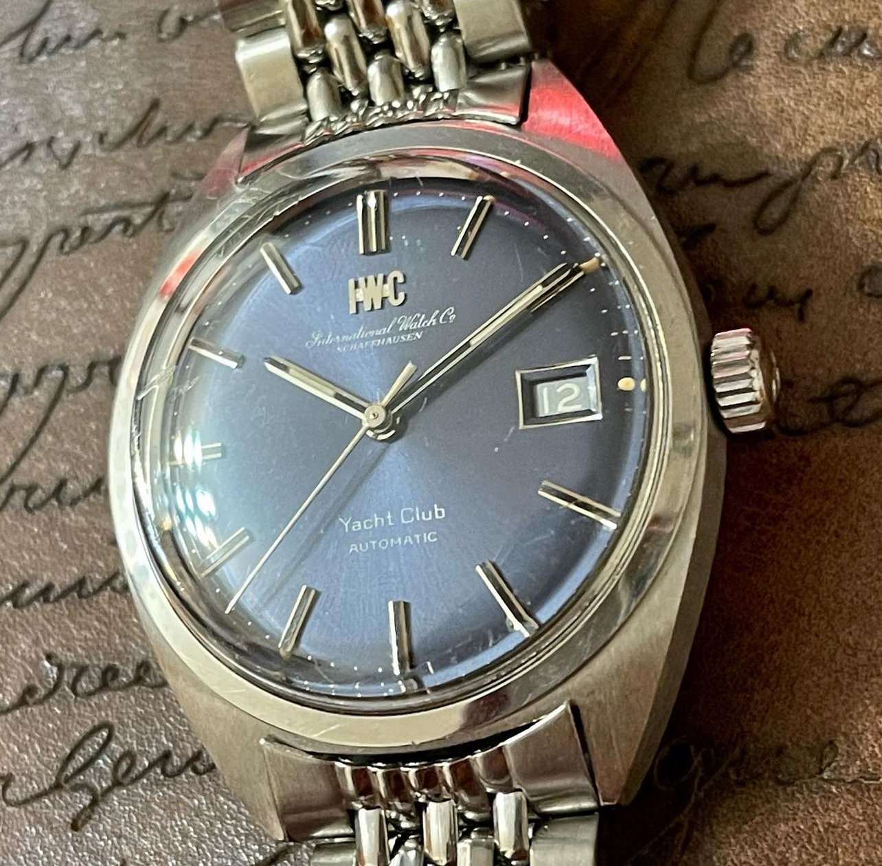

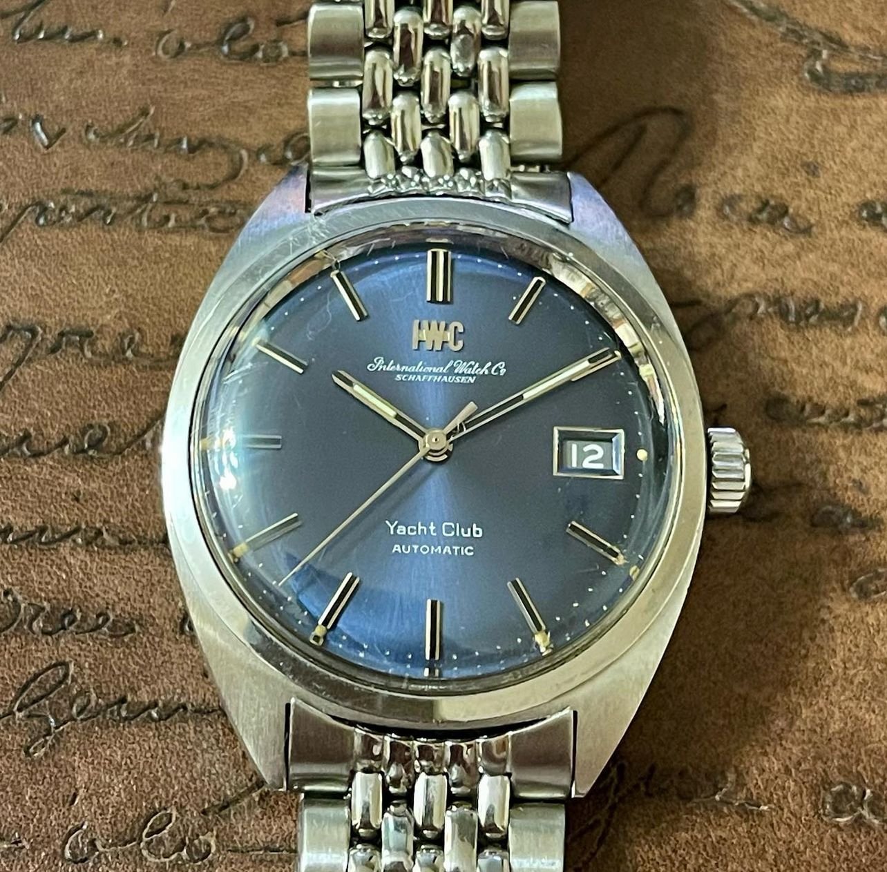

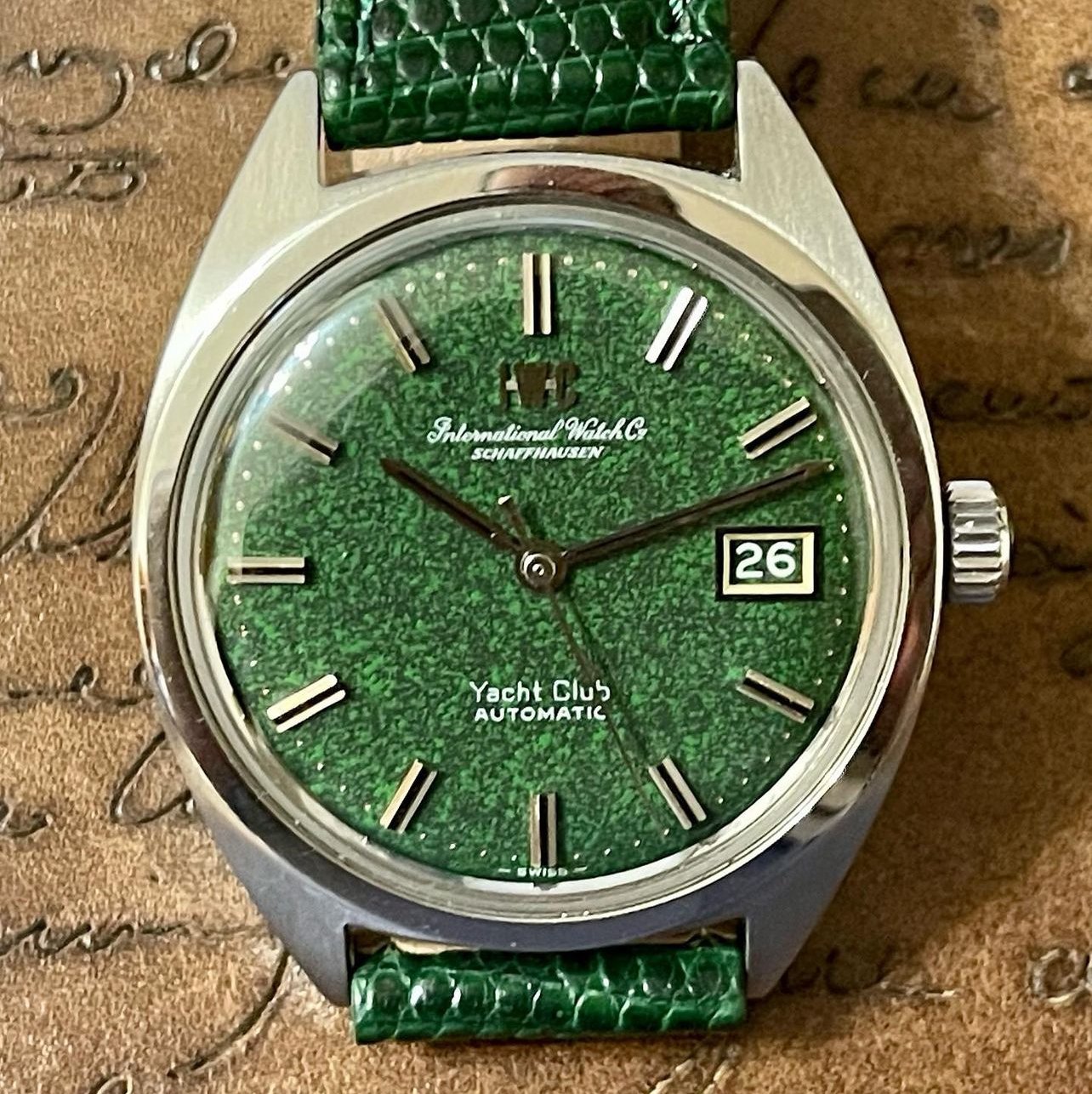

Lovley!
That green "marble" dial YC is very rare. I've seen one or two (possibly the same one?) for sale on ebay and Chrono24 for exorbitant sums.. I think there was also a blue "marble" version?
I'd be very interested to know what the dial looks like really close up and what it is actually made of / how it is finished.

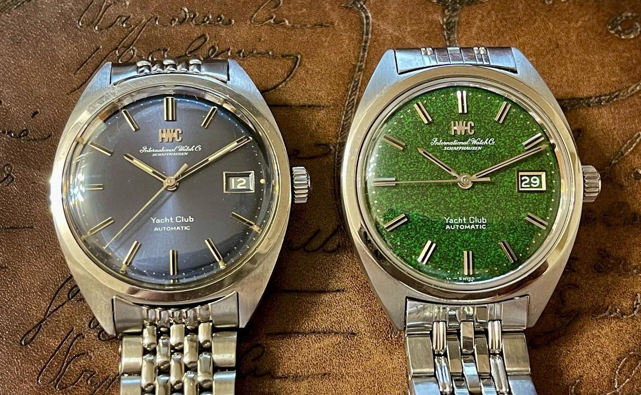

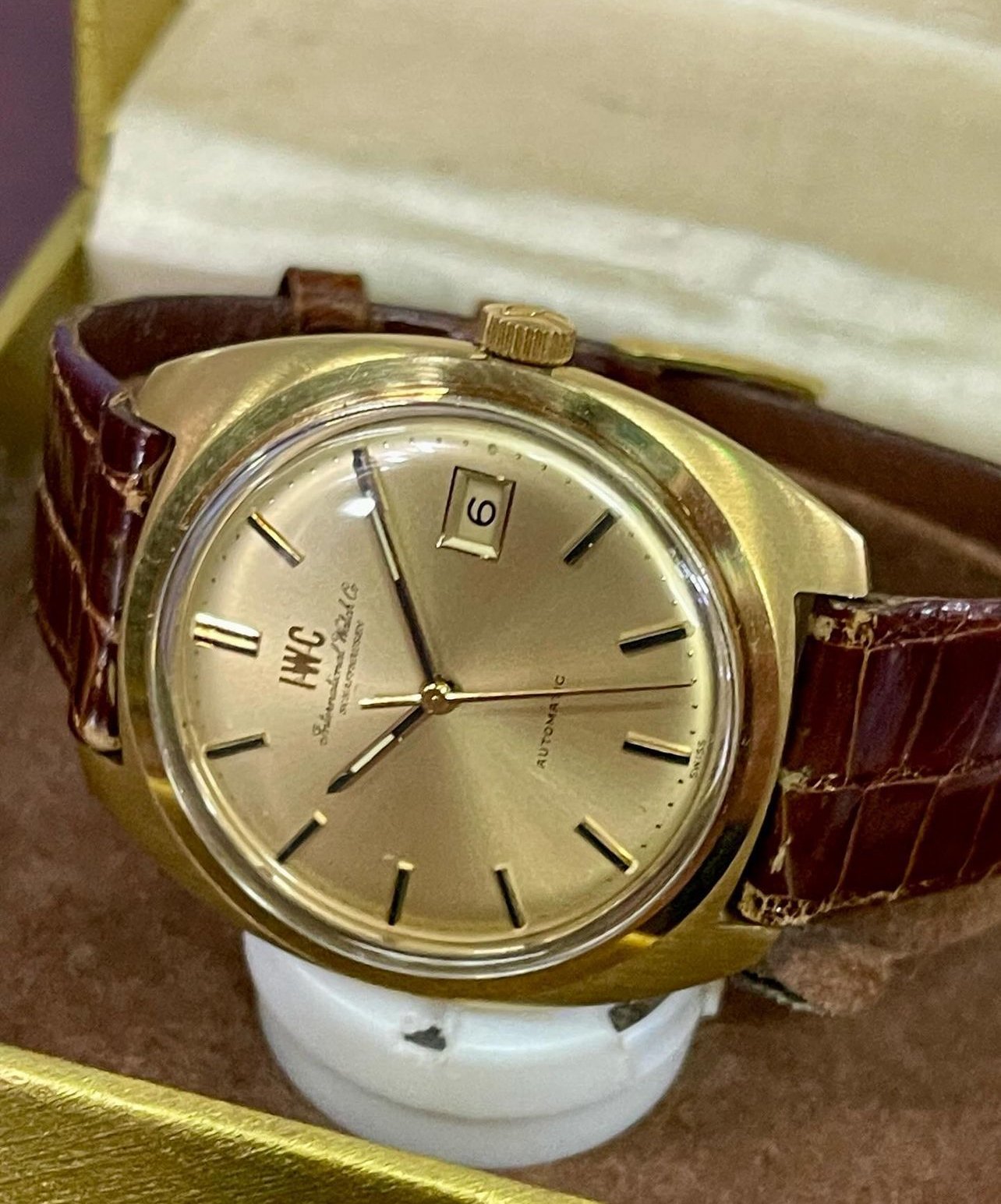

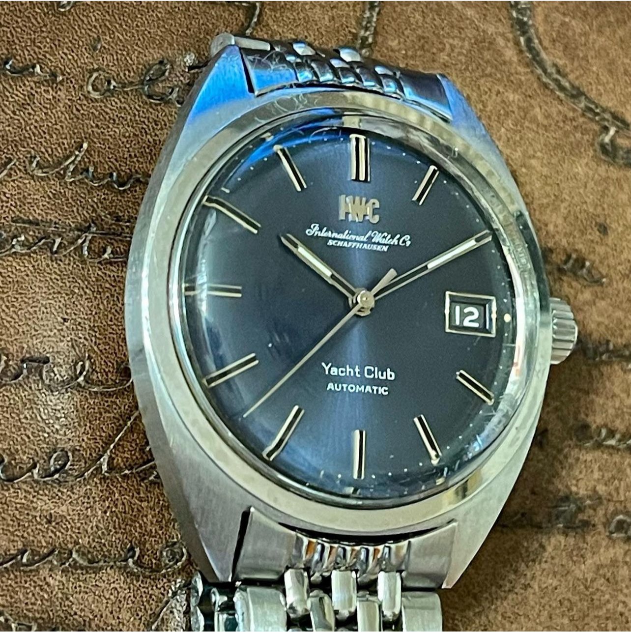

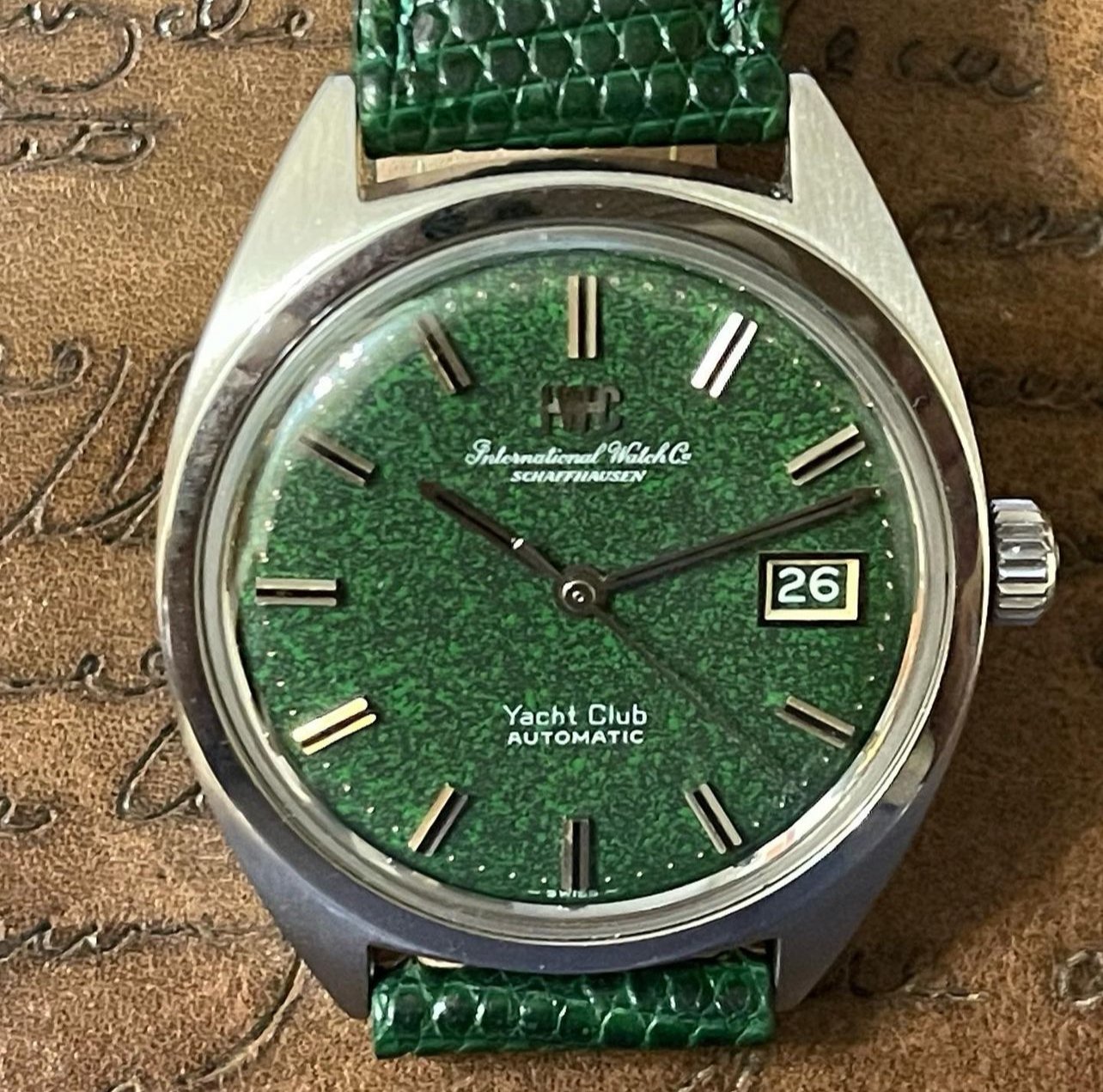

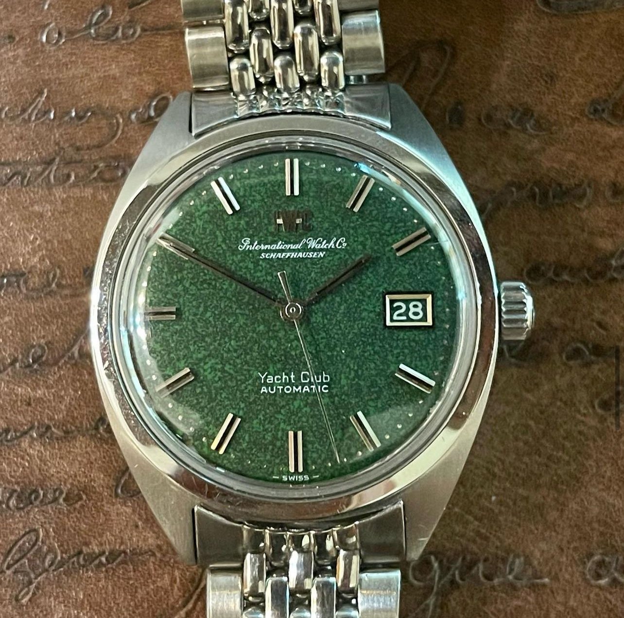

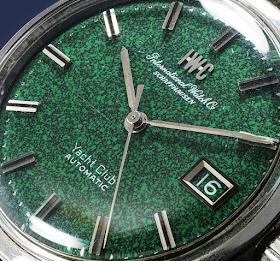

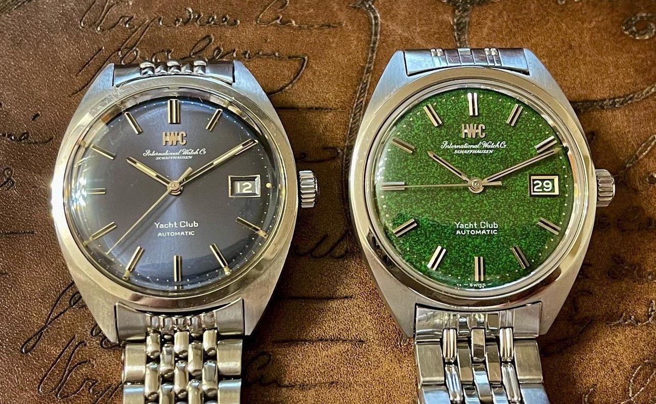

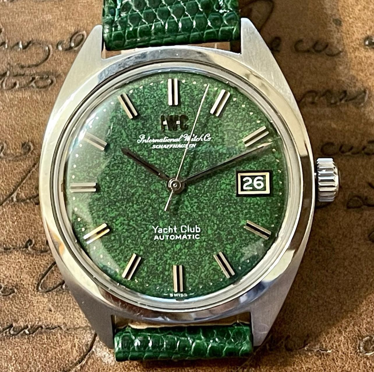

130
399

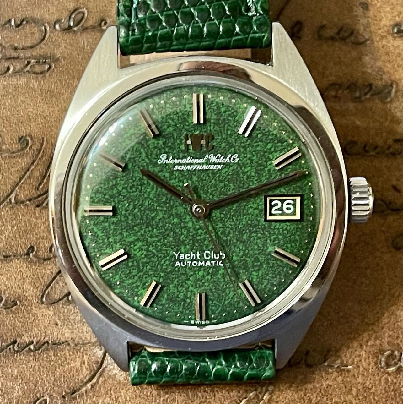

Lovley!
I'd be very interested to know what the dial looks like really close up and what it is actually made of / how it is finished.[/QUOTE]
There are two versions, one blue and one green. The dial looks like a dial surface with blue or green paint

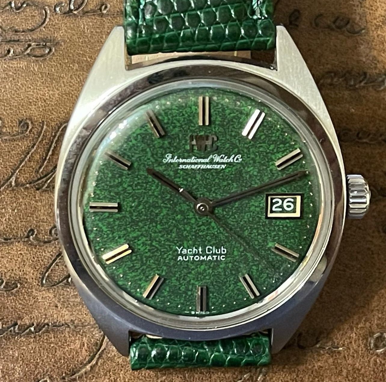

35
19
Lovley!
[/QUOTE]

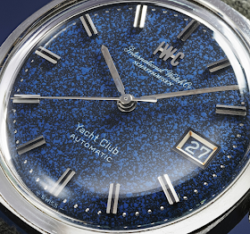

I was under the impression that these were stone dials, is this not the case?
231
301

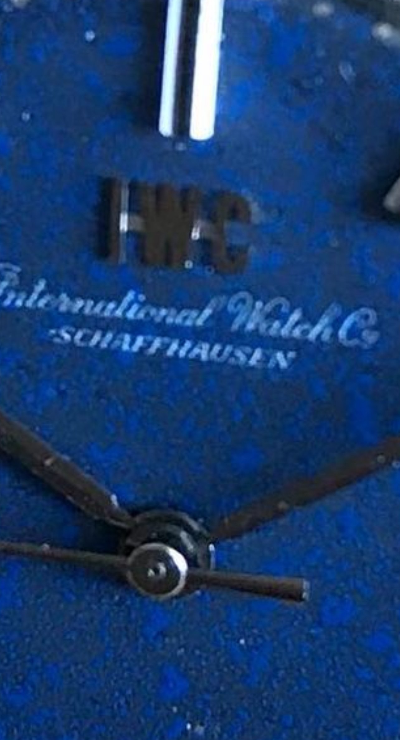

It would seem a bit tacky if they are painted rather than real stone, given that other brands (notably Rolex) were doing various stone dials at this time.
It's not possible to say from these photos though. Really needs a macro lens (preferably manual focus as autofocus will target the crystal and deoth of field is very shallow), or a microscope with camera attachment.

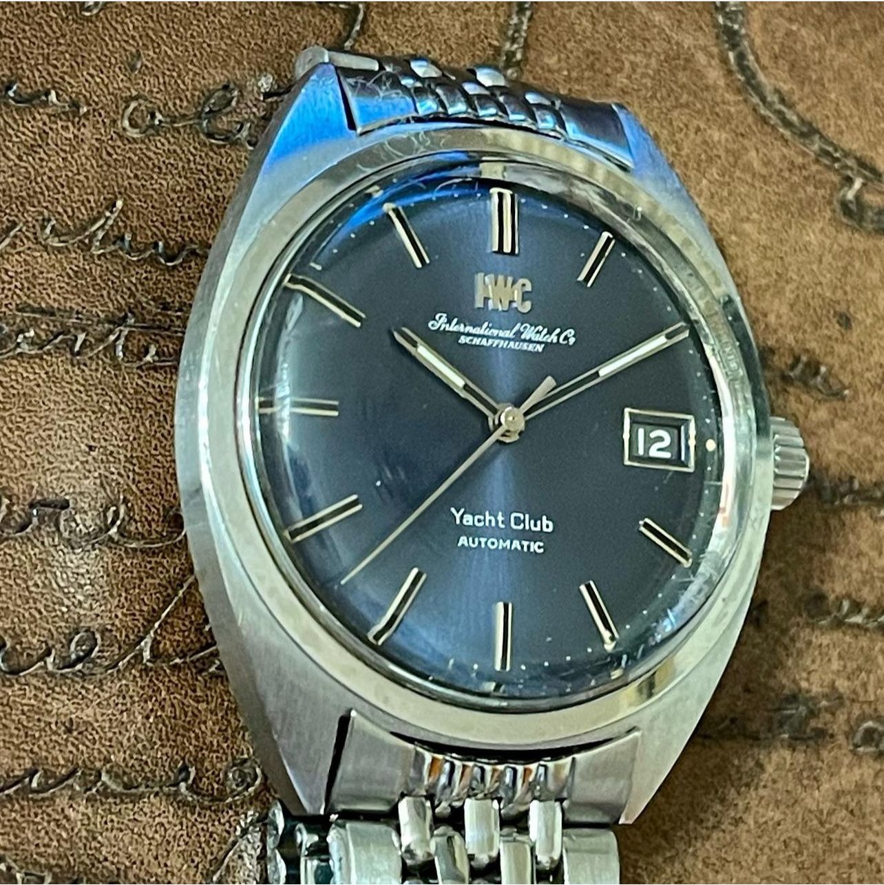

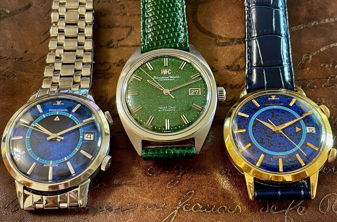

Hello all. The Yacht Club is often compared to the Rolex Datejust of the same era (1600, 1601, 1603). The dimensions appear to be nearly identical and the proportions are very similar. Yet, I can't find a single picture online of a Datejust next to a Yacht Club.
Does anyone here have both, and if so would you be willing to share a pic (or several)?
