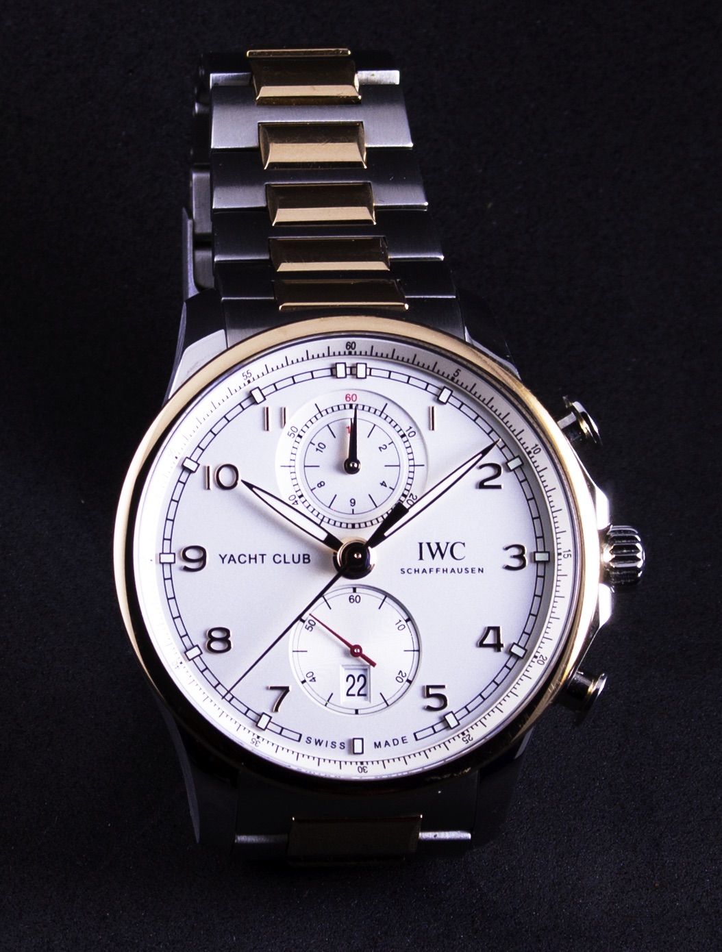

I just got the an IWC Yacht Club Chronograph w/ screw in crown. You can wind it as you normally would most watches but one of the things I thought was pretty cool is as you screw the crown down, it also winds it. The first couple of times it felt like I was not holding the crown down far enough as I screwed it in but I think it is actually by design. Anyways, I love the watch, might sell it at some point. Here's a pic.

Thanks for the detailed explanation, Al. I'm still learning every day. It makes absolutely sense that the clutch would be necessary for a hand-winding watch. And from a repair perspective I can see why the non-clutch design could be better.
I was just having a hard time understanding why a user would see this as an important feature (i.e. the ability to wind the watch while screwing in the crown). So you get three extra turns of winding while screwing in the crown?
