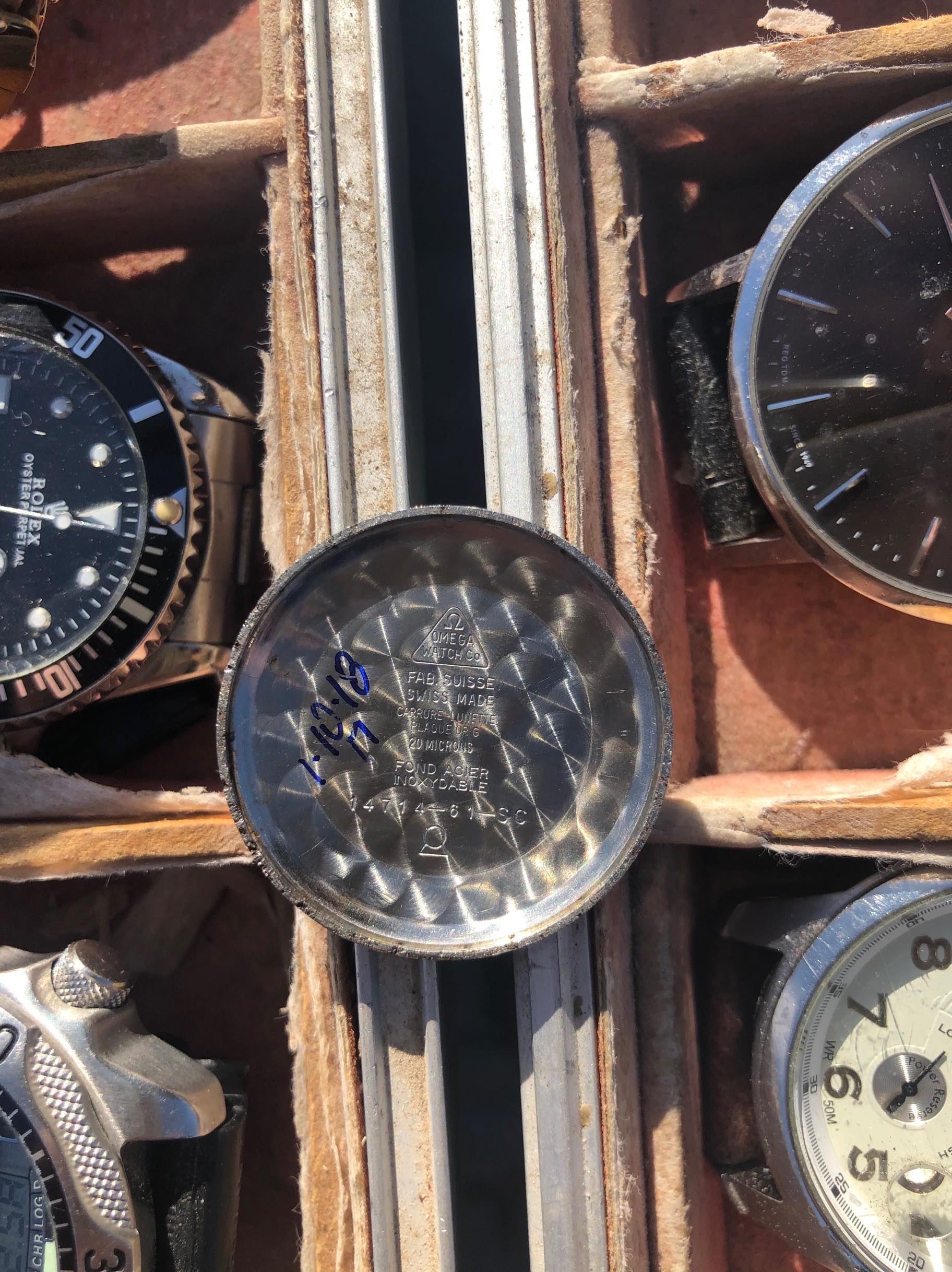

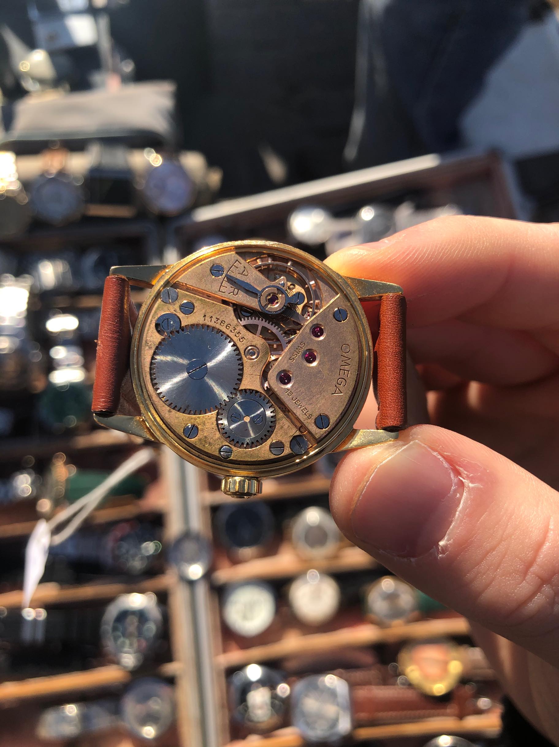

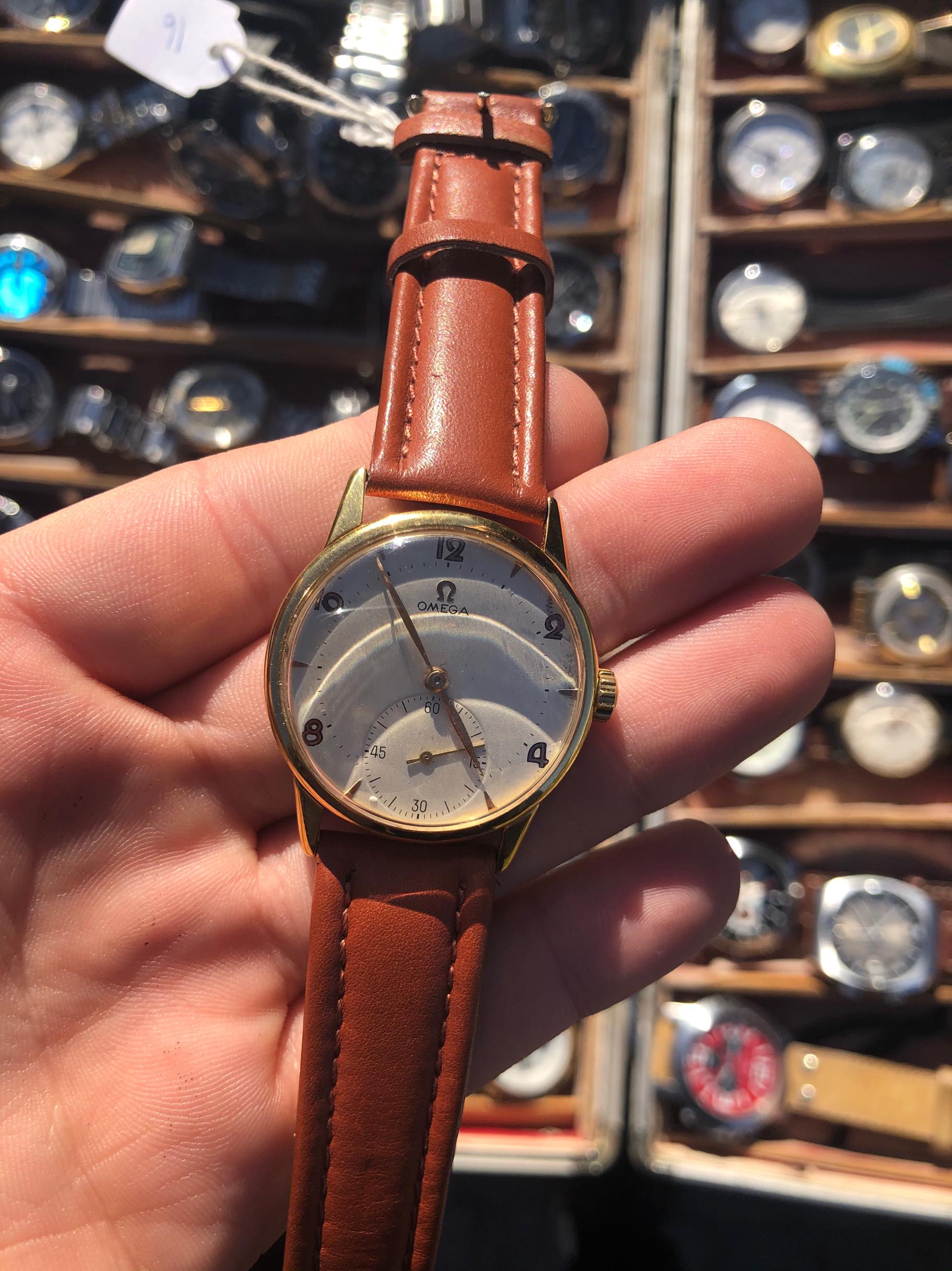

Hello new member here 馃榾 its this omega worth 280 euro ?The case ref 14714-61-sc matches the movement and the dial?
its look like a 30t2 movement,and the dial is repainted.

I believe that the dial has been repainted, so that should factor into your decision. It appears to be a 30T2 PC movement.
Edit: Sorry, I didn't catch the fact that you already knew it was re-dialed. Generally speaking, a gold-plated re-dialed watch is not particularly desirable. Yes, the price is fairly low for a 30T2, but I would rather spend a bit more and get a better example. If you ever wanted to sell this watch to trade up to a better one, it would be hard to find someone to take it off your hands. And don't forget about service costs.

Thank you very much for your reply.You are right it would be difficult to trade it at the future

no - it is that simple
