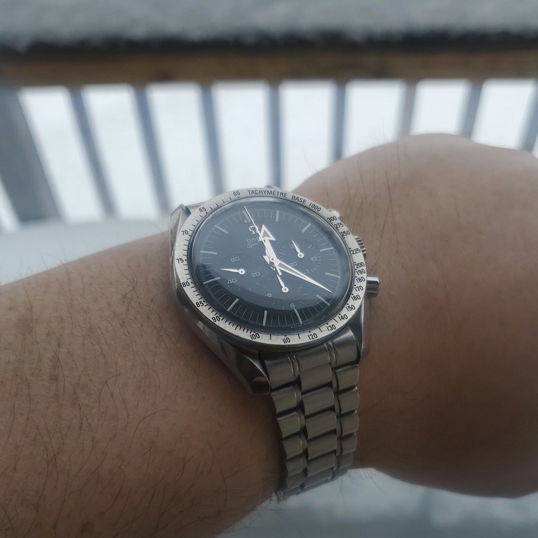

I recently purchased an omega speedmaster 3594.50 from eBay and the watch has an issue where it stops working 3 or 4 times a day. The second hand stops at the same exact spot at the 20 second mark. If I tap the glass, wind the movement, initiate the Chronograph, or change the time, the watch moves again. Is this a typical issue that can be fixed without having to do a full service? I’m debating whether to return or repair the watch but leaning towards repairing (sending it to Omega to service would be my last resort) since I purchased for a pretty reasonable price. Any advice would be appreciated thanks

Your watch is at least 20 years old. When was the last documented full service? If you don't know you should assume it needs one. If you like the condition of the watch, and you got it at a good price, and if the addition of a full service still makes it attractive cost wise, then go that route.

If you don't have some record of recent maintenance, then I would expect that all it needs is a full servicing. Which, as mentioned above, if you got a decent price will be infinitely more manageable than returning it and finding another that has been recently serviced.
Sending it to Omega is certainly an option, but there are a number of reputable watchmakers out there - some are Omega Forum members - who are fully Omega certified, with parts accounts, who can service this semi-vintage watch, and ensure it receives the treatment it deserves!
I am a big fan of the 3594.50 and mine says "hello!" =).

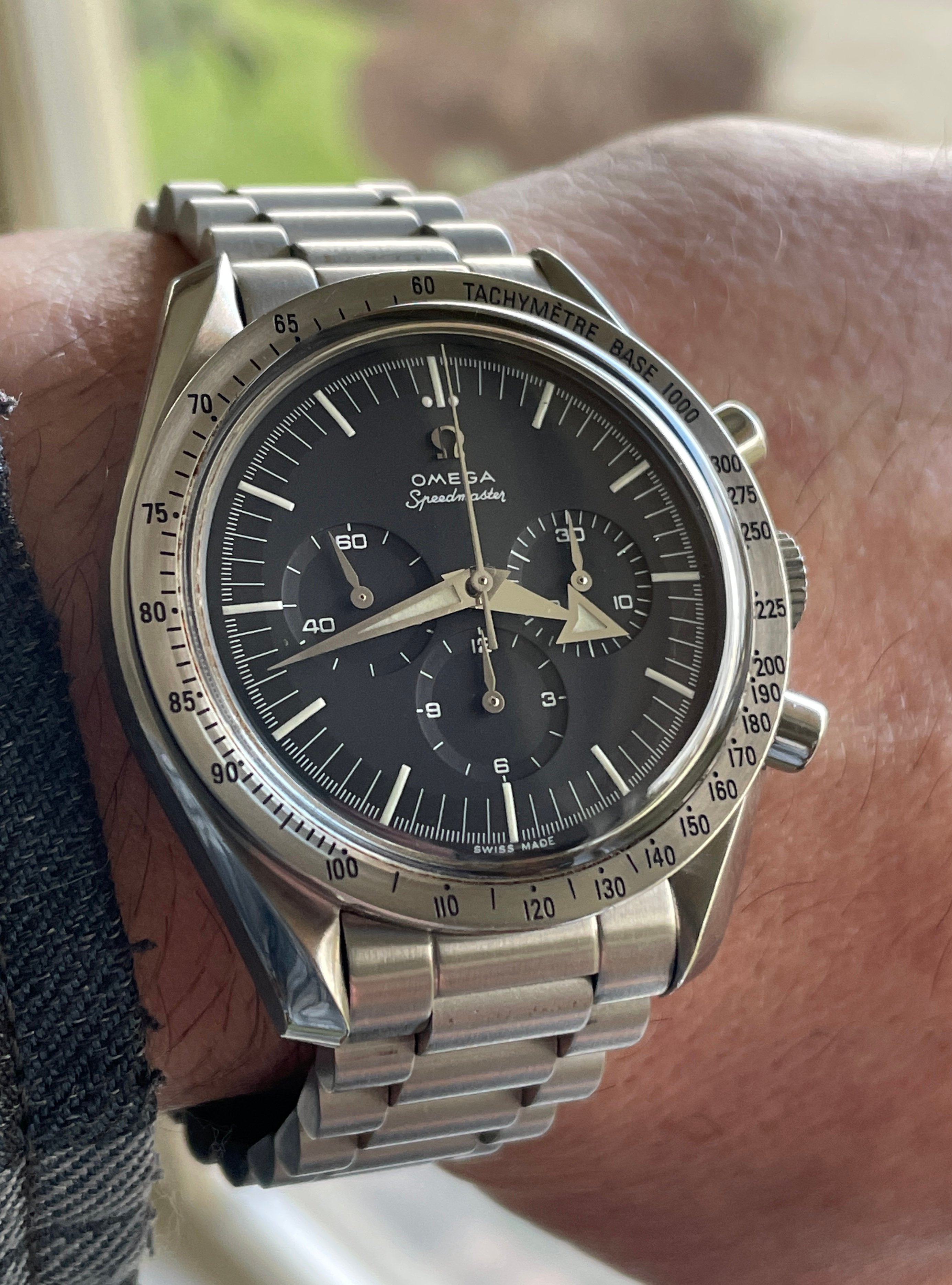

nice 3594.50 - is that the stock or president style bracelet?

The watch clearly is well worn and needs a service. It was probably cheap for a reason.

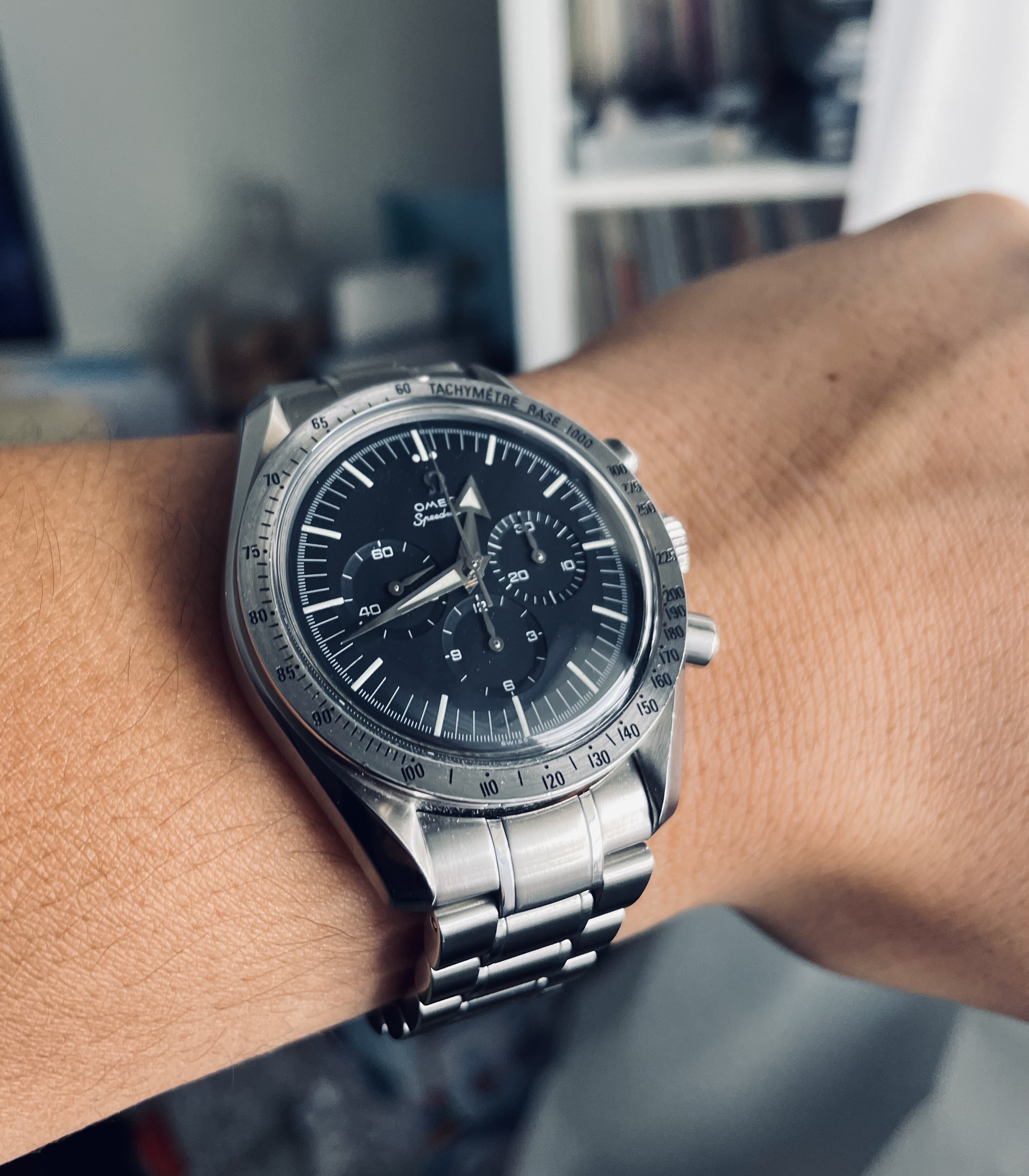

What is that bracelet that you have on your 3594.50? Looks real nice

The 3594.50 is a great choice! Get it serviced and enjoy it!
