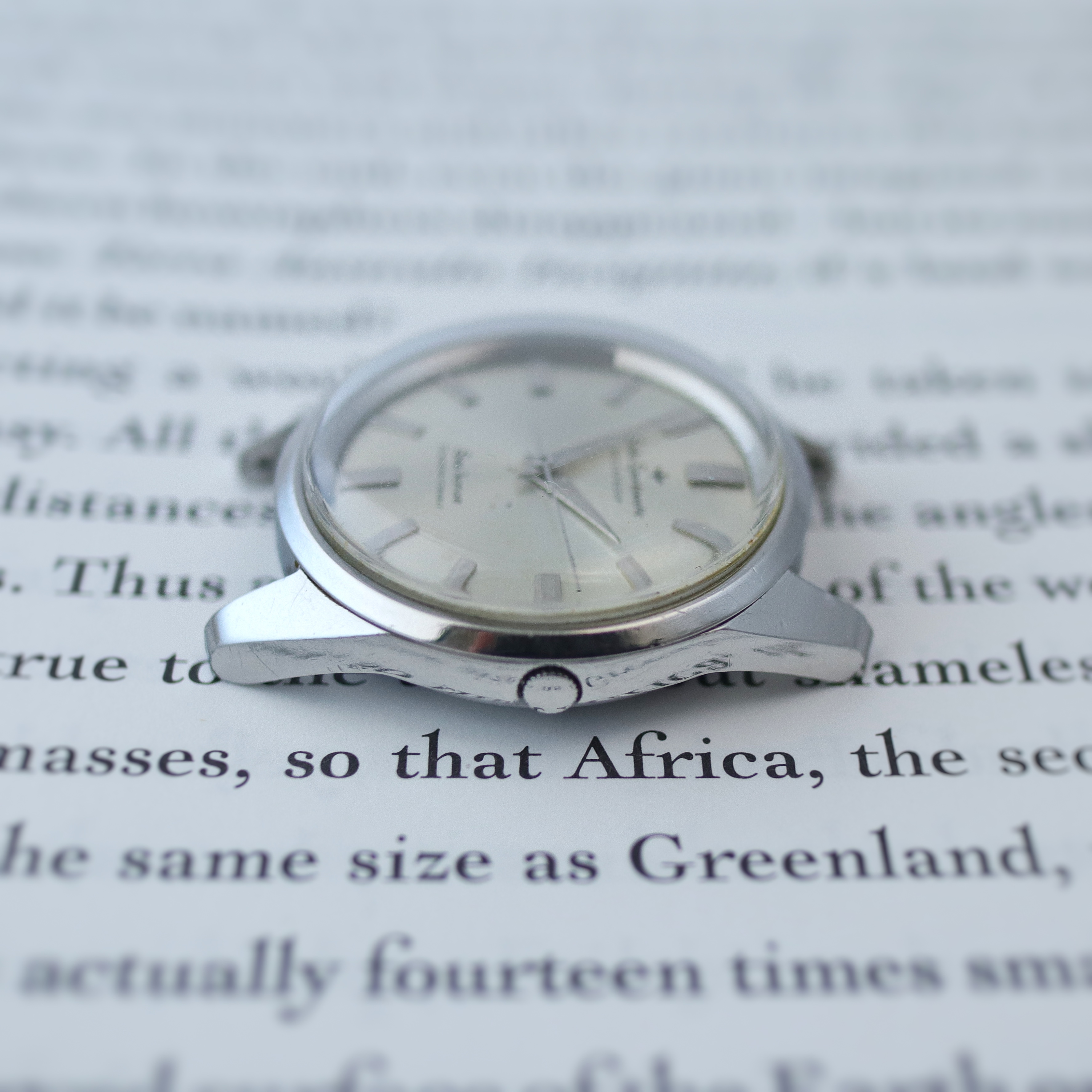

I set myself a challenge during this lock in isolation period to buy a watch. Any watch.
But it has to be £50 Max (or the equivalent currency). Just for fun.
Something that I liked the look of and would wear during the lockdown period. Or look to break even more.
Was happy to stumble across this on Ebay that looks like an OK 60s Diver!
Here she is on the wrist and for a cheap diver made me smile on this sunny day.
Anyone else care to join in the fun please post away.
Will be hunting again over the next few days.
Stay safe!

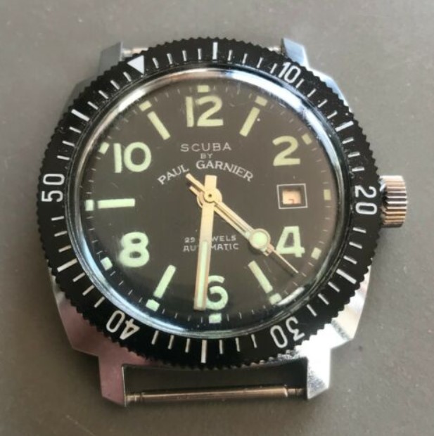

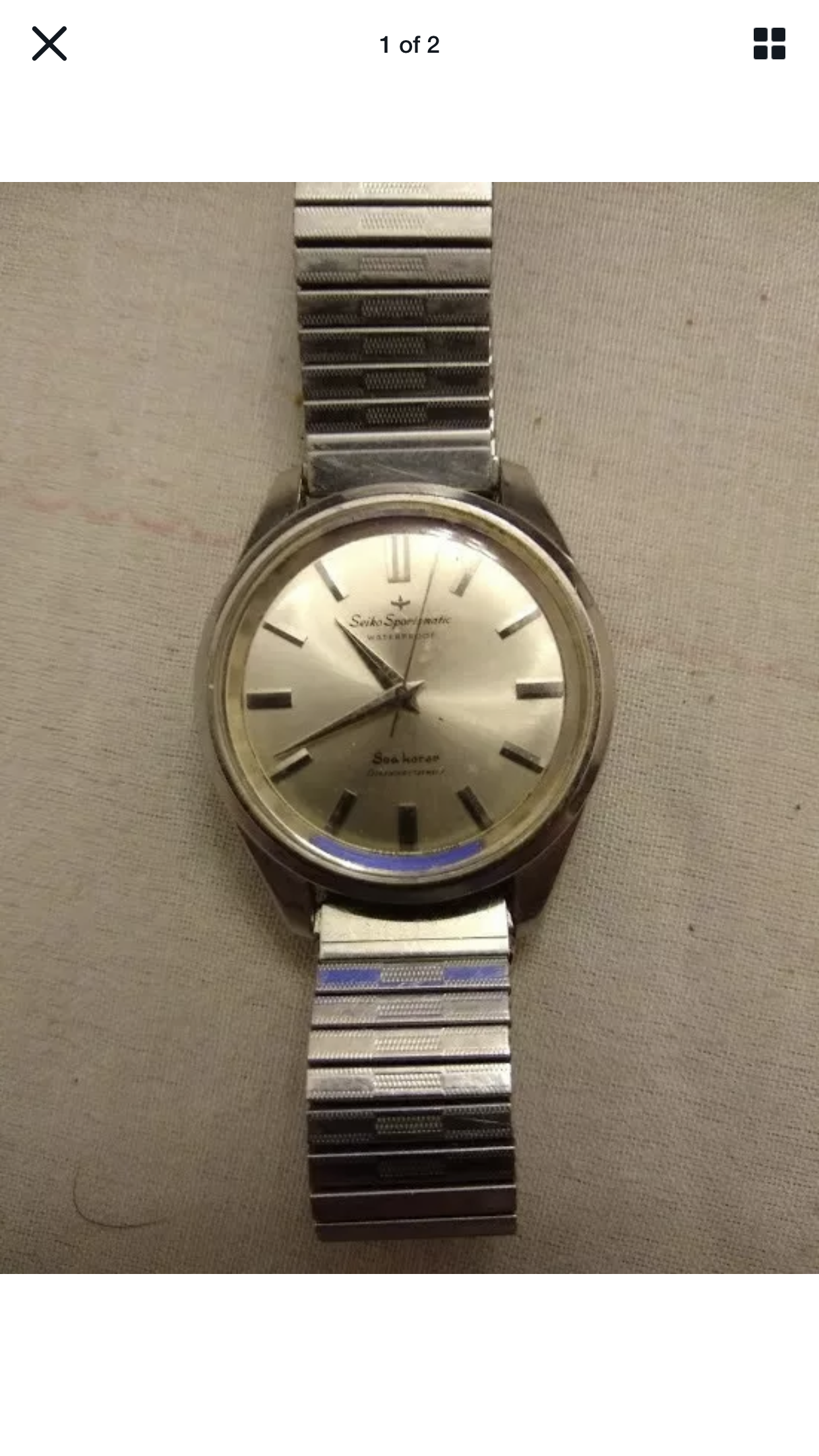

After last week's - virtual - triumph (nice 60s Rodania for 27.50 + pp from UK), in my lockdown-addled imagination I'm pursuing this:
Currently 22.99 GBP, although unfortunately with 5 days to run, so I may need to concede on this one. Interested whether @JwRosenthal ever had one like it. Even if/when I (virtually) lose the 50 pounds challenge, I have however added to my education.
Perhaps this is widely known, but I wasn't aware. The eponymous Jean-Paul Garnier was born in 1801 in France, where he made his career. It's too easy for some of us to become Anglo-centric (and sometimes Swiss-centric): I did not know that Garnier was in fact much more than a watchmaker, and was actually a highly regarded general technologist and engineer in 19th century France - perhaps none of this is news to Francophone OF members. He is popularly remembered for electric clock technology and for superintending the fit-out of the French railway system with station clocks. But the bit that most interested me was that in 1843, he apparently obtained a patent for a species of mechanical calculator, based on his experience with watch engineering. Again, in the Anglo world we are taught that computing began with Ada Lovelace and Charles Babbage, then nothing much happened for a century, then Alan Turing came along, then electronics happened. So thanks again for the lockdown challenge, I've gained zero watches and some interesting new knowledge, duly shared.
Back to watches - please can anyone enlighten me, what happened to the Garnier company after about 1960?
Thanks for reading, stay safe, all.

Nine hours or so to run, still only at 54.00 GBP. So I've busted this week as far as @Just Livin 's £50 challenge goes. Sure, it could still climb a lot if Transatlantic bidders get on board, but I'm still quite pleased with the call. Looks a really nice 60s diver on a shoestring for someone!

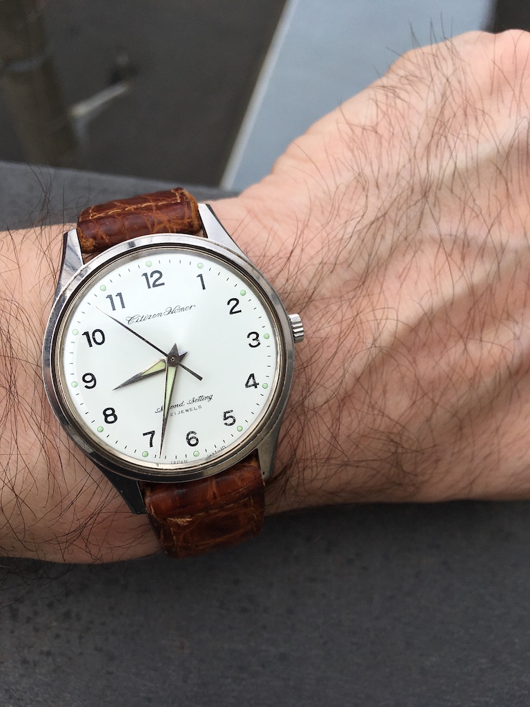

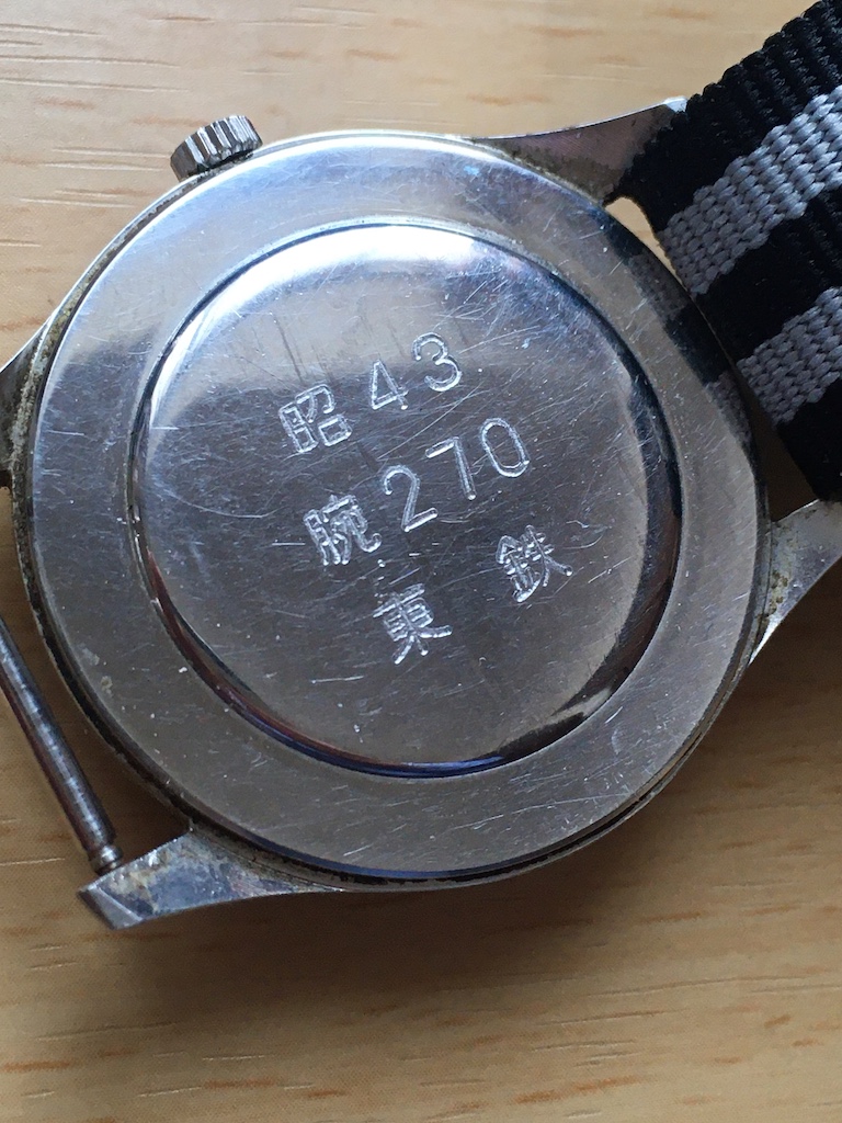

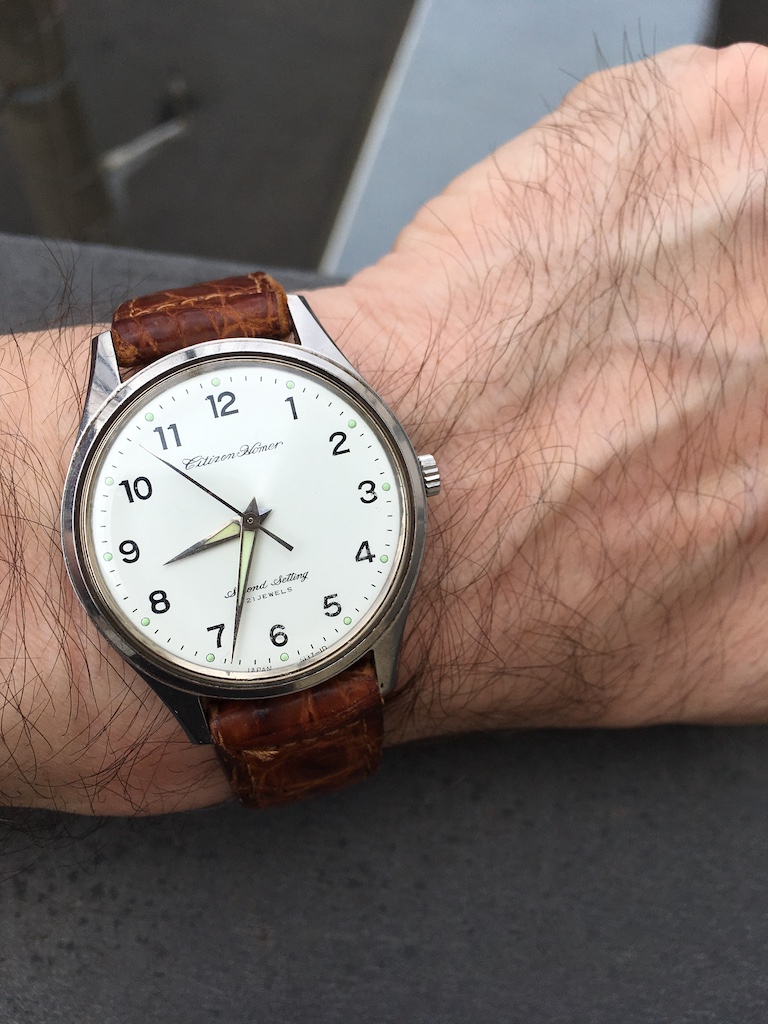

My thoughts exactly when I took a runner on this Citizen Homer Second Setting railway watch. The stamp on the back indicates it was issued in 1968 to the Tokyo Regional Department of the old National Railway. (I would love to learn more about these watches, especially the specificity of the markings. What's the purpose of indicating the particular line or region they were issued for? Could be fakes, but then again they're not particularly valued.)
Edit: I was led astray by the equation £50 = US$75. It looks like it's really about sixty bucks, so the ¥8259 I spent overshoots the target by about £10.

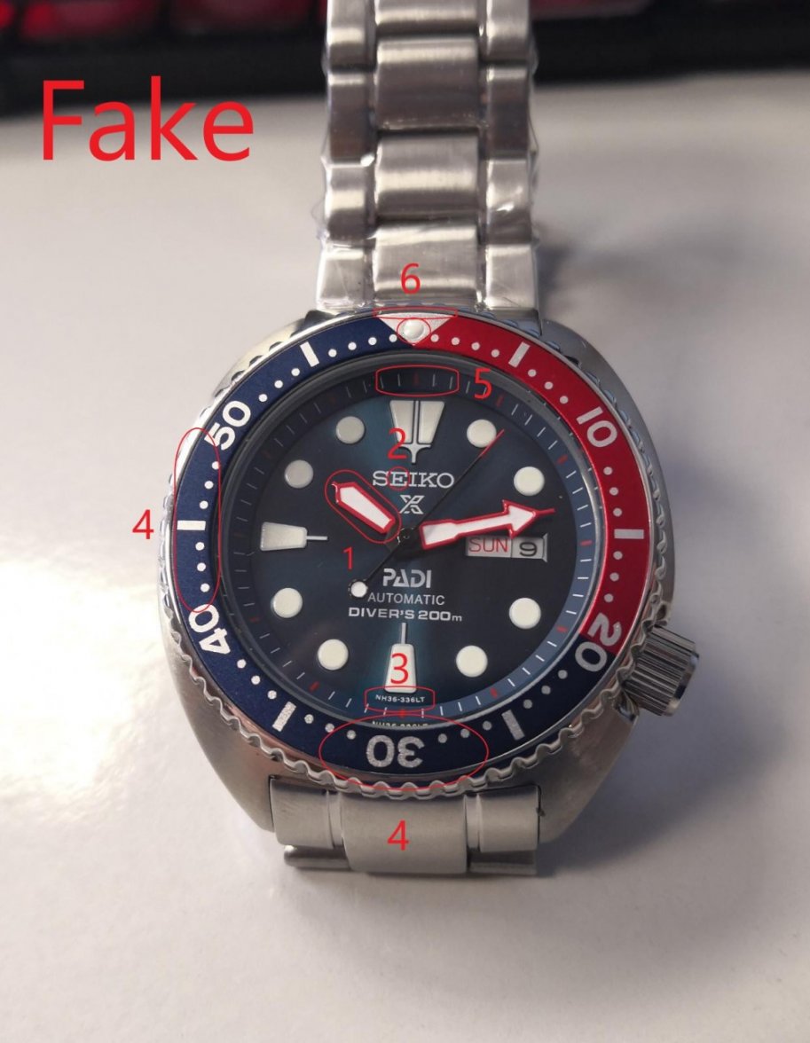

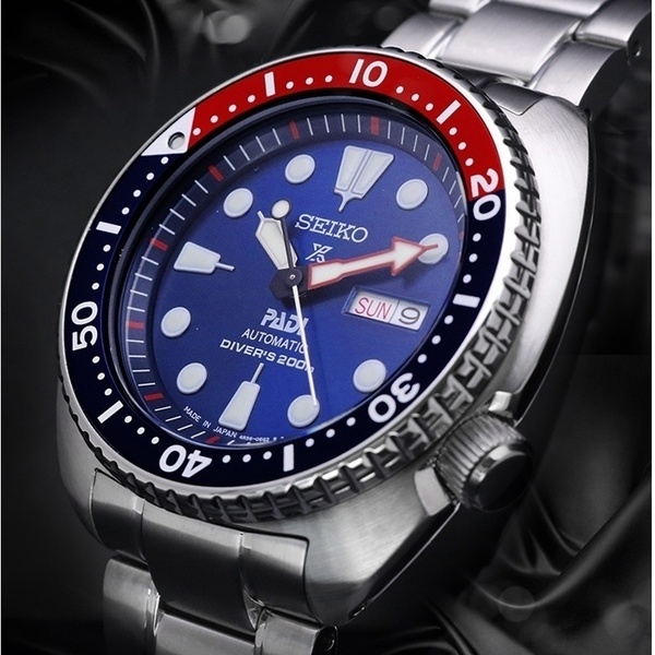

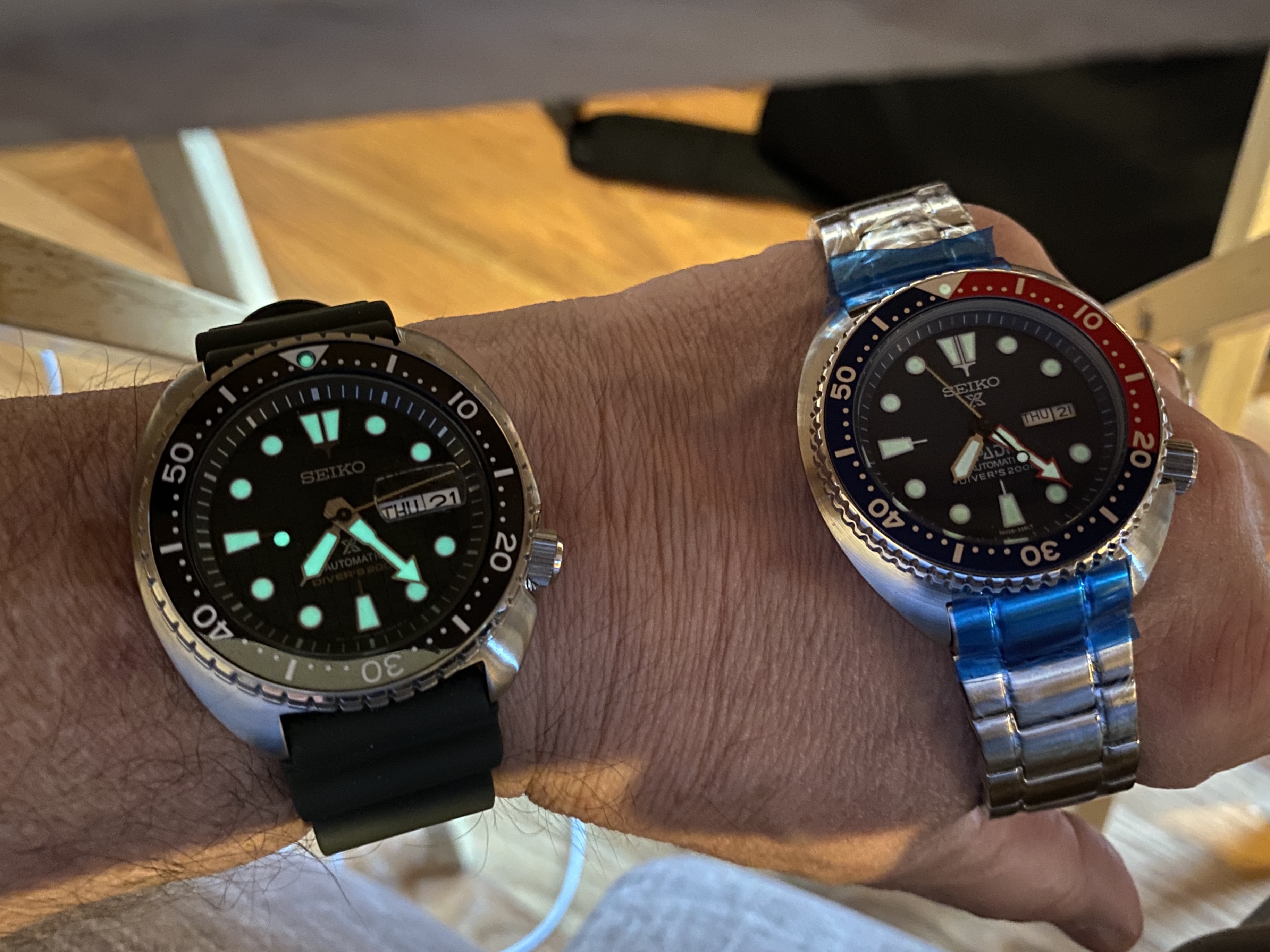

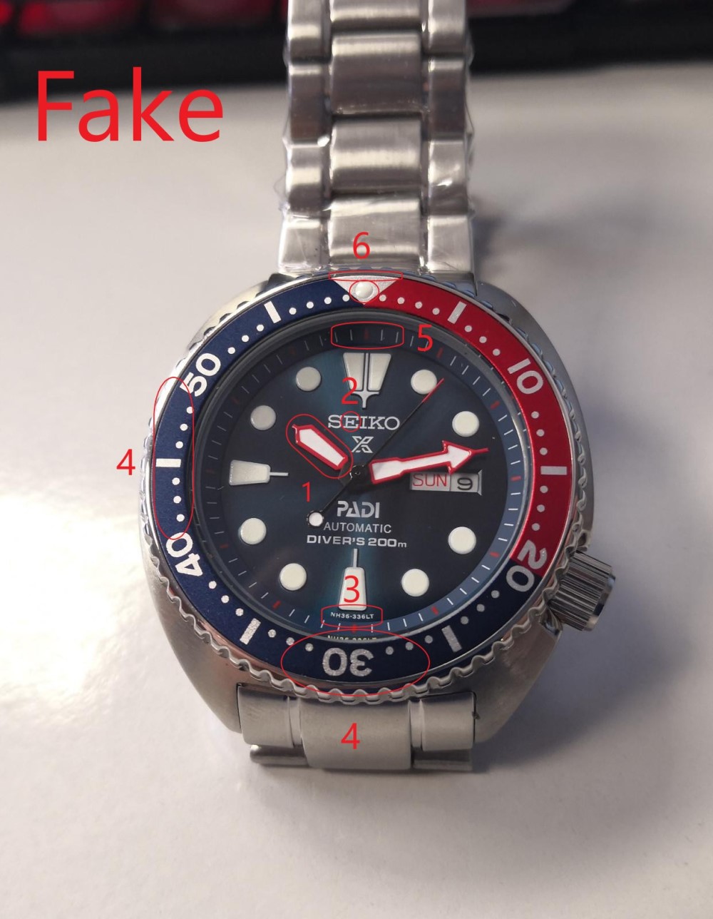

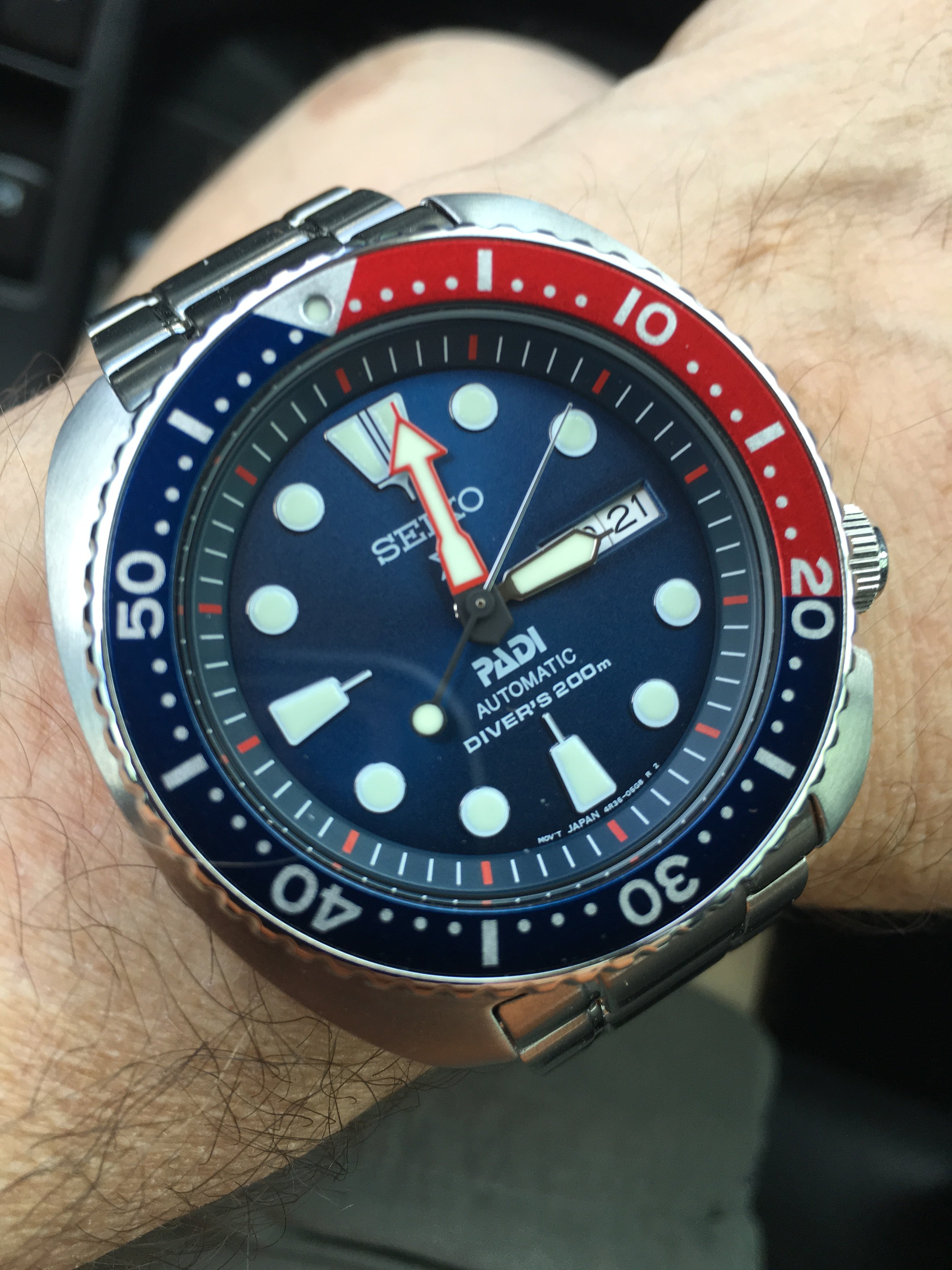

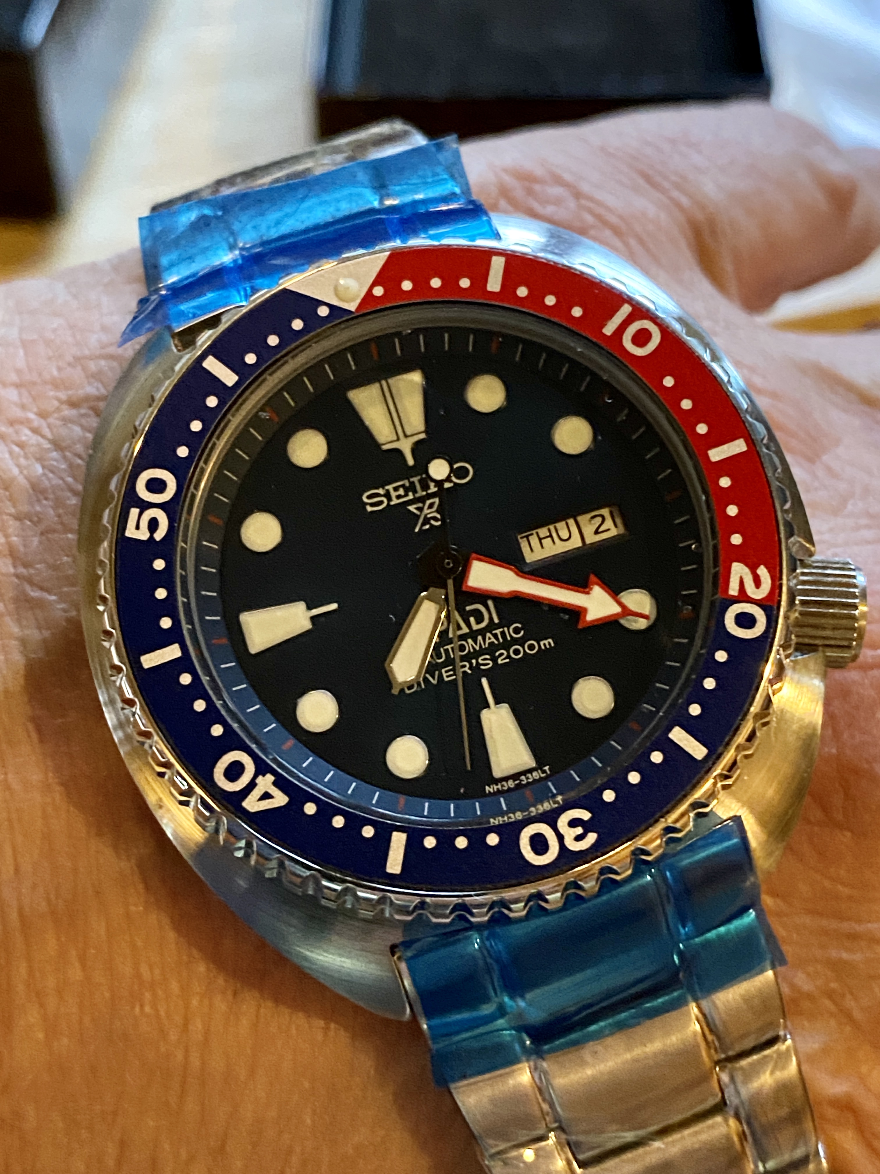

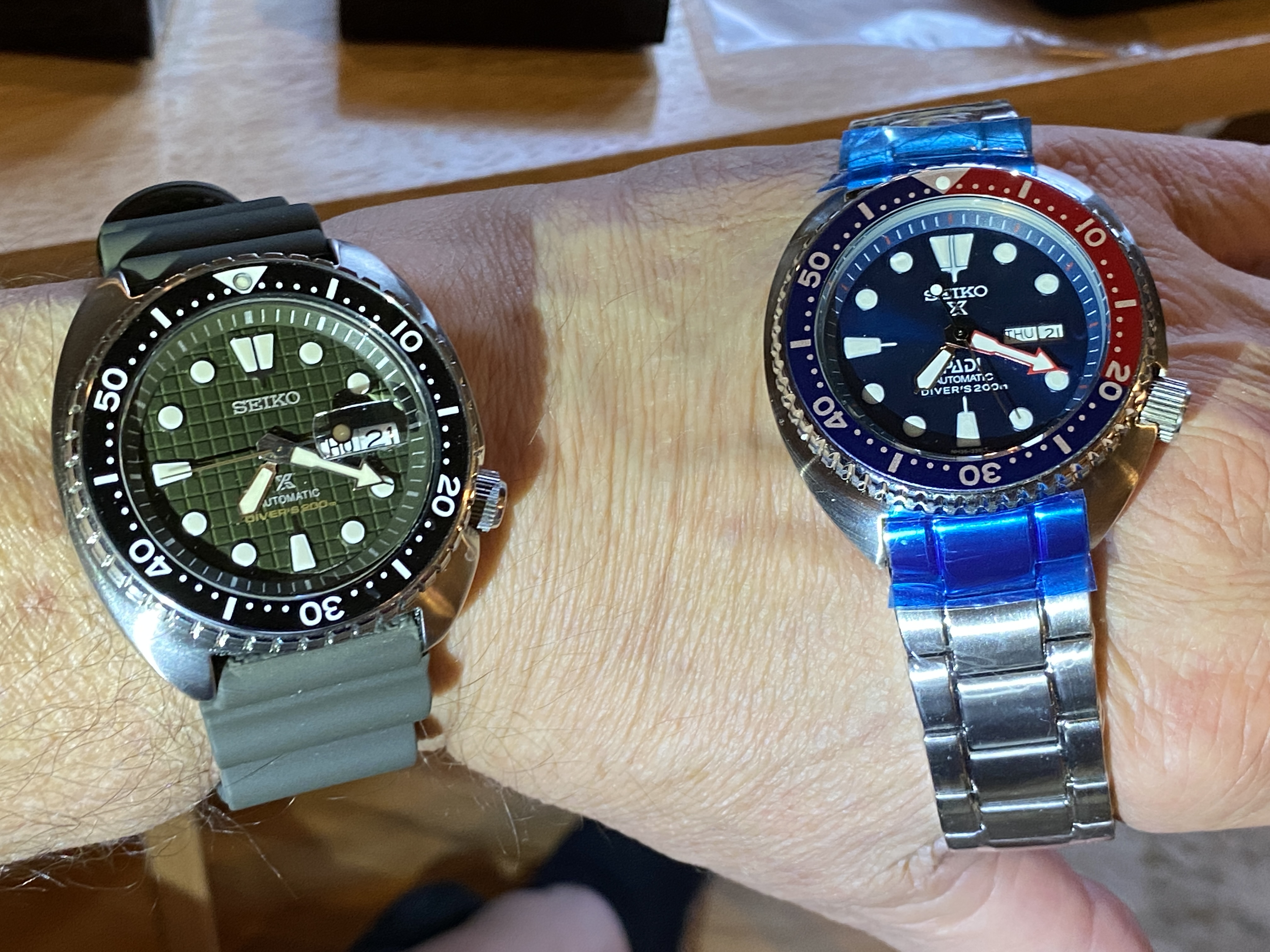

My son tells me, after the fact, that yes, everything on wish.com CAN be fake. The picture with the sale looks like a genuine PADI, but that is not what they are shipping. TBH, I'd only very recently heard of fake video cards on wish.com which made me check out the site - but I hadn't thought that they would take the time to fake a Seiko, or at least all the cosmetic parts. The watch however can be found for $300 from reputable sites, well below the $525 MSRP, so I'm glad they didn't charge me that much and it was $65 out the door after adding $10 shipping.
FAKE
MY GENUINE PADI TURTLE
Fake bezel with wrong lume pip, and the numbers and markers on the bezel are farther out from the dial than they should be. The red lines on the chapter ring at 3, 6, 9, and 12 are thin and faded and don't line up with the hour markers on the dial like my PADI.
The fake dial has very weak lume, and the PADI font is significantly thinner, plus the dial states NH36 (3rd party) and not 4R36 (for Seiko watches). I know there are two dial variations on the PADI that both mention Japan for either the whole watch or for just the movement, but the fake would represent a variation that we have never seen.
Also, the day wheel is not lined up properly in the window for most days of the week, and the font in the date window is wrong (no serif on the 1), so likely even a fake date wheel. The signed Seiko bracelet clasp feels cheap and gritty, and is difficult to close on the wrist unless you wiggle it from side to side when pushing it closed, or press the clasp side buttons, so I'm not sure I'd trust it to put the bracelet on a genuine Seiko watch like my new waffle dial turtle.

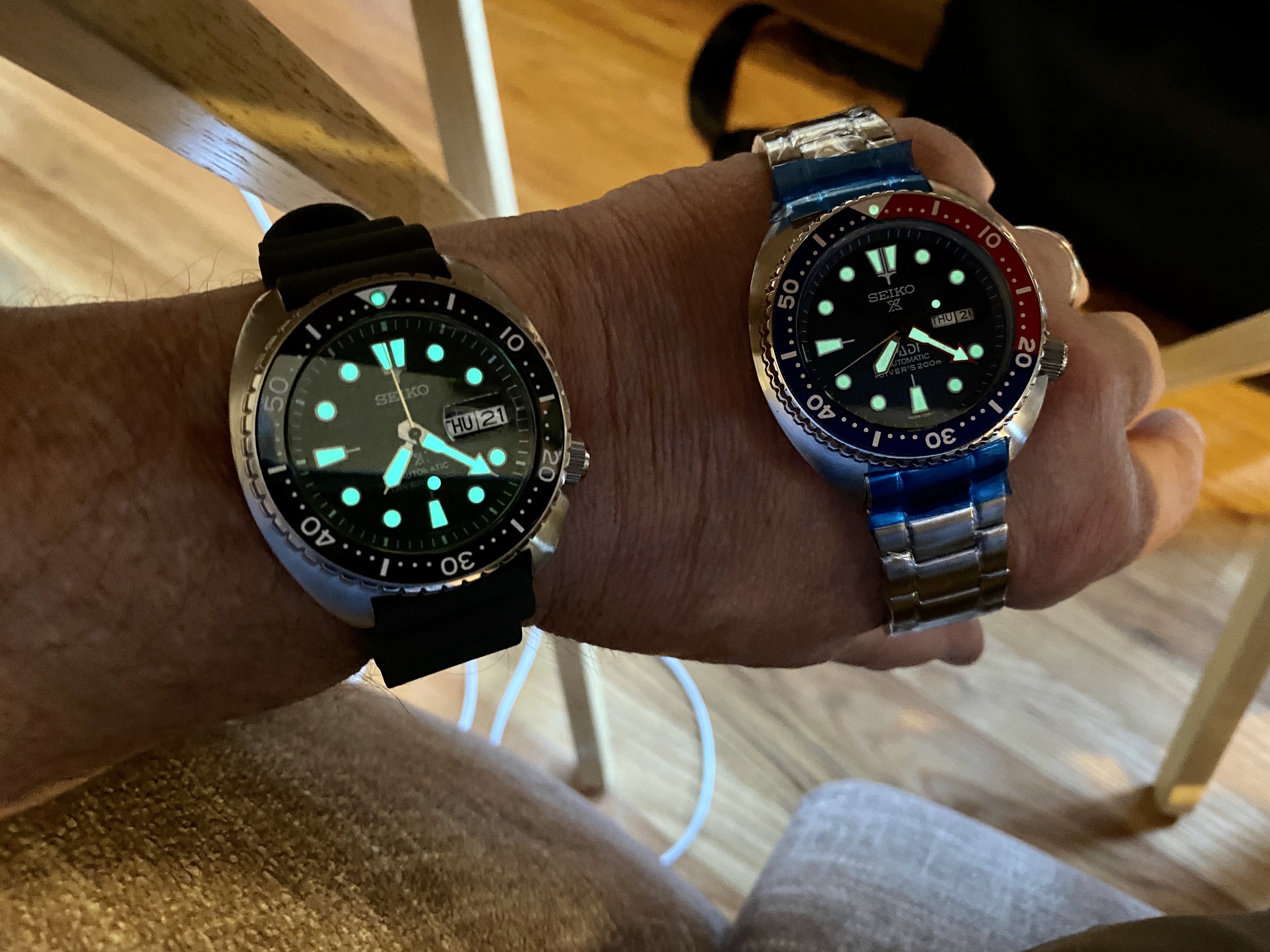

If you shine a bright flashlight beam on the real Seiko and the fake, the genuine Seiko is brighter; and 4 minutes later the genuine Seiko is still electrified out the wazoo while the fake dial lume has faded to zero.
I'm taking it to my watchmaker tomorrow. I would be surprised if the movement is a genuine Seiko movement in good working order and properly lubricated, although I have seen new NH36 movements advertised for sale for $59 to the public. And I know my watchmaker will do a movement swap with a genuine movement for $100 parts and labor, so it might be worth the cost of the movement alone. I could return it, gift it, report it for a refund, or it might be a watch to use as the bones for a "mod seiko" with parts from Yobokies or something (doubtful).
I'll likely report this to my credit card company (Goldman Sachs Apple Card via Apple Pay) - the watch was presented as genuine Seiko PADI and I have saved the web page as a webarchive and as a PDF (as well as each picture) as proof that I didn't get what I ordered. It might not even be worth sending back and wasting the postage.
FAKE

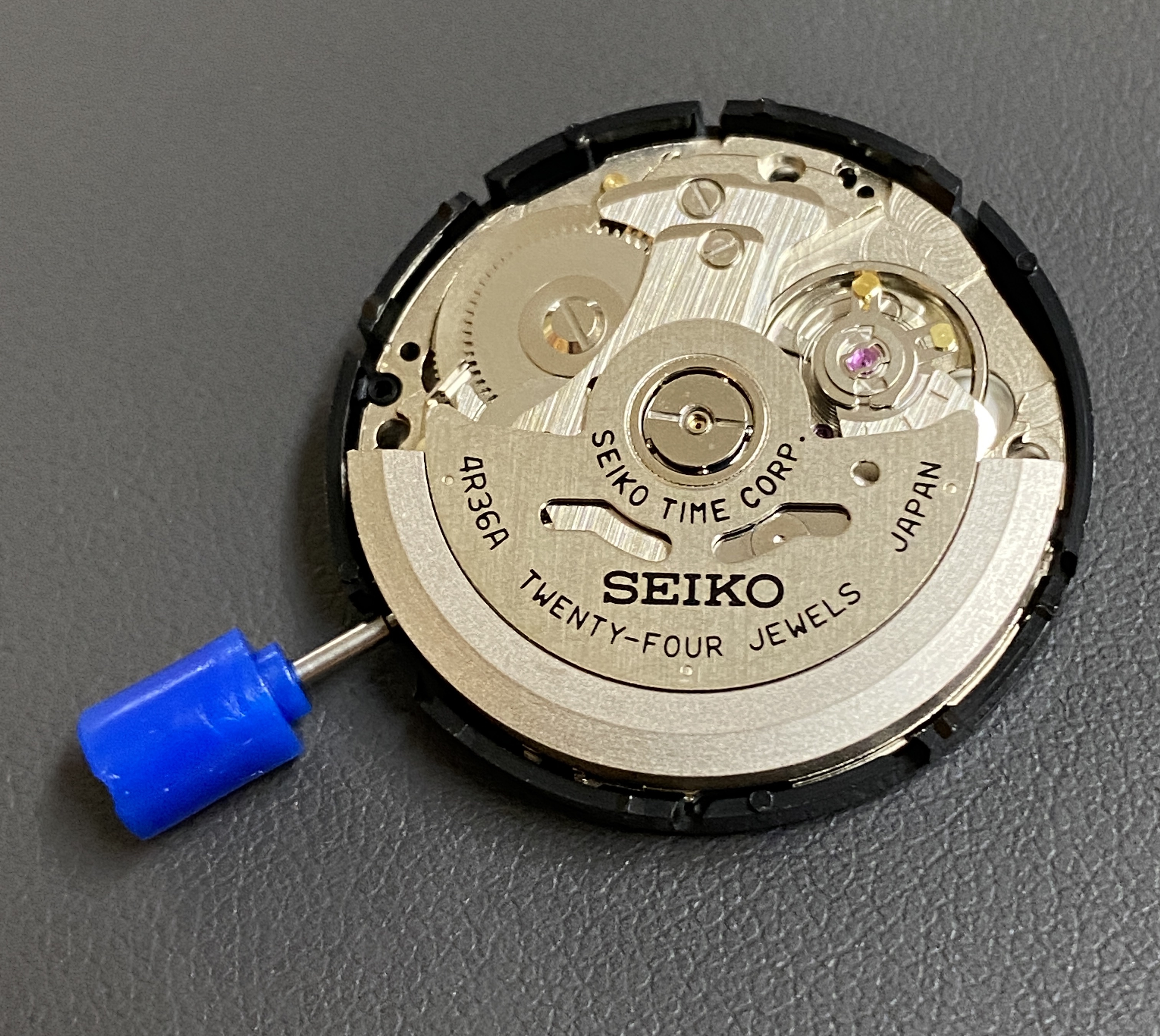

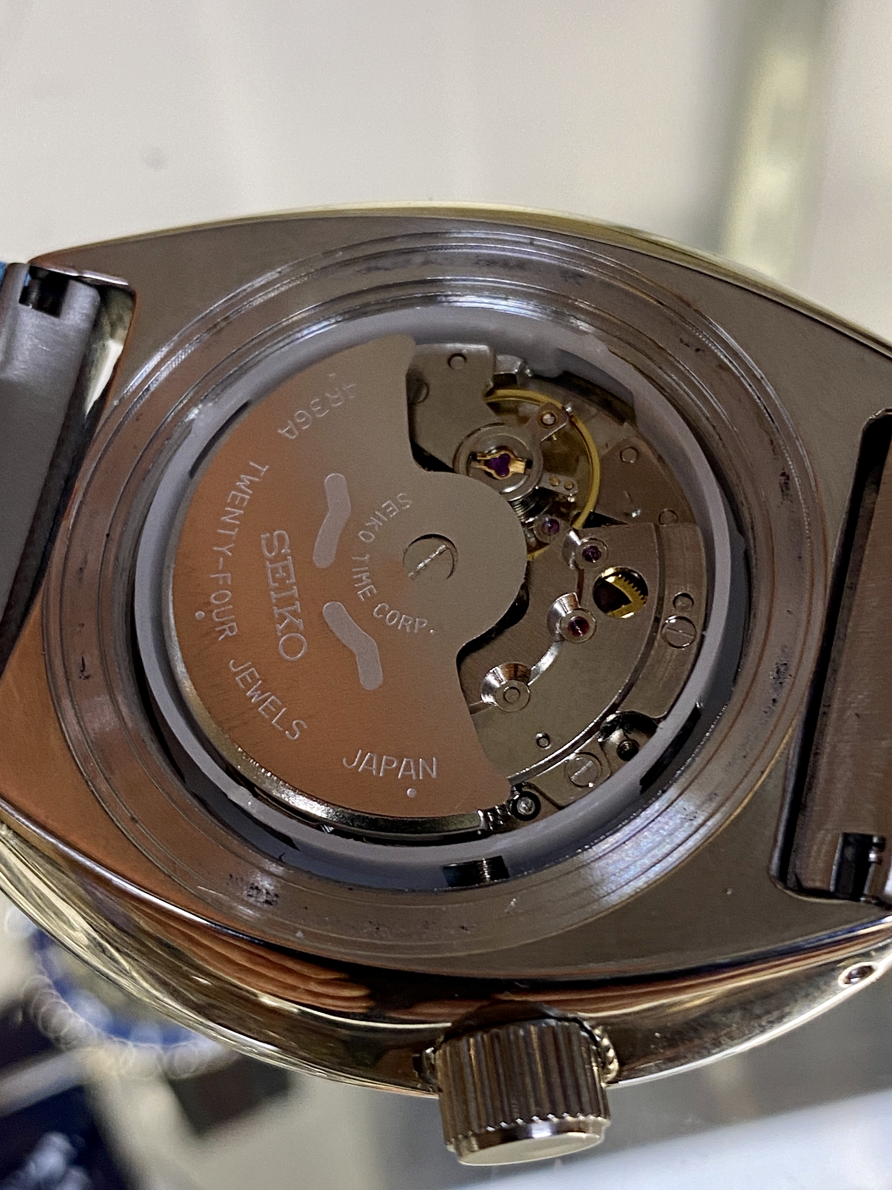

So, the movement is definitely a cheap Chinese FAKE, and it's not even WR to 30M, let alone 200M. It leaks out air in the vacuum test, and is WR 20M. It's running decently at a consistent -8 to -11 sec/day on the winder for the past day and a half.
My watchmaker doesn't think any part of the watch is genuine, and brought out a new movement to show me the comparison. He also days the dial is not on straight, rather than the day wheel and chapter ring being off.
FAKE MOVEMENT in a plastic holder. So, not even a generic NH36 for me.
Genuine NEW unused Seiko 4R36 that my watchmaker had on hand.
