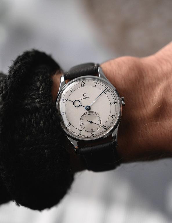

Is this vintage Omega real? 30T2/1939

I think the dial is original, based on the quality of the print, the period correct Ω, the surface finish of the centre section contrasting with the outer section (between centre and rail track). The numerals are all correctly proportioned and positioned in the main ring. The major minute ticks are all identically positioned (not quite touching the second inner ring), all other minute marks are equally spaced and cleanly inked. Third inner ring perfectly positioned for the tip of the hour hand. Can't see enough of the sub seconds dial though.
As to the disparity in condition between the dial and the rest of the watch, I could live with it.

I guess I’m persuaded and I’ll change my vote to original, but the dial condition for a watch this old is simply amazing. Was it stored in a vacuum? 😕 I used to work in the rare book room of a major university library. If only some of that collection looked like this dial!

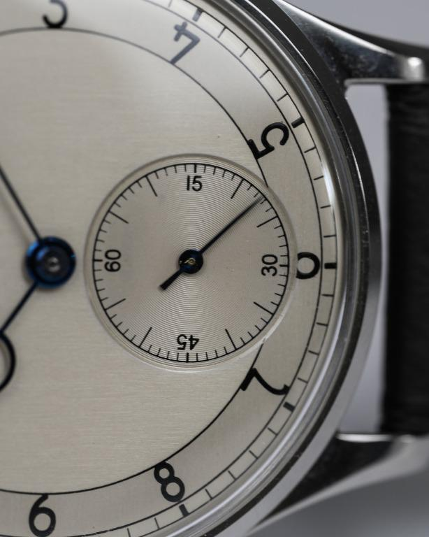

Here is the subdial. A little light reflection off the 4 and 5 reveals their texture. Sharing for the experts to analyze, but I'll say it looks very nice.

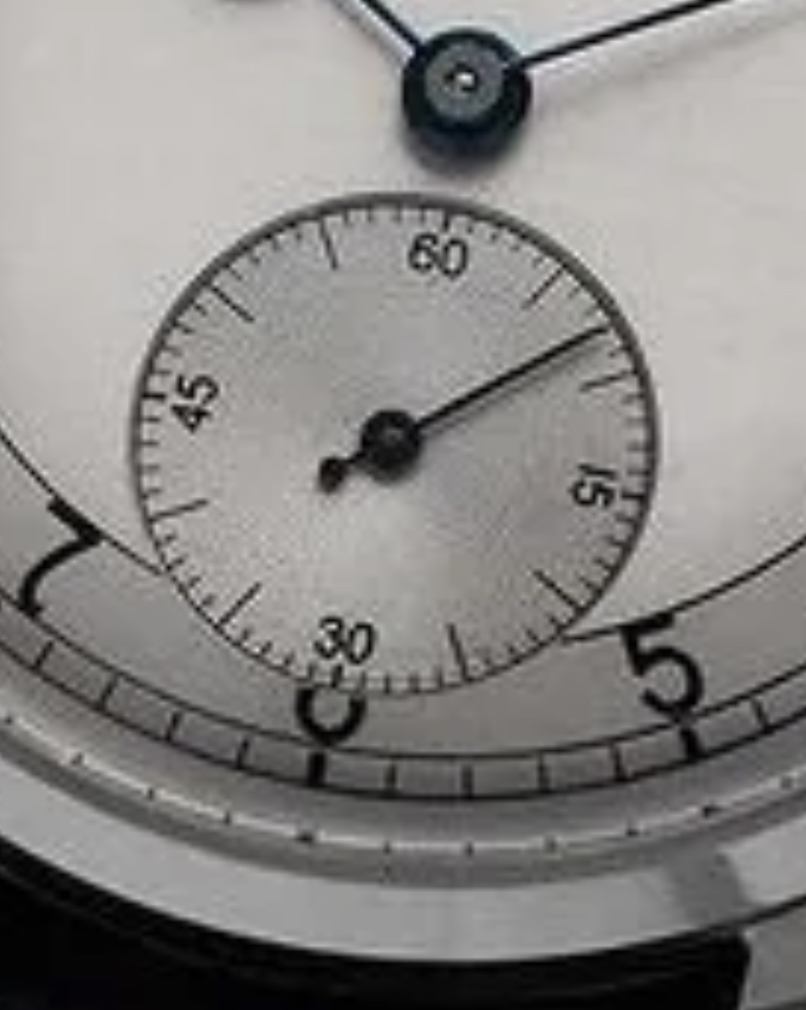

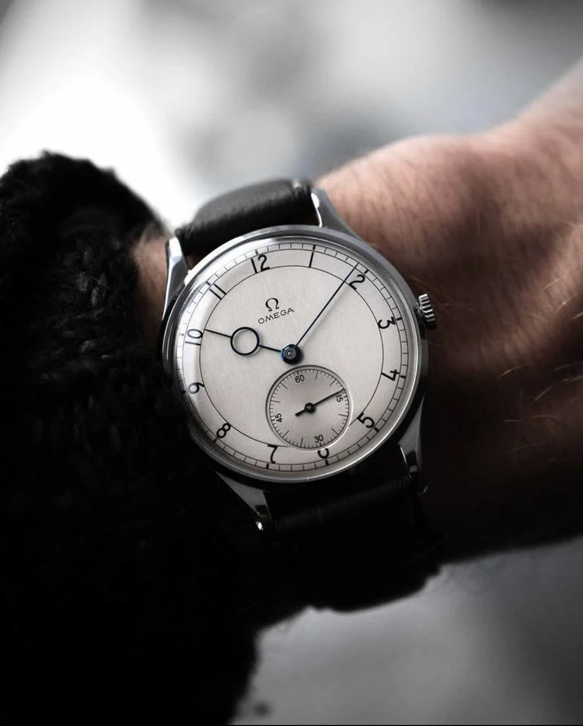

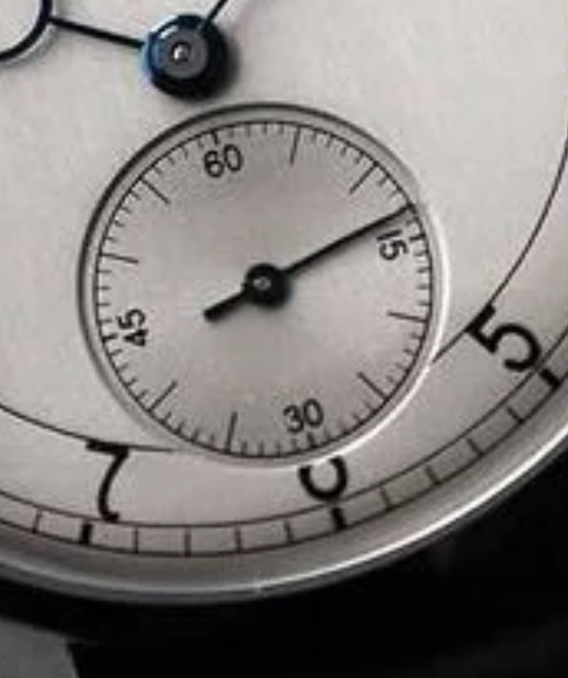

Something seems fishy to me, though. Here is a different watch on WUS from 2020 with nearly the same wrist shot (maybe one photo is digitally altered, which seems common practice for some dealers).
OP watch (I assume from the images): https://www.carousell.sg/p/omega-art-deco-dress-watch-oversize-1939-38mm-1076704503/
WUS watch: https://www.watchuseek.com/threads/...-vintage-2609-9-with-archive-extract.5256505/
The WUS watch ad has photos of what seem to be two different watches, unless it's just the light accentuating the vertical grain in some photos and horizontal in others. The WUS watch ad states "The dial has been professionally restored with all original Omega parts correctly signed."
Edit: upon looking closer, I still think the OP watch is authentic or very, very nicely redone. The WUS watch dial has some clear problems, and the OP watch has none (that I can see).
It’s the same wrist shot (someone edited it differently for WUS) but the WUS listing shows two different watches. On WUS, look at the sub dial in the first image (the wrist shot) compared to the very next image.
As you saw, the graining on the OP’s watch is vertical while the graining in the WUS listing is horizontal, not to mention other discrepancies. I do wonder why the WUS user edited the wrist shot of another person and used it for their listing.
Carousel
WUS. Skin tones are super grey and lacking life.
Yeah, I completely missed that - different track and different hand.
So probably just shady shenanigans on WUS, and says nothing about the OP watch.
