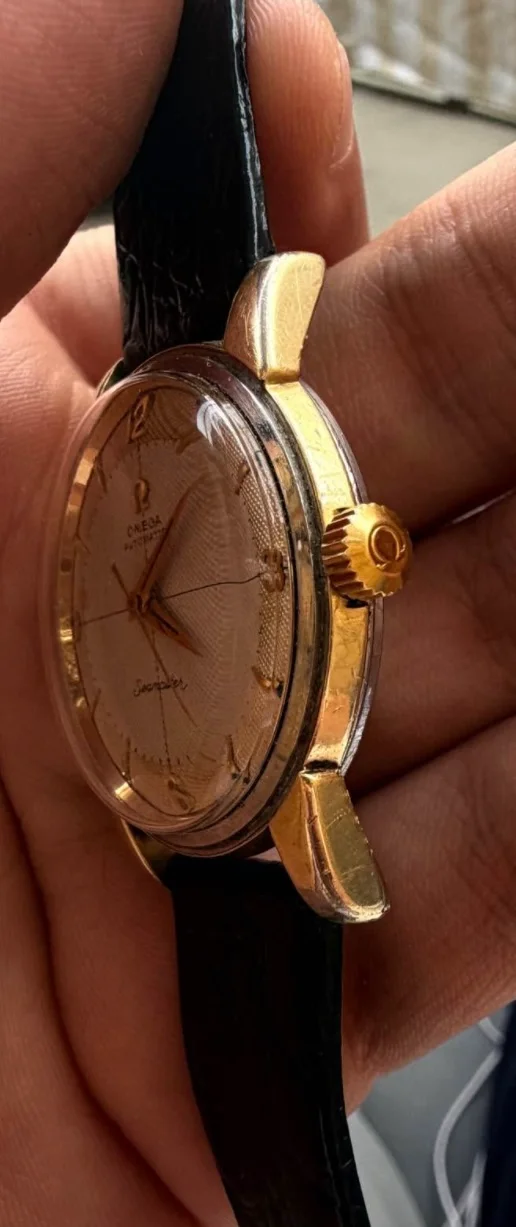

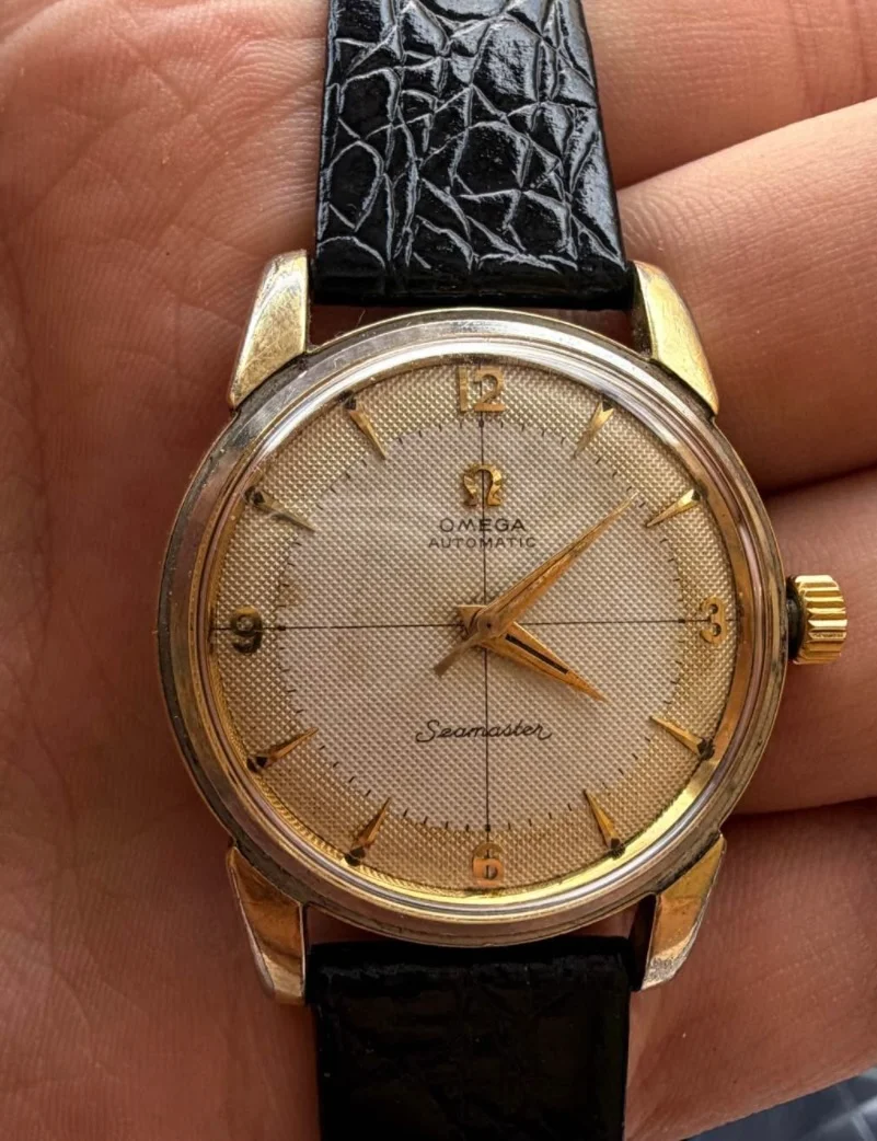

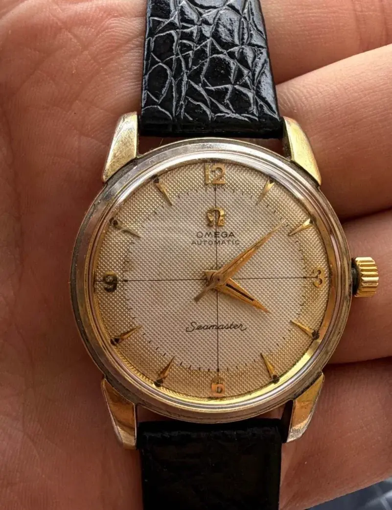

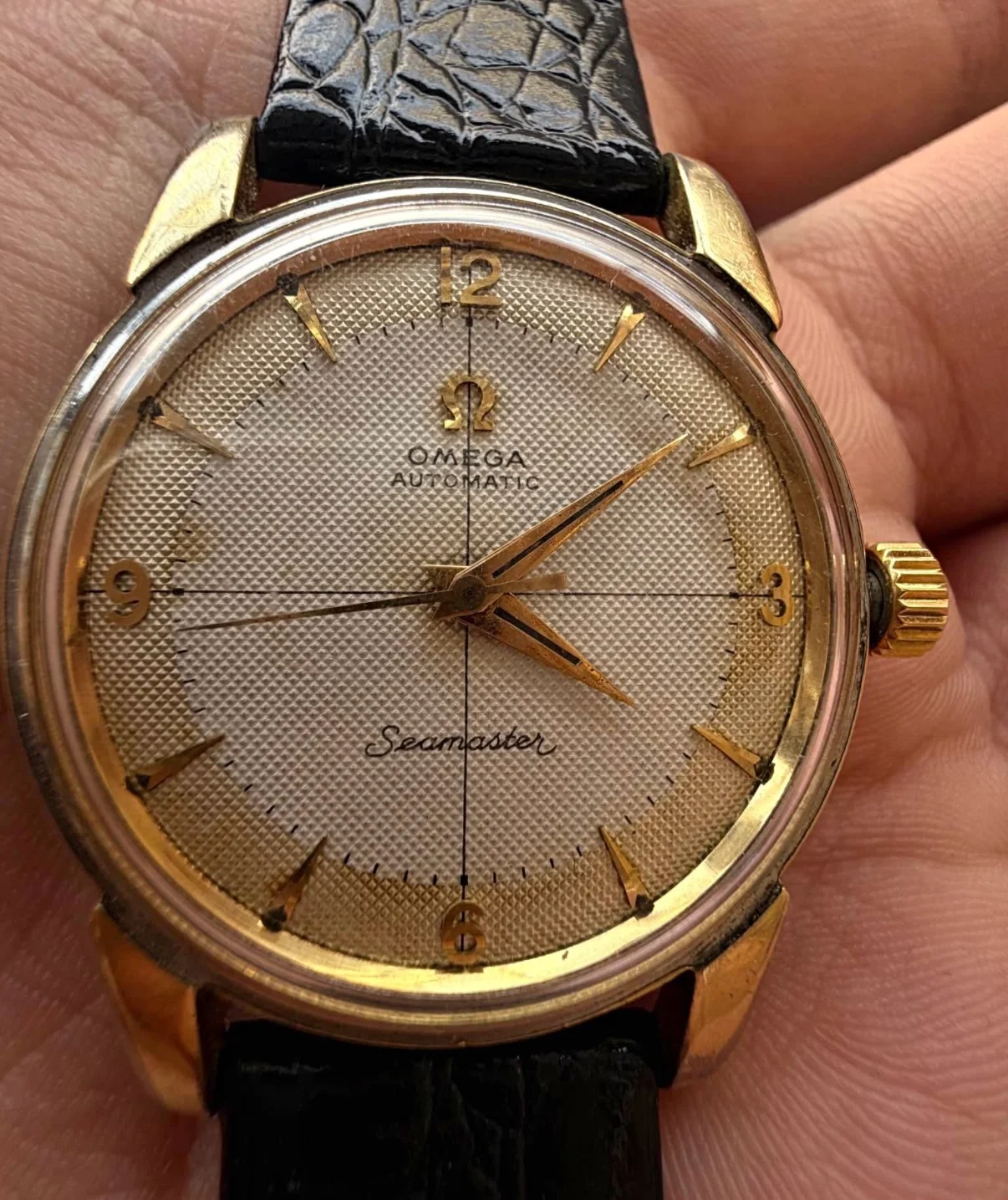

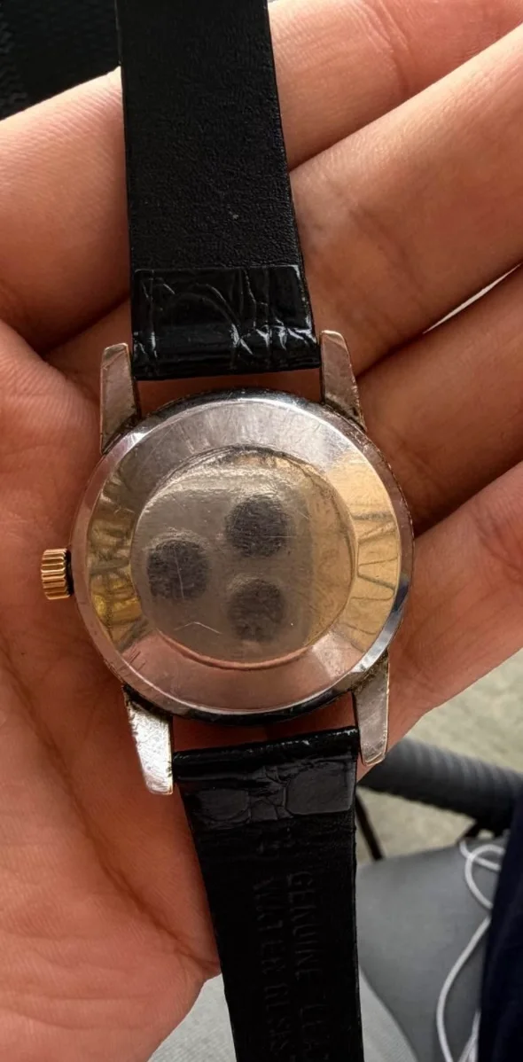

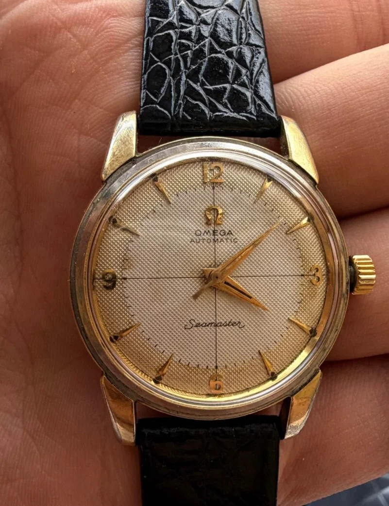

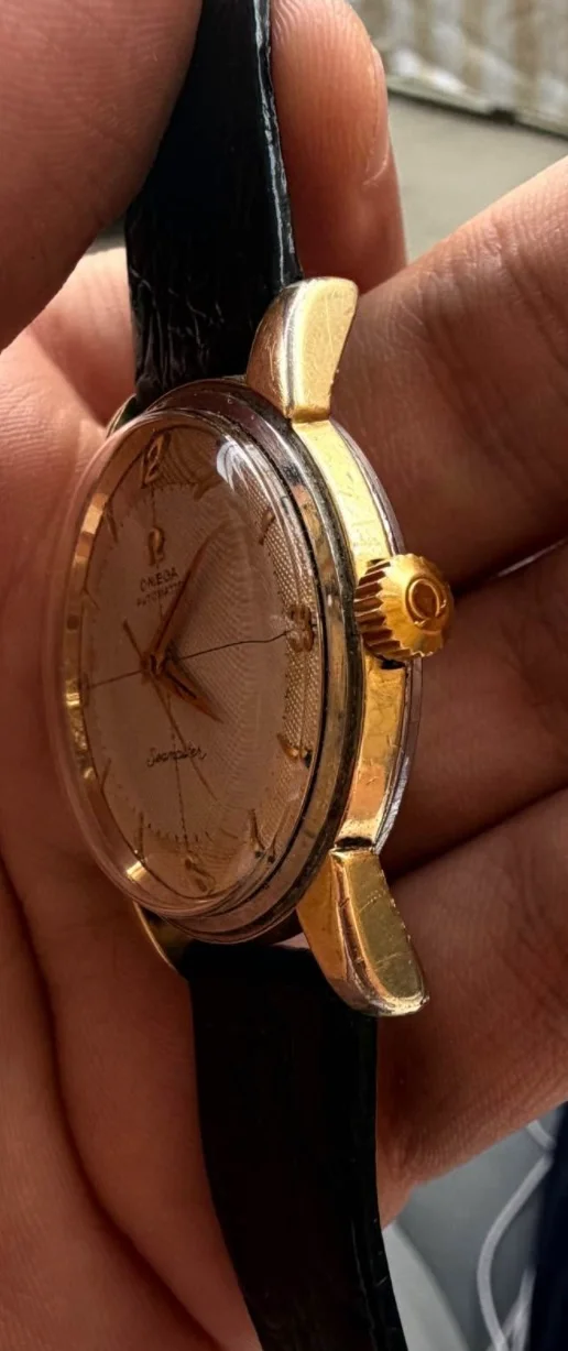

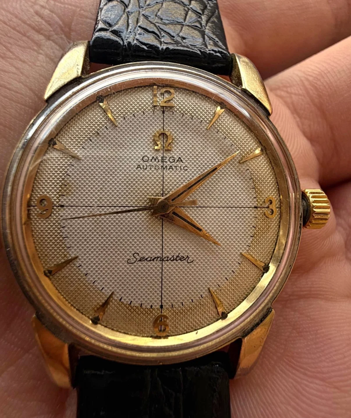

A Posts 1 Likes 0 alexmed95 ·Nov 26, 2025 Hi all, Just came accross this vintage Omega Seamaster with a two tones Honeycomb dial fo sale. That said, I'm still quite new to Omega watches and was wondering if you guys could tell me if it's suspicious or authentic? Also, unsure what is the exact model number. Thanks a lot
Posts 10,504 Likes 16,411 padders ·Nov 26, 2025·Oooo subtitles! Looks legit to me. Is the bezel missing? If so don't go there. Run not walk.
Posts 18,076 Likes 37,721 JimInOz ·Nov 26, 2025·Melbourne Australia Dan S Missing bezel and repainted dial, IMO. IMO too.

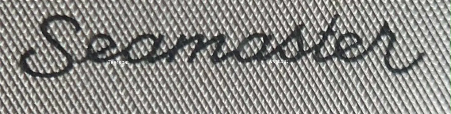

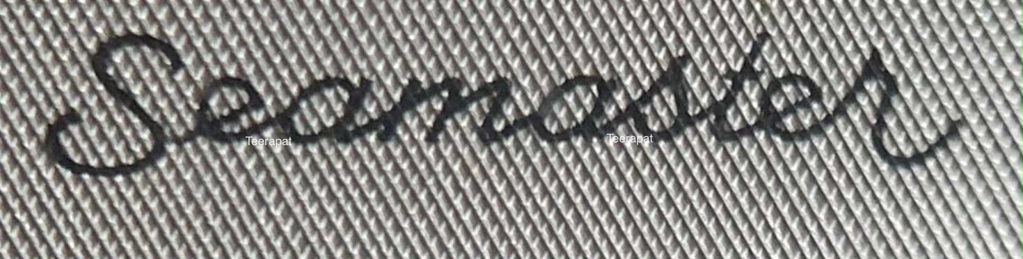

Posts 967 Likes 3,959 qazwsx1 ·Nov 27, 2025 Agreed on the redial. Take a look at the ‘m’ in the word Seamaster. Please compare it with my Seamaster from the jumbo reference.”
