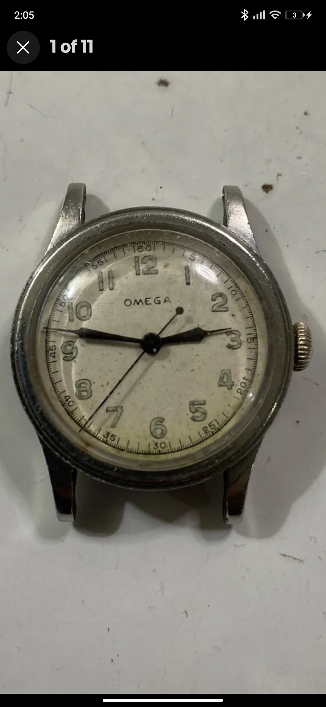

is this vintage omega genuine?
47
56
When it is this old i can not be sure. İs there any omega without logo like this? Can this dial be original?

It would help if you had pictures of the case back and the movement.

The dial is repainted and the hands are not correct. Other than that, I can't say from that photo. There could be some authentic Omega parts.

Ref 2175?
Caliber 23.4 SC
Hands are likely correct and original, dial just incorrectly refinished.

The dial has been rotated counter clockwise. I suspect the dial feet are broken off, I very much doubt if it is a product of Omega. More information needed in order to be certain.

Sorry I don't have the reference on this one.
Might be a 2064.

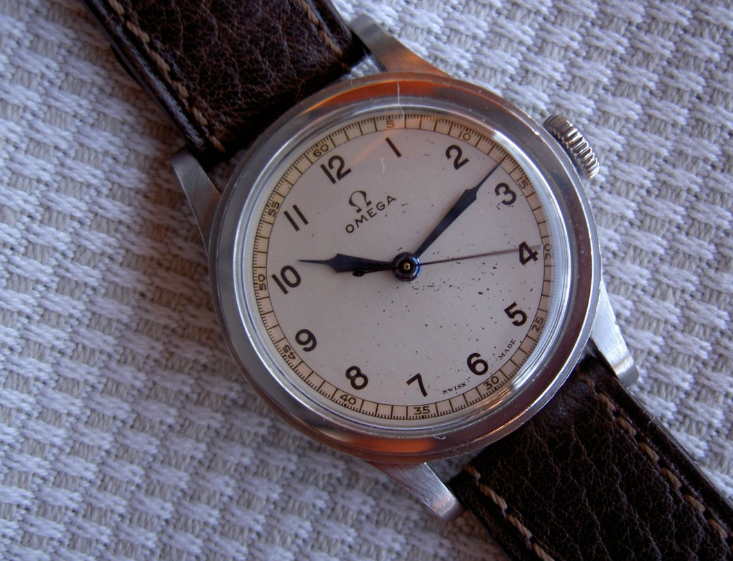

1,588
12,730

Do you know ref number of case similar to this but with 3 notches on the back, like longines tre tacche? I've seen it somewhere but there were no ref numbers inside case back.
1,884
9,610

I have the vague impression that I know this watch 😗
