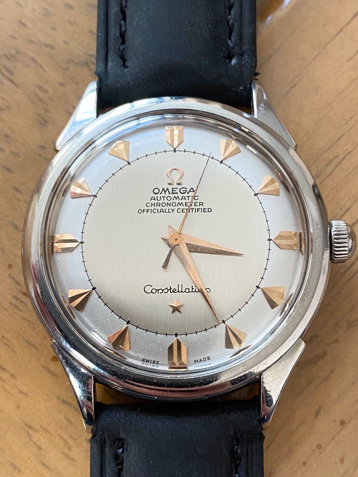

I think this watch has too clean of a dial with some alignment issues and the print doesn't look right. Case is polished too.

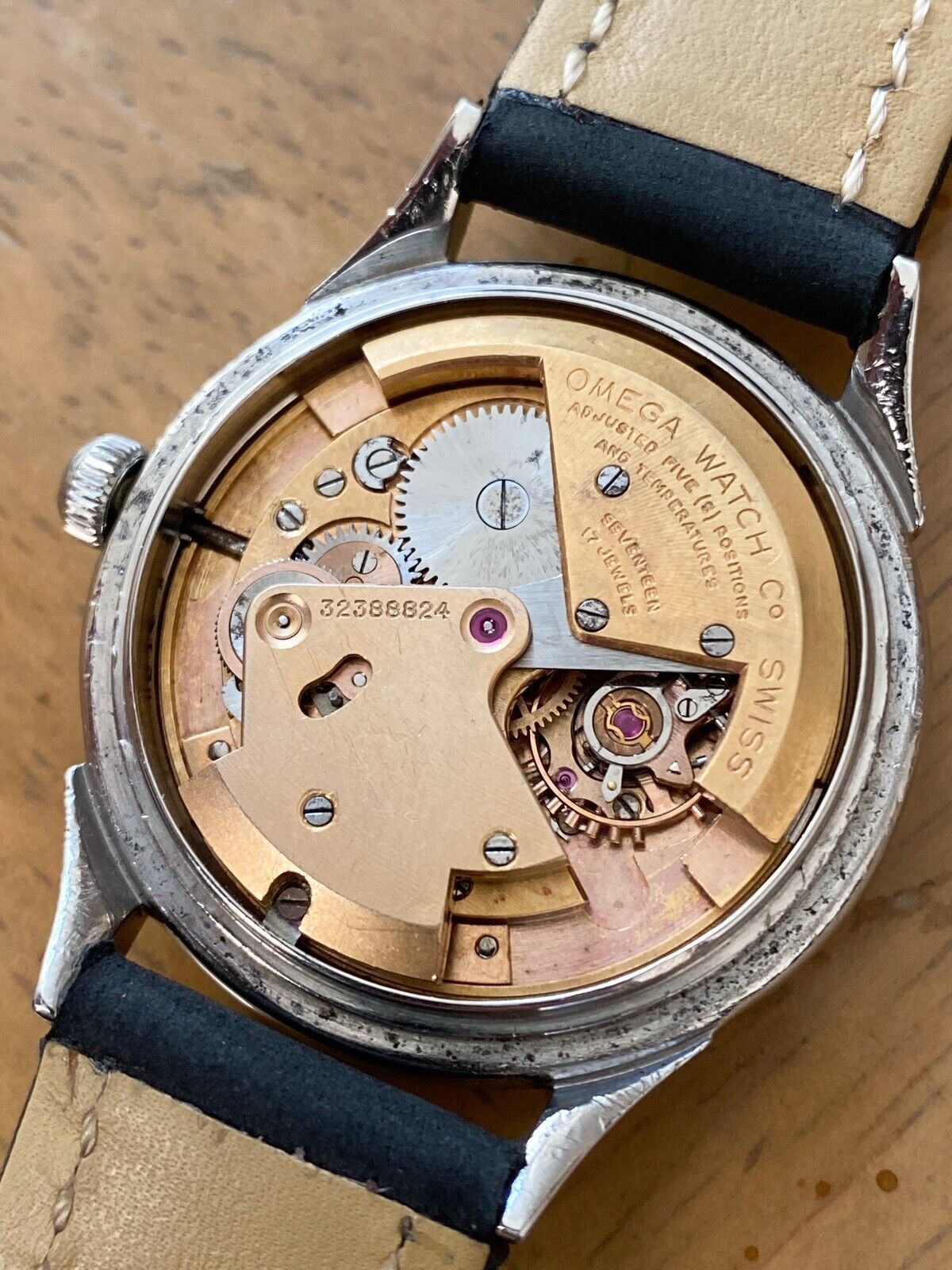

But the serial number is off from what I know unless Omwga keep making them after 1954?
2,270
15,731
Aside of the very bad refinished dial and overpolished case, wrong crown and miss spelled chronometre the serial number on the movement is interesting. Maybe its a service part that was changed during a later service?
8,285
29,301
32m were made up to ~1970
no way that dial is original, though

I was quite certain it was a redial, but found that movement number to be strange.
No intention to bid on it, but I thought it worth of discussion here.

So somebody took a service part with no number and engraved the wrong number? Weird.

I was thinking the service part was engraved with this number and was produced much later than the watch.
Im not sure about the procedure when changing this type of movement parts with serial numbers, but was guessing they dont have a batch of 50s parts laying around to use.

So we are looking at another "franken" watch..

The automatic bridge definitely looks like a service part to me. The grained finish more or less matches what you'd see on a 1010/1020 series or late 565.
