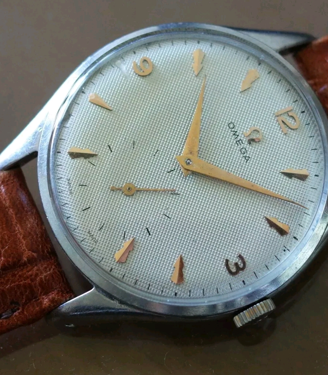

I’ve recently fallen in love with vintage waffle dial Omegas, and found this one on eBay. It looks super clean and that triggers some warning bells for me. Is this a good deal or is it too good to be true?

Probably original, and a nice dial, but nothing like "super clean".
Really? Is'nt the swiss made position strange?
5,026
18,608
Ah. I saw a couple with the same position on the web. Did'nt know that.
8,283
29,288
Yes, that 8 o'clock marker was replaced. But I suspect that the dial is otherwise original, as those textured dials are extremely difficult to redial with any accuracy.
Then again, I could, of course, be wrong.
I'd agree there. Would look more like a nursery school colouring-in project. Also, I would surmise that they are harder to fake.

My guess is redial. I've never seen an original watch with swiss made above the minute markers. Also the fact that a numeral was replaced means that at some point this watch was worked on.

I don't know anything about these, but the sub-seconds area looks clumsy to me, as though the dial would better suit a cross hair there instead of the hash marks. If I really had to make a call then I'd say redial, but either way I wouldn't buy it as the Swiss Made location to me also looks off and even if that is correct I still find it an ugly location to put it in. As for the 8 o clock marker....

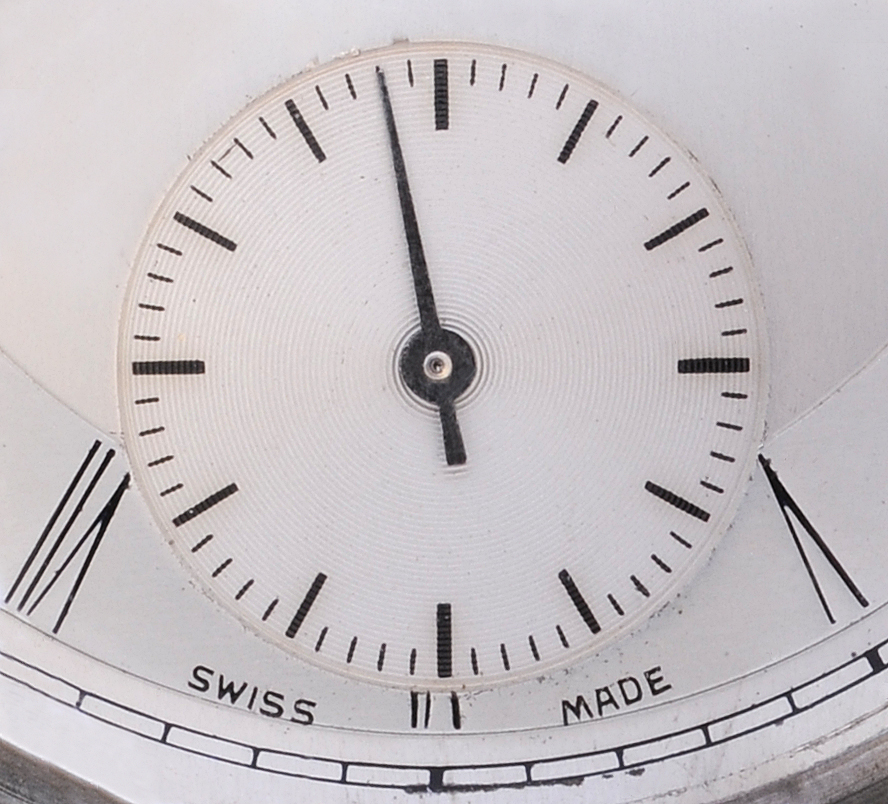

You have not seen everything yet in vintage Omegas:
Detail of an unrestored dial on a chronometer ref. 2366
These are my thoughts as well. A semi-thorough google search will yield one other 2505 with the same configuration whilst all others are the more common varieties with cross hair on dials without sunken seconds track and ten second markings on those with a sunken seconds track. The only place I normally see ten second increments on a level track are on black, redialed watches.
As @BenBagbag will know - and his avatar shows - there are rare exceptions to the design of seconds tracks 😉

I think it's a redial, but one of the better examples.

in my opinion is a redial: the graphic is not perfect as Omega do on that kind of dial, and close to 9 there is a dent and the color looks exactely the same as the other parts of the dial. Usualy the base of the dial is dark yellow and you can't see any "hand made" color on the scratch.
The index at 8 is different and is quite impossible to find one like the others.
sorry for my bad english, hope you understand.

Ref 2505 isn't all that uncommon, so OP, pls don't be in a hurry to buy this particular one
